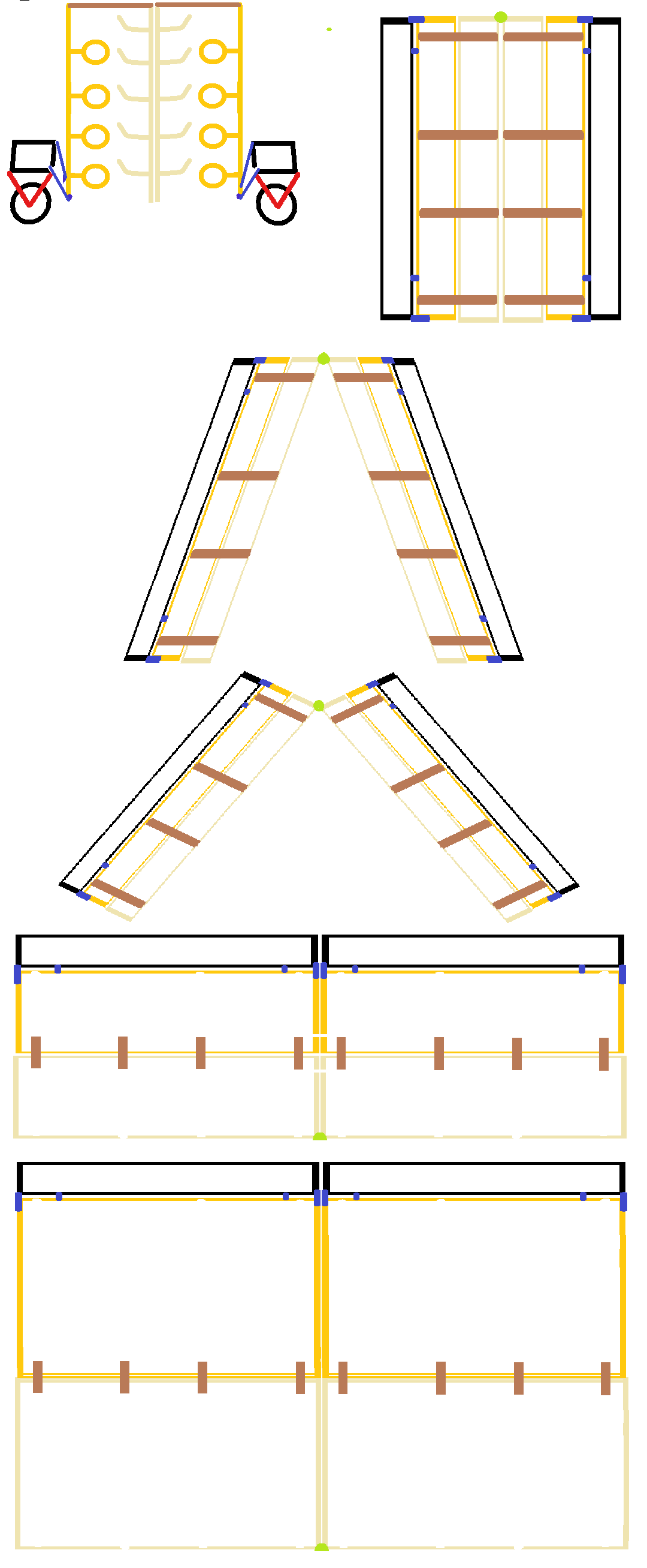

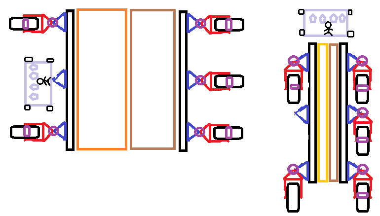

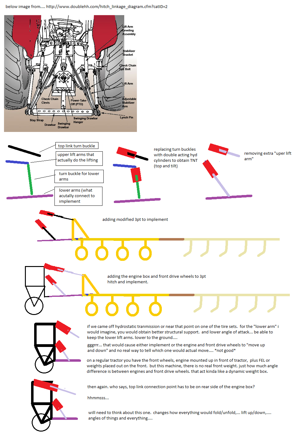

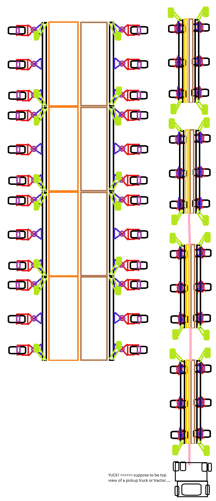

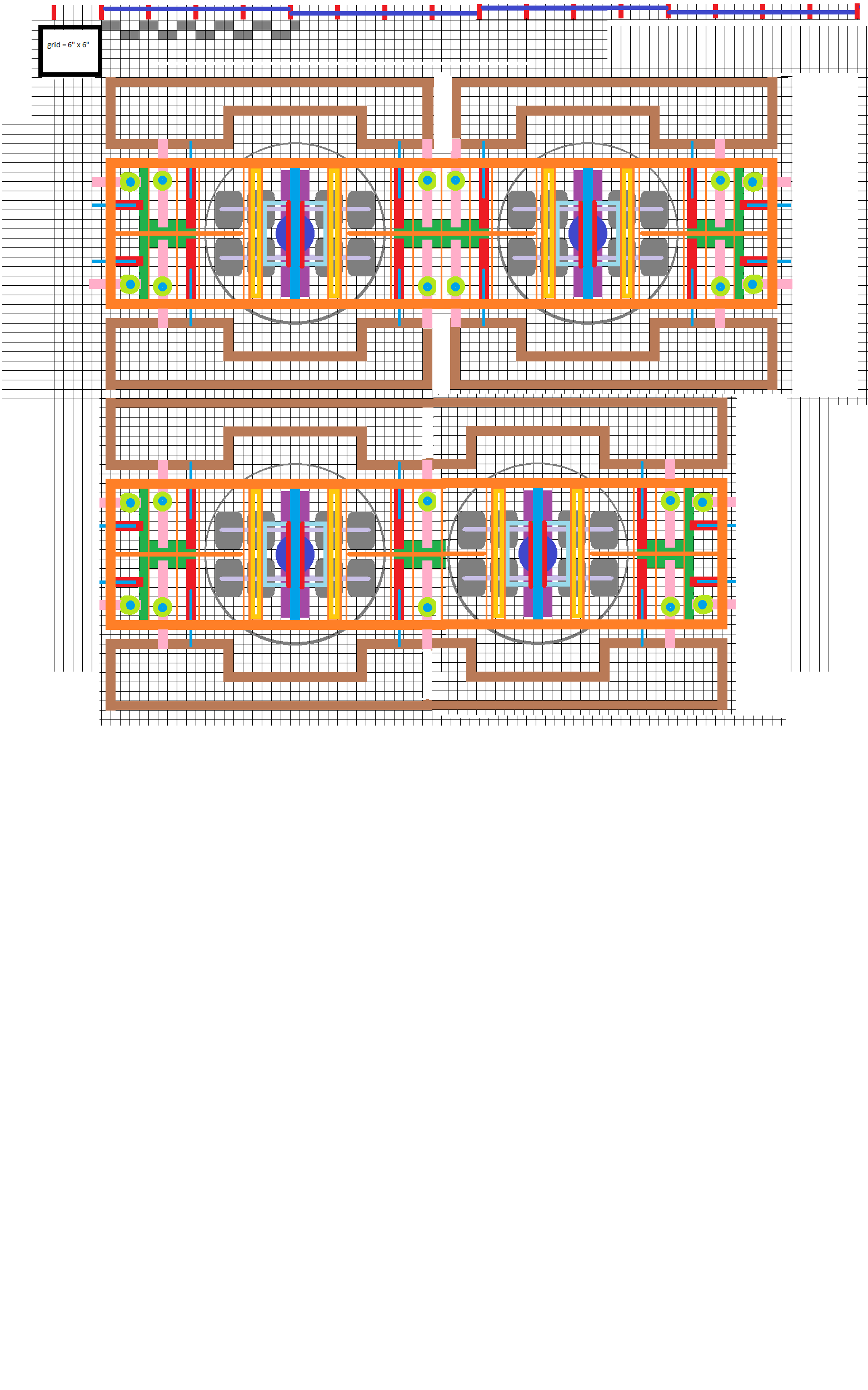

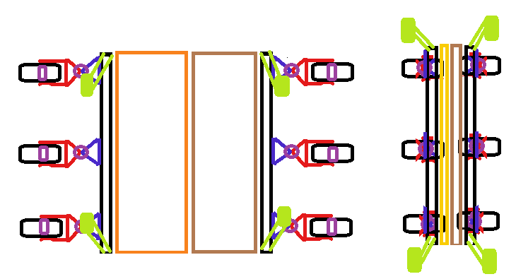

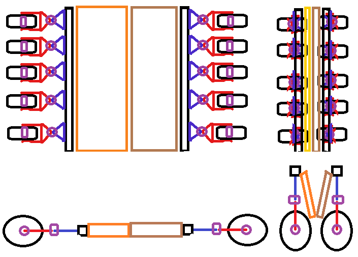

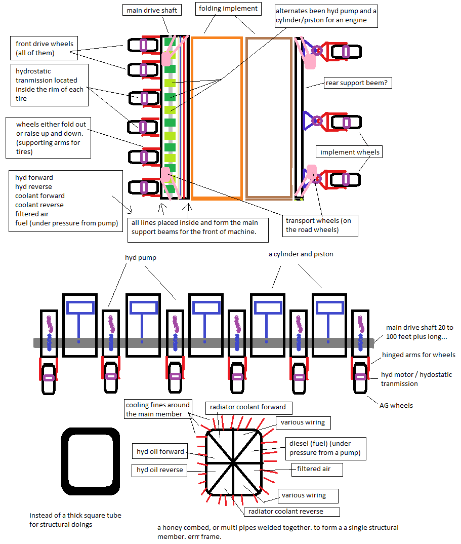

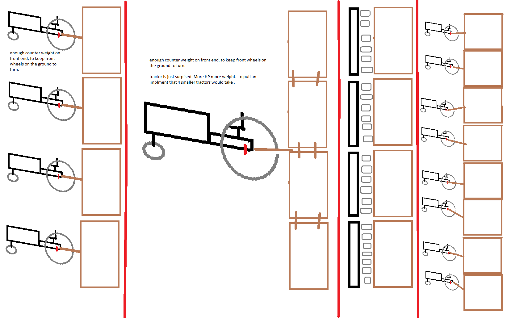

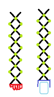

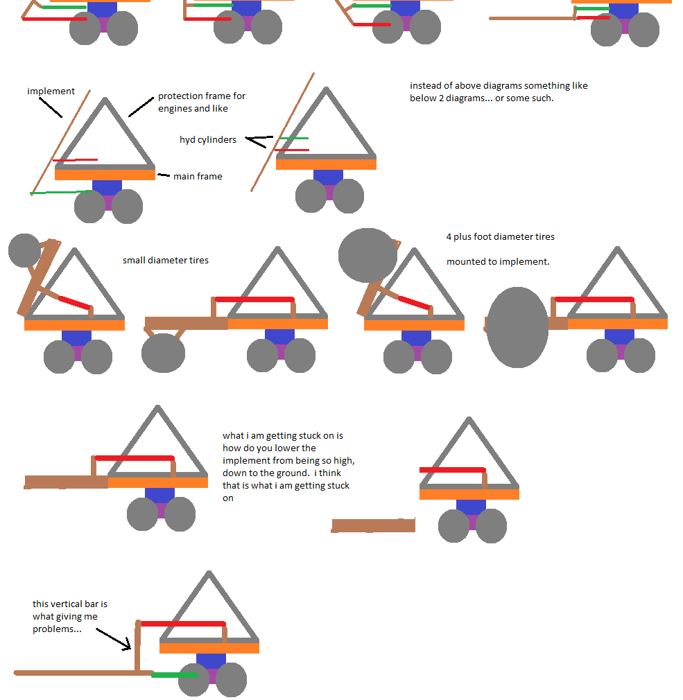

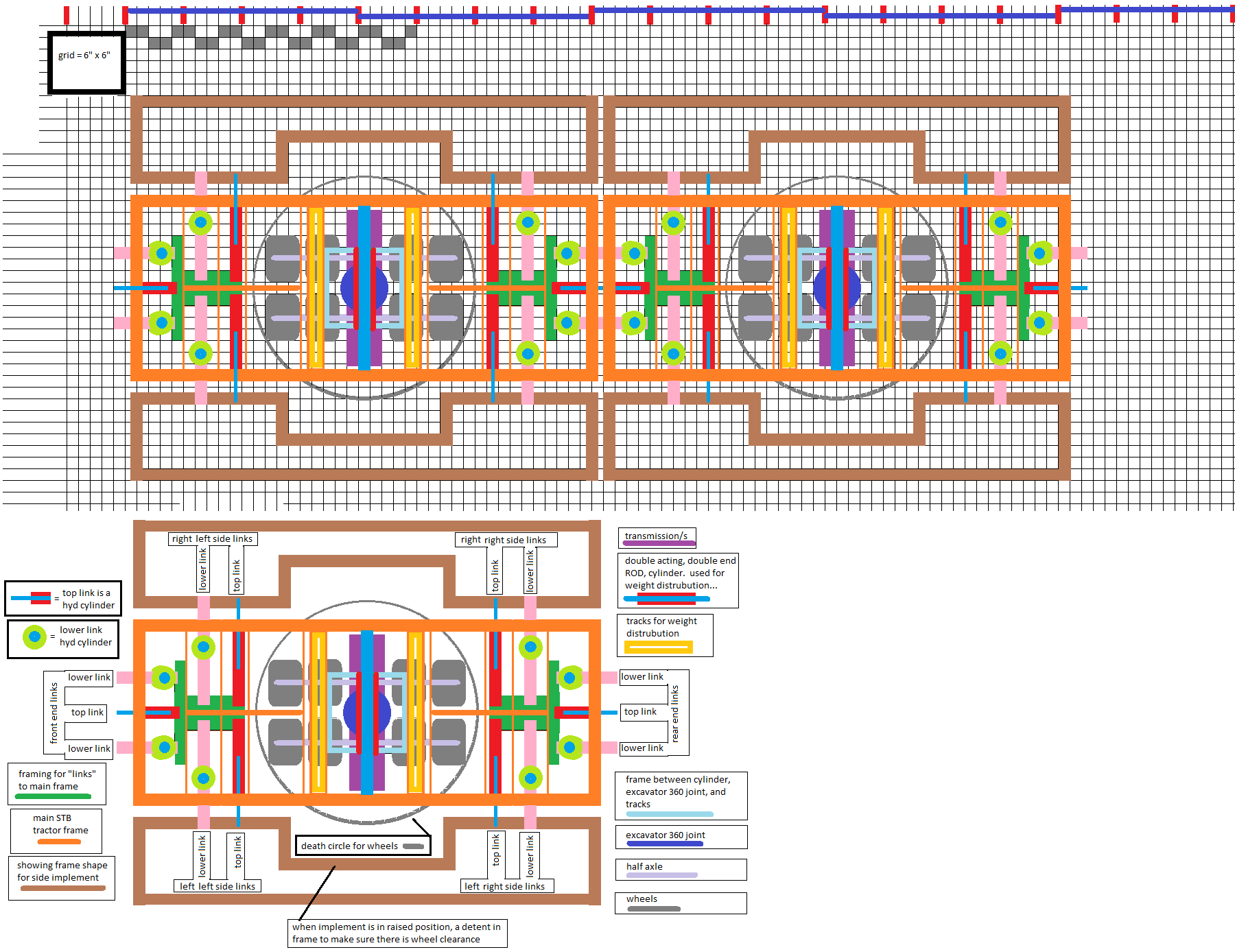

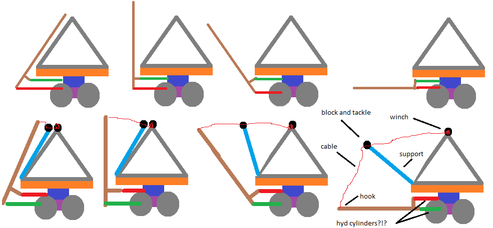

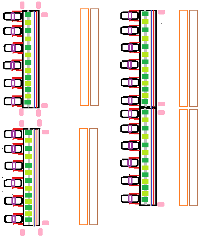

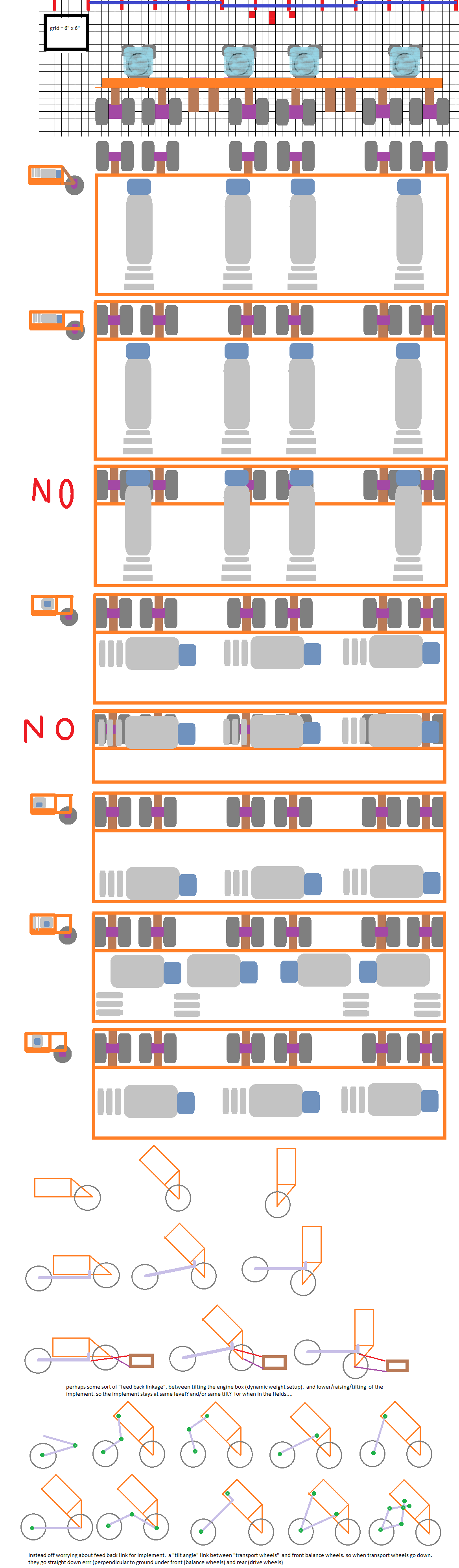

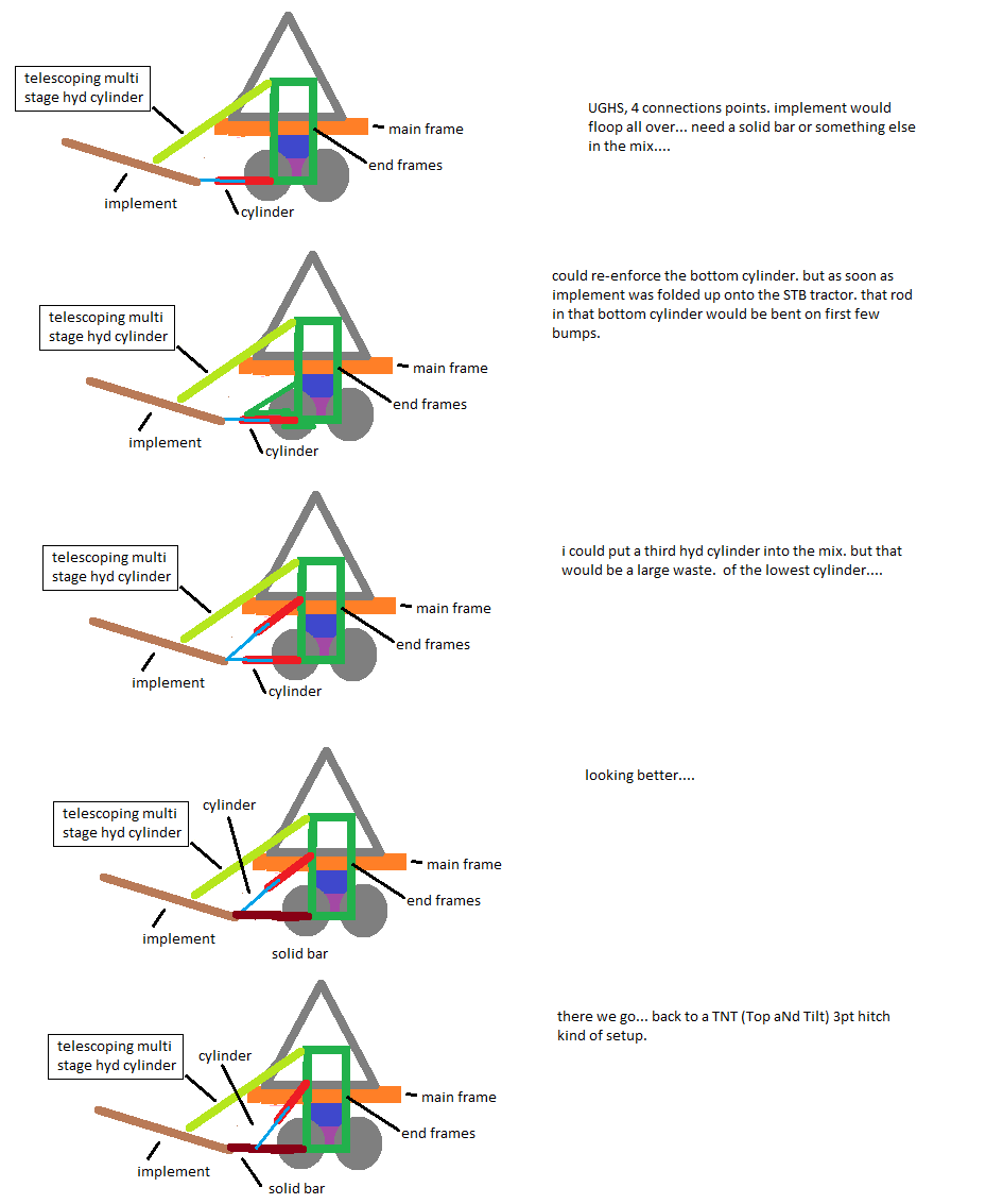

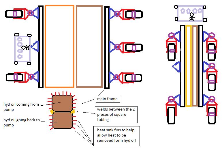

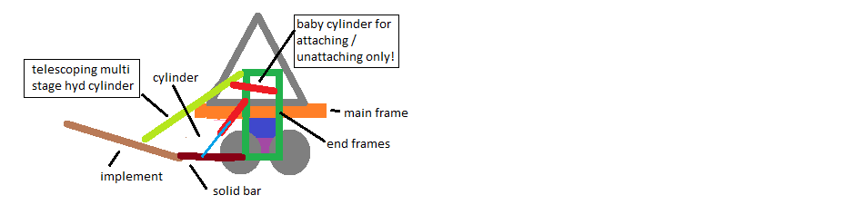

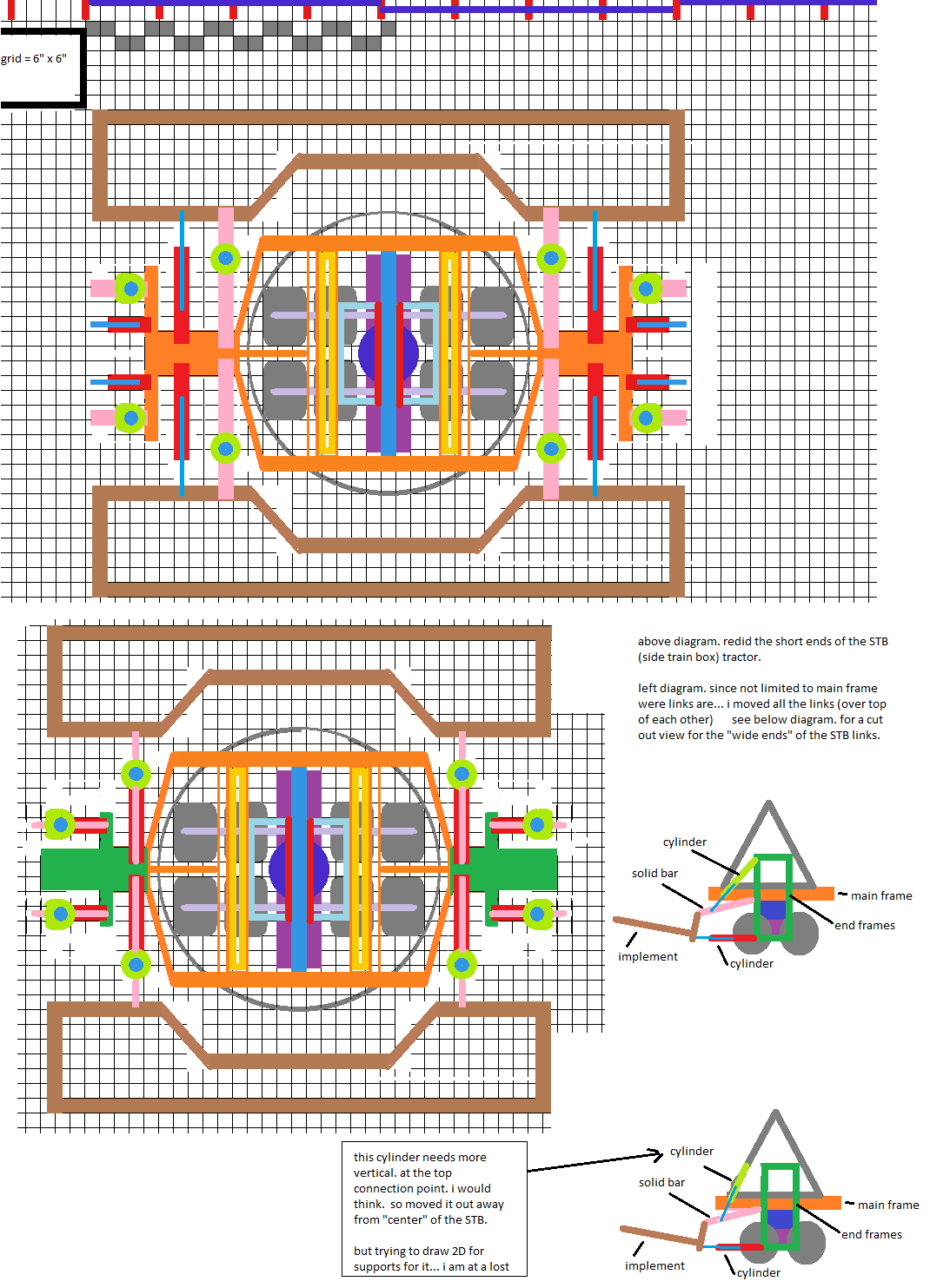

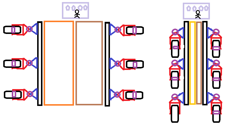

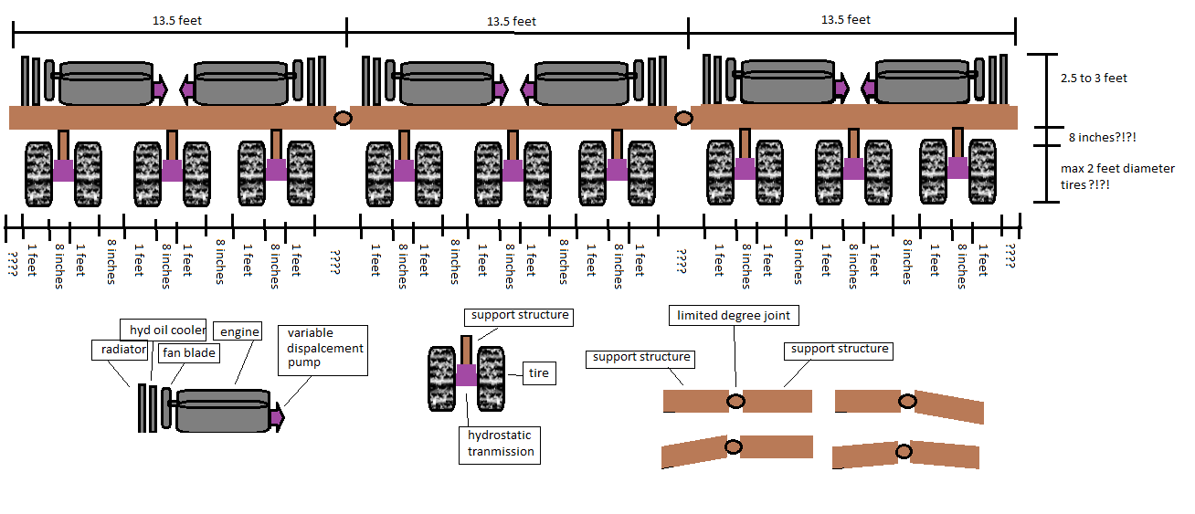

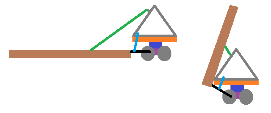

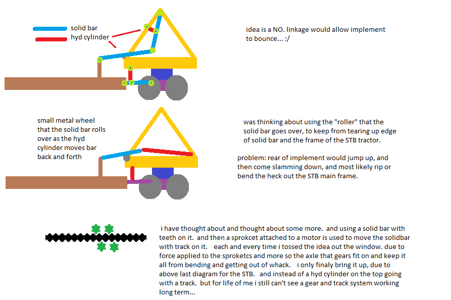

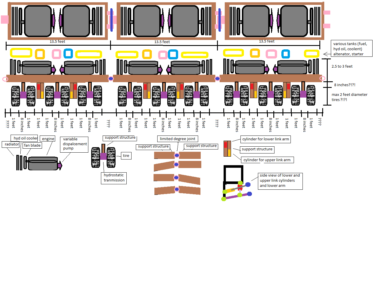

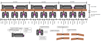

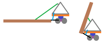

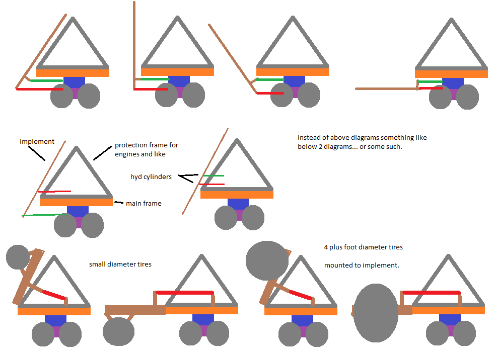

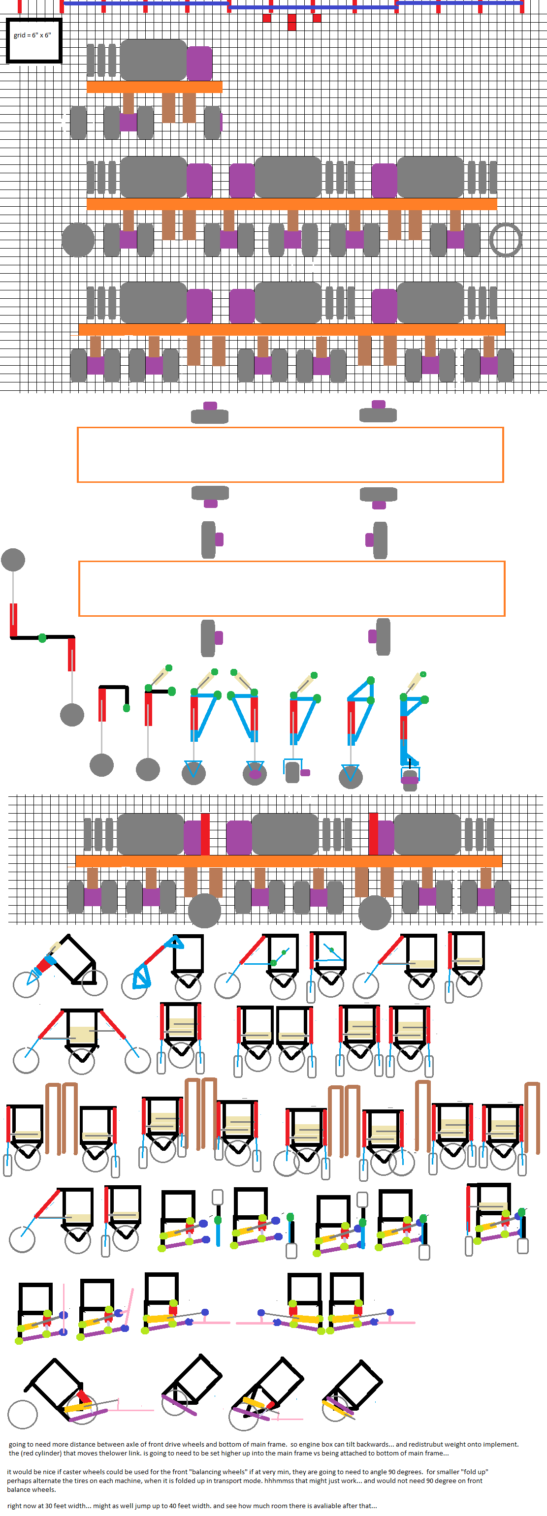

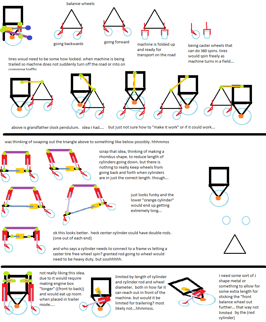

some diagrams for the main frame (spine) of the SSTT
axial engine. don't know. i like idea of the length vs dimensions of width and depth. but not so sure about it. and looking at it, it might offer high torque, at lower RPMs. but unsure about that.
below image is from Axial Vector(TM) Engine Corporation Presents Its First Commercial Product Operating Status
i been iffy about this type of engine. really do not need high RPMS.
below image is from Aircraft Engines Explained and Types of Aviation Engines with References Animations Videos and Pictures
i keep going back the age old regular internal combustion engine.
though i am second guessing placement under the spine / main frame. vs building the engine and hyd pumps into the the spine / main frame. or perhaps placing them above the spine / main frame.
looking at first diagram posted in this post. i am uneasy, trying to place some sort of "mounting" brackets on edges of engines and hyd pumps. without any sort of actual frame under or around the engines and hyd pumps and just relying on the metal of them to act as a structural support. i could see things just tearing apart and just wrecking the SSTT.

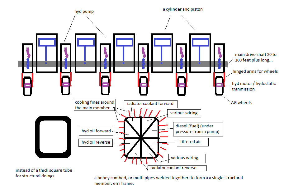

was thinking about running hyd oil lines, coolant lines into the main casted metal shell for the spine. but that does not really work come time to manufacture / creating the casted shell.
thought about splitting the 60 foot section up into "chunks" say 5 to 10 feet long. but that brings me right back to issues of creating places for bolts and just breaking things in half.
i suppose the things could be welded together. to allow for different doings, but...but... hmmmsss trying to get into anything to fix it, once initial welding was done...

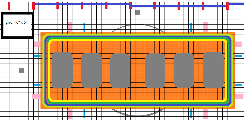

really need to get a grid going, and actually do the math to figure out approx measurements, for tracks, AG/R1 tires, implement linkages, linkages between sections. without know those min/max approx measurements the main frame (spine) for the SSTT is a toss up.

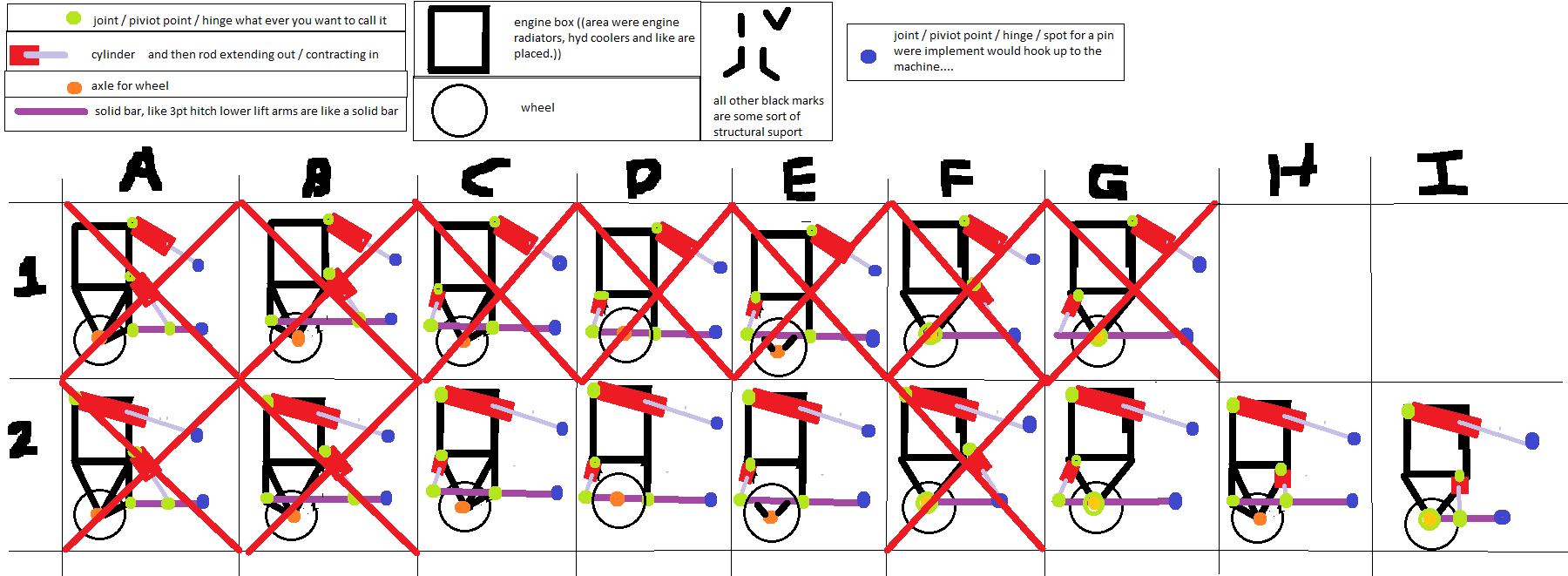

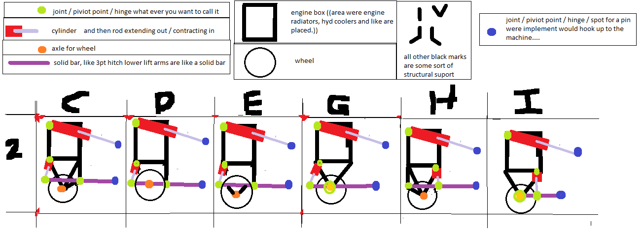

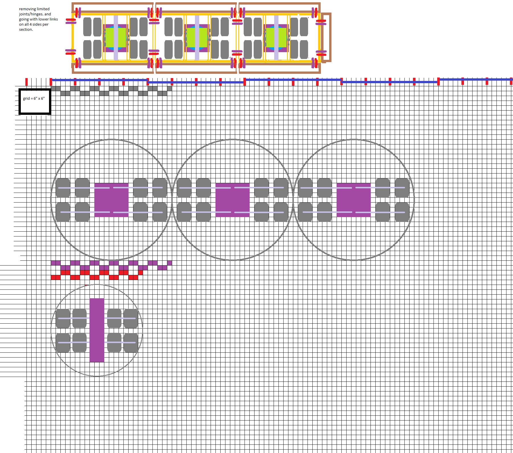

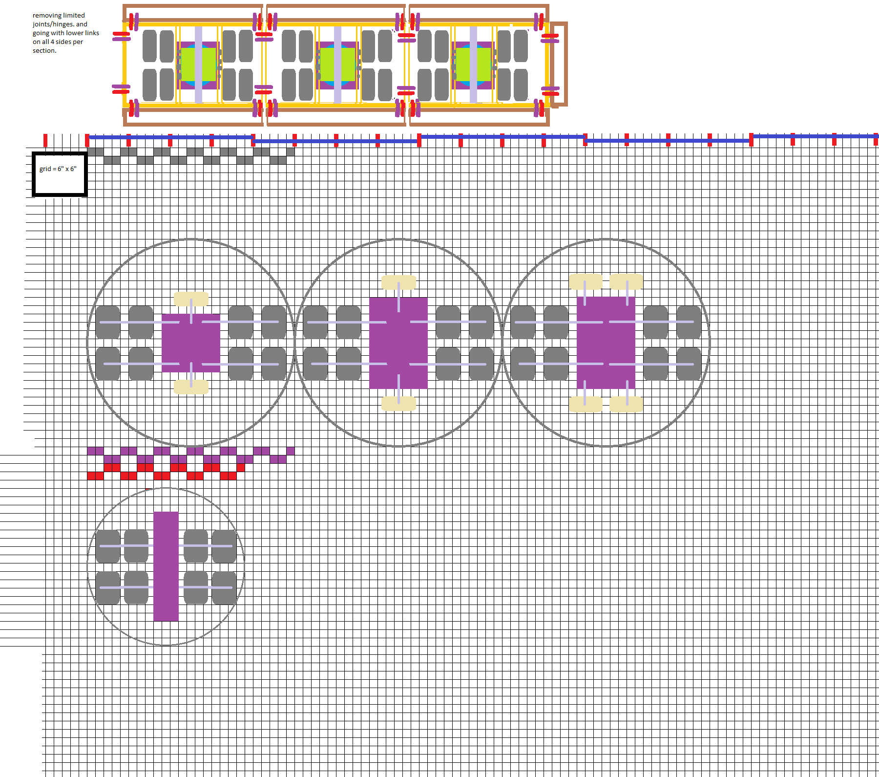

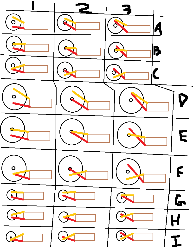

found the lego's got frustrated, hit the shop, and found some small dole rods, got some cigarettes, took the tobacco out of them. and ended up using 2 cigarettes with nothing in them. to act like cylinders. got some twisties (bread ties / garbage ties) and ran them through the filters on the cigarettes and through some lego's (could have been card board).
i got something functional but, how in the world do you go through all the variables. for the "implement linkages"
thinking it might be easier, to create a program, and feed it some variables and constants. and let it go through 1,000 to millions of irritations or more.
--solid bars (set min / max length, with irritating through say 1/16"
--cylinder (set min / max length, with irritating through say 1/16"
--put in a transport tire to act like a blockage
--put in a implement that is say 12 to 14 feet long
--put in physical dimensions from surface up to say 14 to 16 feet
--put in 2', 4', 6' 8' limitations from edge of tire on one side, to edge of tire on other side
--double it up for implement linkages on both sides.
--gravity or like, constant. that causes things to fall. to keep everything down to earth and not free floating.
--give program option of were solid bars / cylinders connect to each other along with on the implement
--give a start / stop (implement folded down and into the dirt say 20 inches, and then folded up in transport mode.)
--add a database into the mix, and if it passes put it into the database.
--be able to select a database set, and reply it in some sort of animation software.
then again perhaps run another heavier set of requirements, with weight involved, and simple cylinder math. and place a time stamp on, "start to finish" between folding / unfolding and then back to folding. (in attempt to narrow things down even further) perhaps setting the max PSI valve feeding cylinders... and diameter of the cylinders as another limitation. along with overall length of cylinders + rods.
--weight would be physical weight of implement. without taking anything else into consideration for weight. keep it simple.
a simple x,y (2D) grid should work.

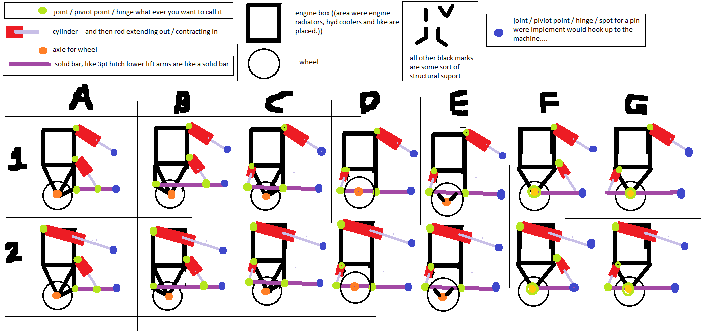

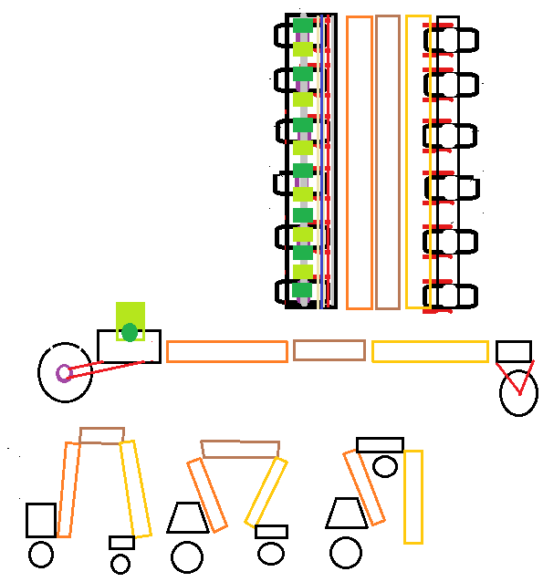

continuing off of last post...
what would be needed to accurately compute things?
---rotation ? or rather degrees of rotation?
---length measurement of course.
---center of each hole (were a pin would go) or rather make that center of the hinge point.
*rubs chin* how do you go back and forth between hyd cylinders....
i suppose loops within loops within loops, or rather, for each cylinder, the computer puts in, a "loop" would be done.
---FOR EACH (X, in Y_cylinders, step Z <= Y_cylinders_max_extending)
-----call function
-----another loop...
-------call function
-------another loop...
the functions. are going to need to go through each extending and contracting of each cylinder in say increments of 1/64" of an inch.
if i keep following this path of thought, it could take a long time for a heavy duty server to go through enough variations to get something back... that could even be useable...
there needs to be a way for computer to "track" lengths of bars / cylinders and were they connect... yikes... feel sorry for database.
--perhaps incrementing a number.
--but still the database would get large. even with using a secondary table. just to hold data for tracking, and another table for things that pass.
there needs to be a way to limit how many "solid bars" and how many "cylinders", and how many points of connections (pins / hinge points) just to reduce and stop a non ending loop...
also there needs to be a way to limit how close (pin / hinge / pivot) point happens to another. or less on same x,y axis plot point.
---solid bars, and then simply Teeing off up off of bar for a cylinder attachment point... (off set amount) yikes..
---i suppose you could limit solid bars extending off of other solid bars via only in perpendicular notation at fixing the point so they do not hinge / pivot.
---then placing some sort of variable / constant by user. of how many perpendicular bars could be done. guessing 3, times, maybe up to 5 times max.
there would need to be limiting boundaries for implement.... so implement side (furthest away from SSTT)) does not bend down, when it is being folded to transport mode. so it does not "tip" the SSTT over
the "box shape" of an implement would not be allowed to go into the transport wheel areas. along with under the transport wheels.
--but linkages (solid bars and cylinders could go through wheels)
--so looking at perhaps a secondary layer per say. for boundary points. i should say collision points.

--rod length ======= this is how far a ROD is extended (beyond the contracting / extending) that is taking into account with cylinder.
--implement connection 1 ======= distance a solid bar can come off the implement for a hinged point
--implement connection 2 ======= second connection point.
--implement connection 1 ======= how far back on implement connection can be
min/max (how many)
--connecting points ======= how many (hinged / pivot / pins) can there be
--cylinders ======= how many cylinders can be used
--straight solid bars ======= how many straight solid bars that there can be.
--off set solid bars ======= how many times a perpendicular solid bar can come off another straight solid bar.
increments for lengths for the next "LOOP" irritation
--solid bars
--cylinders
--rod length
increments +/- for computer to extending or contracting a cylinder during each loop.
x,y plot points
--fixed position x,y plot points ======= hinged / pivot points that solid bars, or cylinders or rods connect to. but points never move ((think of them as points connected directly to frame of the SSTT))
--dynamic position x,y plot points ======= for connection points between cylinders, rods, solid bars. that change based on movement of a hyd cylinder
--4 sets of X,Y plot points. --transport wheels ======= just treat them as a box shape, area were implement can never move into.
--4 sets of X,Y plot points. --transport wheels, (opposite side)
--4 sets of X,Y plot points. physical boundry limits of everything. ======= total height, total width. that anything can move within
--4 sets of X,Y plot points. linkages going below "axles" of tires. ======= exception... once linkages get past out side edge of wheels
--4 sets of X,Y plot points. location of implement when "unfolded" and down on the ground.
--4 sets of X,Y plot points. location of implement when "folded up" and ready for transport down the road.
--4 sets of X,Y plot points, that linkages (solid bars, cylinders, rods,) need to be within, when implement is fully folded up ready for transport mode.
--4 sets of X,Y plot points. dimensions of implement. ((assume top X,Y points = top frame of an implement))
boundary laws / conditions
--implement can never go into area of were wheels are.
--implements can never go past the physical over all boundaries (max/min height, min/max width)
--same goes for solid bars and cylinders.
--no solid bars, or cylinders can extend into an implement but may attach to implement
--no solid bars or cylinders, can extend below wheel axles with exception of being past outside edge of wheels.
--no solid bars or cylinders, can have fixed connection point (think connection point to frame of SSTT) below wheel axles.
pass/fail laws / conditions.
--an implement must fully fold and unfold, then fold backup again, then unfold one more time. without changing anything beyond extending / contracting cylinders.
--folding/unfolding all boundary laws/ conditions are taken into account.
pass/fail database
--record lengths, and X,Y plot points. for each solid bar, off set perpendicular bar, cylinder, rod. fixed connection points. and implement connection points.
--if it fails, nothing gets recorded to database.
saving/pausing/stopping/resume/loading program database
--just holds incremental numbers of everything? every time or perhaps after so many irritations. database records get updated?
--on resume, inserting code to load a specific setup of X,Y coordinates, and lengths, etc... for preset doings someone came up with?
posting before i loose stuff.
/ new tractor idea possibly....
#170
what other ways can be used to reduce the length of a full non stop run of the program from start to finish.
increments for x,y coordinates, for distance fixed points (left to right) ((think connection points to frame of SSTT))
increments for x,y coordinates, for distance fixed points (up to down) ((think connection points to frame of SSTT))
the program does not need any sort of GUI (graphical user interface) perhaps simple command line? or text file command line feed. then use a secondary program. to pull "passes" from database and display and animate if need be.
without getting physical size / dimensions, stresses, etc.. of metal involved. that i would imagine take a good chunk of time to compute. when ever something passes. perhaps running a second program on database, that takes into account the extras. speeding up the initial run. but at cost of a large database?
i think, even trying to add "weight" and cylinder diameter, and like, on each pass, would considerably slow things down.
other words to above, there are going to be certain length ranges of solid bars to cylinders that things pass. and these ranges... will fill the database up quickly. till lengths get passed a certain point and things begin to Fail.
thinking running a quick very limited function program, and then having the secondary program. check the database to run a more complex thing. and in this secondary program. if something passes, add the info to another database, or delete record in the one database, or tagging the record with "fail"
*rubs chin* don't remember name of it, but it was a command line graphic editing routines. with ability to make simple 2D ".gif" animated pictures.
*rubs chin* animation... is what will be happening, but need to get my mind around, the physical "stepping" through each loop. to physically extend or contract a cylinder and have everything else. move with it. i guess it might resemble clay animation. well hhmmss...
start from "fixed" coordinates, and move first cylinder, then that x,y on end of rod, then need to decided on path. if 3 or more things pivot/hinge/rotate from a single x,y plot point...
i guess, i would rotate things around, a X,Y point. and then, rotate the next thing it connects to and were the 2 circumferences of each rotating piece meet. do a check vs last 2 moves. for path of direction of movement?
aaaaa.... getting over my head already. i guess i need to go a hunting, for physics for animation, and pathing tutorials. i do not think any of the 10 plus year books have anything in them. remotely of what would be needed.
