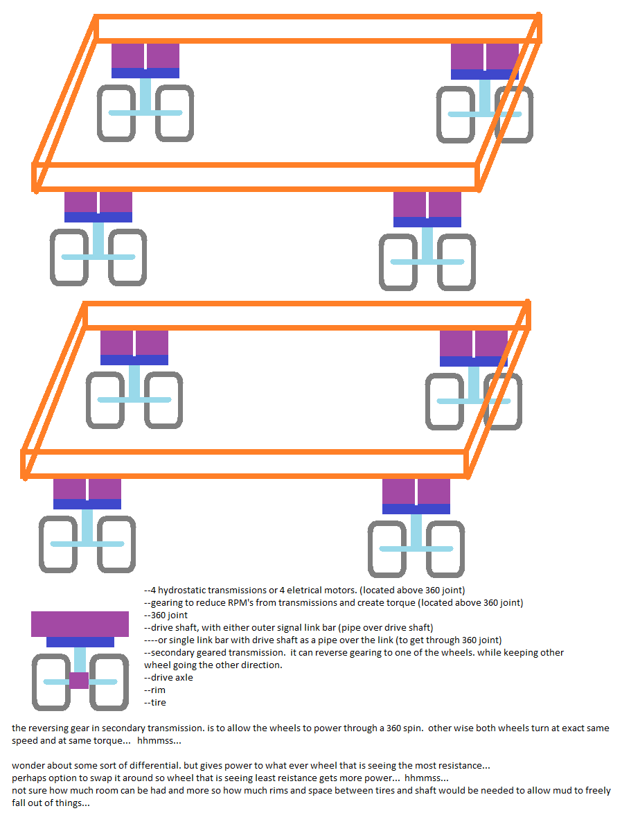

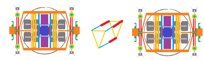

been battling with autodesk for last couple days. and not really much to show for it.
been trying to find the groove per say. of working through things and thinking a few steps ahead, in how to draw something up. and finding some things do and do not work so well. resulting in restarting from scratch a few times. the constraints of autodesk is the big one, and then dimensions linked to constraints. just makes things into garbage after so many edits.... do not pull a dimension off before changing another value and i end up with foo bar...
below is finally something that did not result in geometry not looking like a rag dog, after the puppies had it for a few minutes...
diagram created with autodesk inventor student edition.
dual transport wheels
---tire and rim lip (if you could even call it that, (quick and dirty))
---inner rim, with magnets on it. for an electrical motor. (have not figured out how to do elliptical or wavy "coils" of wire just yet) and hopefully some room for some brakes
---T shape support structure.
---axle though at moment showing as a single axle vs 2 half axles. not really sure how much room an electrical motor will take up. and it may come down to placing motor in one wheel, and brakes in the other wheel.

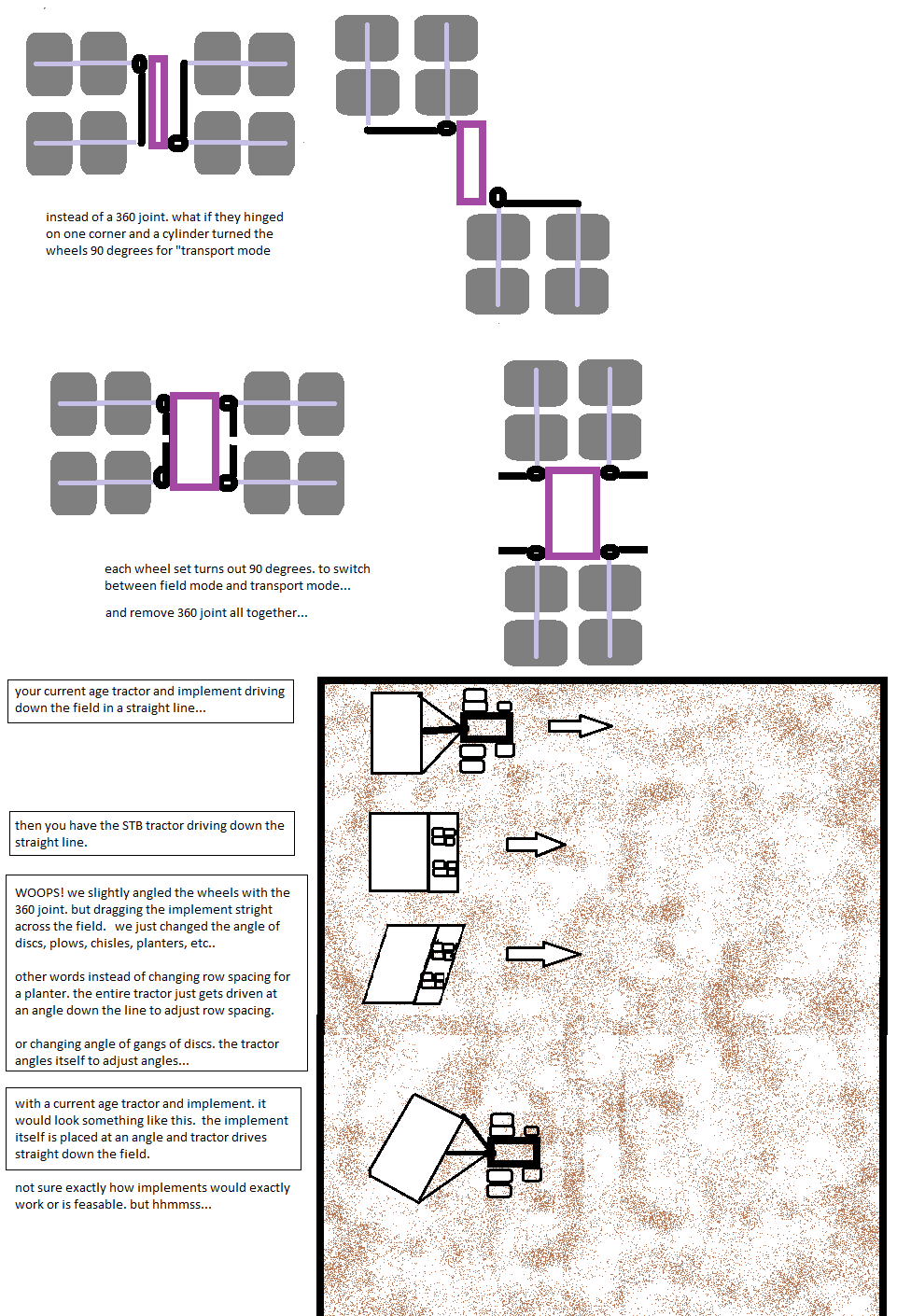

/ new tractor idea possibly.... #204
Looks like you are making good progress. Inventor and other solid modeling software has a big learning curve. Hang in there!

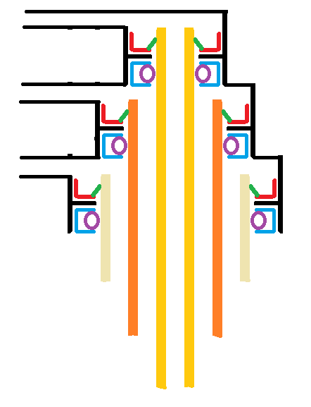

getting electrical wires through the 360 joint...
up to this point, been thinking about having electrical wires, run up through the very center of the 360 joint, but i think, i am going to switch that over to a "pancake" design. vs joystick up to this point. just need something with better long lasting brushes or multi brush setup. for U-ring shaped metal contacts... cost will be higher for pancake vs joystick design. but may give me those few 1/8 of an inch that might be needed.
back to inventor. to see what happens...
below quick and dirty. of reducing seals / bearings down to 3 to deal with coolant and compressed air.

:/ need to come up with a better way to pancake the electrical wires, going through the 360 joint.
perhaps a U channel, and then an upside down U channel of copper or like. and let them rub against each other. with some springs located every so often around the U channel circle.
perhaps do something like various oil seals and like do. and form a single flat bar wrapped around a circle. with a spring on one side. to cause the circle of metal to want to get tighter around the center. and then do anther flat bar and spring. but this time put a spring to cause the flat bar to want to get "larger" in diameter. that actually might work.
problem is. man, that metal bar might get rather heavy, and rather thick... to handle the AMP's and/or Volts going through it. hhmmsss *light bulb*

Does the 360 joint have a home position? If so then I would just us a cable. Wipers, etc get very complicated and have reliability issues.

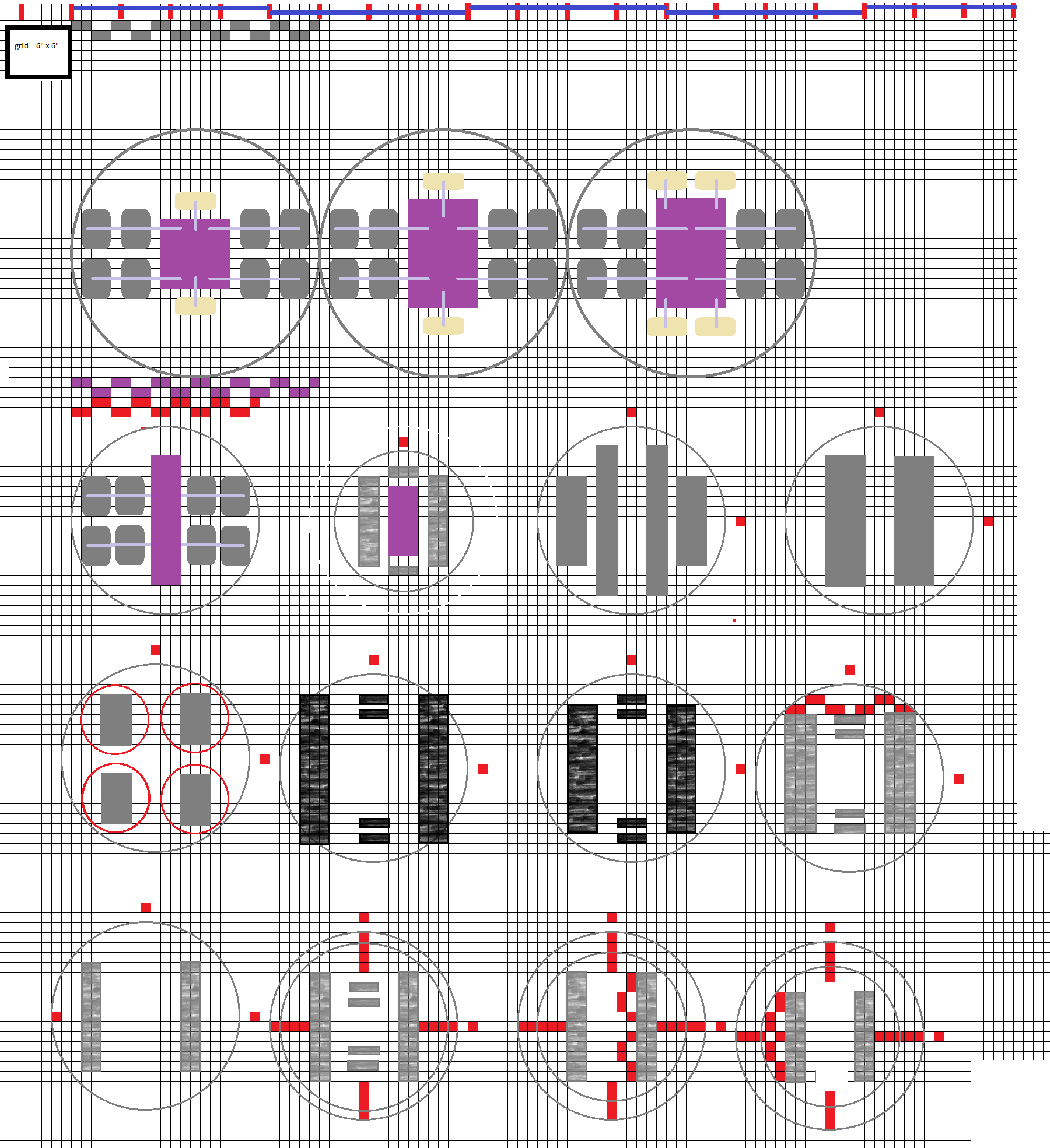

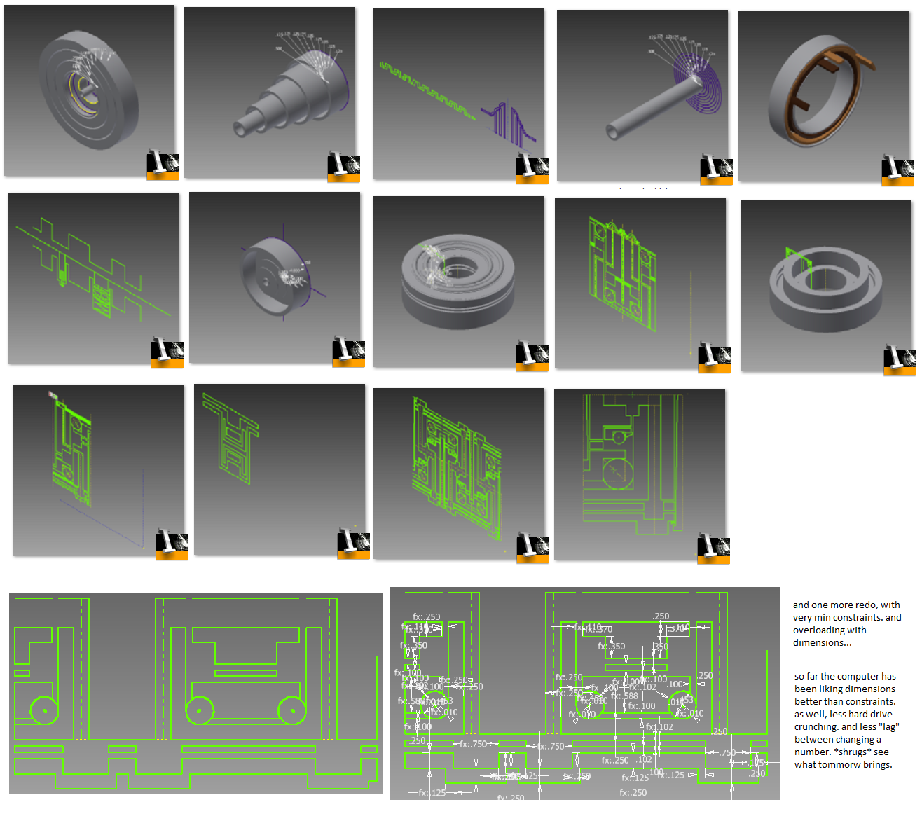

the 360 joint has taken a life of its own....
after getting fed up with constraints. i backed down, to just using parallel and perpendicular restraints. and using variable names, as dimensions are entered. slow going, but so far AWE! *looks relieved* less head aches...
was not really liking how far the last diagram in post 206, was poking up into the air. above the 360 joint. little bit different design. with 6 channels of bearings, and 6 seals. but looking much better and possibly a little bit more compact. still working on the new design with 2 Fluids (1 inlet / 1 outlet) and 1 compressed air.
various random diagrams. as i attempt to learn autodesk, and get something done for the 360 joint.

Nice drawings! Yes that looks like "wipers" or brushes. I would seriously avoid using them unless absolutely necessary. I think a cable will be much more reliable and robust out in the mud... just my 2 cents. :2cents::2cents:

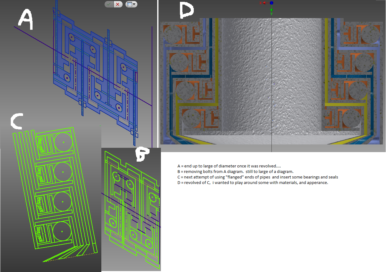

16 to 20 hours shot.... on that idea. awe well.... time to try again on a different fluid / air going through 360 joint.
problem, to large of of overall diameter once done. it gave me a few ideas...
starting to get the hang of things better.
scissors like a scissor lift might use is no good. forgot all about. how scissors change sizes as the extend up and down. was more hoping for "fixed" points. and avoid and sort of track setup.

getting a tad aggravated, every time i get close to finishing something up, autodesk inventor crashes, or causes computer to lock up tight.
it took me a while, with autodesk to figure out how to create dimensions at an angle vs horizontal or vertical. as soon as i did it, i accidentally grabbed a hold of one of the dots and dragged a few things out of proportion. so was like COOL! so i started to draw up some lines for linkages for transport wheels, to get a better view point of how things would happen. after first couple diagrams. it turned into a "hang man" game. not joking! couple of the diagrams, when moving, looks like someone hanging upside down, with there feet tucked in, and doing sit-ups.
