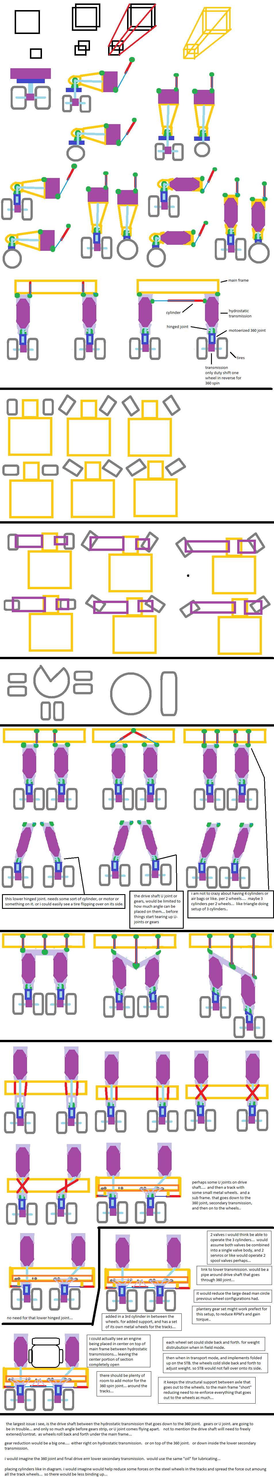

#223
i am still not happy with transport wheels raise and lowering of them.
i set my limits of....
---3 feet total rise and lower
---1 foot to lift everything up off the ground during transport mode. so there is enough clearance under neath everything, to get over steeper sudden changes in hills and bumps that come along.
---middle 1 foot, normal operational range in field mode.
---1 foot upper limit. to deal with adjustments side to side to deal with weight adjustments, and perhaps getting out of muddy situations.
---6 feet total height though would like to see 5 feet total height, counting wheel hights to top height point that sticks up.
---2 inches of clearance around transport wheels regardless at what rotation they are at. along with 2 inches above them.
---8 to 10 inches above the 2 inch clearance to deal with 360 joint or what ever may need to be directly located above transport wheels.
---8 feet total width
---each side is set back 2 feet to allow for implements to be folded up onto the sstt (sideways snake train tractor), and implements basically rest right on top of the transport wheels, when in transport mode.
some more hangman games for linkages. played around with more than what is shown for linkages to reduce hyd cylinder length, nothing that could work, could fit within the limits noted above....
redo of lower frame that connects wheel sets. to have "wheel wells" to help gain some extra space. though the C and T or I beam. gave up before finishing up. just not seeing it happen.

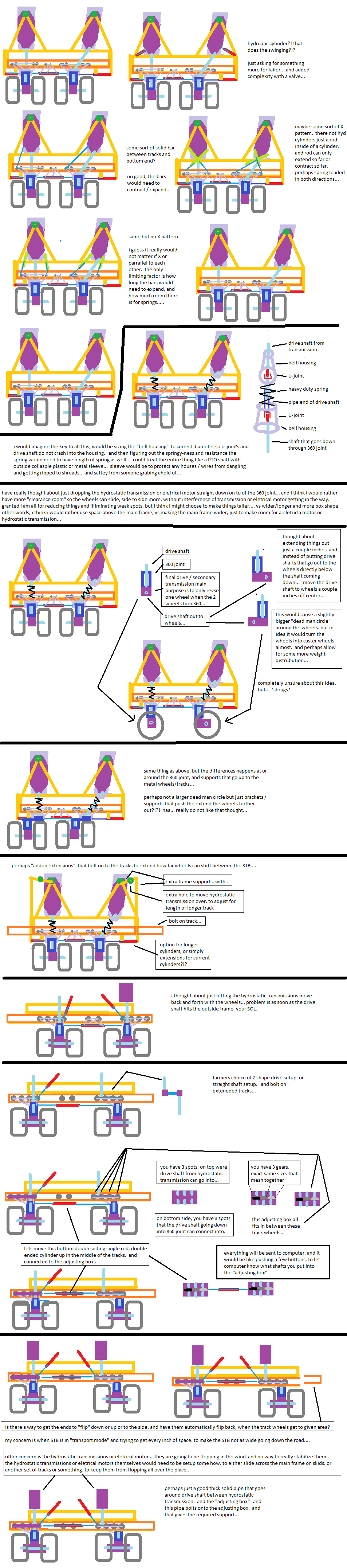

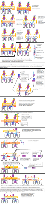

#224
another few more games of hang man game but with 4' foot diameter AG / R1 tire.
below version. i kinda like. i am able to use a solid bar link between the U shape track, and axle of wheel, and then a hyd cylinder to swing tire out some. the the U shape track. seems to be pretty nice. but how to put power to the track. to move say a 12" inch wide back and forth on the track is a problem in itself.
==pro the 1 cylinder going down to the tire axle. only needs to extend about 6 to 8 inches. and rest of it could be frame. longer the cylinder is placed, the better off in dealing with mud and ruts and allowing tire to sink further down vs rest of the tires on the SSTT.
below diagram. uses 2 hyd cylinder, and between the 2 cylinders, a pipe inside of another pipe, to act like a guide. gives a few more inches of clearance. overall this clearance might be extremely nice long term. to being able to raise and lower the tire and down to the ground. without having to place the physical main frame (spine) of the SSTT higher above the AG / R1 tire.
===both cylinders need to extend about 14inches.
scissors linkages. i am actually interested in. they look like they could actually work. vs transport wheel usage. it would still require 2 hyd cylinders. but would allow some extra reach perhaps.
i would still like to do some rotation of the 4' diameter AG / R1 tires. maybe 10 degrees in each direction, perhaps more if possible. the AG tire does not need to do 360 degree rotation, nor 90 degree rotation, just a few degrees. i think would really help long term to some ugly situations. example driving across a hill or up or down a hill at an angle. in order to go straight across the hill without slipping back down the hill. to making some odd ball twists and turns in fields, (around run a ways (grassy areas to deal with run off water and erosion) to field edges that are not nice and straight clear down the field but have some curvature to them.
the problem is the complexity of AG wheels turning just a few degree even. is going to be out of most novice or intermediate operators i would imagine.
brain storming, i might see having tires rotate a couple degrees might make it easier to backup and re-arrange things if you mis-judge distance, or GPS is off, or perhaps GPS is correct but you end up sliding some down a hill knocking the GPS statement of when to exactly turn and how much off is thrown off some from simple sliding down the hill some.
hhmmmsss *light bulb shines* goes off to autodesk inventor.

#225
not much done this weekend. i tried a few other setups. to slightly rotate the 4 foot diameter AG / R1 tires. and gave up on the ideas fairly quickly before finishing things out. just could not see anything happening with the ideas as i started seeing things started to form up.
below is what i am currently thinking about for AG / R1 tires.
--2 hyd cylinders
--1 central pipe inside of a pipe. (((special note))) in order to keep things flopping the pipe connecting to lower axle. does not have a pivot point. but just bolts / welded directly to the lower frame. playing hang man game. seems to work this out fairly well for distances and constraints placed on things.
EDIT: just caught when assembling things, i put one of the tires on backwards. so tread for both tire is not in same direction. perhaps this might actually be wanted now that i think about it. if same type of implements are hooked up on both sides of the SSTT at the same time. to make cornering in fields quicker, for say plows, or discs, or like. then again, perhaps a different tread pattern might be better suggested for SSTT when all said and done. vs a typical tire tread for a current age tractor.

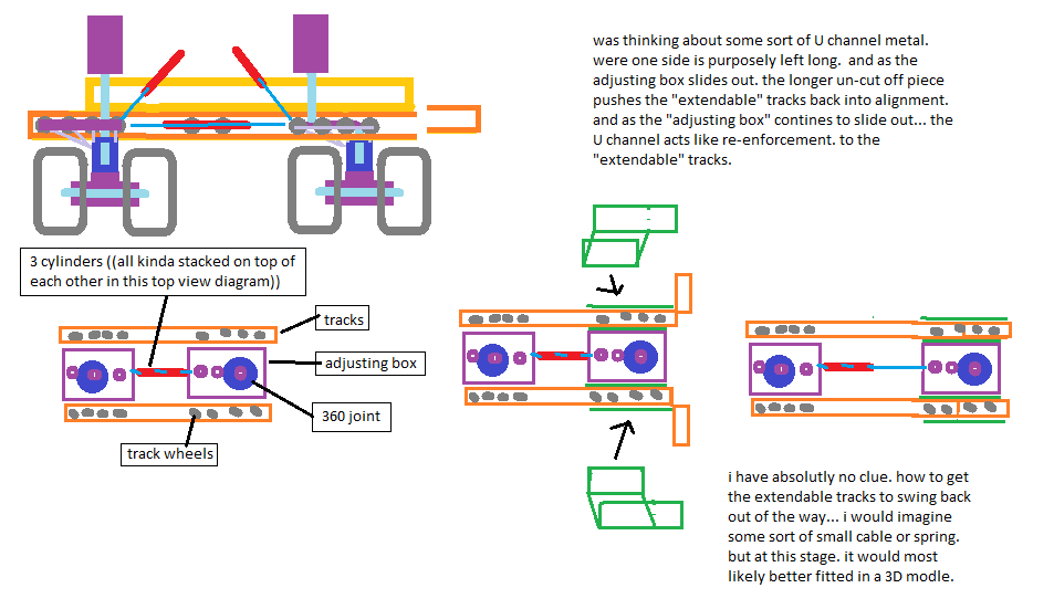

#231
playing "hangman" again, but for tracks this time.
i think it would be easy enough to add a "triangle" track setup...
but problem is limited to about 4 foot long. just not enough space to squeeze anything longer in between implements located on both sides of the SSTT.
so i thought about adding some extra wheels / rollers, so the track could be "folded" up and at all times keep the tension placed on the track. so it would not fall out of alignment with sprockets and groves that the track ran on. that idea lasted long enough for me to get frustrated trying to draw something up. and trying to find space that was not there to begin with.
then thought about 2 tracks approx 3 feet long for total of 6 feet. i am hoping i can find enough room. for this. were i can "flop" each individual track upside down to keep everything inline. when driving in one direction. and then do another flop, to allow tracks to be driven in opposite direction. and keeping the tension pulley/wheel/roller going in correct direction vs driving/powered sprocket/wheel. or at very least. i could state track adjust to ground slope. and allow for weight distribution.

#232
been chasing my tail for most part of today.
going to need to go through "pathing" tutorials for setting tracks or chains on sprockets. tried on my own but never did get it figured out quickly enough.
went for 4 sets of tracks. thinking i might be able to pull it all off. but before tracks even got applied over the wheels. i am looking at "transport wheels" without the tracks on them and no 360 joint.
after a few days, since transport wheels. i am a tad lost on dimensions of what i am limited to. i think i am going to tackle a generic main frame for the entire SSTT. and begin attaching wheels / tracks / implement linkages. and do a little fine tuning on actual dimension of things.

#237
Medusa head for toothed rod. ok maybe that would be expensive to actually make. perhaps, going with something like a PTO shaft end, that sticks out the rear of tractors. vs a wave of arcs. hhmmsss that could work.
/ new tractor idea possibly....
#238
*rubs chin* my mind is getting a tad foggy, if a planetary gear setup vs reduction gear could work. way to much math for my brain to handle at moment. let alone finding the math. for basic generic calculations.
for the toothed bar, i don't know yet. looks way to complex still. along with needing to get oil or grease or lubrication in between the bar and the track it goes into.
part of wanting to see if planetary gear would work. is another attempt to reduce overall height the 360 joint takes up. though looking at things. not sure if it would be needed, i may still go with reduction gears as now, but possibly add a couple ring gears into the mix. na.... will just beef the living daylights out of things if need be.

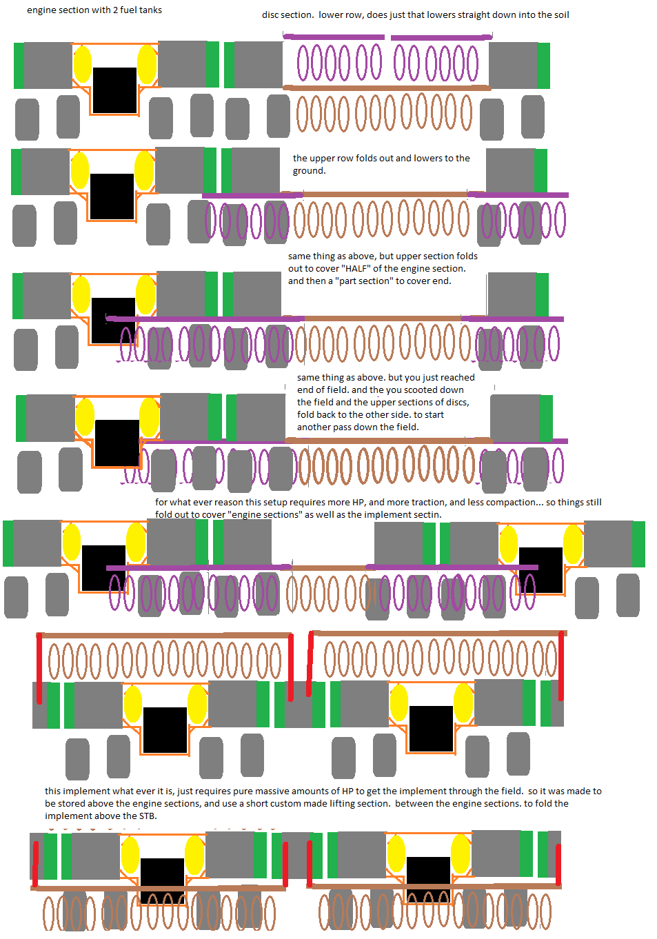

YA! finally got into doctor today, and get some injections, to deal with some muscle nerve issues. hopefully my mind will be speeding down the field once again at full throttle. vs trying to figure out what 2 plus 2 equals.
back to the transport wheels.... at one time i thought i would be able to make it so there would be 4 wheels (2 lefts, 2 rights) would have there own set of raising lowering cylinders, and own cylinder for 360 joint to rotate it. but space is simply not there, without adding an extra 8 to 12 inches. and if i add the extra space, and transport wheels sink up to the axle other parts would be dragging and digging in as well, and just be one ugly stuck mess trying to get the SSTT (sideways snake train tractor) out of the mud.
but now it is look like....
2 front left
2 from right
2 rear left
2 rear right
total of 8 tires. will have 4 hyd cylinders to raise and lower them to the ground. and then i am not sure if i am going to stick with a single hyd cylinder or go with 2 hyd cylinders to rotate the 360 joint.
i have room to enlarge the reduction gears. and i might be able to either run a shaft between left side 360 joints and another shaft on right side 360 joints. problem is... keeping everything as low profile as possible.
WAIT a min....
that might work better, a hyd cylinder on left side 360 and a hyd cylinder on right side 360 joints. and keep all the ugly shafts from going from left to right side and vice vs....
hhmmsss THE PROBLEM.... needing adjust wheels for row / crop. doings. GGGRRRR. i guess go back at it and see what i can come with vs, shorting the idea out, vs seeing if it is even possibly by rough set of numbers.
on a different note, been going over...
hyd pumps. a good portion of the yesterday, was re-inventing the wheel. and trying generic stuff out in autodesk inventor, ya it may seem pretty pointless, but it was a learning experence, and helped me clarify, what would and would not work. and portion of today, was re-looking back at video's on youtube.
i am down to axial and radial type of hyd motors.
the one big issue has been, using up space, as in the replacing the rim of a tire with a hyd motor. looking over on Please wait while we redirect... website. all the hyd motors are foot ball size. give or take a few inches in any direction.
also the piston sizes or rather cubic inch of displacement and GPM and RPM, and PSI
the RPM's for transport wheels are a bigger issue compared to field only mode large 4 foot diameter AG/R1 tires, and tracks for in field mode. transport tires need the low RPM's while in field mode, then high RPM's when in transport mode going 25 to 40 MPH down the road. and honestly been looking at 65MPH down the road. why not at this point. no were near a point of being able to narrow things down.
gearing is an issue.
---thought about instead of gearing, put in 2 circles of pistons in a axial hyd pump, the smaller ring, fewer piston circle = higher RPMs or MPH, and then the larger ring with more pistons, = slower speeds and more torque. and then dropping a 1 to 3 speed transmission / gear setup.
---for radial hyd motors putting in 2 rows one with larger pistons and another row beside it with smaller pistons. and same as above, smaller pistons = for higher RPMs / MPH, and larger pistons for slower speeds and more torque.
----i have thought about setting up 2 rows of pistons of same size for both axial or radial hyd motors, and instead of running all the pistons in parallel all the time which would give a lower RPM and high torque, i thought about running every other one or 2 or 3 in series, and en essence change gears for higher RPM's other words, i would be changing a 4" diameter bore hyd cylinder 3" inches long. to a 1" diameter bore hyd cylinder 24 inches long. ((how ever that math works out, to lazy to open up spread sheet and do the math for this example)) by simply changing the pattern of were hyd flows in/out of each piston.
----i have also thought about just beefing up the metal, of everything. so i can just push more GPM of hyd oil through a hyd motor. to get the RPM's that would be wanted. that in itself, i don't know about this idea, due to higher GPM that get pushed through the hyd motor, the more friction loss that is created. and efficiency begins going down, along with more heat that gets produced. more GPM = larger size hyd hoses and pipes. larger hoses = smaller bend radius of hoses before causing problems with the hoses, and there will be enough hoses, that bend radius could be a big problem. and then with heat, = more hyd oil cooling that would be needed and efficiency just keeps going down across the entire SSTT. i could raise hyd pressure from 3000PSI up to say 5000PSI, but for now trying stay with 3000PSI hyd oil pressure. larger diameter hyd hoses cost $$$ more. not talking 1/2" or 3/4" but more likely 1" to 2" in order to keep friction loss down to an acceptable level.
actual regular gears like in a transmission. i have been thinking about them. from planetary to spur gears. and different arrangements. and at moment, i keep jumping away from gears. good portion is, because, i do know know / comprehend, the math that is needed to be known. for gears. and to keep gears from stripping teeth and like. but other is, physical space that is there, to place gears. i need room for a hyd motor, brake, gearing, and have room to place in each rim of 2 wheels, and then a short 4 to 8 inch width between the 2 wheels. plus need to route some wires for sensors and hyd oil itself. plus an air line for brakes. possibly an another air line, to supply air pressure to shift between gears. then gear oil or hyd oil, to everything. if hyd oil. do i run another small little hyd pump and pump fluid back and forth between each axle or install or other.... those higher end MPHs are going to be creating some heat in them transport tires, when sstt is in transport mode going down the road.
that last paragraph in itself is overwhelming me at moment.
