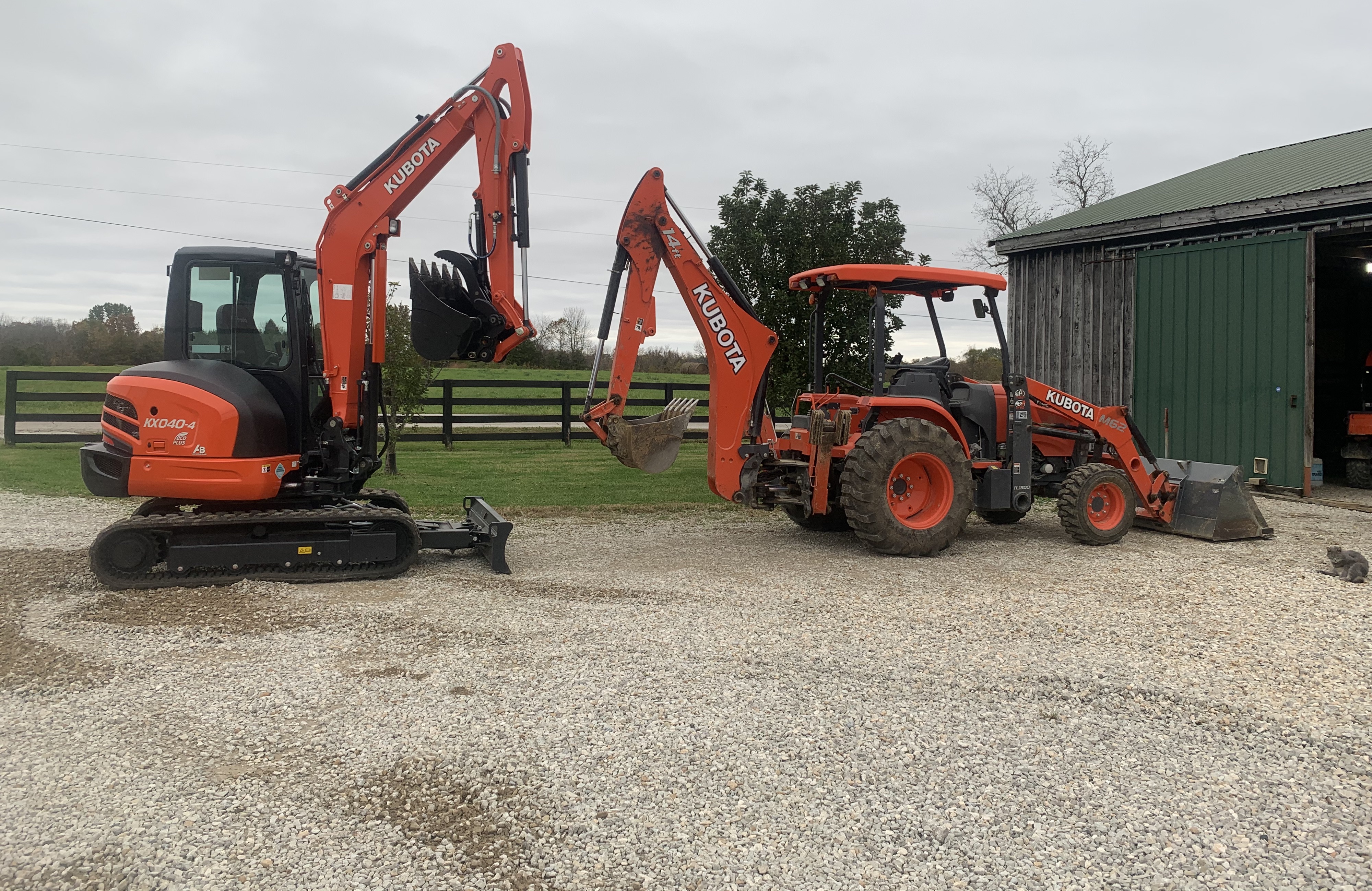

It may be a complete replacement for the M62, I'll wait and see. But I'm wanting an M6111.
Its seems great for what it does. I'll do mostly sewer and water lines with it, and need to use a lot of gravel, so I have a smooth 48" bucket coming. Quick attach will allow for quick switching. I've ran plenty of excavators over the last 32 years of plumbing but have always owned a backhoe because of gravel. New house are getting tighter and tighter so space is becoming an issue. I think it will do a great job.

Man... that is a sweet beast. I drooled over one of those when I bought my KX 71. Congrats !!!

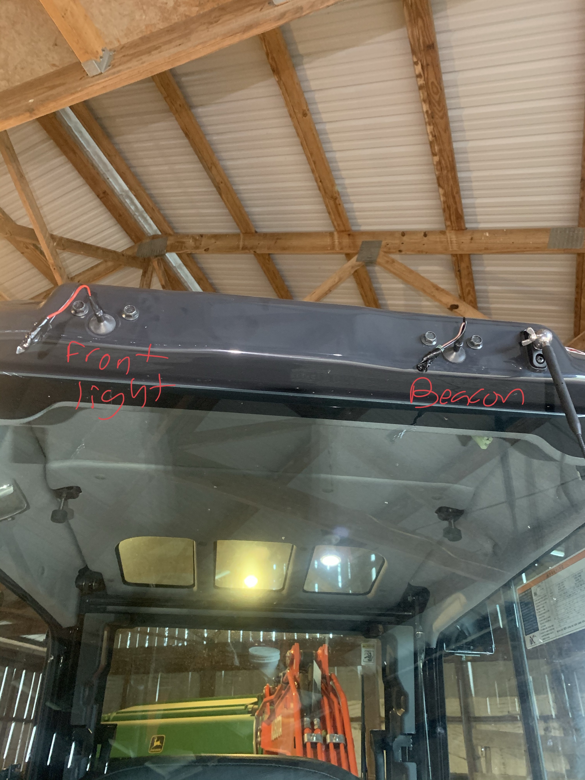

So there is a beacon light switch. Does anyone know where the wire is? I could wire up a reverse led work light.
/ New tool. Mini ex.
Found the wires for rear light and beacon light. They are located behind the passenger side speaker. 2 sets with grommets already on, actually the beacon wires are connected to the grommet closest to the radio antenna. The brown wire is controlled by the beacon switch, and the red is powered with the front lights.
