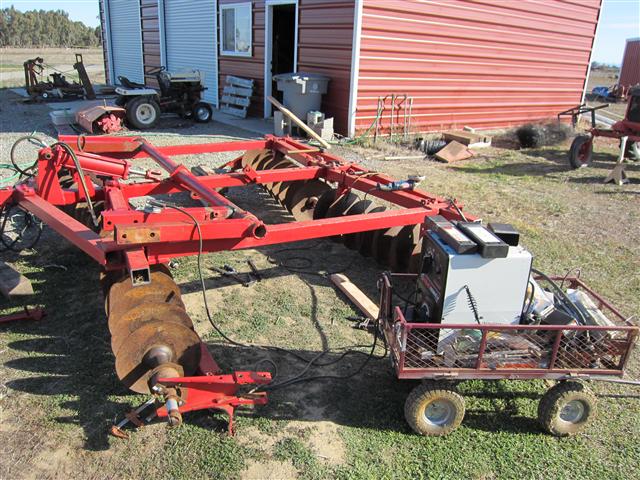

Best tool for welding--4-1/2 inch angle grinder (Makita is what I use)
Rods--6011, 7014, 7018, 7024 in 1/8" size
Helmet--autodarkening type. Mine is a $50 unit from Northern Tool.
Wel-Bilt Auto-Darkening Welding Helmet | Welding Helmets | Northern Tool + Equipment
Never been flashed with this helmet
I also wear motorcycle-type goggles (UV400 rated) under the helmet to keep reflected ultraviolet light out of my eyes.
[ame]http://www.amazon.com/Adventure-Foldable-Goggles-Yellow-Lenses/dp/B001GPL836/ref=sr_1_11?ie=UTF8&qid=1326550292&sr=8-11[/ame]
Good welding jacket, gloves and hood.
50-ft extension cord for the welder
Welding cart to carry the welder (I use a cart from Tractor Supply)
Good luck
