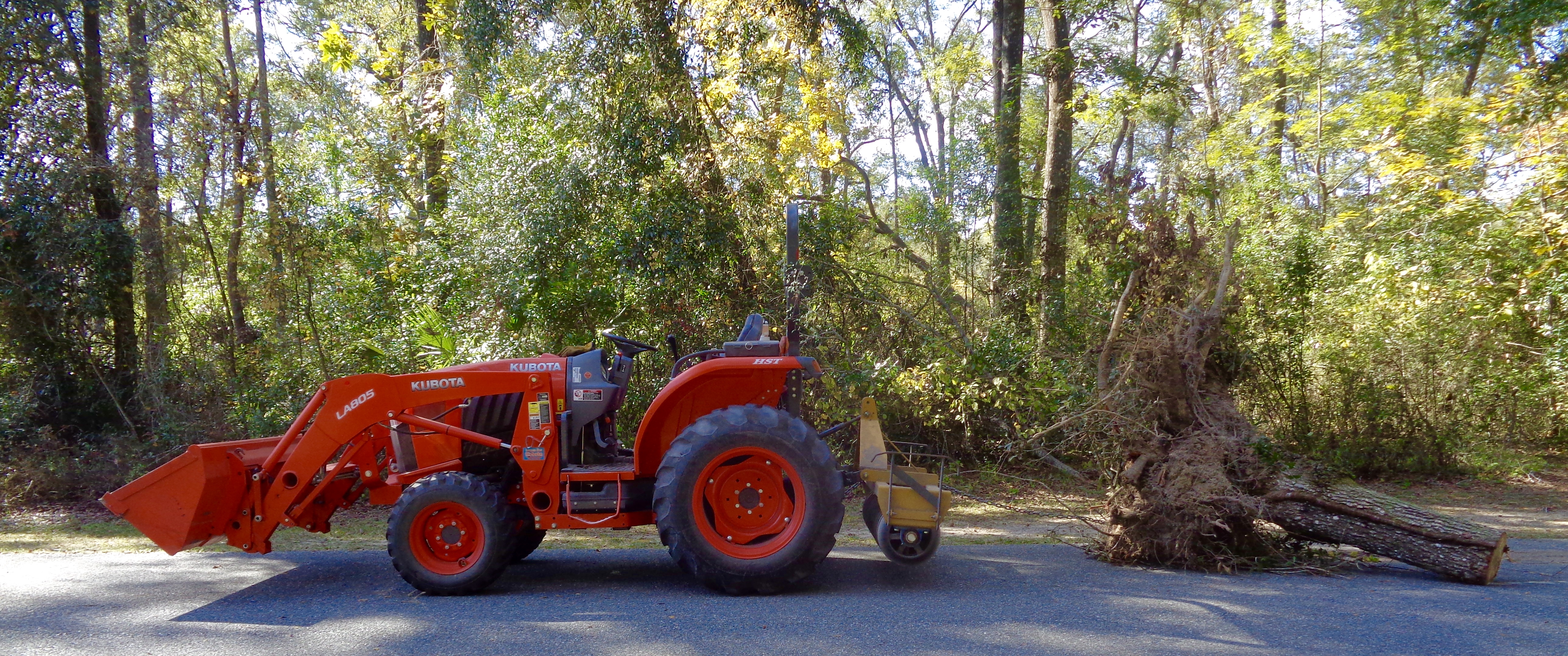

I pulled a fair size stump to our burn pit today with my 3,500 pound (bare tractor)/ 5,400 pounds operating weight, Kubota L3560. Photo from today. Hurricane Irma debris.
