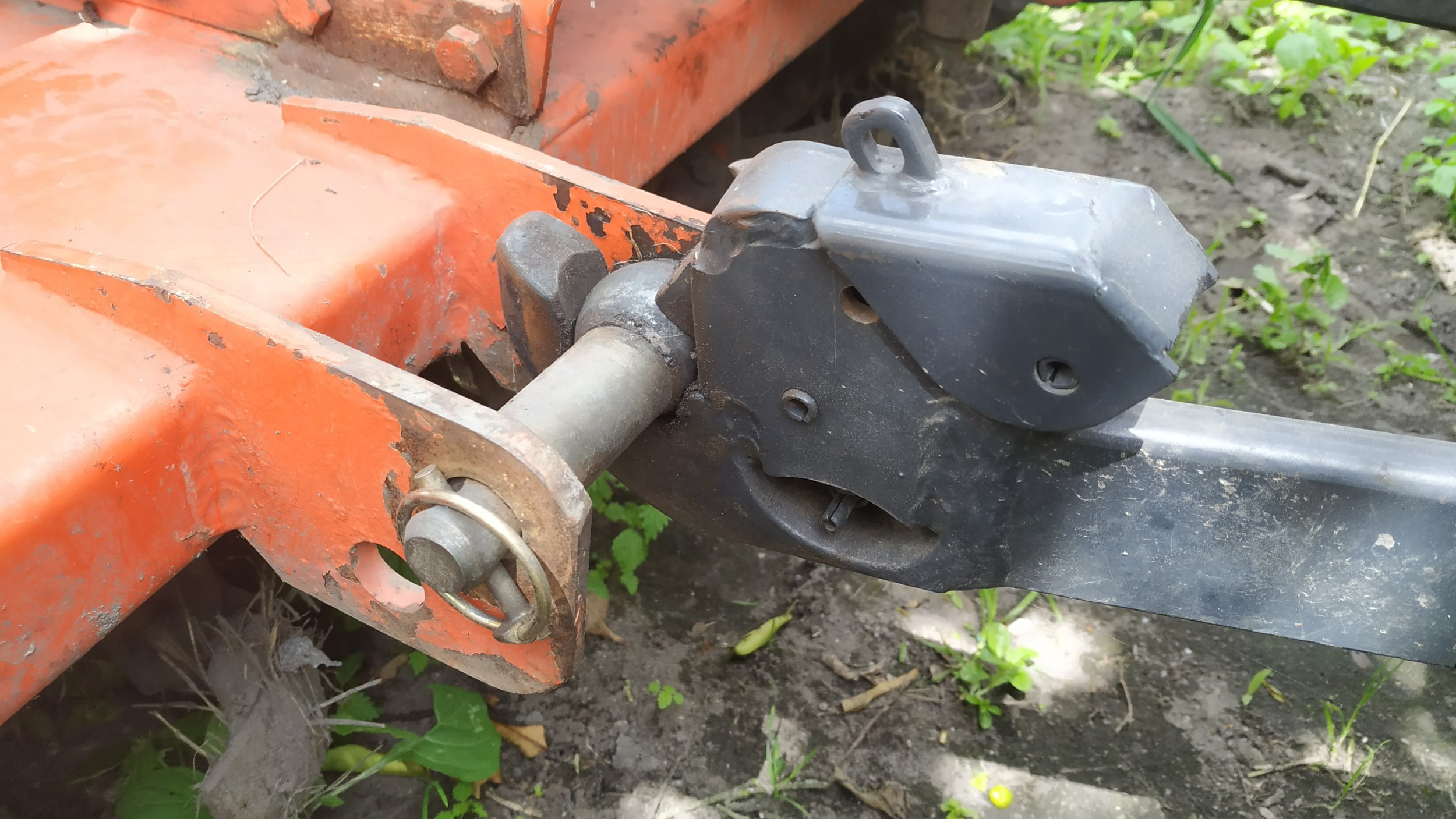

An issue I haven't seen in this thread: sway chains that go from the outer ends of the axles to the ends of the arms are easy to swing aside, to put the arm sockets onto an implement's pins. In contrast sway chains that start at the center rear of the tractor must be unhooked to swing the arms outward. This is difficult on a compact tractor with limited space back there. So adapting an implement to fit a QH is more worthwhile when this is the case.
I had an old back blade I never used because hooking it up was a PIA. It was incompatible with QH because the QH hooks couldn't slide under its pins.
So I added new 3-point pins farther forward on the back blade. Here's my thread describing the project. I enjoy design/fabricate/welding projects like this.
A photo from that thread. (And the inner-side sway chains are in the photo). Now I can just back into the implement, lift, go.
20210412_170450rdetailweldbackblade-jpg.699998
Good solution.
When I installed the Pat’s QA I also changed to telescopic/pin sway arms. Can easily adjust hooks to the perfect side to side position.
Had homemade pat’s type hooks with turnbuckle style sway control and used an temporary adjustable bar for width. Didn’t work very well and bent the width bar several times.
Enjoying the telescopic sway arms as much as the Pat’s.
