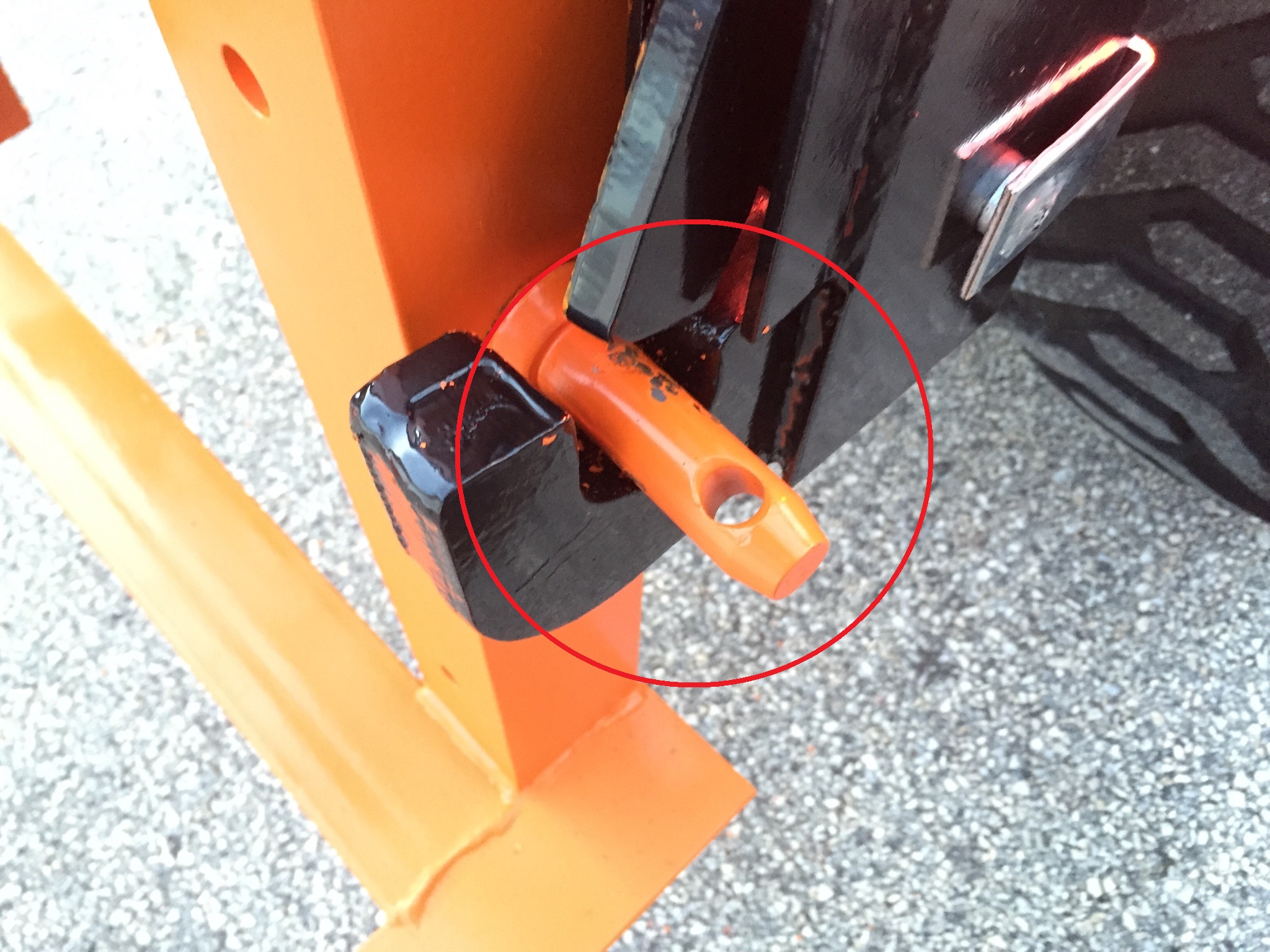

I just recently purchased my first quick hitch from Harbor Freight Tools. I have never used one before, so I'm wondering what parts I will need.
What do I need to place on the draw pins circled in the photo to secure the attachments? Can I just throw a lynch pin on the end and call it a day, or do I need something special like these bushings?
CountyLine Quick Hitch Bushing Kit, Cat 1 - For Life Out Here
If so, how do they install? And where in your experience is the cheapest place to purchase them?
Thanks for any input you can provide.

Yes you need the bushing kit to take up the slack, Northern tool has them for 13.00 a set.

Or you can use the cheap bushings in pairs, held on by your linch pin. The expensive ones with a knob are not needed.

And, understand, all the bushing is doing is making the implement pin and the Quick Hitch hook the same size. Doesn't do anything to hold the implement from falling off. And isn't definitely necessary. Most of us are just OCD enough that we want things to fit nicely. Many, many Quick Hitchs are used without them.
If you feel they are necessary, I'd probably do as Bruce said and buy the cheap ones. Then they and the linch pins can be used somewhere else if needed.

I have a set of the stepped bushings, 1 pair came with the Quick Hitch. Fro everything else I use a CAT 1 to Cat 2 adapter bushing then slide a flat washer over the lift pin, then put in the lynch pin or 5/16" bolt then clamp the flat washer to the pin/bolt and tack weld them together. I have too many of the lynch pins break the spring clip and pop out if I'm not lined up correctly when backing into hook up implement.

The really nice bushings you linked are held on by a Roll/slotted spring steel pin that you hammer through the holes. I have them on my ballast box and rear blade.
http://www.tractorsupply.com - countyline cat2 to cat1 lift arm bushing
These bushings are much cheaper and easily taken off one attachment and placed on another. I have them on my box blade and 3pt road grader.

For light use in most cases you can get by without the bushings. If you use the implements a lot and have higher draft loads then having the correct bushings lowers the amount of wear on the pins and ball sockets. The top link and bottom links are different sizes but for most quick hitches they use cat 3 size pins.
So for the top link on a cat 1 implement the easiest way to fit is to use a cat 1 to cat 2 bushing with a cat 2 to cat 3 top link bushings over a 3/4" pin. For some implements that I have modified to work with quick hitches I have welded in a piece of a standard cat 3 top link pin. Depends on the implement and what is the best fit for permanent solution.
The lower links work the same way but I can usually find the cat 1 to cat 3 solid bushings about 2 inches long to fit most clevis hitches and these slip over the 7/8" pins. For the standard hitch pins the adaptors with the shoulders are preferable and are available for cat 1 and cat 2 sized pins. You could also use a standard cat 3 pin if it would fit the holes in your implement. While I have used the slip over bushings and clevis for lower links I am more likely to loose the hardware or have it borrowed for another implement. Once I install the adaptors with shoulders using the roll pin it seems to stay in place and is there when I need it.
