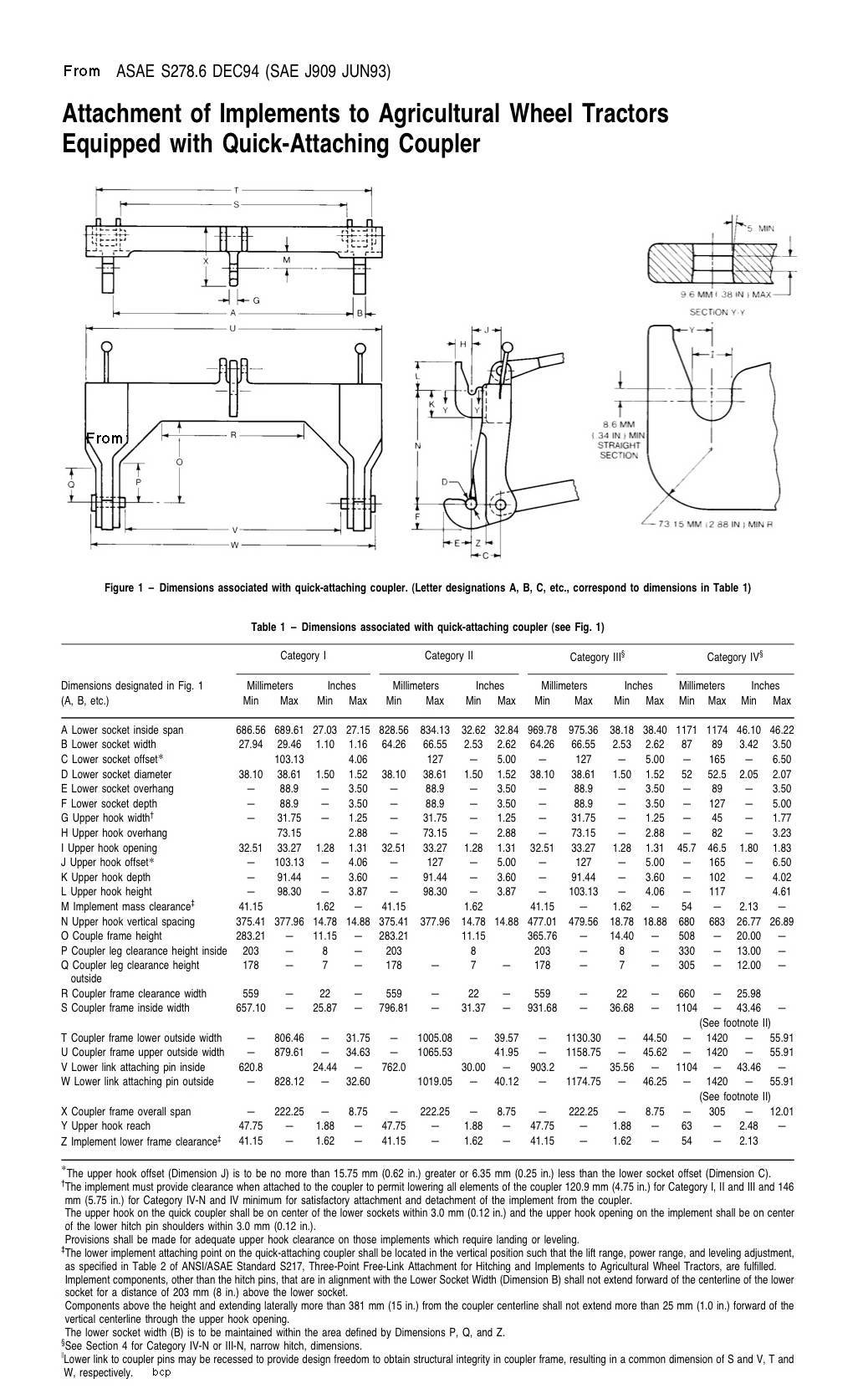

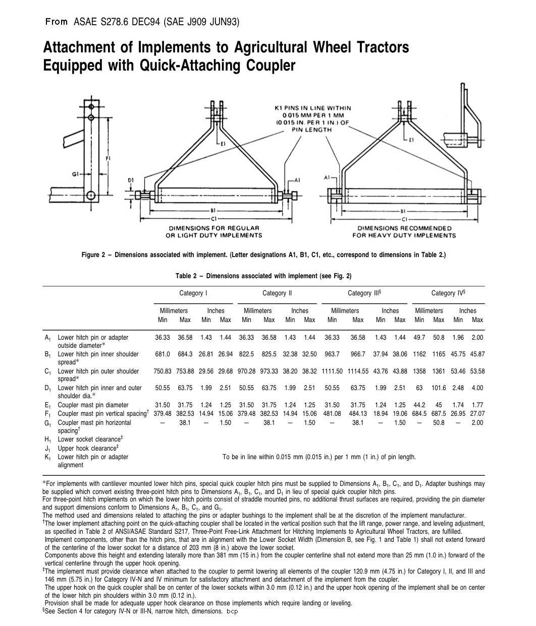

Modifications should be done to whatever is out of specs, even if it means a little more work. Specifications have been out for years but I still see new implements that don't meet them.
Quick hitch specs
Implement specs

Thank you bcp,
I appreciate you taking the time to post those diagrams. I know it will save me (and hopefully some others) a lot of time having this info beforehand.
   / New to Quick Hitches - What do I need? #23
Unfortunately, Bruce is right, it seems that no one pays the slightest attention to the standards. On my new QH from Rural King (NOT the Speeco as indicated, but a Chinese "Country Way") the "N" dimension between the lower and upper hooks that is supposed to be 14.78 to 14.88 in. is ADJUSTABLE. Think that it can be adjusted to 14.78-14.88? Nope! 15 in to 18-1/8 in.!

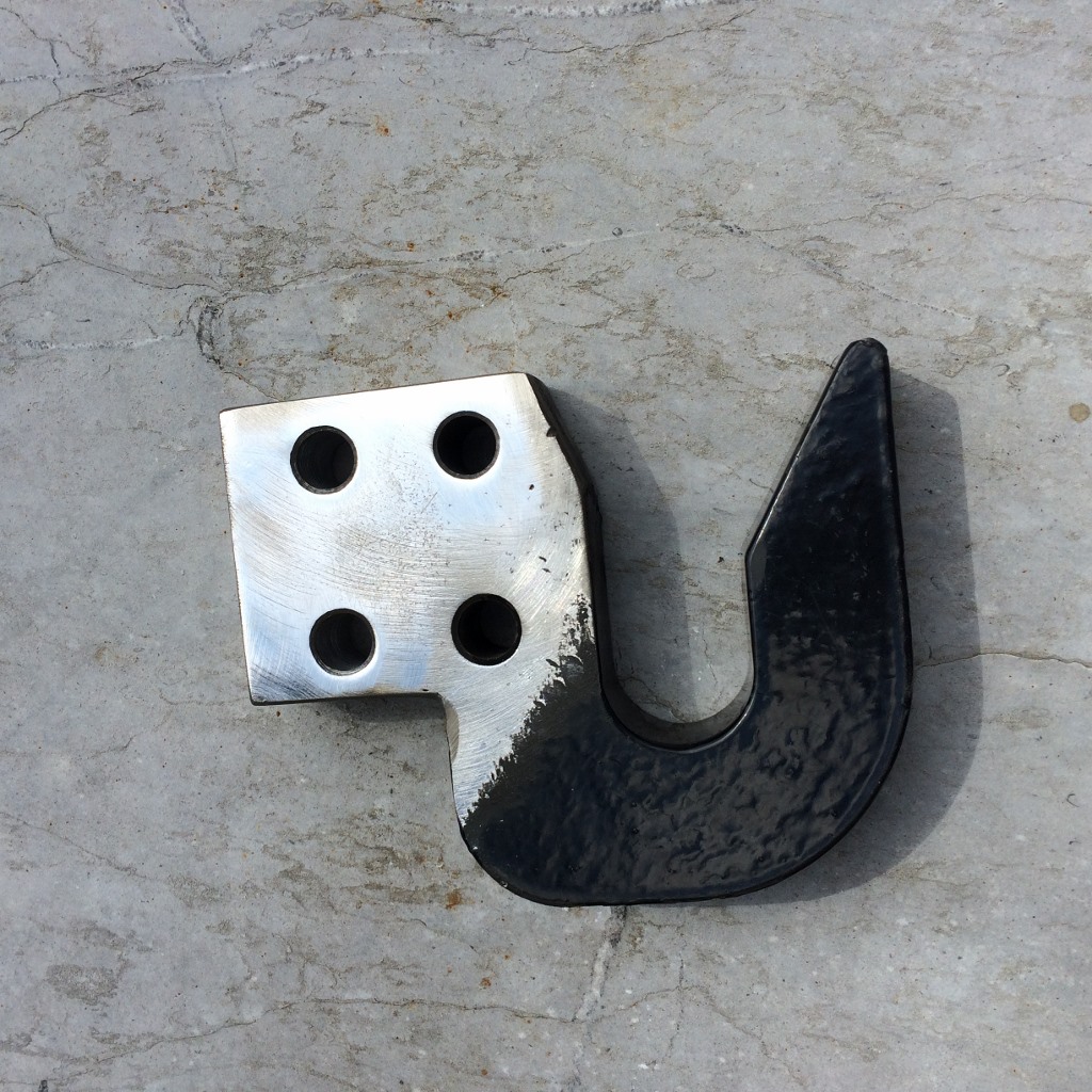

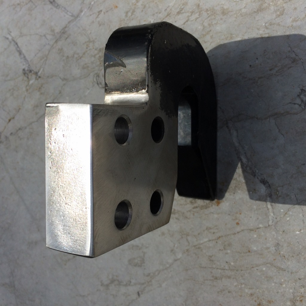

   / New to Quick Hitches - What do I need? #28
Some nice work by the local welding and fab shop.
As noted, I needed to extend the back of my top hook like others have done with my "Country Way" chinese QH. Turns out it is 1 -3/16" thick and shop only had 1 -1/8 or 1 - 1/4 stock. Said he could use the thicker stock, weld, and then mill it back down so it would all be the same thickness. But would cost me $20+ extra to set up the mill. I was already in for the stock and $65 for one hour minimum shop time. Paid a total of $120, but also got a 5' section of 1" square tube and had that stitch welded to a matching piece of 1 - 1/4 angle for another project.
I think I got a great deal. Agree?
   / New to Quick Hitches - What do I need? #29
The effect of moving the top hook rearward or forward is the attachment will no longer hang level. A change in the top link length will be required for correction.

My QH is Speeco and it does have the extended top hook, places the hook out far enough that the side frames of implement top link do not hit the pins of the hook.
Sure this moves the top out but every implement I have requires different setting of top link anyway. That is one of 2 reasons I have hydraulic top link. Other reason (primary reason) for the hydraulic link is to grab the top link first then pull the implement that last 1 -2" into the hitch, then raise and lock it in from tractor seat.
