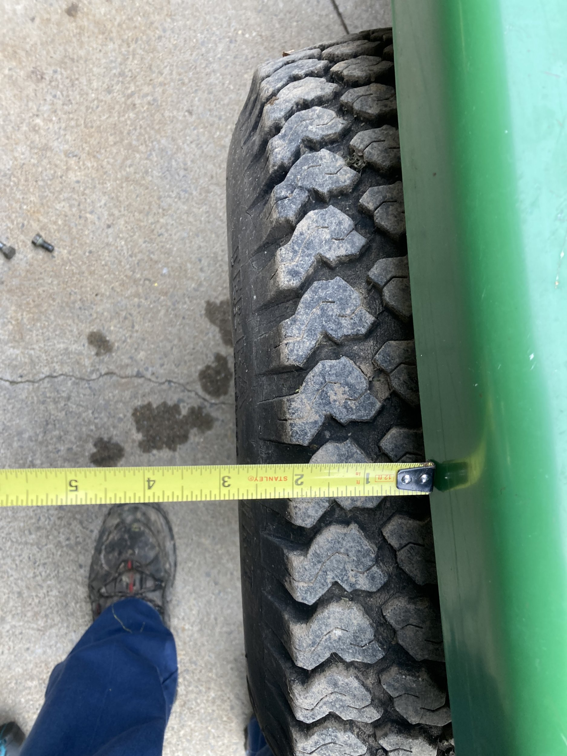

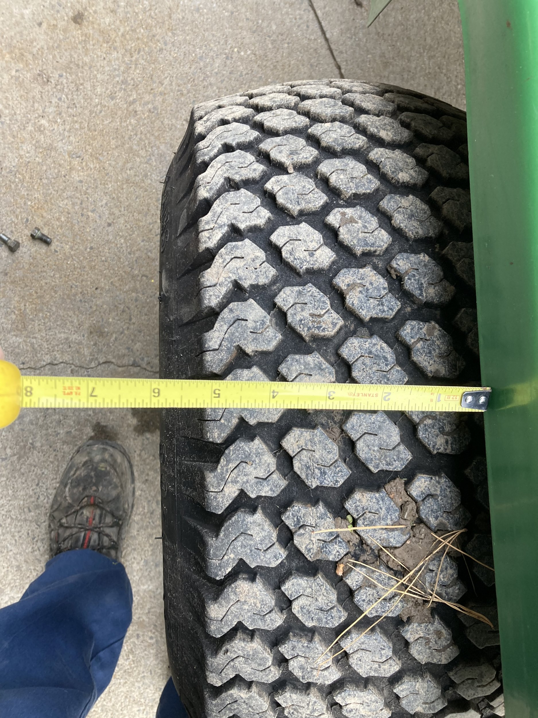

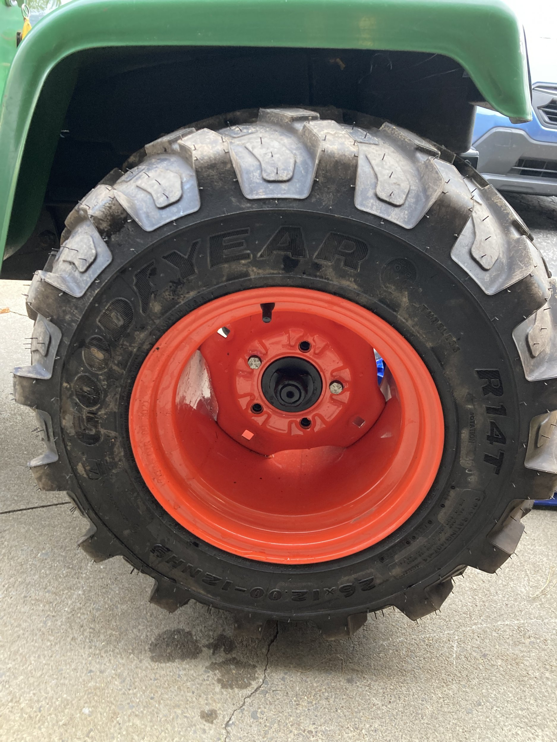

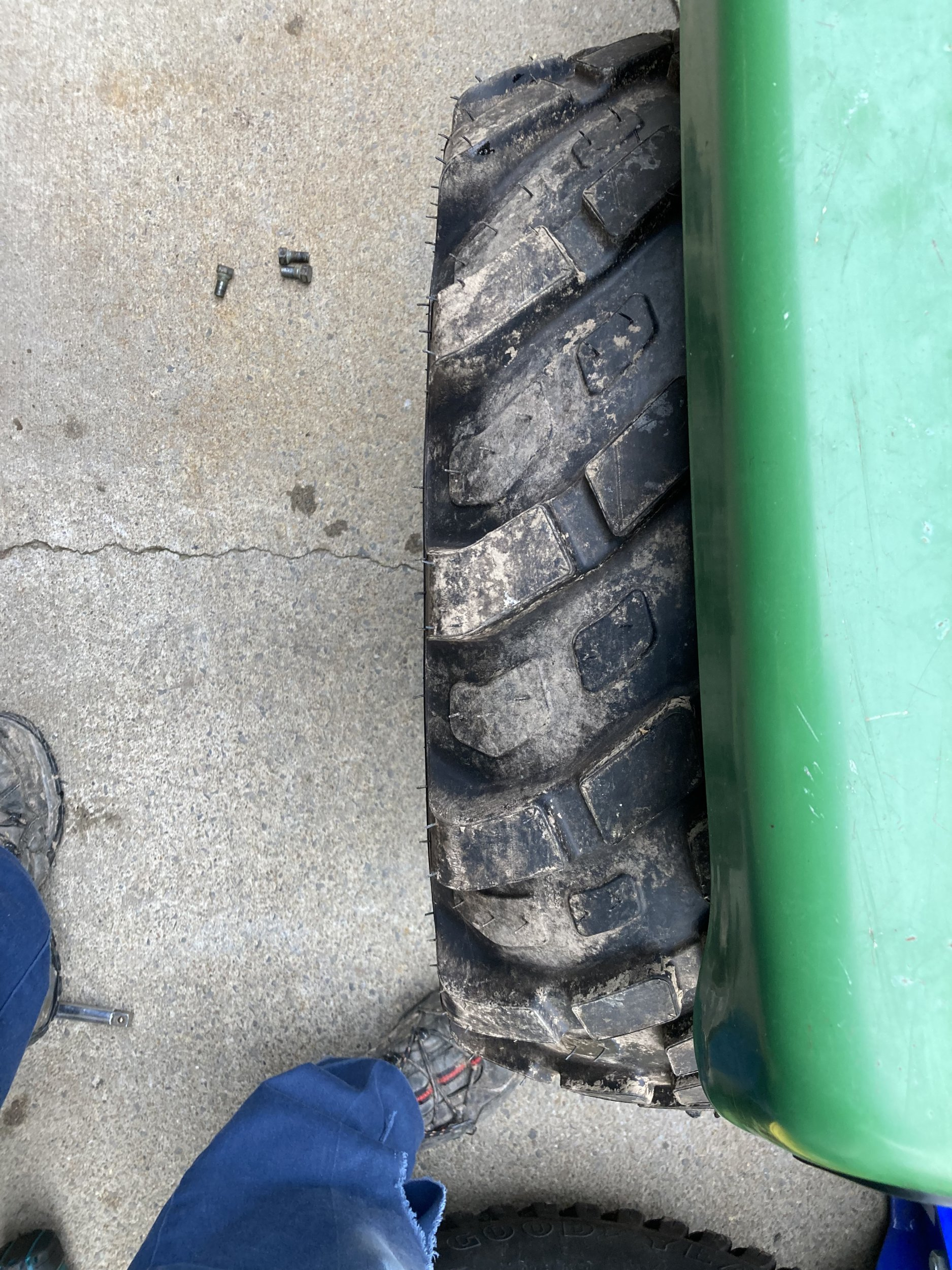

Lookee what I discovered👍-Kubota BX series rims are a perfect fit on the 430, and stick out 4” either way you mount rim. The JD wide rims it’s either 2-1/2 or 6”, so the Kubota rims are a happy medium 👍these are Kubota BX2380 rims, so I’m guessing any of the 12” BX rims from the 23xx or 26xx models will fit….

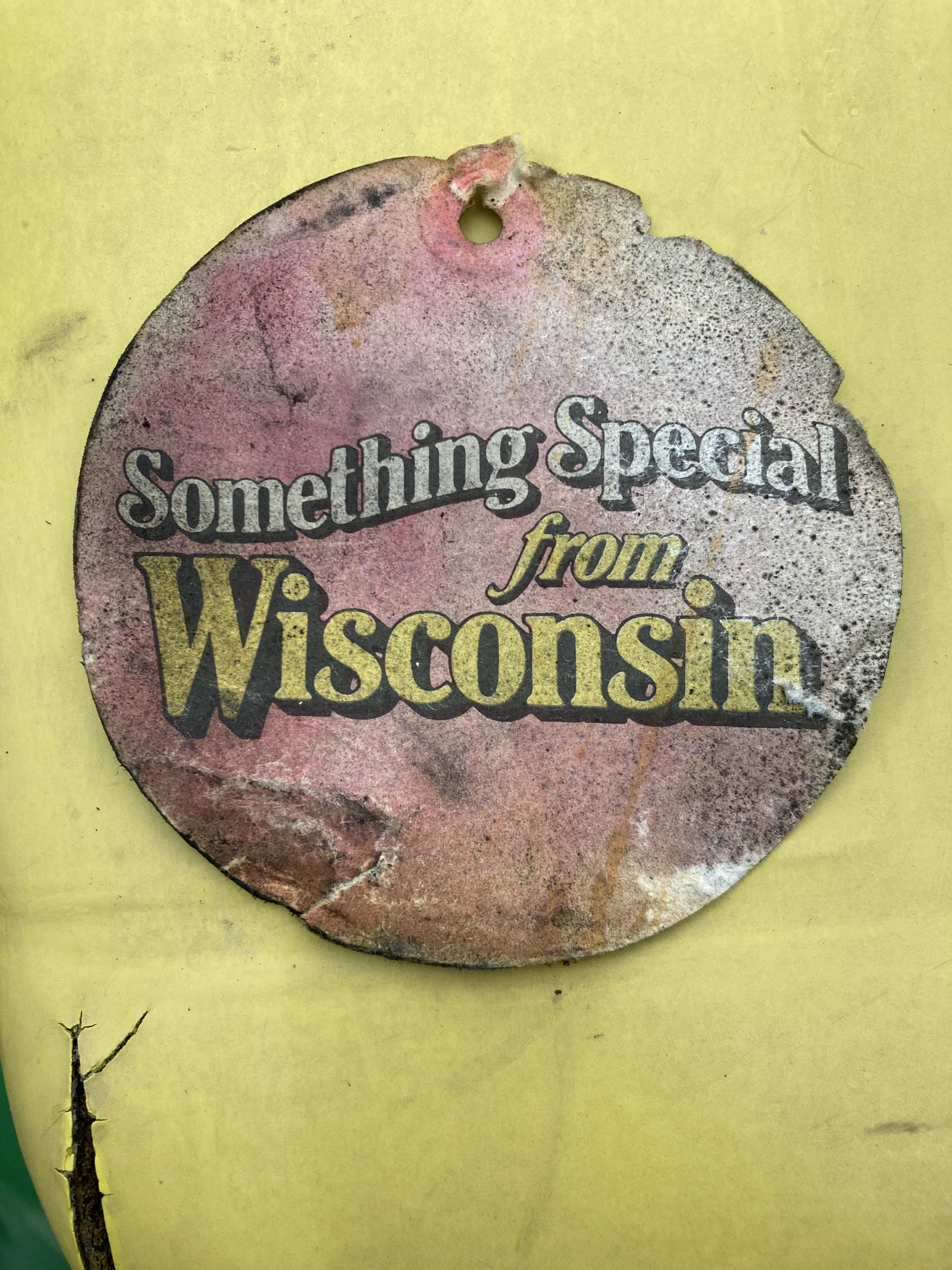

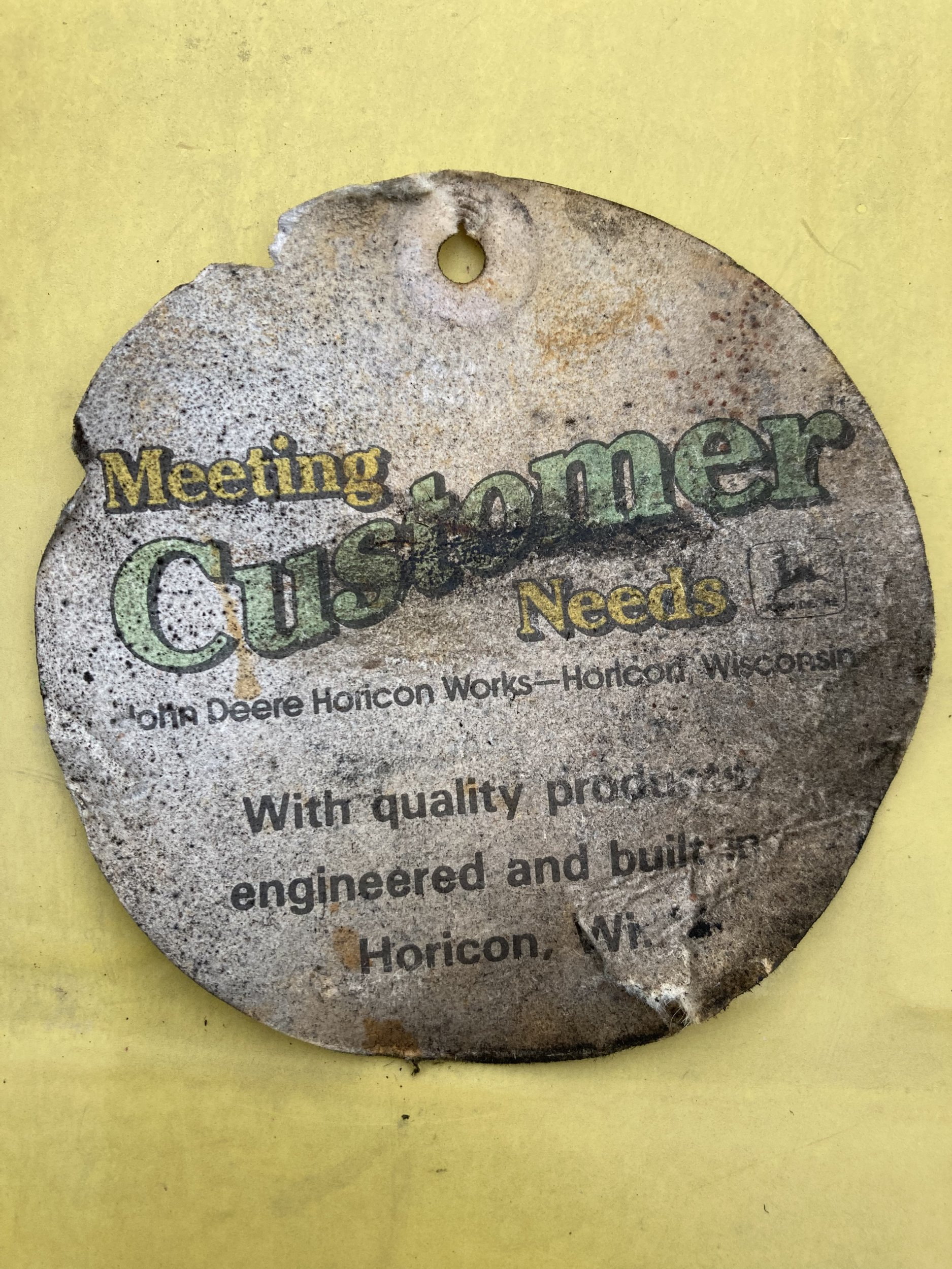

I found this tag from factory underneath pan next to frame, it’s a cardstock paper tag, looks like it held up pretty good where it was…

You're going to give that 430 an identity crisis unless you paint those wheels yellow.
