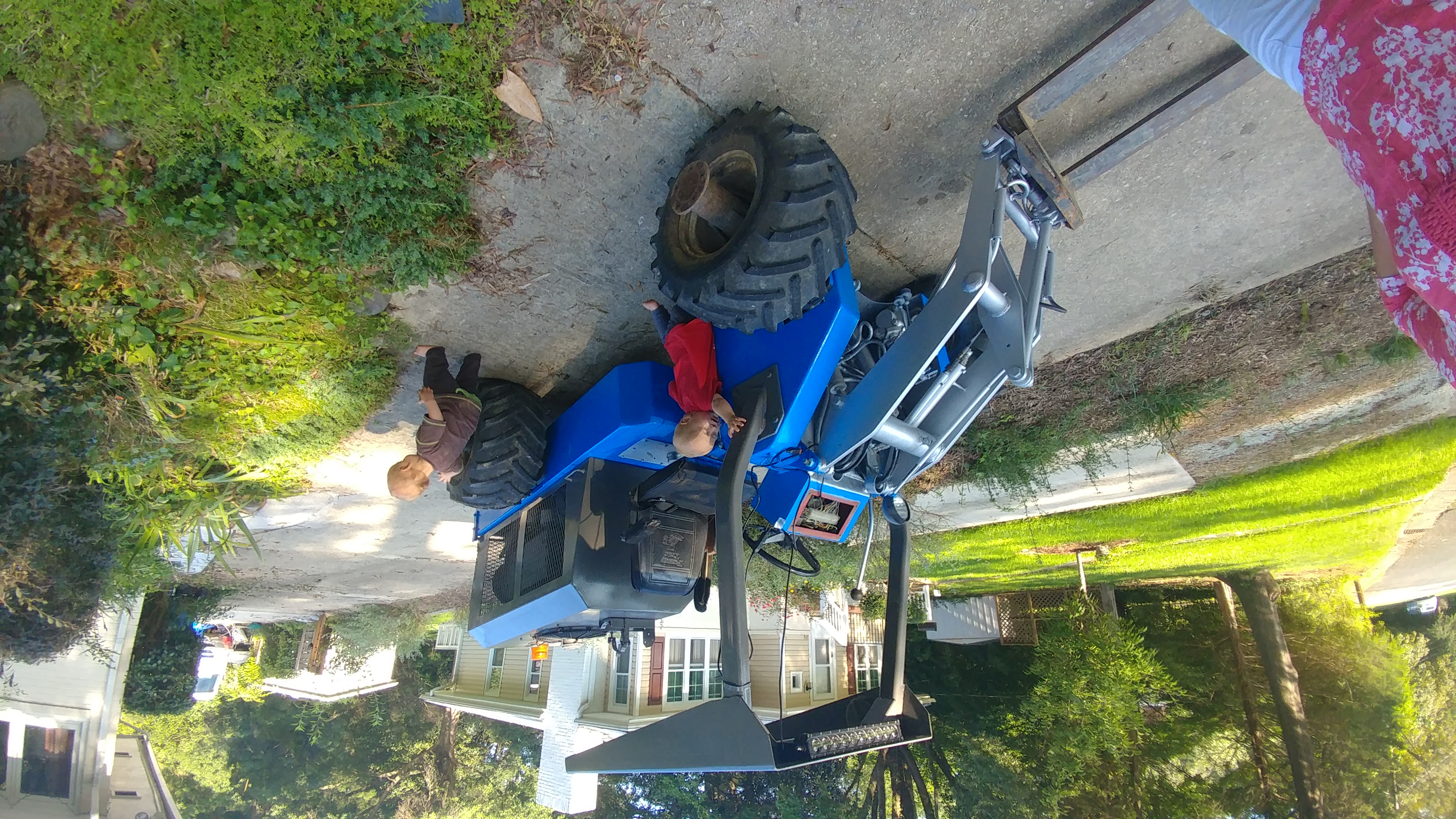

Thanks in pretty happy with the machine and flail mower costs.
I figured I'd try to max the power from hydro-->gearbox at the cost of a few rpm on this first try... And basically make a complete tractor tool carrier with driveline... It should be close and like a tractor, I'll be able to swap gearbox driven tools but have the forward facing geometry handled already.
If I'm not happy with the power(or the China gearbox implodes) , I can power the belts directly with this or a better matched motor....we'll see how my setup works In practice... I imagine I'll ultimately want to direct drive the most common tractor built tools... Brush flail, power rake, mulcher for me.
I'm planning on a short u joint setup from the hydraulic motor to the gearbox. Motor mounted to a 3pt quick hitch... From there I can pick up any 3pt tool.

Getting inspection by the pit crew mix-up fit.
Couple new lights, a Jumpstart /charge port, 12v outlet, paint. Decal set en route. PT red was clinging to life. So repainted w sail blue, MF gray and alumacoat.
Seat base and flail mower w qa plate went to fabrication today for fit up. Full suspension seat on return along with the sideshifting flail cutter.... Finished pics to come.

They've got plenty of machines to entertain them b4 they figure out about child labor law... ;-)
/ New to me 1850 #30
That's an awesome picture! I'll sure they will enjoy the tractor rides!
