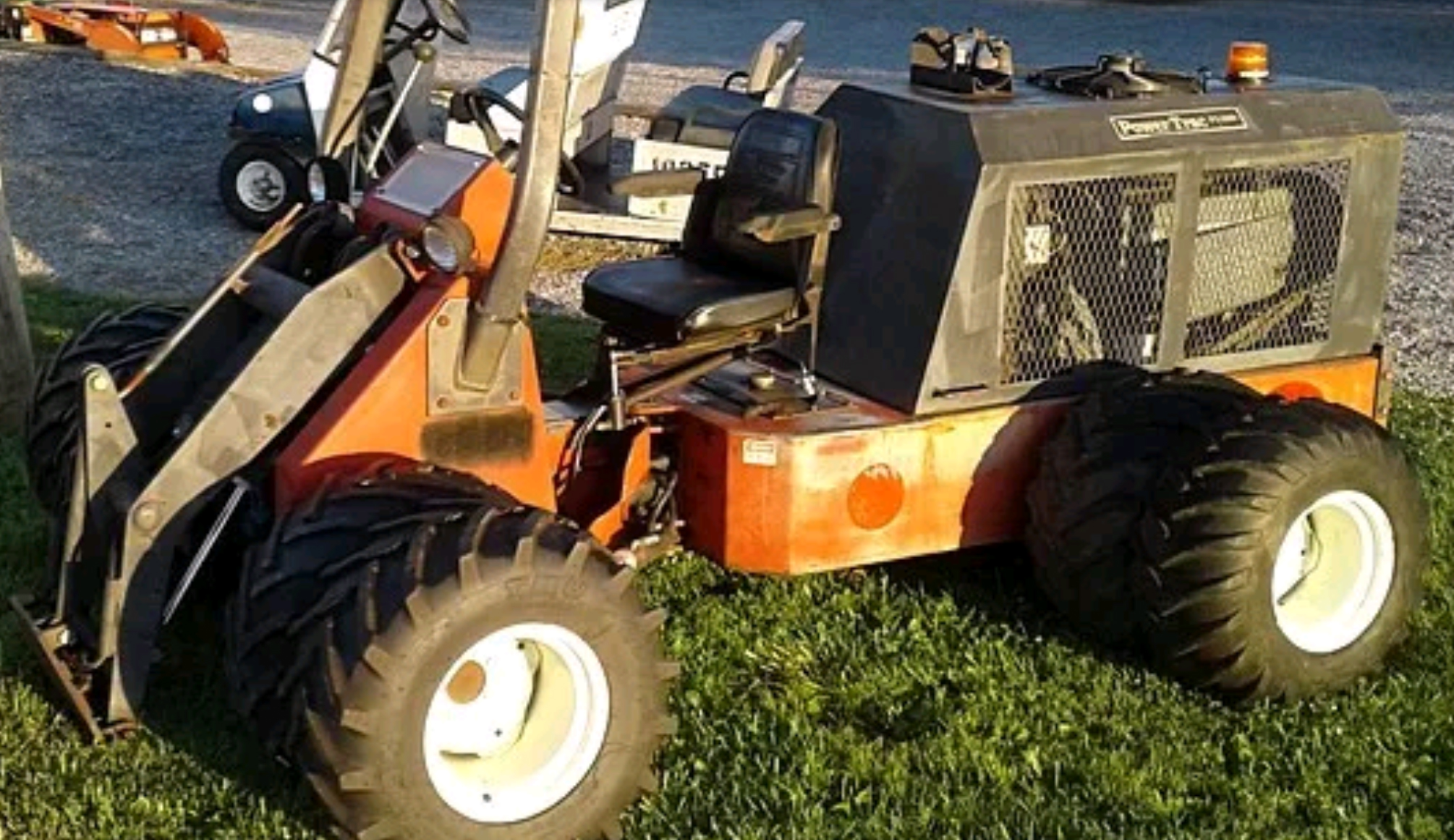

/ New to me 1850
#9
Runs like a top....heading home with a heavy trailer!
Was a municipal unit now it's gonna be a very country unit... Closer to 1600 hrs and seems like maintenance was done by some body on the clock.
No obvious immediate needs... Other than a suspension seat!

Congrats!

No attachments, unless the fire extinguisher counts
I've got a non pt grapple bucket, flail brush mower and excavator type mini mulcher en route. I'm finishing up a rehab on a 7'x16' deckover trailer. This winter I'll rebuild a 6' power rake and fit up an excavator attachment... Probably adapt the burley 3pt hitch from my 425d to the rear of the 1850....dunno yet. Happened pretty fast.
This things job for me is margin(field, road, utils) maintenance and trail construction /management.
Price? Well I nevah... Bless your curious heart. <--to be read with a slight gasp in my late grandmother's drawl!
Don't tell her I answered such a question!... Less than a new 425,more than a new 422.
