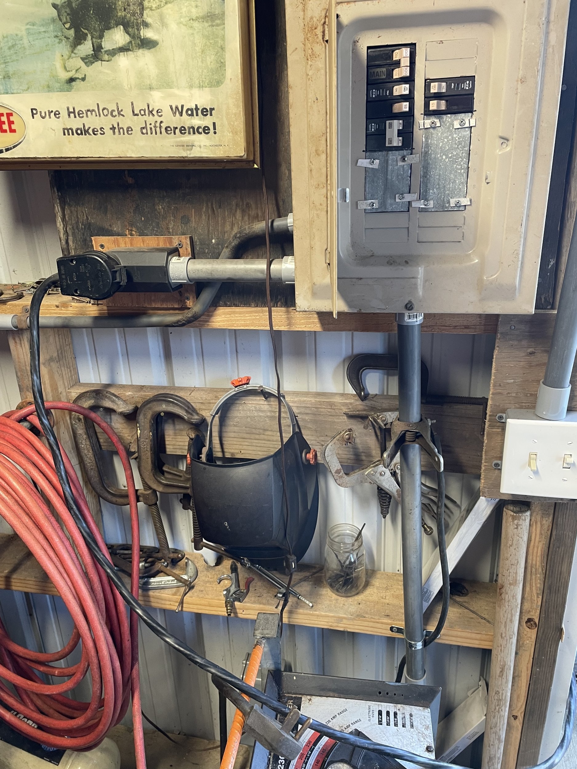

Compressor safety, it always bears repeating:
I’m one of those people that always believes in shutting off the power to the compressor after leaving the shop. I do this every time I leave (apparently mostly every time.)
I was working on the plasma table late last night, and apparently didn’t shut off the compressor. I came into a very loud Shop this morning. thankfully, no overheating, no fire, etc.
Something was missing.
Found it.
Old file as ez-out
So, time to add a timer to the outlet so that doesn’t happen again
(And time to replace all the pop off valves on this one)

I plug a compressor into an outlet that is controlled from a switch next to the front door of my shop (on the right side of the photo below the sub-panel). The overhead LED fixture up there is also plugged into that outlet. I never leave the light on when I’m not out there so I never forget to kill the power to the compressor. Of course it’s just a little 120 volt model.
That wouldn’t work out so well with a 240 or 480 volt one. Also, I just plug that compressor into that outlet when I need it, because it annoys me to hear it come on when I don’t need it.
I have a second small 120 volt compressor on the opposite end of the shop, that I can plug into a non-switched outlet by the back door, when I need air back there. I prefer (2) small compressors, over one big one, because I always have backup that way.
