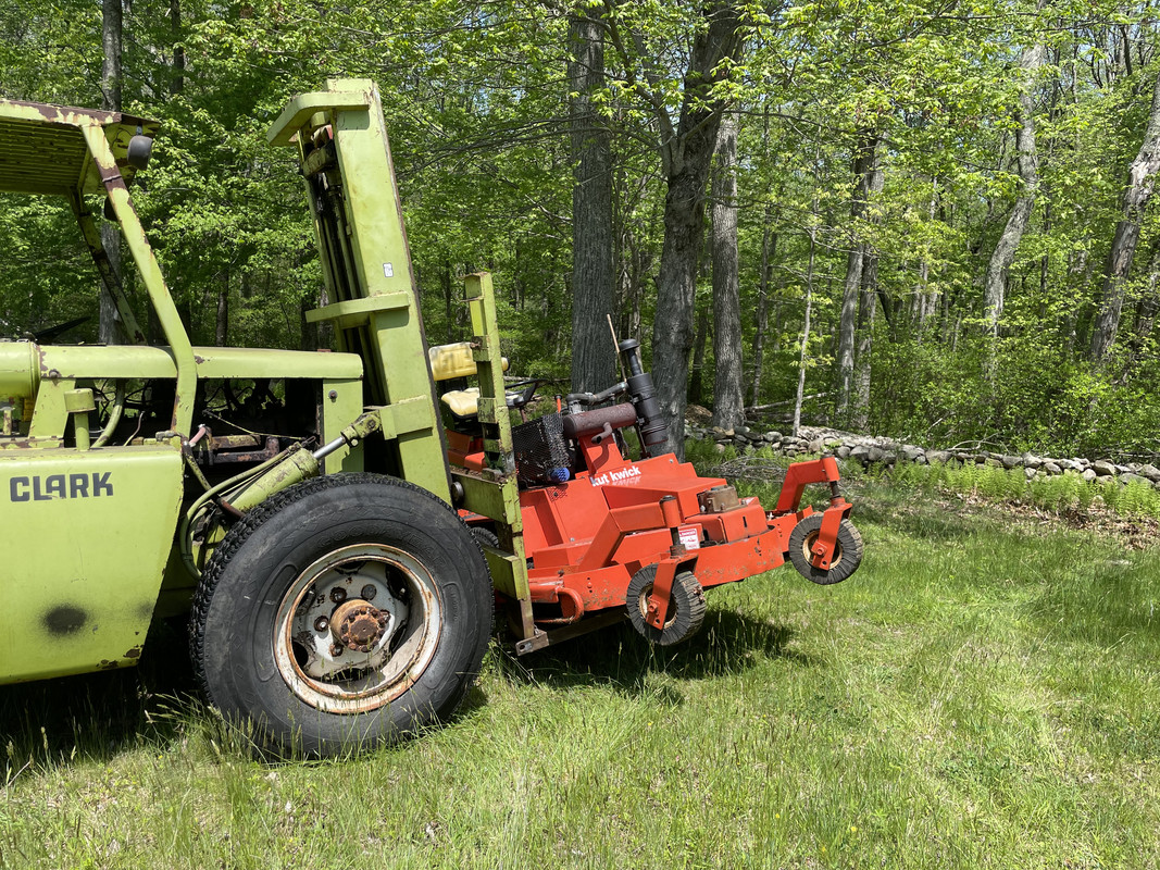

Well winter seems to have resulted in a dead mower ( generally I use a flail, but do my edging w this)
Seems electrical
Ranger to the rescue and into the shop

It randomly cut off after 5 min of mowing
fuel flow was good, seemed electrical
Would restart instantly
after 3 x in 100 yards, lost the click of the solenoid on starter
Hammer brought that back and starter would now “click”
jumpbox didn’t prove that it was a weak battery so into the shop
So, at least a starter issue for one and then something preceding that causing it to die. It seemed “coil like” but coil
ugh, I hate black magic electricity
I can get it going again I’ll put one of the spark tester’s on it and see what kind of spark I’m getting on a dies
