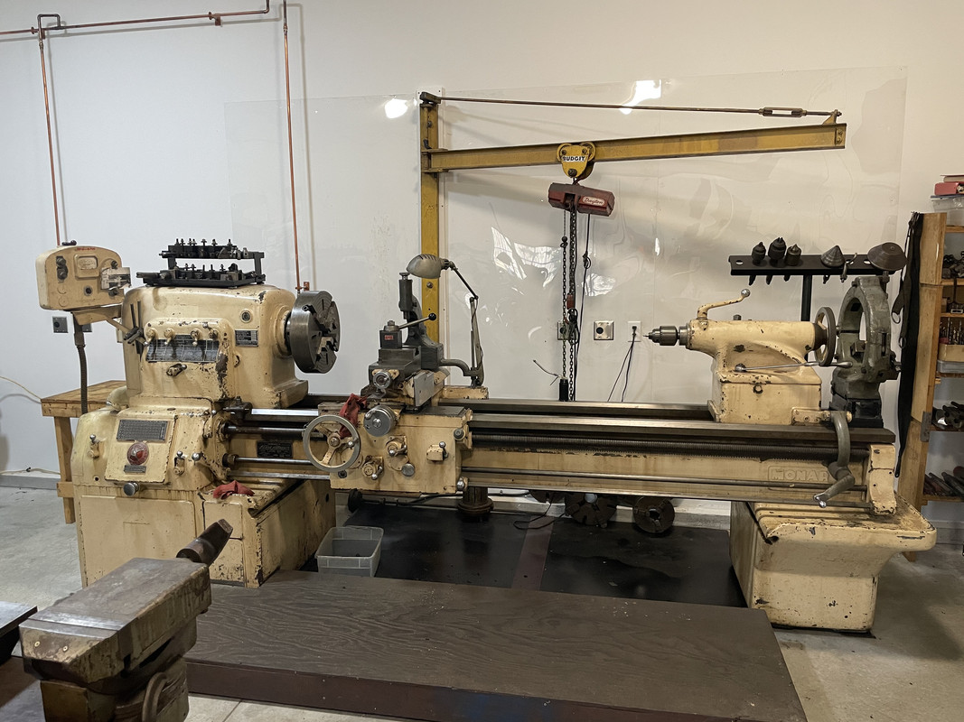

You will probably going to want to get the plasma out of there as soon as you can. Plasma smoke contains a lot of fine metal particles that does a job on machine ways and it looks like you have some nice machines in there. I am going to get one next year after I move my shop and it is going to go out on the covered porch away from the precision stuff. BTY, what is the big lathe on the right side of the picture? I need a good farm lathe that will swing 12" over the carriage.
/ New shop started
#387
Water table seems to be doing quite well for dust, I’m pretty happy
I wipe and coat all ways prior to use or any carriage/saddle/table movement anyway ( due to years of combined wood/metal shop) so I will just keep that up
lathe is a 24(48”) swing x72” (iirc)monarch model 60
it was was an old hydraulic tracer model that had it butchered off
So not ideal for threading as compound is fixed parallel to work
Otherwise it is great machine

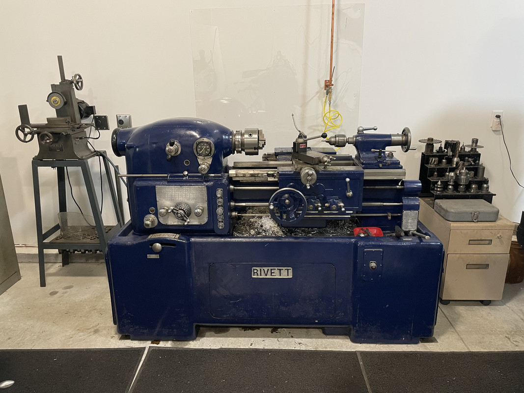

It is second only to my Rivett in fun
