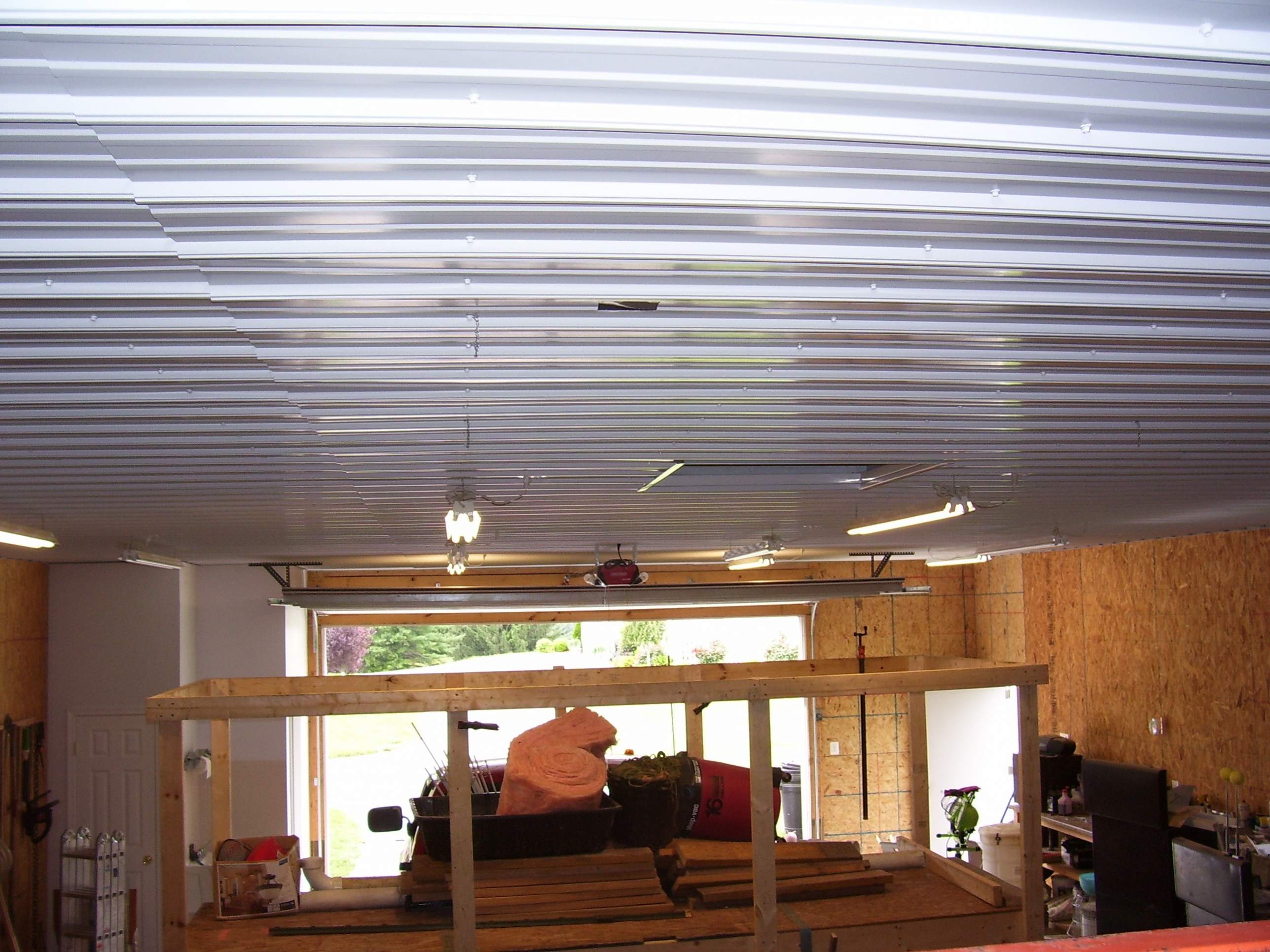

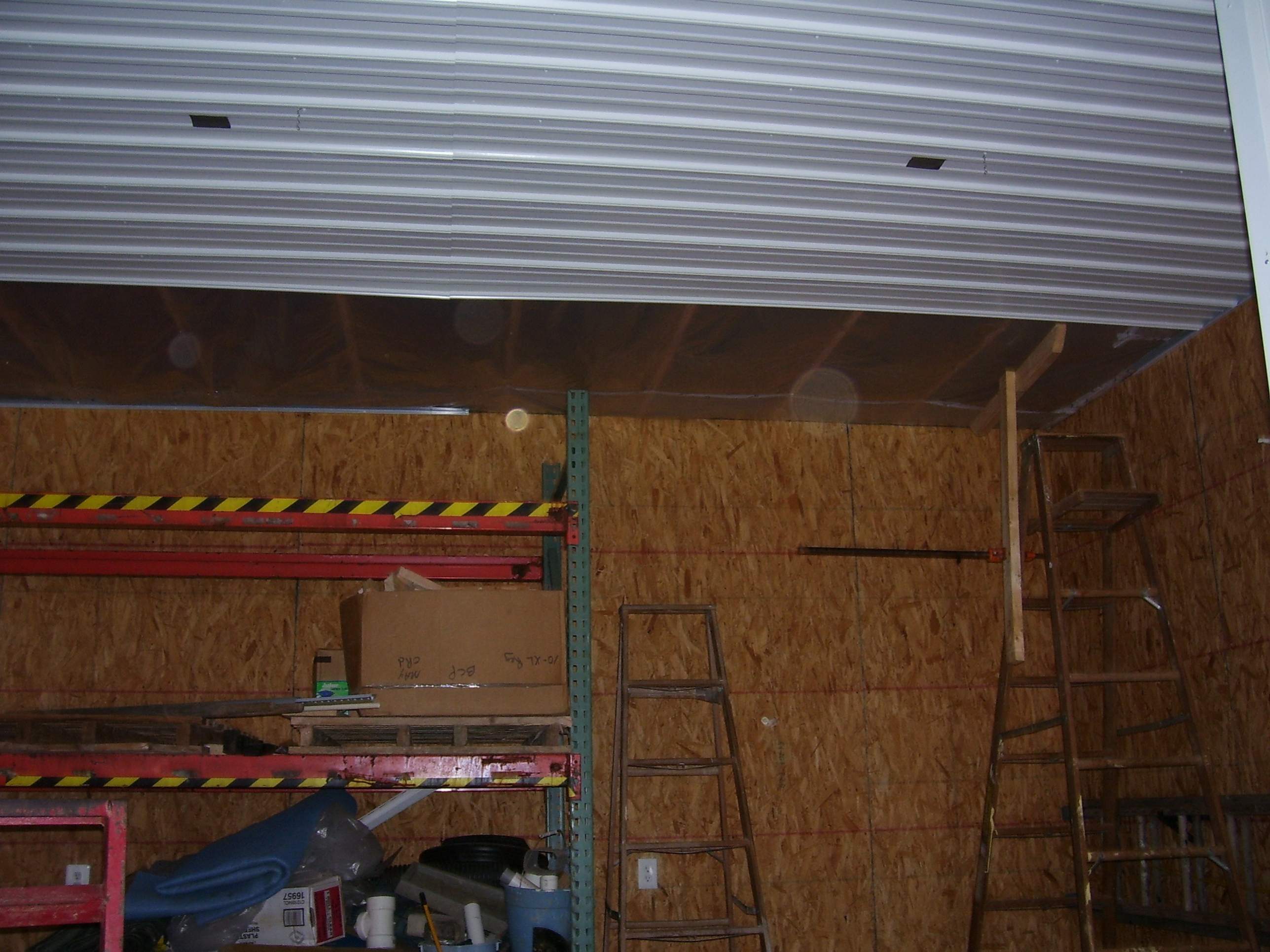

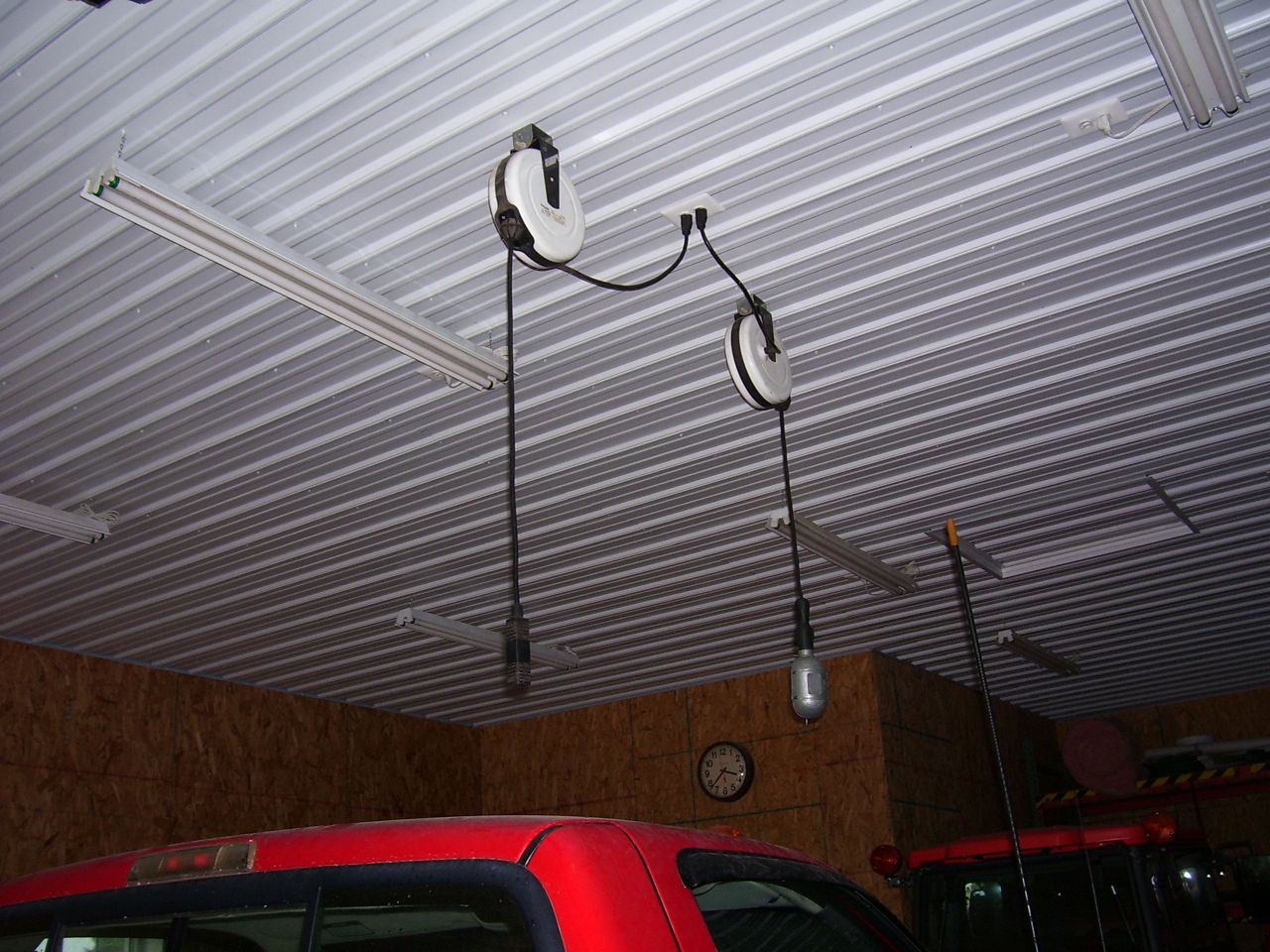

Here is how I did my ceiling. I bought cheap 4' long plug in lights from Home Depot. Lights are set in rows and each row is controlled by a switch. I have 4 rows of lights. After 5+ years I've only replaced one bulb that started to flicker. I did purchase the electronic ballast (I think that is what they are called) so that in cold weather there is no buzzing noise. Cheap and so far so good!

How high are your ceilings in your 40 x 40 area?
Celing is 12' and right now it's open above because I haven't finished the barn yet. I do plan on putting white metal siding up there.. After that I'm sure I'll need sun glasses when the lights are on. :laughing:
