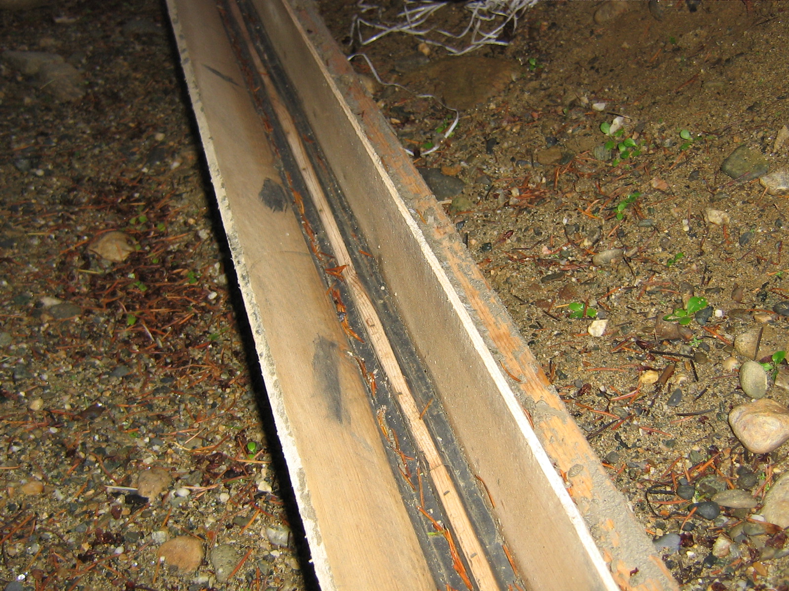

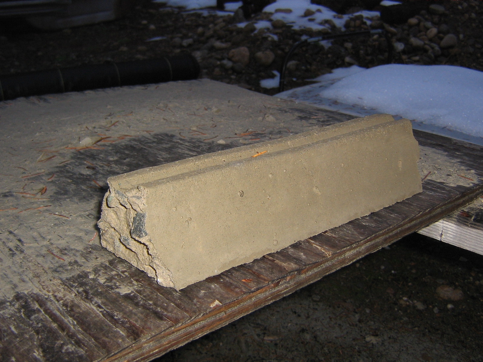

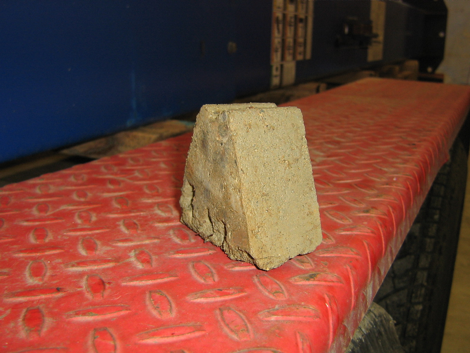

I just took these three. I'm not good with computer stuff and it tells me that it can't find any new ones on my phone that showed them in place befrore placing concrete. 001.JPG002.JPG003.JPG The first is a form 8' long. The second is a left over section of the concrete I poured and the third is after cutting to length with a diamond blade.

You made 400 of these? Wow!!!!

That's interesting, not what I was picturing with the description but would work fine, the little concrete blocks with wire at $.70 don't sound bad until you multiply by a large number...
