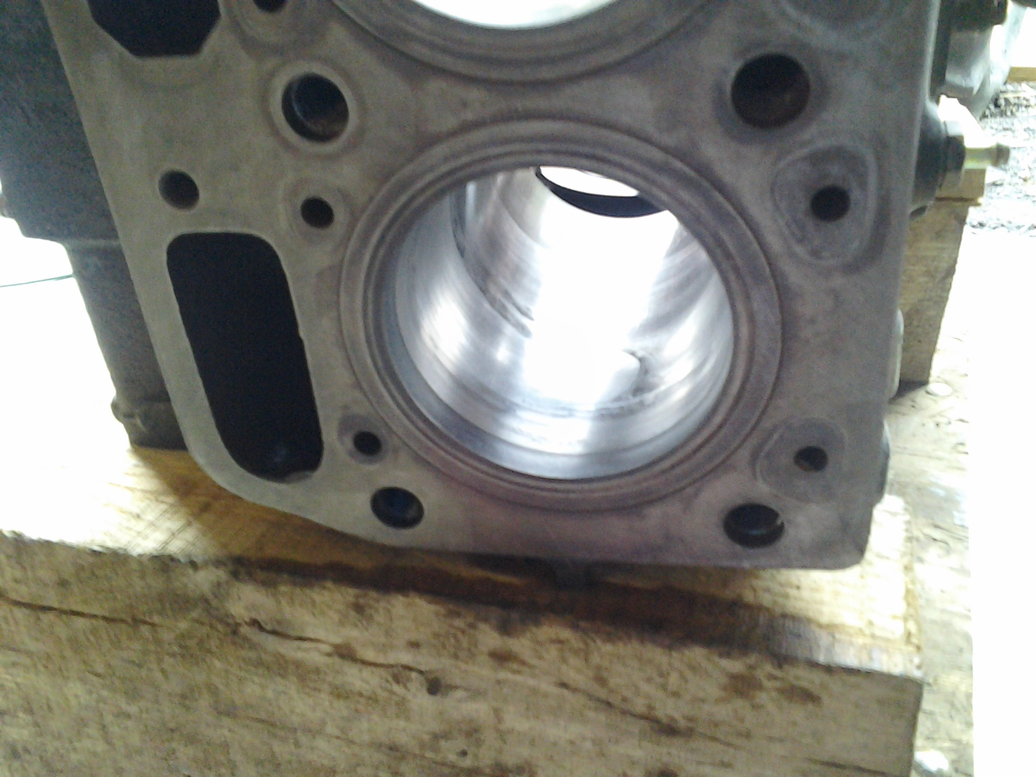

Well got all the parts for the engine. Took the block to the machine shop and had the front and rear bearings pressed in. I don't want to talk about what that cost. I was deglasing the cylinders today and noticed one of them has some black staining in it. After deglasing you could still see it slightly but can't feel it at all. The cylinder are standard with hardly any wear and I don't want to hone them any more If I can avoid it. Any comments? Here's a picture. 406.jpg

Well got all the parts for the engine. Took the block to the machine shop and had the front and rear bearings pressed in. I don't want to talk about what that cost. I was deglasing the cylinders today and noticed one of them has some black staining in it. After deglasing you could still see it slightly but can't feel it at all. The cylinder are standard with hardly any wear and I don't want to hone them any more If I can avoid it. Any comments? Here's a picture.View attachment 397599
Surface discoloration isn't bad to warrent horning. You did polish though? If you have a gauge to check the circularity to be continuious down the cylinder, that would give the best assurance.
/ NEW PROJECT #37
Polish? :confused3:

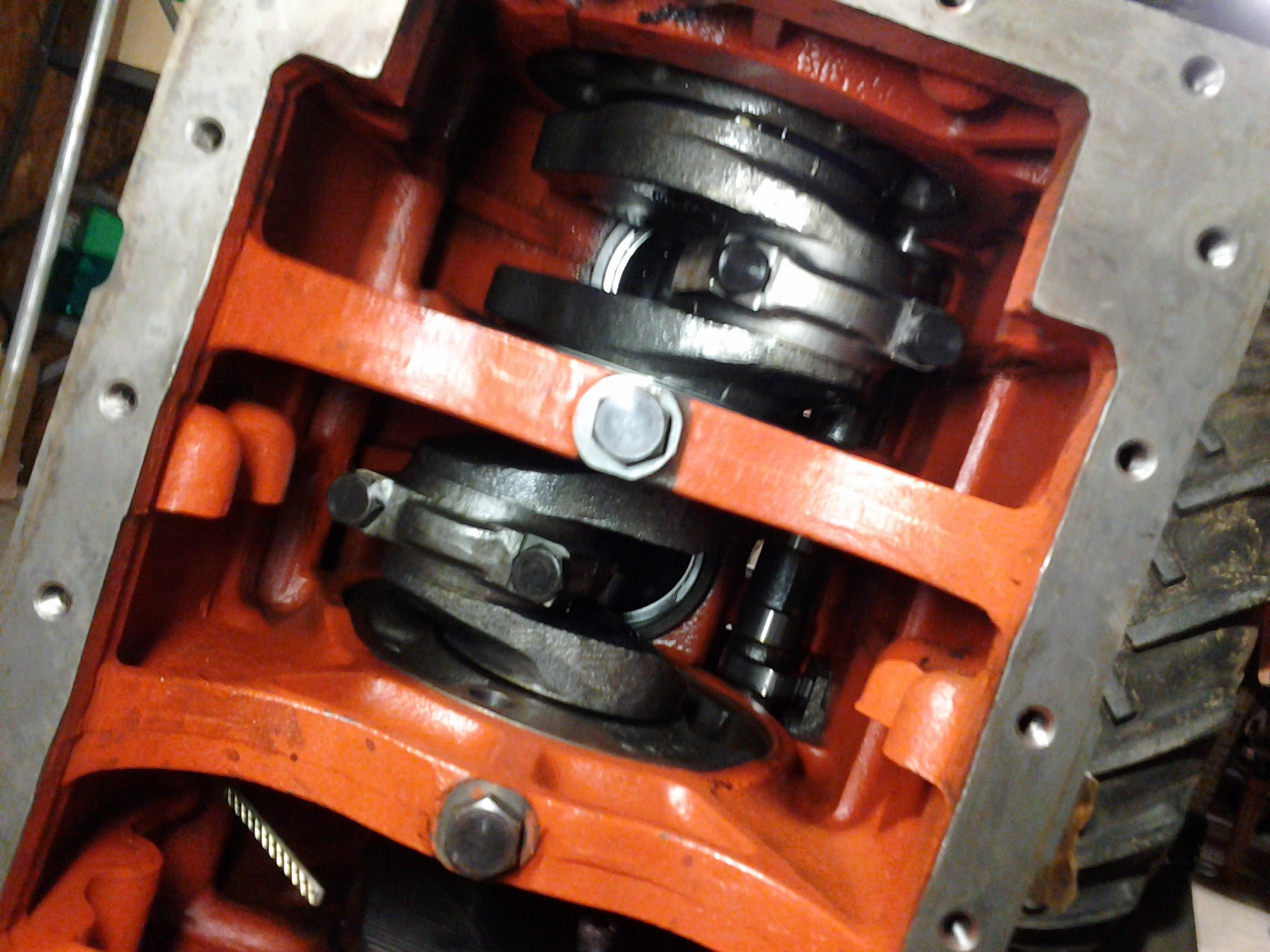

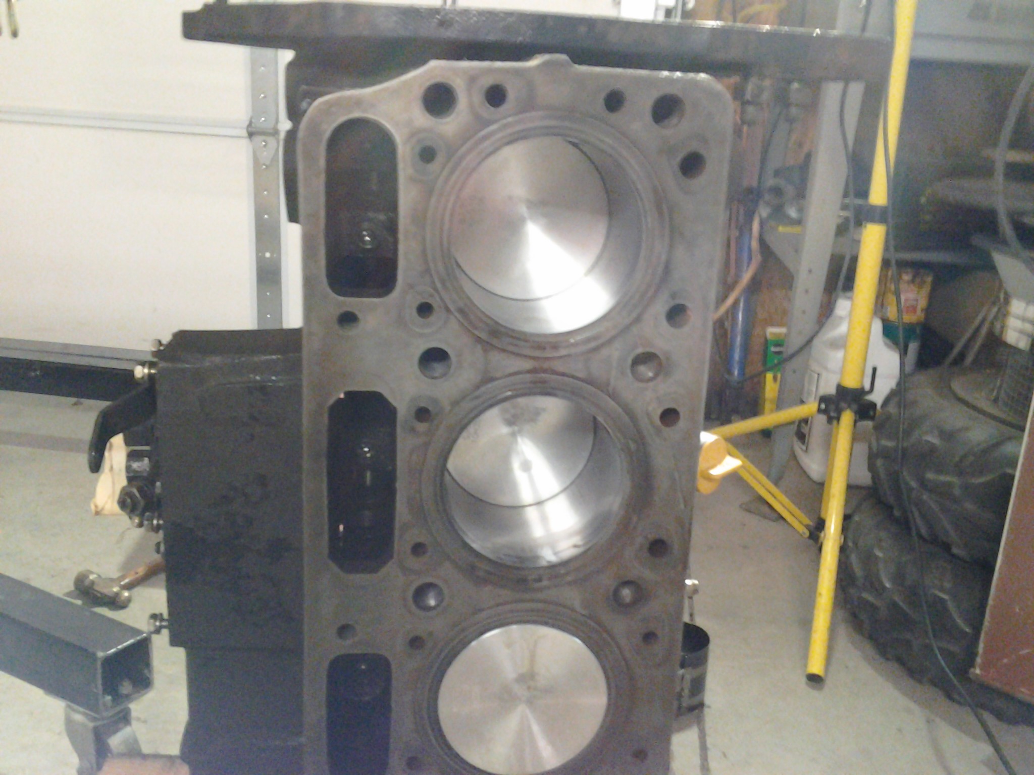

I did hone and ended up with a good cross hatch pattern. Got the block put back together today. Everything went well. New pistons,rings,1 rod,crank,and all bearings. Bolted back to tractor and called it a day.002.jpg003.jpg
