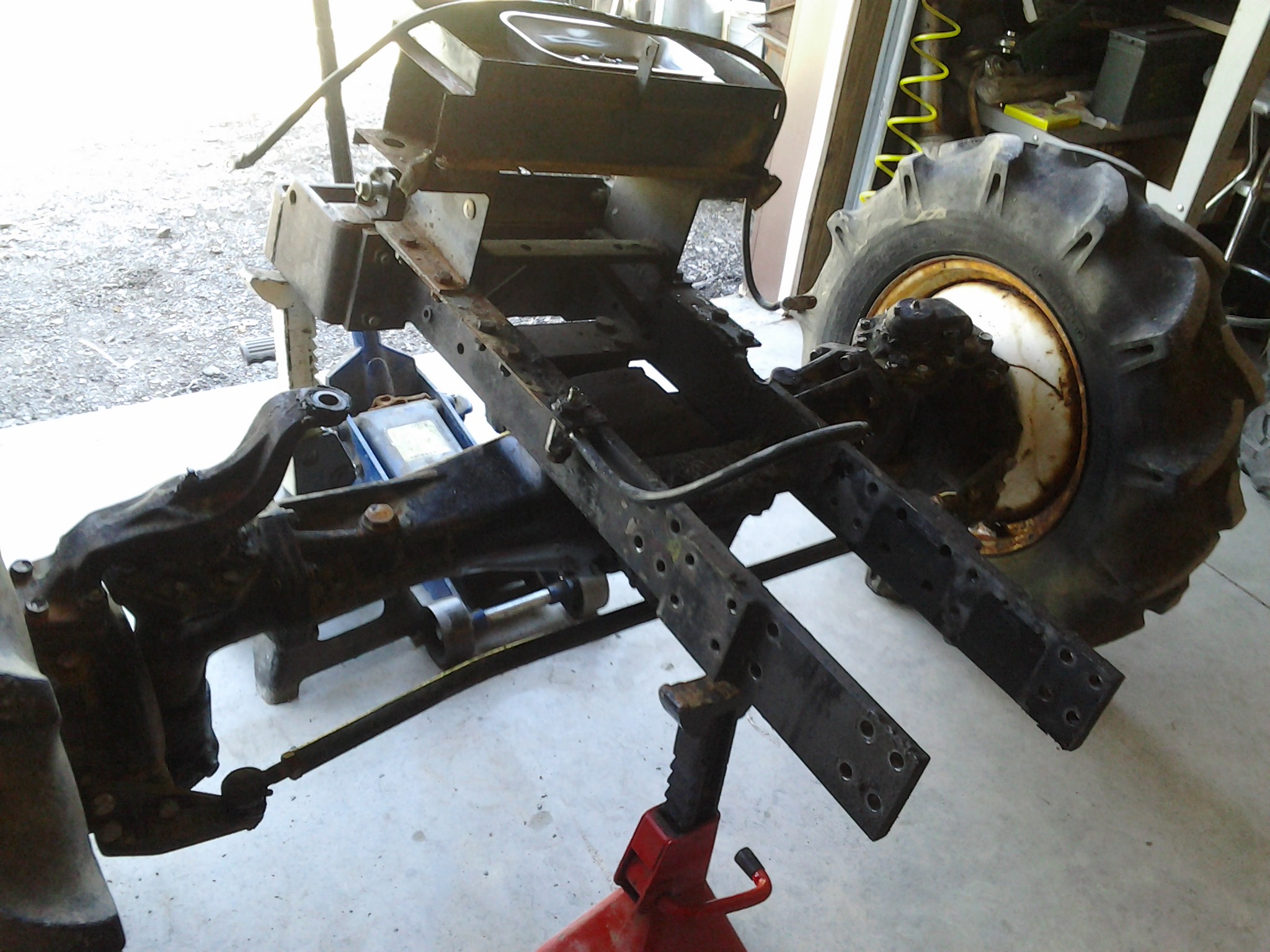

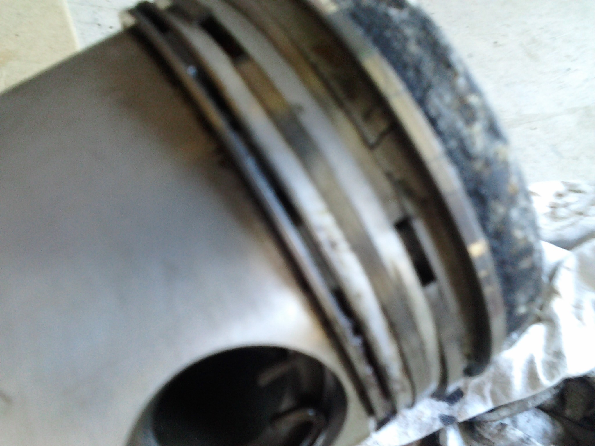

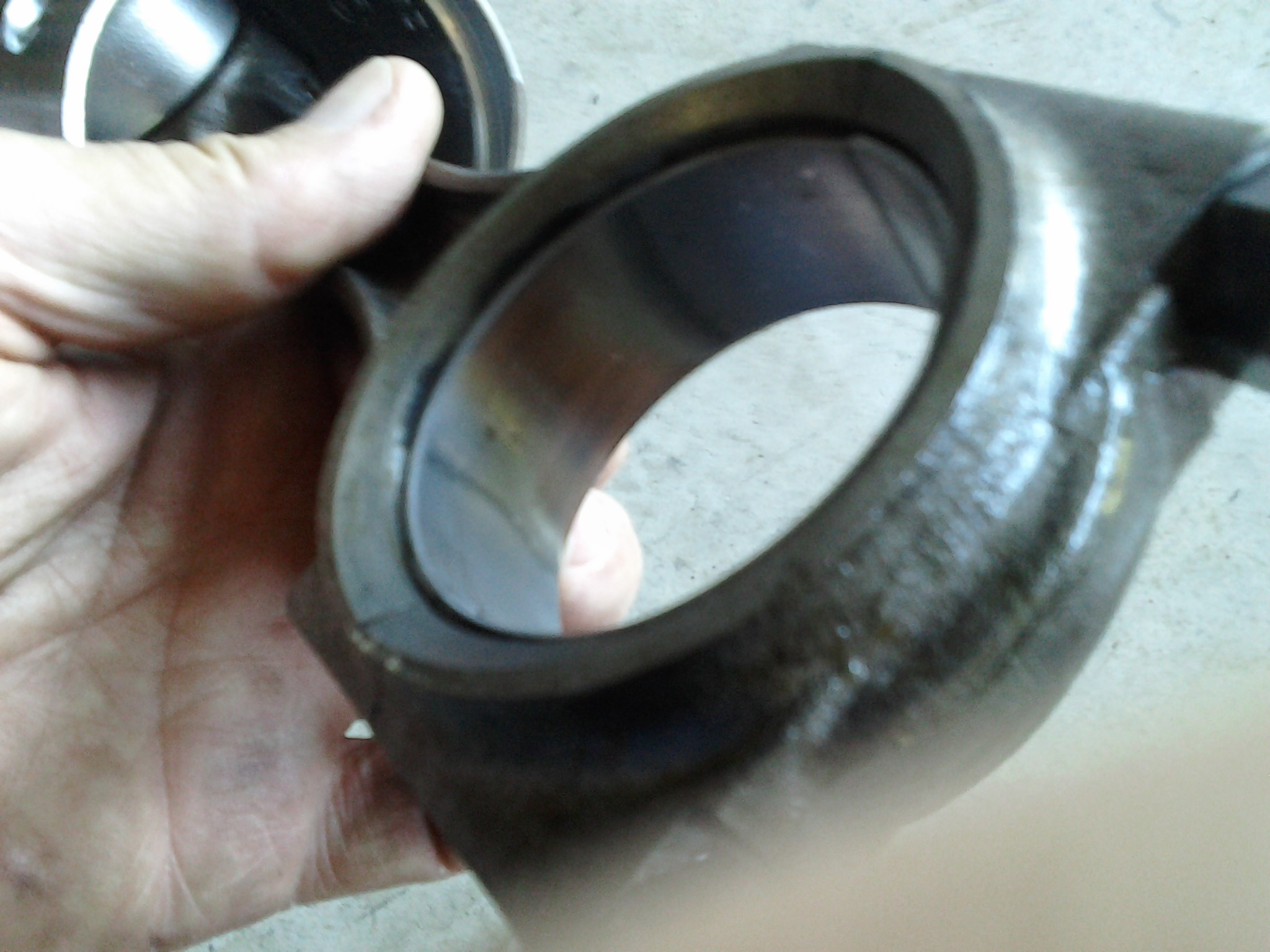

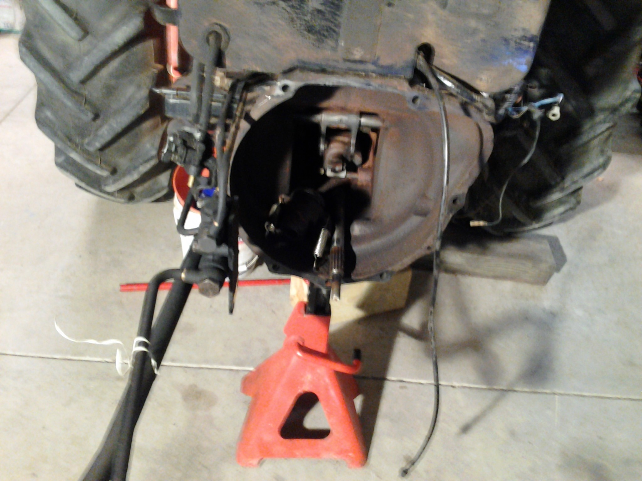

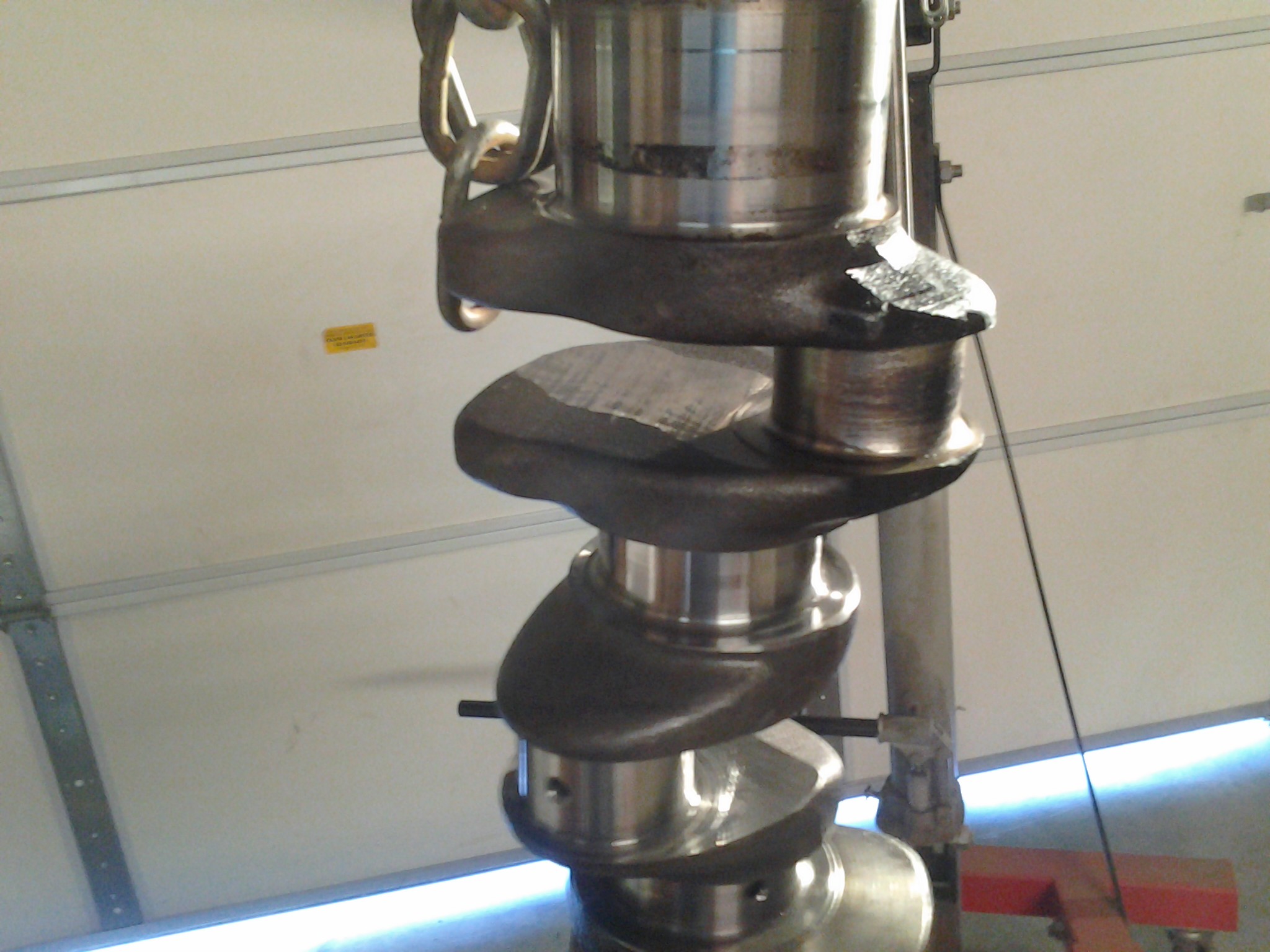

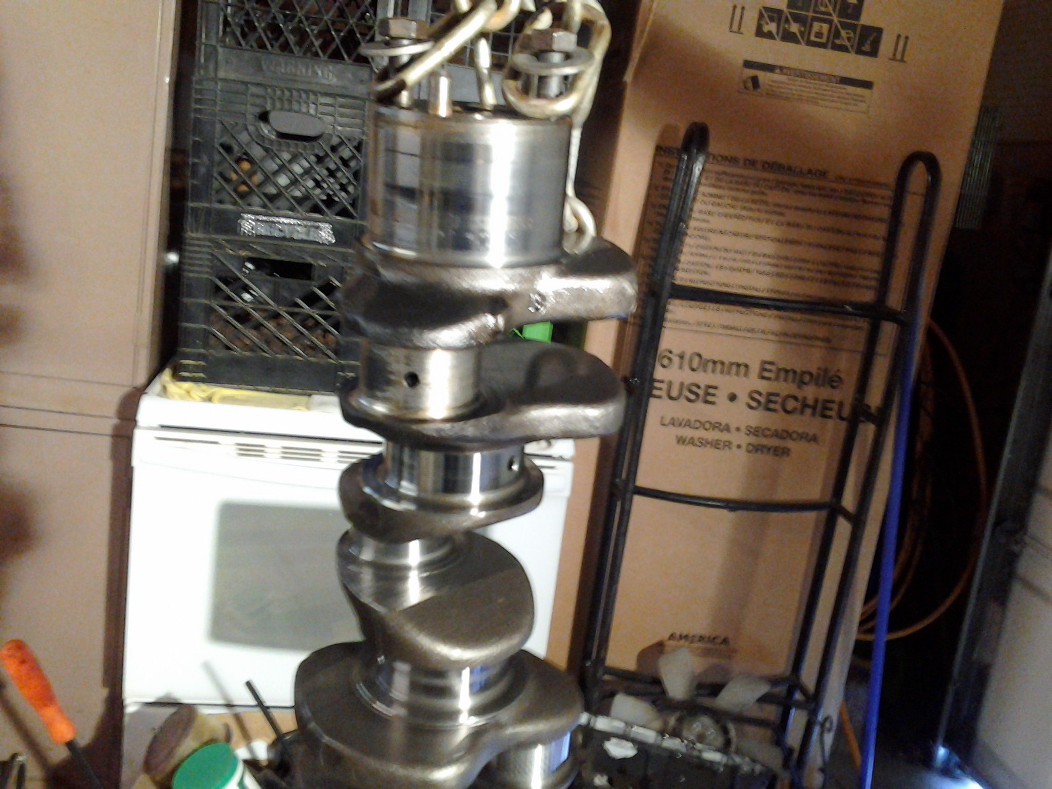

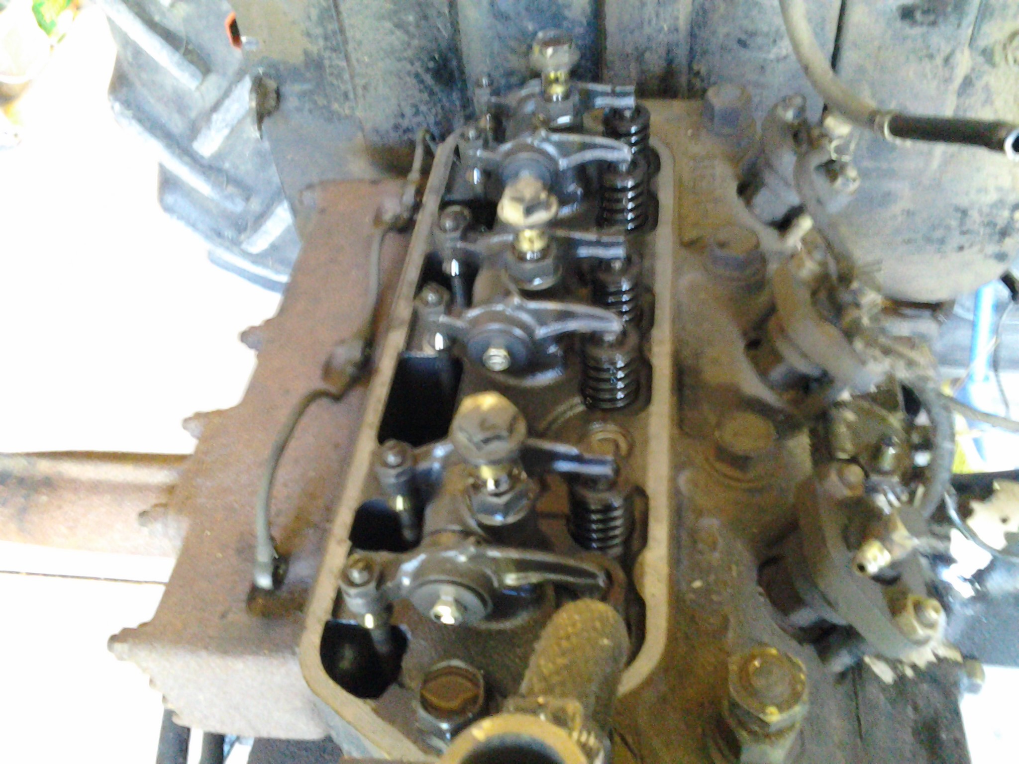

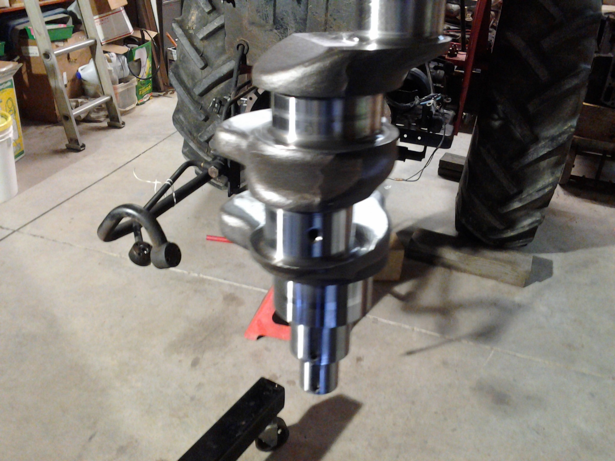

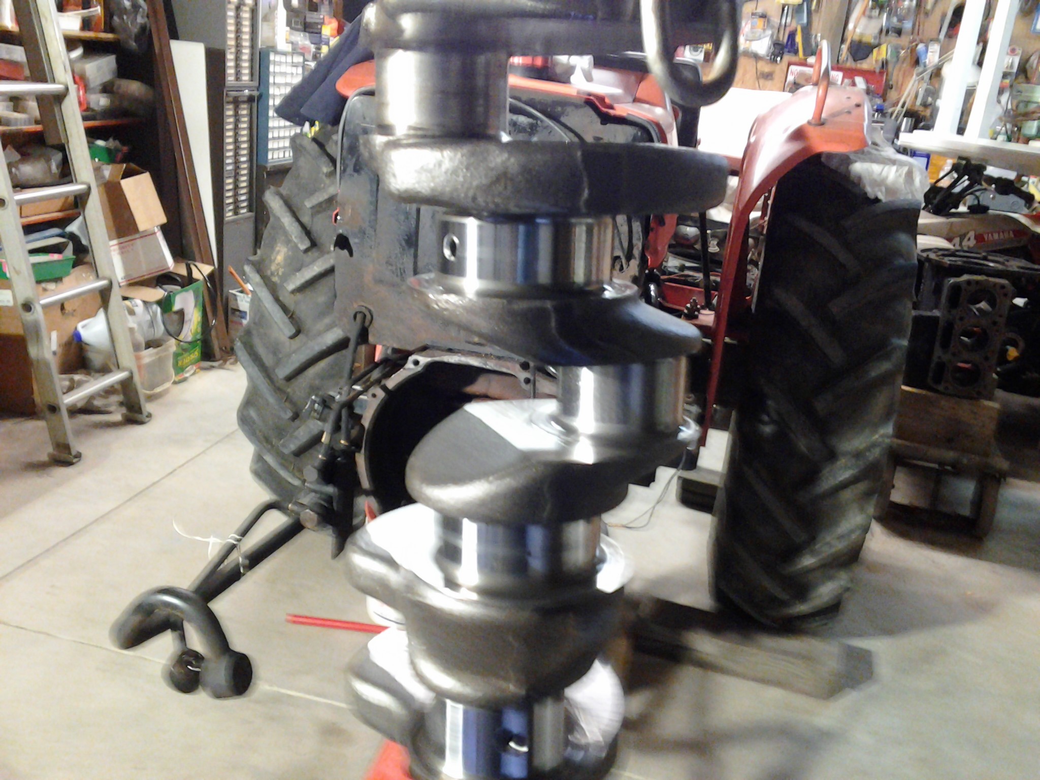

Got a little deeper into the tractor today. Crank has to built up or replaced. I'm going to have to make a tool to remove and install the front and back main bearing. It sure would be nice to have special tool the manual calls for. The clutch showed very little wear so I'm going to put it back.Here's a few pictures. 006.jpg007.jpg008.jpg009.jpg010.jpg011.jpg
/ NEW PROJECT #25
Can't tell much about the crank from the fuzzy pics, but are you sure it needs to be built up? There are .010" and .030" undersized bearings. May just need to be ground, if that.

the crankshaft
I was thinking you could but the tool too. Unless its so expensive that making one is more cost effective given the money vs time senario?
I would think you could buy the tool from JD for removal since they work on similar yanmar engines in thier small tractor line back through the 80s
I had the crank checked at the machine shop today and it was way beyond the .030 range. Going to talk with the crankshaft rebuilders on monday but I'm thinking about buying a new one. The tool is fairly simple and I hate to buy a tool that I may never use again. No I didn't have the block cleaned.

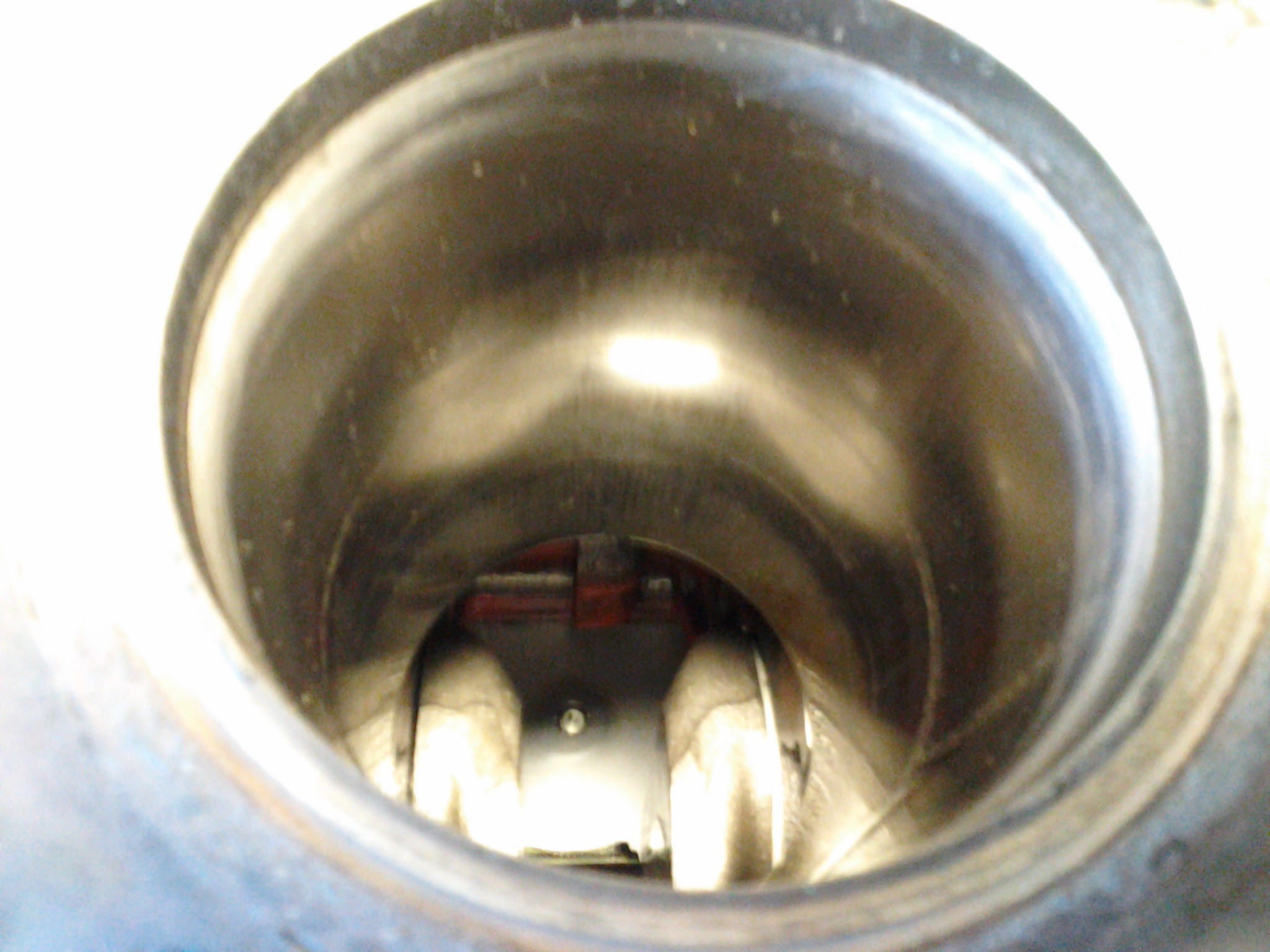

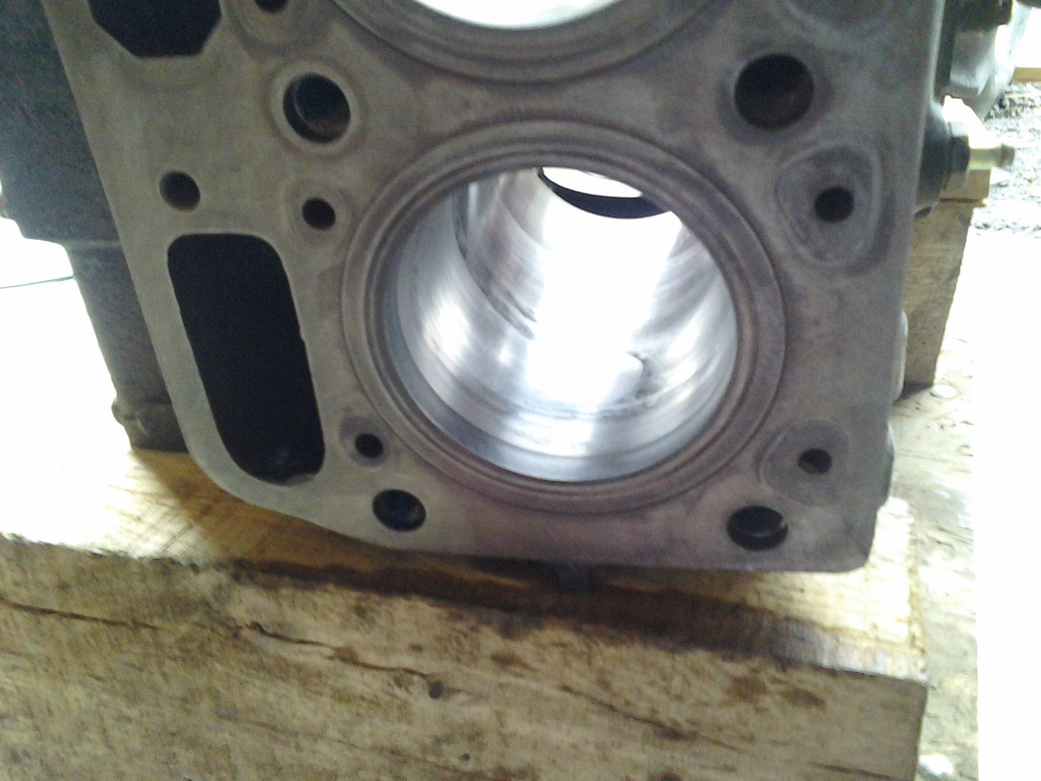

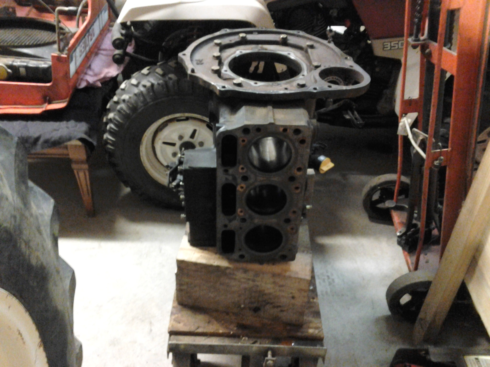

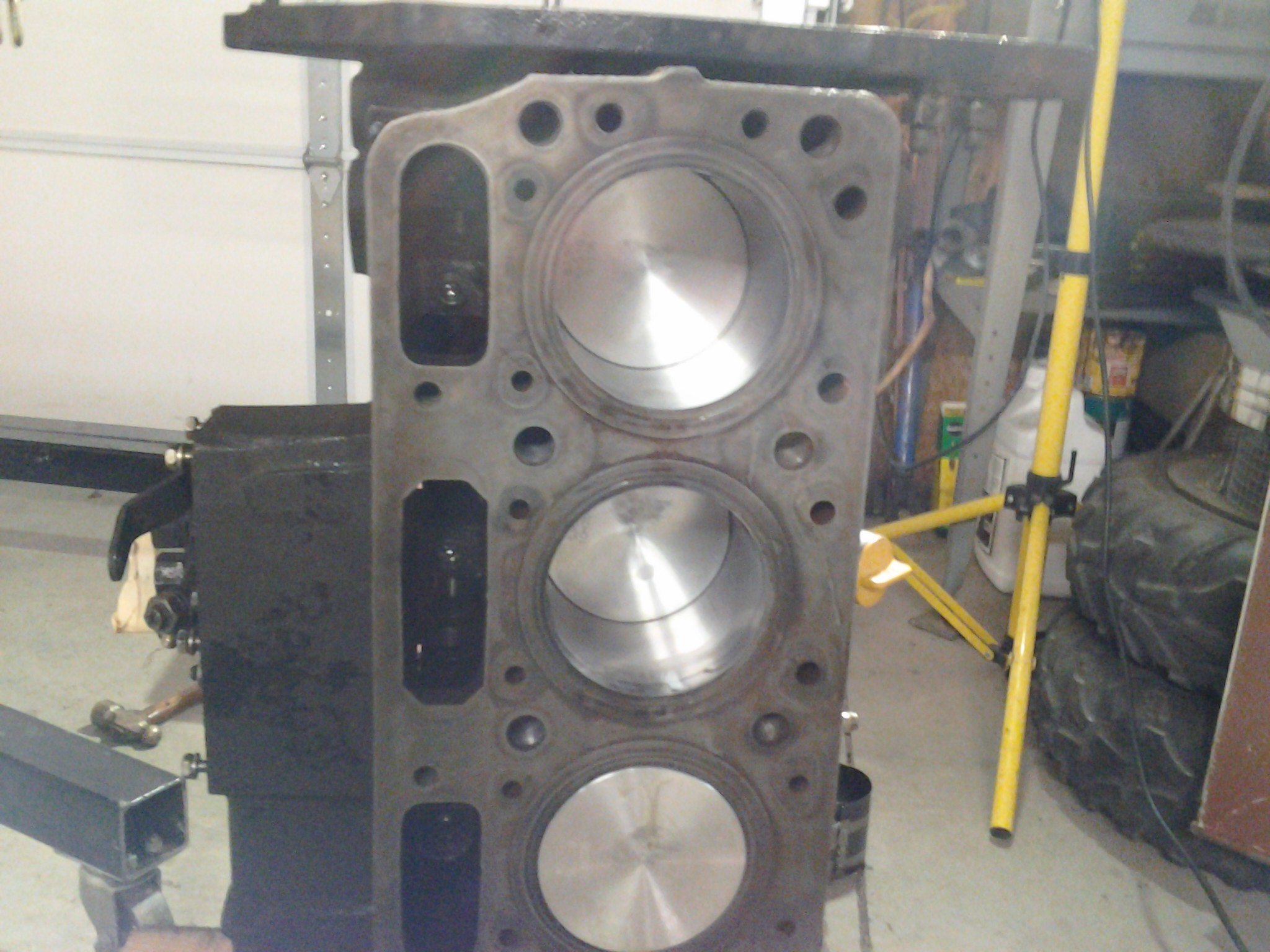

Well got all the parts for the engine. Took the block to the machine shop and had the front and rear bearings pressed in. I don't want to talk about what that cost. I was deglasing the cylinders today and noticed one of them has some black staining in it. After deglasing you could still see it slightly but can't feel it at all. The cylinder are standard with hardly any wear and I don't want to hone them any more If I can avoid it. Any comments? Here's a picture.406.jpg
/ NEW PROJECT #36
Well got all the parts for the engine. Took the block to the machine shop and had the front and rear bearings pressed in. I don't want to talk about what that cost. I was deglasing the cylinders today and noticed one of them has some black staining in it. After deglasing you could still see it slightly but can't feel it at all. The cylinder are standard with hardly any wear and I don't want to hone them any more If I can avoid it. Any comments? Here's a picture.View attachment 397599
Surface discoloration isn't bad to warrent horning. You did polish though? If you have a gauge to check the circularity to be continuious down the cylinder, that would give the best assurance.

Polish? :confused3:
/ NEW PROJECT
#38
Polish? :confused3:

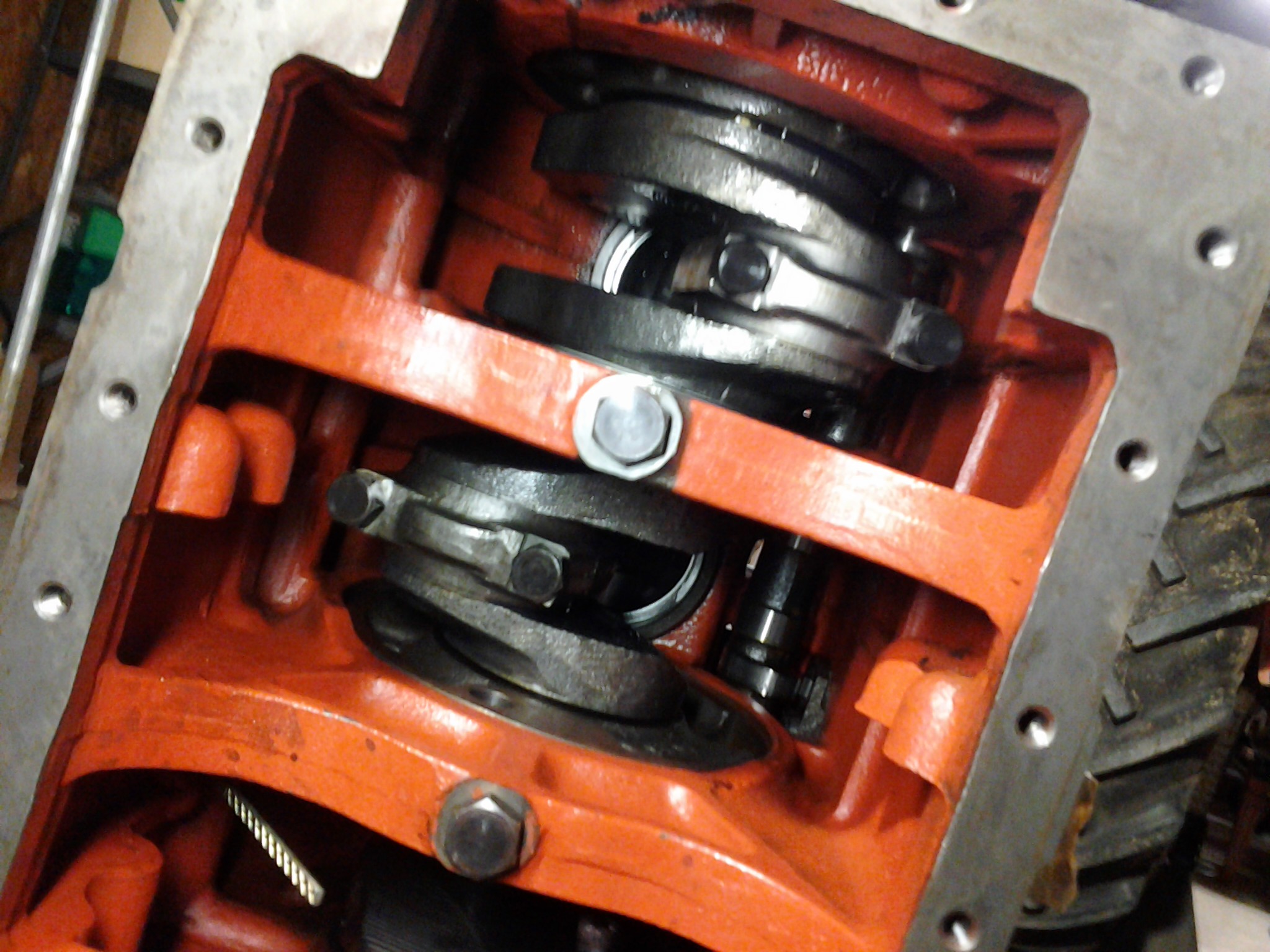

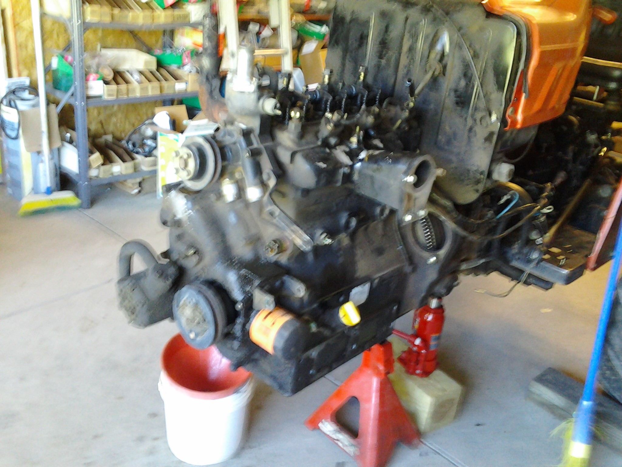

I did hone and ended up with a good cross hatch pattern. Got the block put back together today. Everything went well. New pistons,rings,1 rod,crank,and all bearings. Bolted back to tractor and called it a day.002.jpg003.jpg
