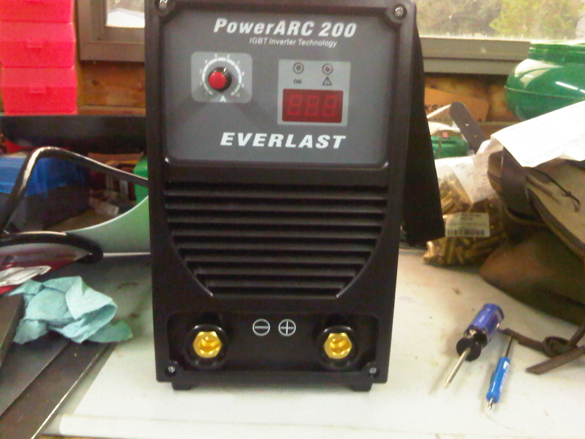

I've been in the market for a new stick welder for a minute. I was originally gonna purchase the Hobart Stickmate AC/DC from Tractor Supply, which they retail for $479.99. I also had a 10% coupon that I would have used on the purchase.
After a thourough review of this forum's content regarding the Powerarc 200, and after a couple conversations with Mark on the telephone, I decided to purchase the Everlast machine instead. The tranasction was handled by telephone with Oleg last Friday. The sale price was $315 and $35 shipping to Oklahoma City.
I pulled the machine out of the box today, and attached the plug. I haven't used the machine yet. I have attached a pic (hope it loads). I want to point out that this PA 200 does not have the 'special 6010 port' as described on the website's product information, and as mentioned before in previous discussions. Additionally, I haven't measured it or weighed it, but it surely seems smaller than the dimensions that Mark gave me verbally, and certainly doesn't seem to weigh 38 pounds.
My criticism thus far regarding my interaction with Everlast would be the following: a) It seems Everlast has an inventory management problem. Everlast was out of stock, and subsequently verbally postponed their shipment dates more than once. b) I have always been skeptical of the 6010 port anyways, but as a matter of principle, goods should be sold as advertised. I consider that Everlast might not have even been aware of the change in the product, which makes me wonder how much oversight they have of the production line. It certainly seems that had they known of the product change, that Everlast would have made the change in it's product advertisement or communicated otherwise. And if they did know about it, and failed to make the change known, I would argue that's a questionable business practice.
Lastly, please know, that I'm just an average consumer. The fact remains, that if the machine WELDS as advertised and reviewed, then I frankly don't care. But, I am a little disappointed, and hope that my fellow hobby welders would empathize appropriately.

Meriasek, I understand how you feel, my PA200 will be delivered Monday. After all the hype about how great the PA200 welds with 6010 in the special port, I don't understand why they would remove it. I posted over on their forum to see if we can get a response from someone at Everlast.
/ New Powerarc 200 #3
We didn't order anything removed. I'll check it out. Its not a regular PA 200, that's for sure. I have a note in already. We'll make sure it gets straightened out. It looks like an early edition of our new 140s scheduled to be out soon.
/ New Powerarc 200 #4
I got an email from the factory right away.
Appears they made a change we didn't order or someone creating the order on our end didn't spec it out the same as before. :mad: They assure me that it is the same performance though on 6010, and that it will work well with both 7018 and 6010. Our guy in the factory from Canada overseeing production at the time it was made must have missed this feature change.
IF it doesn't work as promised, we will make it right.
/ New Powerarc 200 #5
Does this mean that the one coming to me will not have that port either? I gotta say that a company not taking note of a major product change like that doesn't reflect well on that company. Seems like if your plant over there is exclusive, you shouldn't have to spec out every order. All it would take is "Make us 5000 more PA200s." If they made a change without Everlast's consent, you need to return them all for the correctly spec'd units or have a sale on those units that are without the additional bells and whistles.

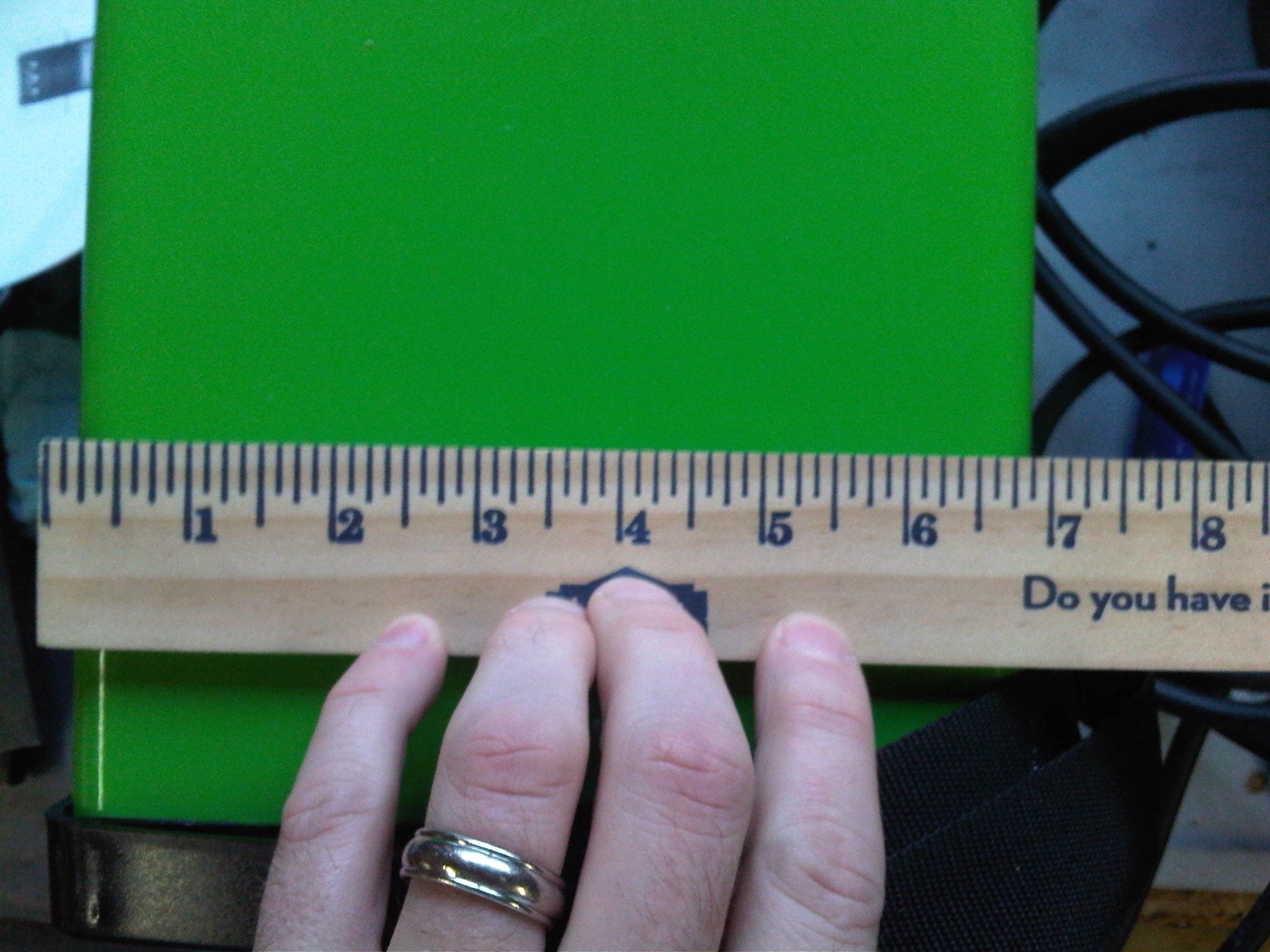

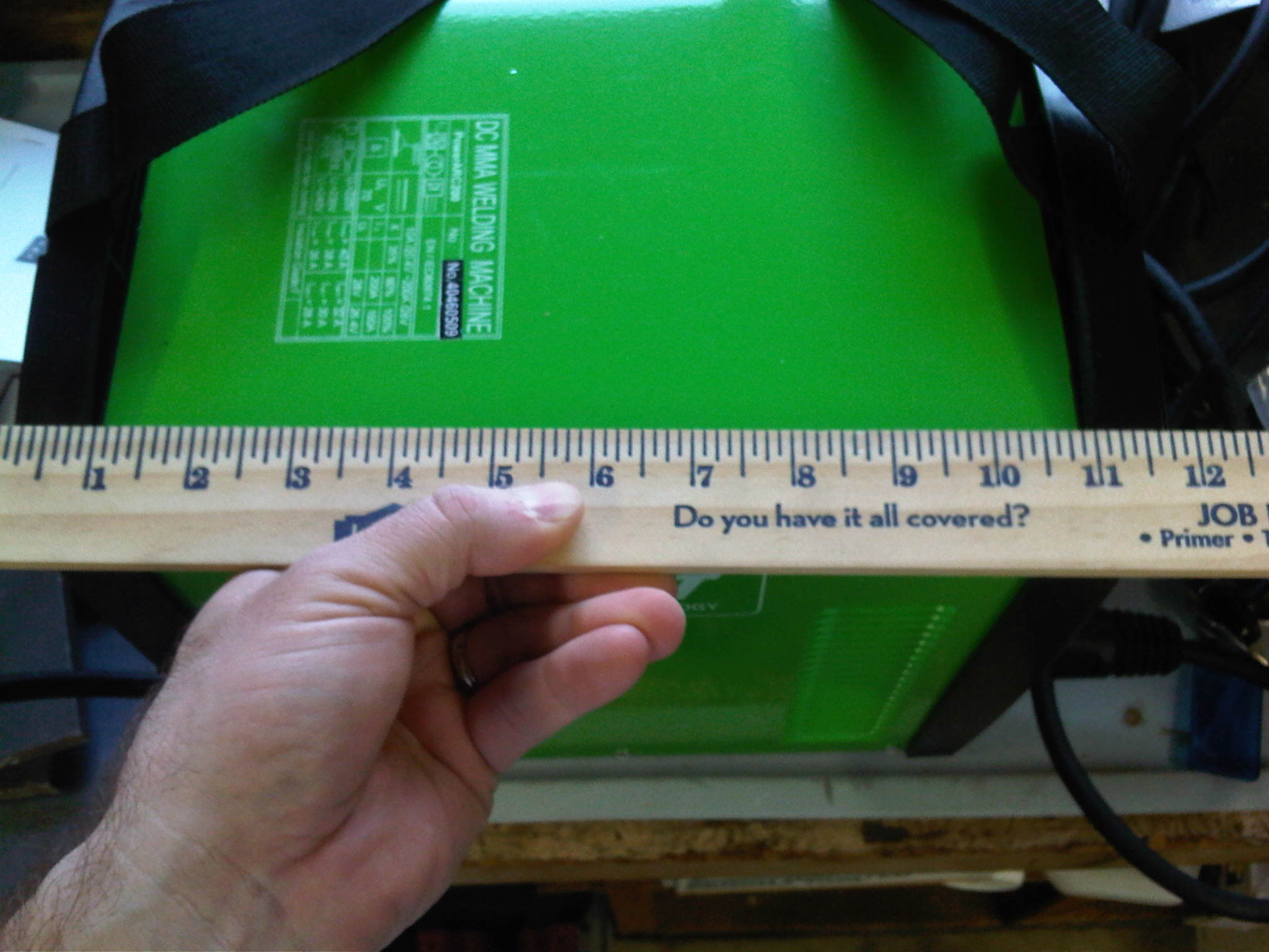

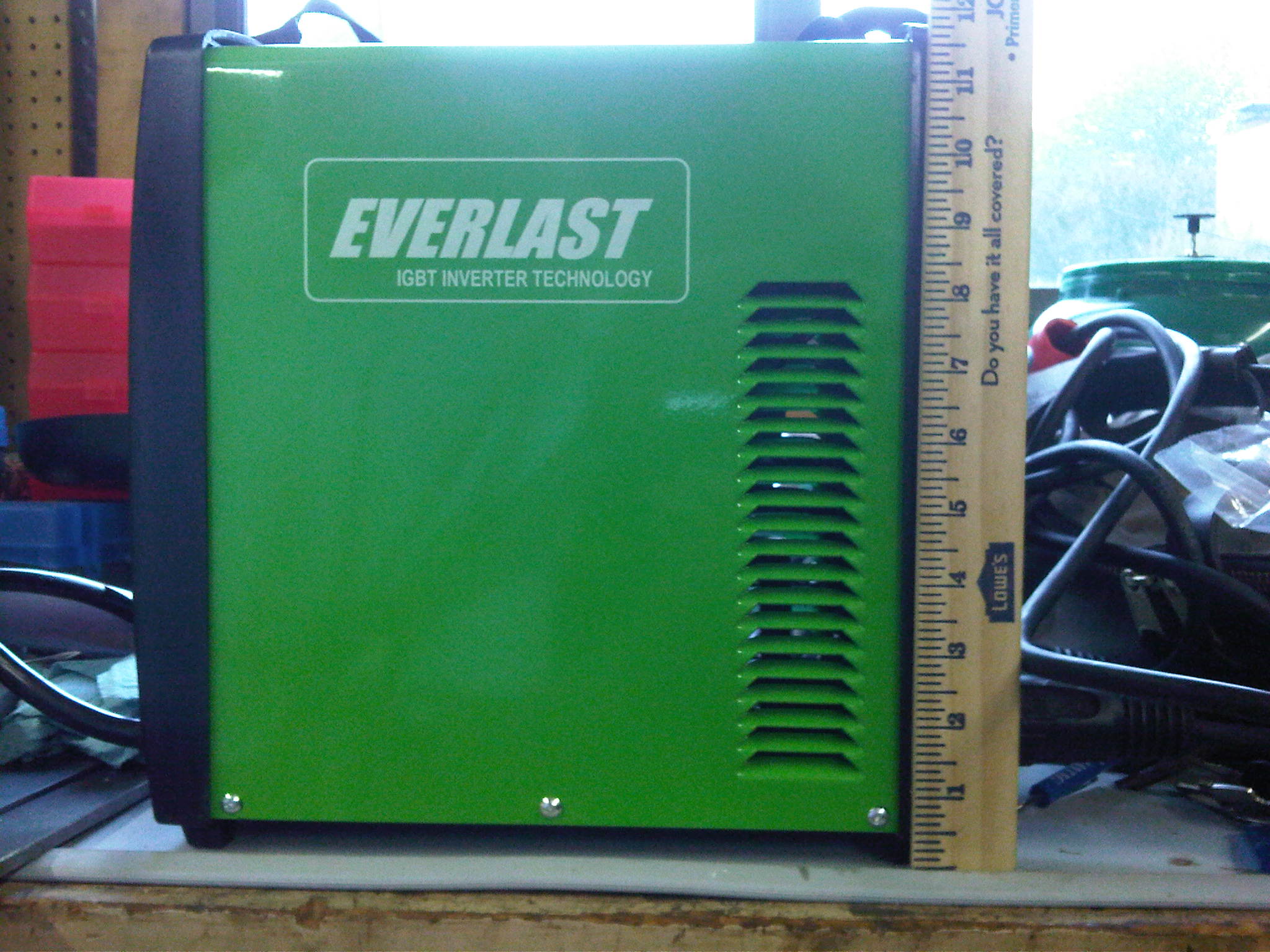

I have posted some additional pics regarding this machine's dimensions. It is roughly 12" deep, 7" wide across the face, and 11.75" tall. Again, I have not weighed it, but the UPS waybill notes it's shipping weight as 20 pounds. It definitely doesn't feel like 38 pounds as referenced on your product information page on your website.

On going dialogue with the factory has been reassuring (and we have our man over there in the factory again). They did issue an apology, and promise to make them our way and ship lcl if need be.
From the email received this morning, here's what happened, a good bit more detail arrived this morning with a point by point answer to my questions. Forgive the disjointed detail, but I'll try to bring all the information together.
The units should weld 6010 without any problem. The factory's Argentinian customer had been the first company several years ago to request 6010 operation capability> 6010 is not used in China and some other places in the world for root pass, and 6013 is used in its place. Any one ever welding 6013 knows it doesn't require much of a welder to weld 6013. Many factories in China offer a small inverter stick welder, but very very few will weld 6010 correctly. Some will barely weld with a 6013. The Argentinians used a similar but larger design in their 400 amp units to our older style. Which produced a high voltage tap that provided a great arc as people see, but for the larger machines was too much power and the reactor builds a lot of heat creating a shorter duty cycle in the larger welders, though it was highly effective. The Argentinians had worked to get a single port unit with improved inductance and voltage management system. The 3 port system is a simple way to do it, but as just pointed out it has been known to be too hot for some applications and creates heat in the machine due to the separate reactor. Anyway, the reactors were redesigned and voltage management/inductance was improved to handle the 6010 through a single connection.
As I alluded to before, we were working on our new 300 design to be a conventional 2 port, and were surprised that the factory said no problem and I was a little surprised because I expected some development time and units sent for testing...It appears from this mornings email, the Argentinians were ahead of us and gotten it worked out and footed the "bill" so to speak. Of course, we did not plan on this coming in the 200 for some time, and wanted to use it in the smaller quantities of the 300 first. The factory took our request to mean we wanted it to be incorporated into all our units.
Hot start and the adaptive arc control is still built into the machine.
Of course, I will get hold of a unit quick as I can and verify this myself...But to sum up, yes, the units have been changed in this order. We can go back to the original if we need to. But IF this works, we may keep this. But if customers aren't happy, we can definitely turn things around and get some here as reasonably fast as possible and replace them with the original style.
Here's what I will ask our customers to do: Use the machine, see if it is capable for your needs. If not, we will put the manufacturing into gear on the old style and get them coming as soon as we can and will replace them soon as possible. Or if a customer insists, we will refund the product. After the email and given the detailed explanation, I have no reason to believe the factory was blowing smoke, and go on their advice that the unit will indeed work with the 6010 well. But, of course, the proof is in the pudding.

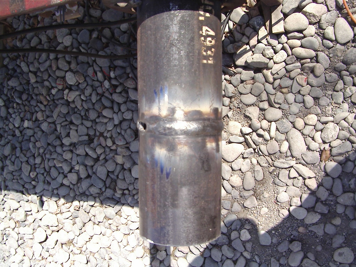

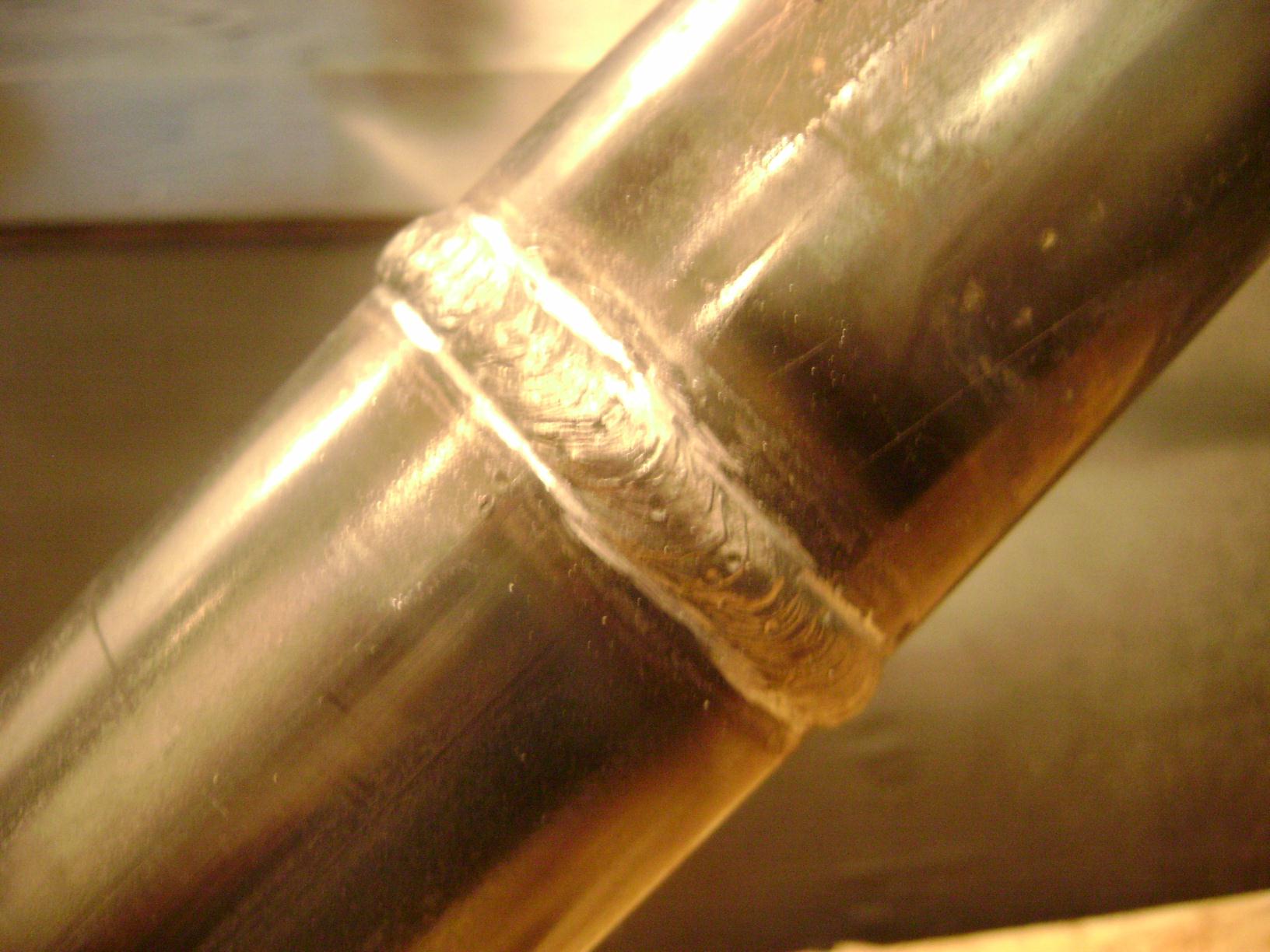

i have had my pa200 for a while now but, for a number of reasons (not least the weather) i haven't had much chance to use it.
i have to say it welds structural steel very well, no complaints.
pipe is another story, and as you can see, i'm still trying to dial it in.:laughing:

Nice looking weld except for that little "pin hole". lol

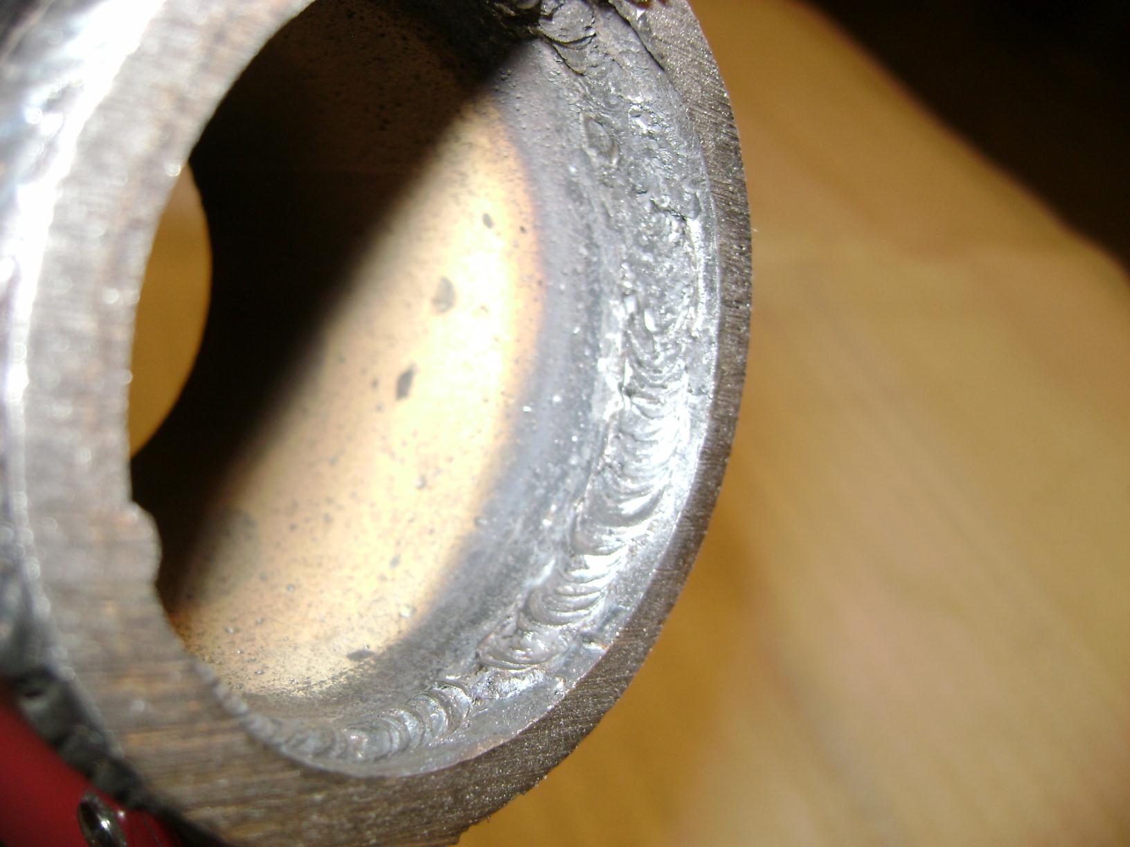

Wow I guess I lucked out, my PA200 does pretty good on pipe. I'm the weak link. :eek:

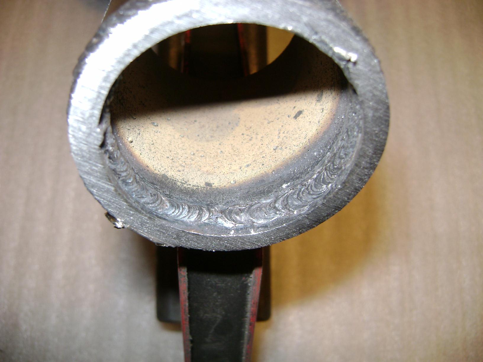

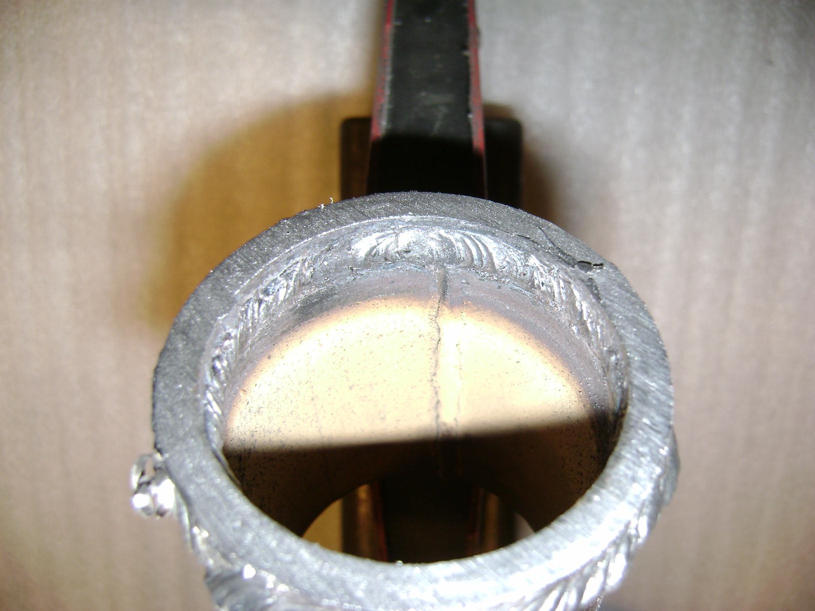

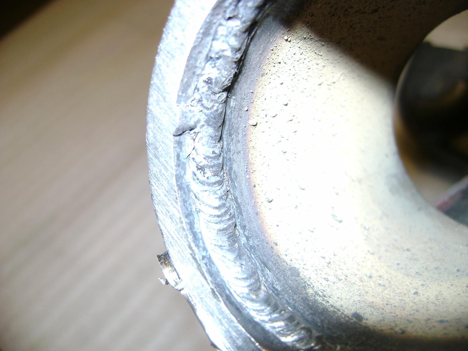

If your not working to a WPS, try some Hobart 335A 6011. My PA 200 loves that stuff!
For 5-G vertical up I use 5/64" land and a 5/64" drill bit to set my gap. Around 65 to 70-amps for 1/8" rod. If the pipe closes up on me while tacking, I take a die grinder with a 1/16" wide disc to cut the gap back open.
