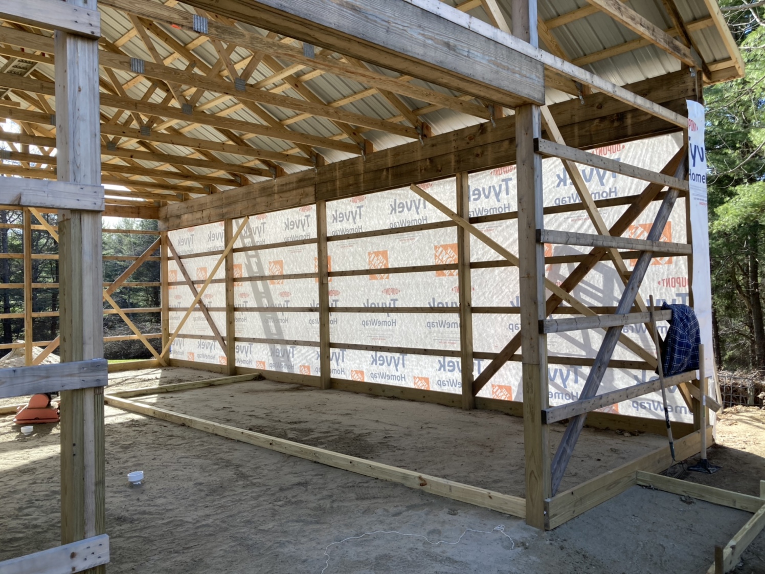

Latest update. Still waiting for the concrete floor to be poured. Put in the forms for the aprons that will connect the 2 overhead doors to the driveway. Today we put the Tyvek on the back wall and then put the siding on. The other 3 sides have to wait until after the floor is poured. Will be working on the soffits next as weather and energy permit!

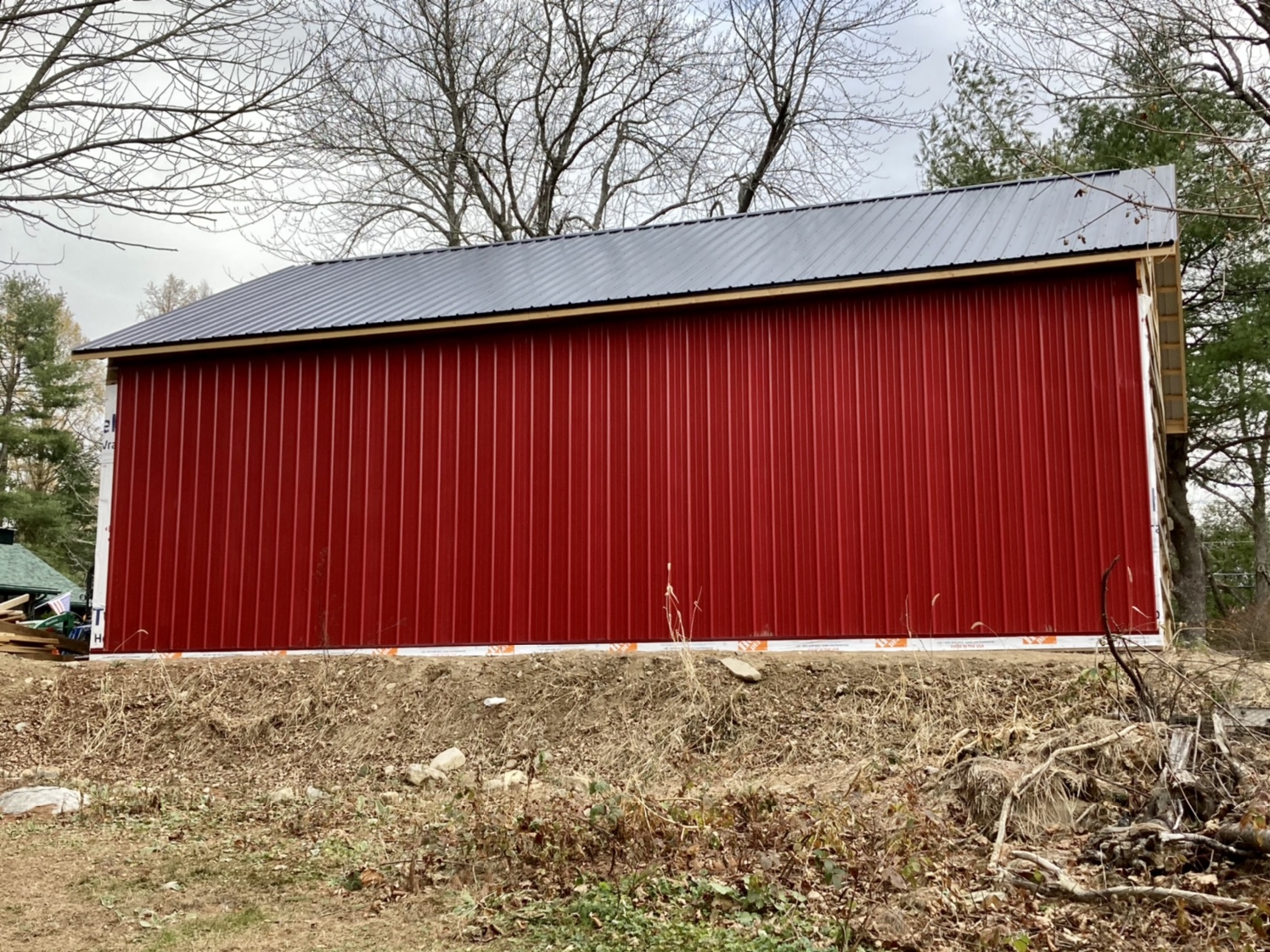

Red is still my favorite color for a barn!!!!

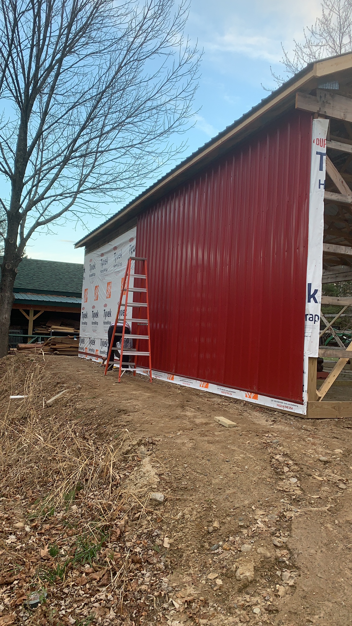

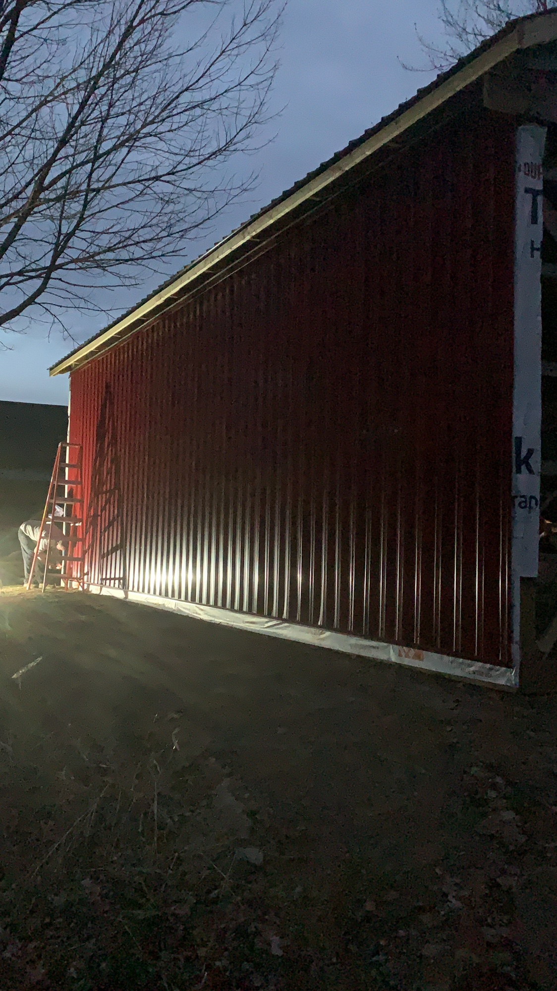

Daytime picture. Need to trim the Tyvek at the bottom of the barn.
I still have Tyvek poking out from under the siding on one of my barn additions. It's so simple to go trim it with a knife that I never get around to it!!
   / New Pole Barn Started #79
I'm glad to hear that I'm not the only one :laughing:
S219 you described it perfectly, I usually do trim it during construction as it's just so easy and (I don't know why) rewarding, but never get around to trimming the few areas where my knife catches the wood grain and takes a little detour away from the bottom closure or "rat guard " as some call it.
