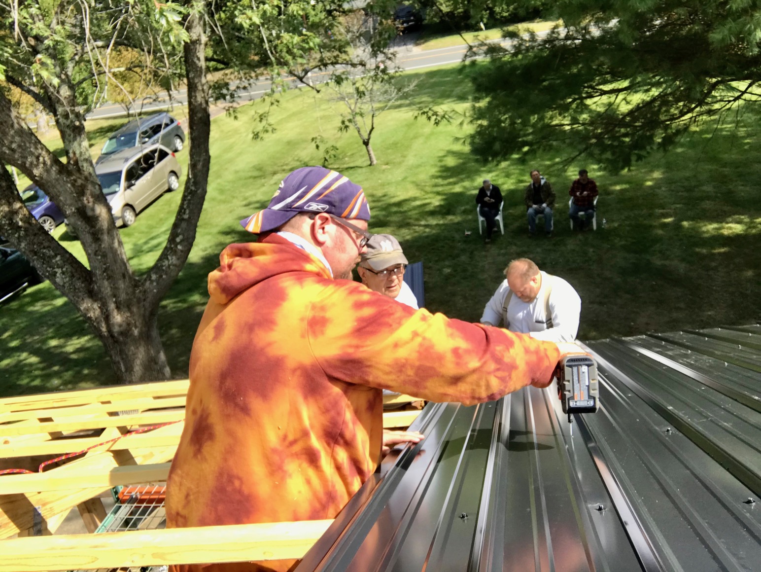

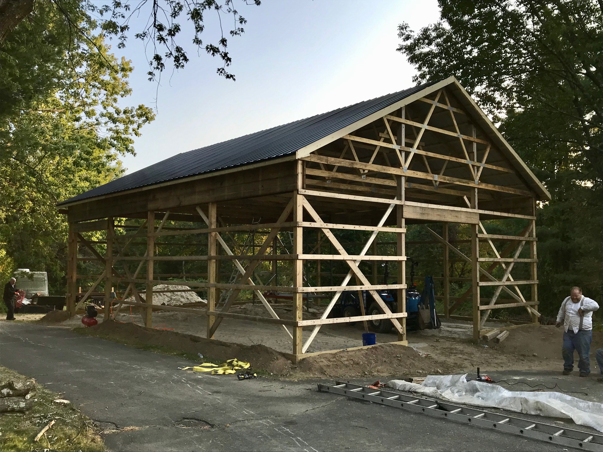

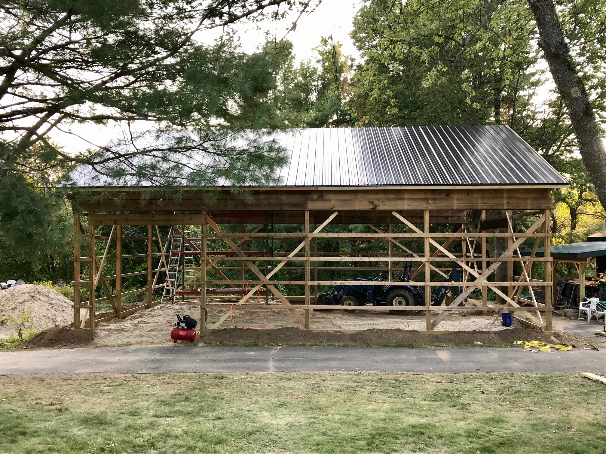

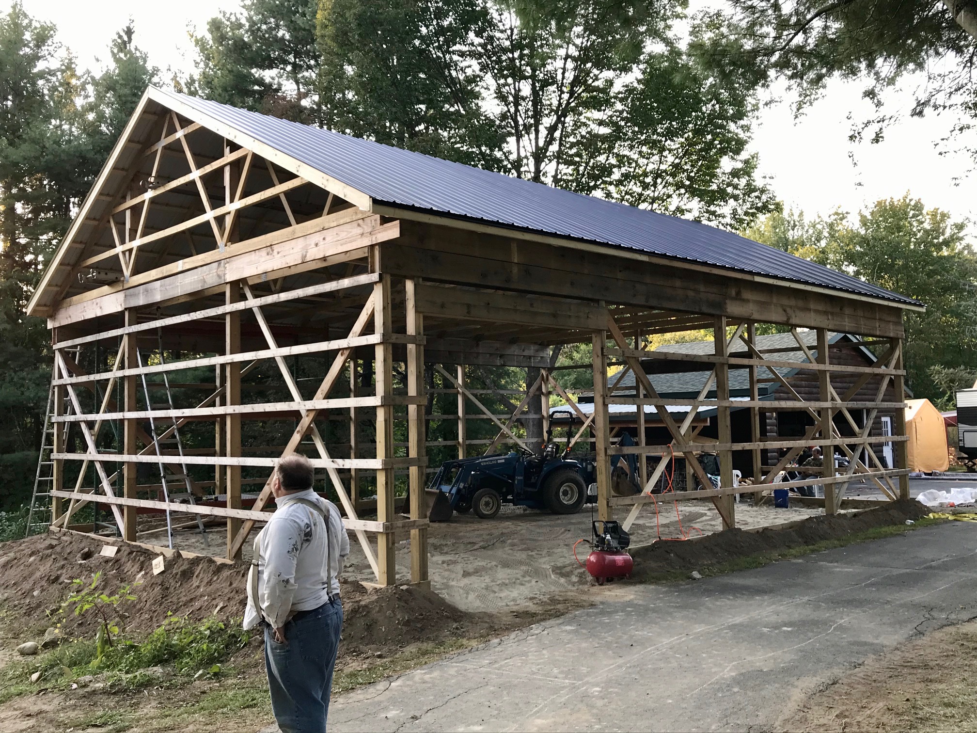

Monday we put on the fascia boards, added extra bracing to the walls and pre-drilled all of the metal roof panels. Today we put on the metal roof. Had 4 people on the roof and 3 people on the ground delivering roof panels. Used a rope and c-clamps to pull the panels up the roof into position. We had 3 platforms to work from - 12' shelving at the low end, a kicker platform a mid level and a kicker platform at the peak. Allowed us to work safely and not climbing on the outside of the roof.
Here's the crew. The roof crew worked hard all day. The ground crew had some time to relax! The ground crew had over 200 years experience between the 3 of them! The roof crew was 3 pastor's and me! I think we had the good Lord on our side today!
Roof is on.

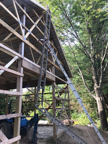

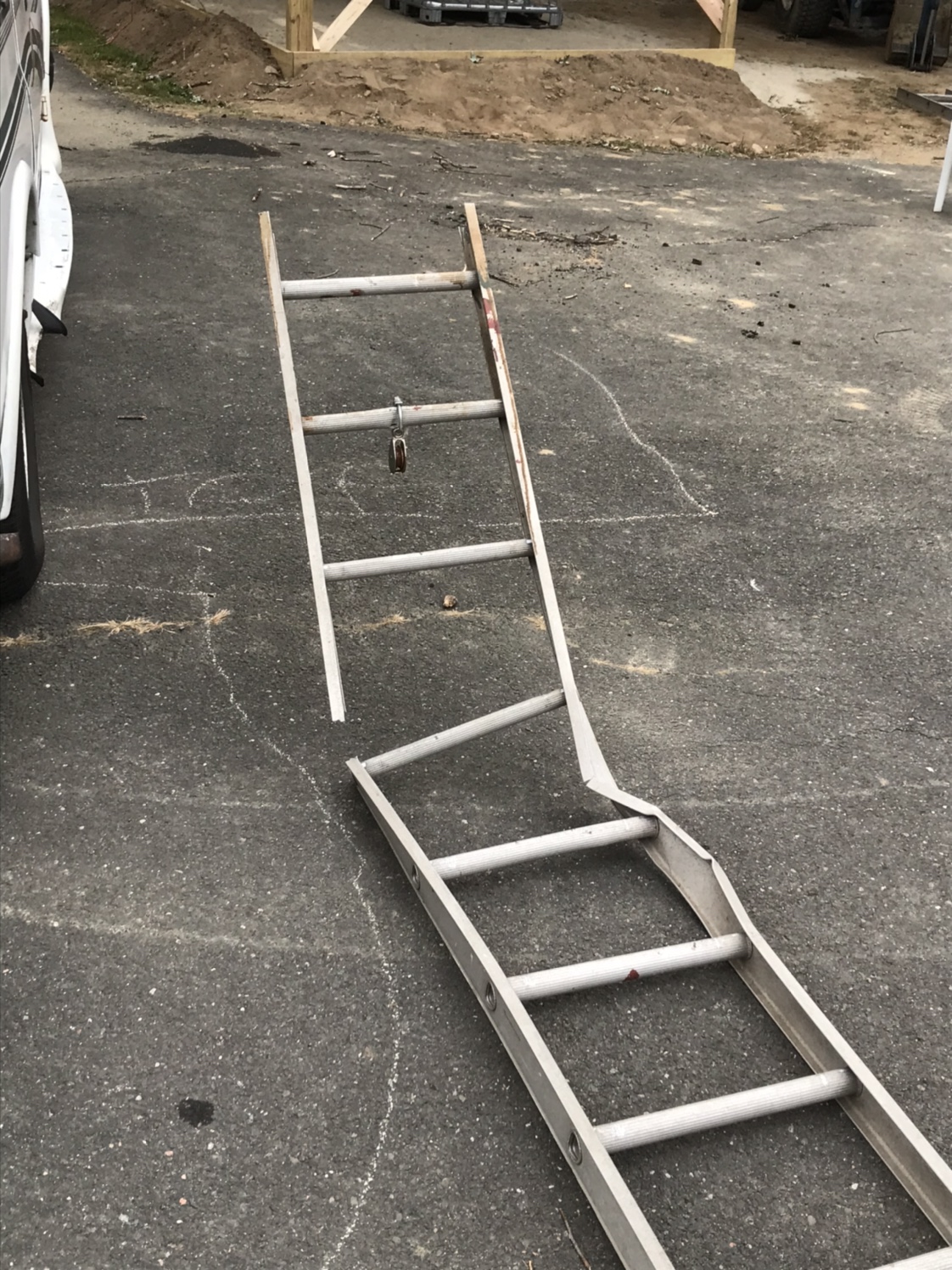

Had a setback today. Was on the roof putting on the ridge cap. Got it on in 30 minutes and as my brother-in-law was climbing down the 24’ ladder it collapsed and he fell 12’ to the ground. It left me hanging off the edge of the roof but I was able to climb back on with only a few metal cuts on my arms. My BIL went to the hospital to be checked out. No internal injuries and no broken bones but a slight concussion. Very grateful no one was seriously hurt. IMG_1317.JPGIMG_1321.JPGIMG_1316.JPG

Wow, sorry to hear that but glad it wasn't worse. I have had too many ladder accidents.

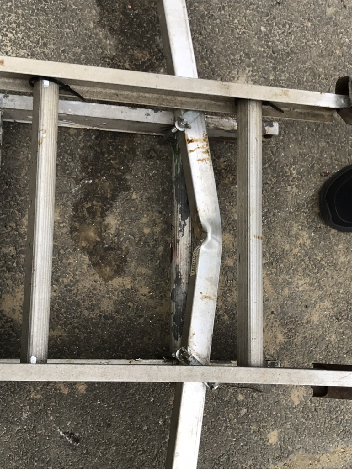

That is an odd place for a ladder to fail, so it makes me think there was prior damage in that spot. Maybe a ding or dent or something that led to the failure?

After the accident, we looked at the ladder, and upper section of the ladder fits inside the lower section of the ladder, with the edges of the beams riding inside each other and they get locked in by the rungs. The lower section was not longer square, with one edge wider than the other, and that meant the upper section was not locked into the lower section. So it appears the 2 sections partially separated when my brother-in-law got to the mid-point of the ladder. Then it twisted and one side sheared in half. It was a class 2 ladder and well over 20 years old. I won't be buying one of those again. My father-in-law brought over his class 1A ladder, and it is built completely differently with actual metal brackets holding the 2 pieces of the ladder together. His has a 250 lb limit vs mine at 225, but the difference is night and day in strength and design.

I always buy the 300 pound ladders. Not that I weigh that much. But with fully dressed in winter gear, boots and carrying something up a ladder, I figure I am over a 250 pound ladder. Glad no broken bones. Stay safe. Jon

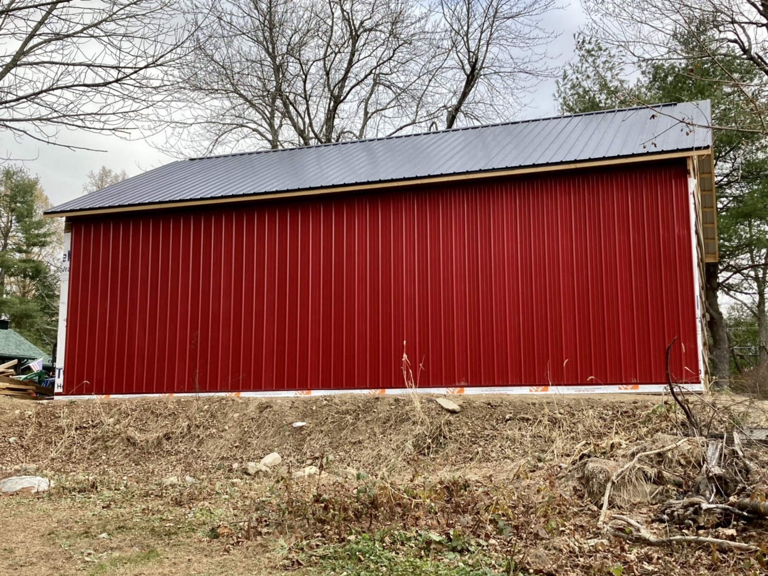

Latest update. Still waiting for the concrete floor to be poured. Put in the forms for the aprons that will connect the 2 overhead doors to the driveway. Today we put the Tyvek on the back wall and then put the siding on. The other 3 sides have to wait until after the floor is poured. Will be working on the soffits next as weather and energy permit!

Daytime picture. Need to trim the Tyvek at the bottom of the barn.
