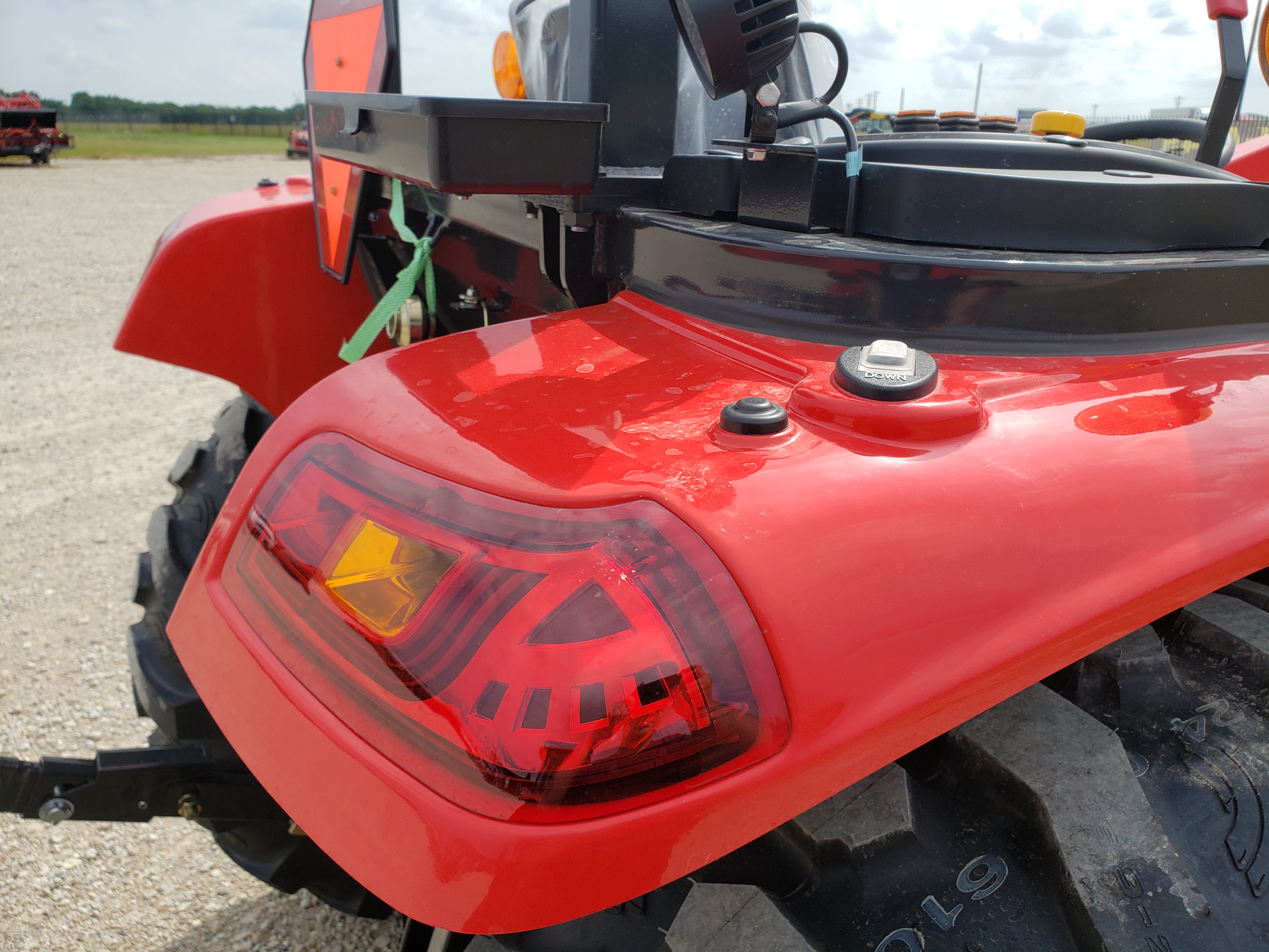

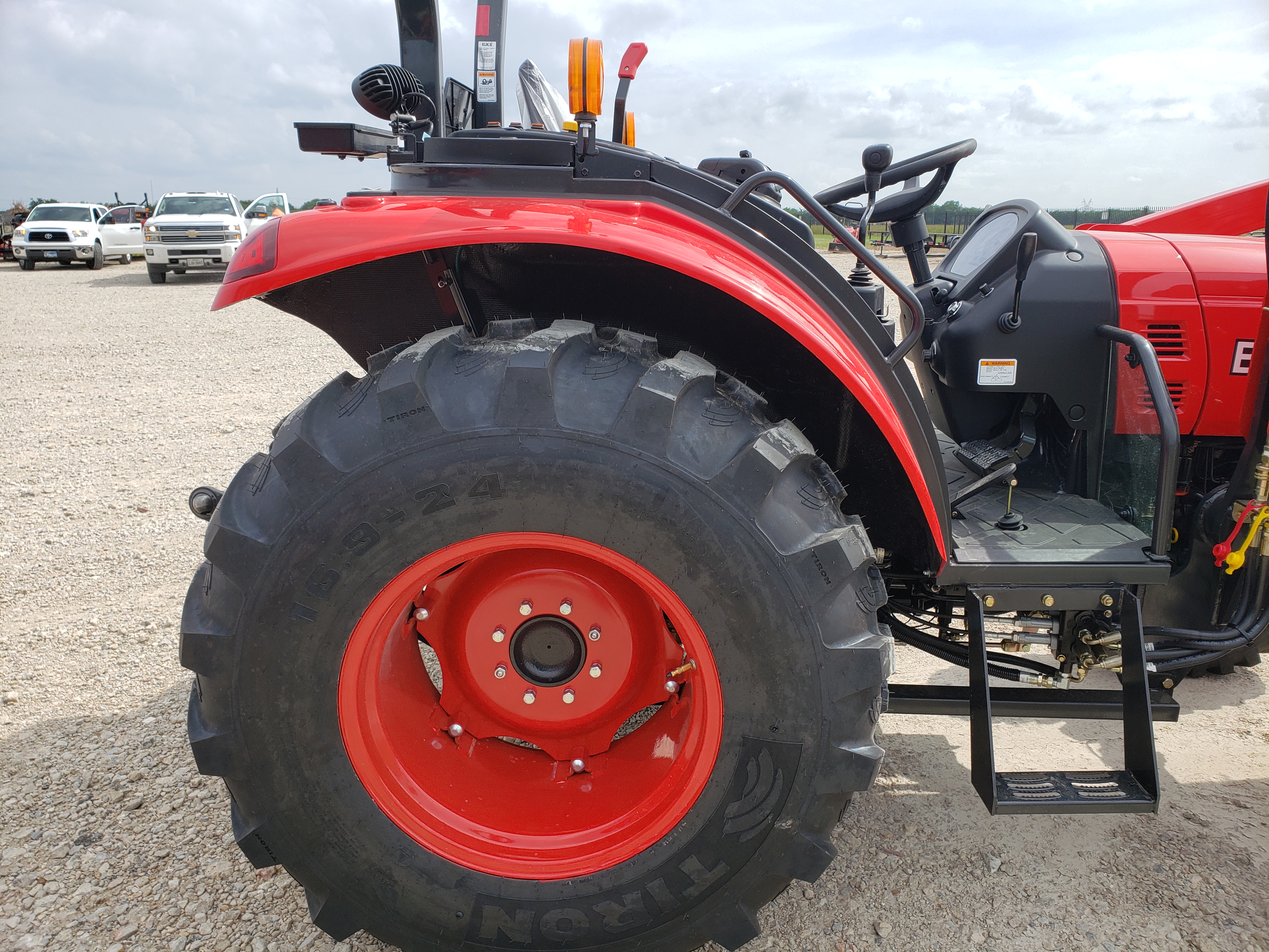

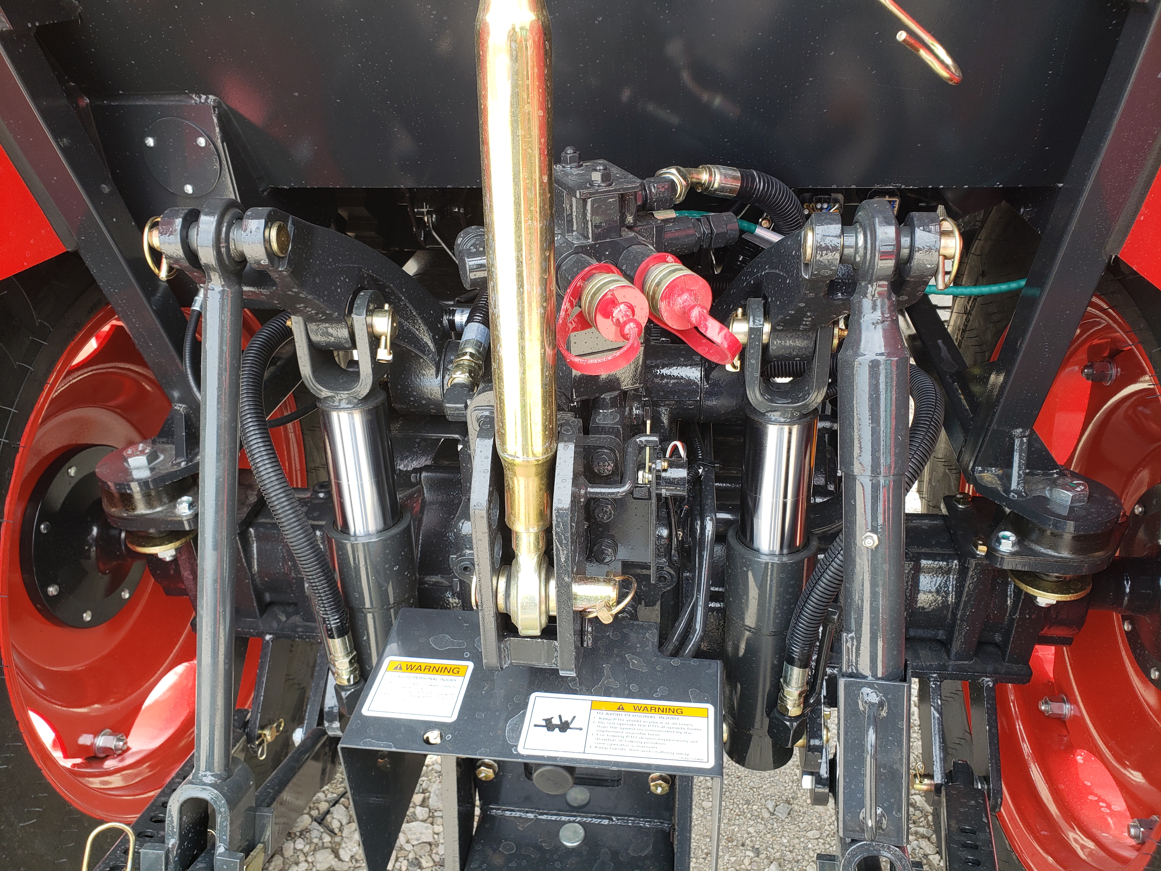

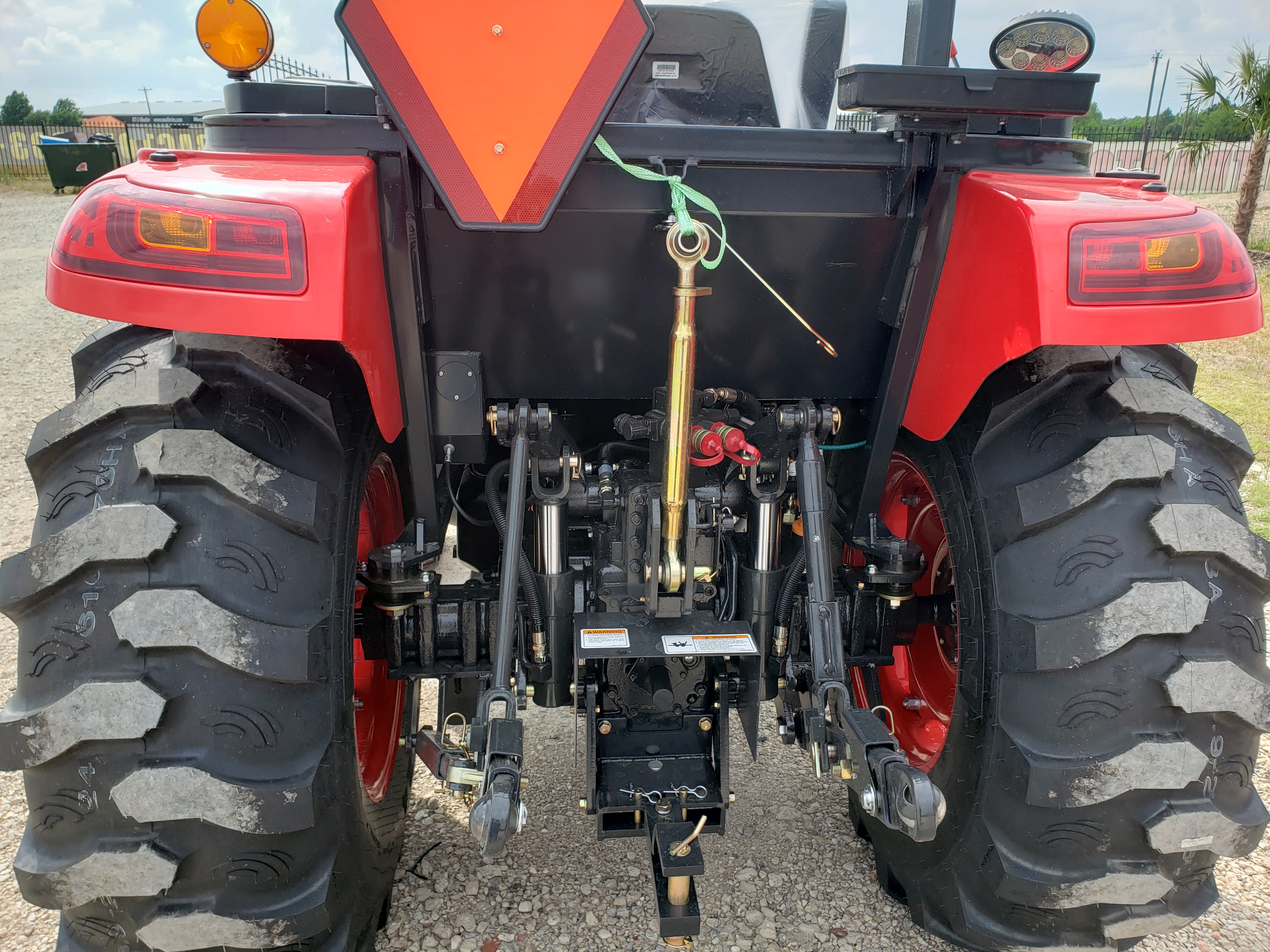

o so we juts got the first load in off the truck here are some more close up pictures of the new 5835R, and i was mistaken the 6225 won't be coming to america, however they will instead be releasing a new 65 hp model in 2022 which i've been told by our dealer rep will be the 6535R
we will still be getting the 7445, and the Branson 110hp which has yet to be given an official designation.
i attached a few picture sthe rest are at the link below

Nice machine! :thumbsup:
I see only one PTO speed. Is this the only option or there are more speed available as an extra?
I also see a wire for the front axle, which I'm think it's for the Auto 4WD.

Thanks for the update Asteral. I'm curious if the tractor pictured is delivered "standard" with the one rear remote, or was that ordered by you with that added option? Will there be additional options available at time of order, like say 2 or 3 rear remotes, adjustable lower link arms on both sides (like the 25 series) instead of just the right adjustable arm, etc.
Thanks for keeping us up to date.
/ New model coming out this year #9
Oh, and I like the flush mounted rear brake lights, instead of the pods above the fenders. Looks nice.
And I think you need to let some air out of those back tires.
:D

so i've been told they come with more options than what is on this one, the particular one was ordered for a particular customer who wanted it this way..., as for the other options you can get a dual or tri port rear remotes, and there is a different option for the pto speed as well, this will be the first model to come out with a manual regen button to engage a regen on the dpf/doc filter ( no DEF Fluid, or ECU control on the tractor i'm still looking into how the regen is controlled without an ECU though) all in all they appear to be a pretty solid line of equipment with more HP models coming in the next year or two( 65HP+ models and the like), with Cab options available as early as Q1 on 2021, it seems Branson has finally figured out Most Farmers need a bit more power options available than just a 52HP
