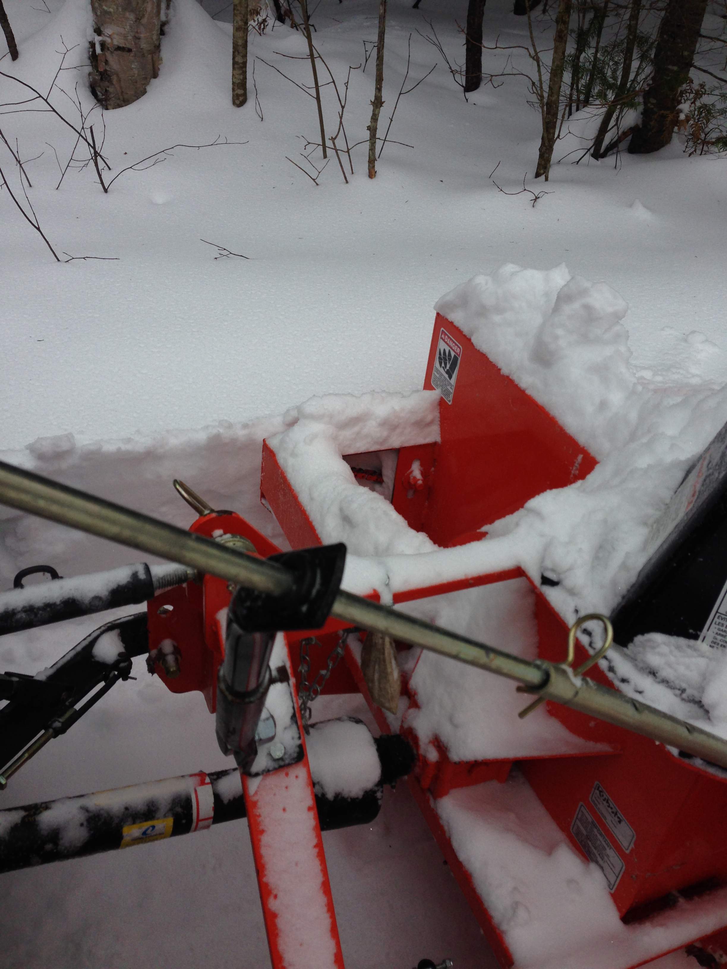

Kind of like this:
Regarding traction, I have NEVER run out of traction when I had these on:
