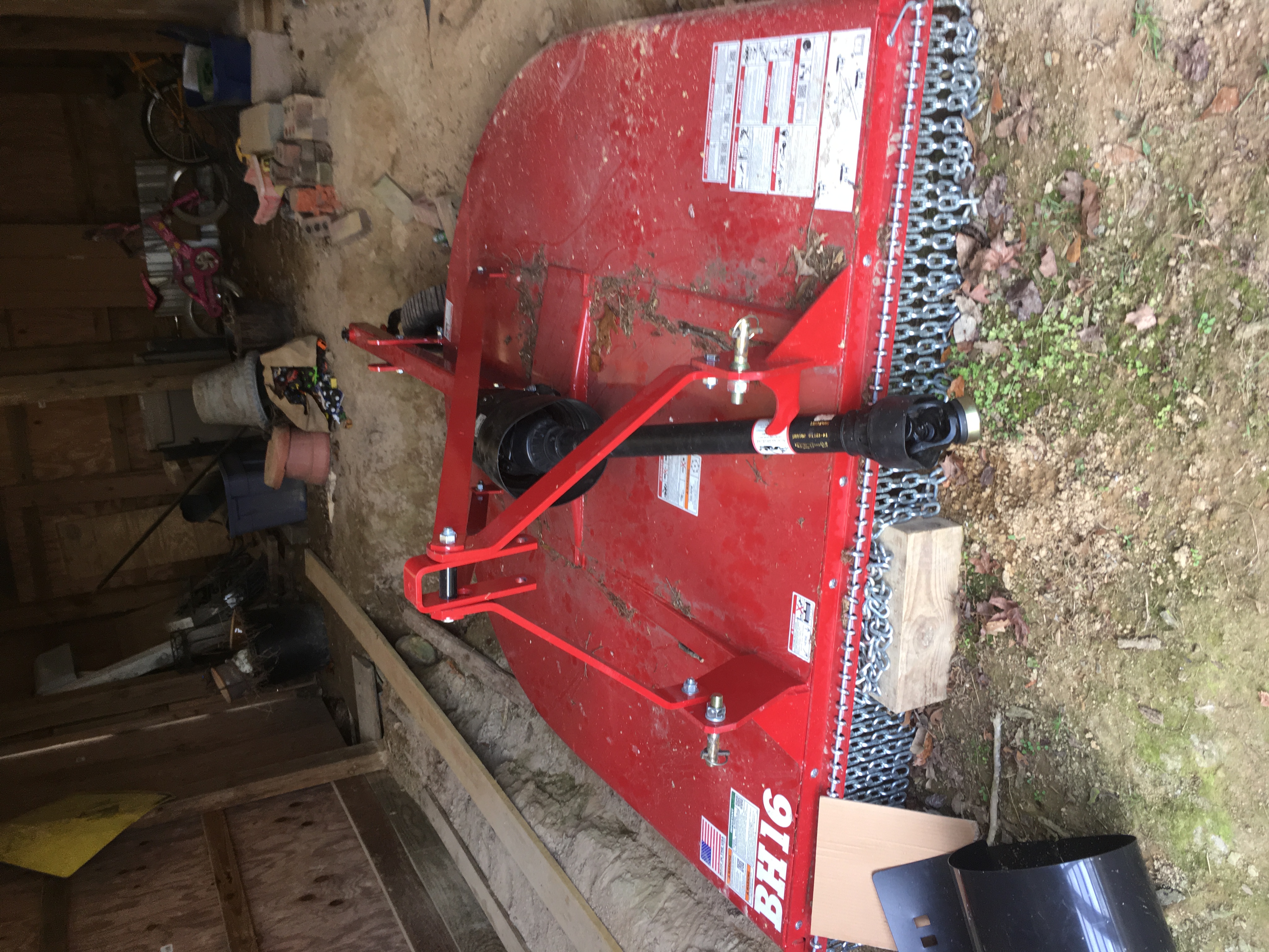

One of the items I need help with is how to hook up my tractor and bush hog with a quick hitch. At the time I acquired the bush hog I did not consider a quick hitch, so the dealer provided the bush hog for direct hook up to the tractor. Now that I want to use a quick hitch I realize the bush hog does not fit the quick hitch and I have not been able to determine how to connect it safely to the quick hitch. The Bush Hog operating manual shows a different kind of bracing on the cutter than I have, so I have tried, without success, to contact Bush Hog directly for advice. I am attaching a photo of my bush hog in the hopes that one of you have some advice for me. IMG_0219.jpg

Just a quick note. Seems the U shaped bracket on the top needs to be horizontal, open end forward with a pin in the extra hole, to accept the top hook on the quick hitch.
