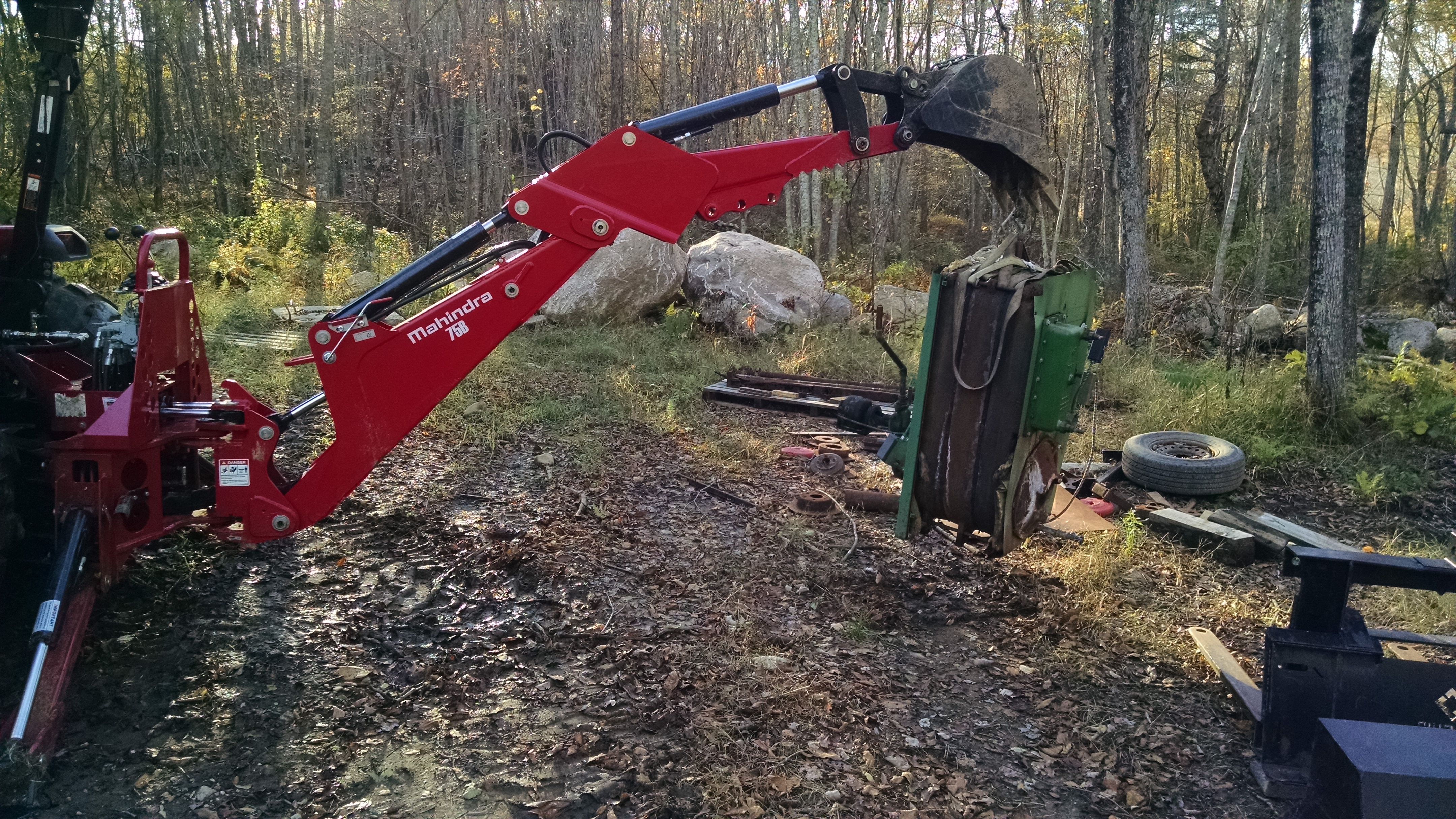

Yes, I have one. I bought it this past summer - installed it myself. In general I like it. Like I mentioned, the adjustment of the boom relief valve made a big difference. From the factory, they were all set at around 3k psi. If you tried to set the boom at one position, and use the other functions to apply force (bucket when prying a rock or root, crowd when lifting, etc), the boom would drop. Bringing that boom relief up to 4k psi made it much stronger, as the boom will now lock into place much better.
Here's a picture lifting an old GM boiler. I would estimate this at 1200 pounds. IMG_20161031_161515194.jpg

Nice! I wonder if they would know how to do that for me at the dealership. Not sure. They have only been selling Mahindras for a few years. And learning as they go.
