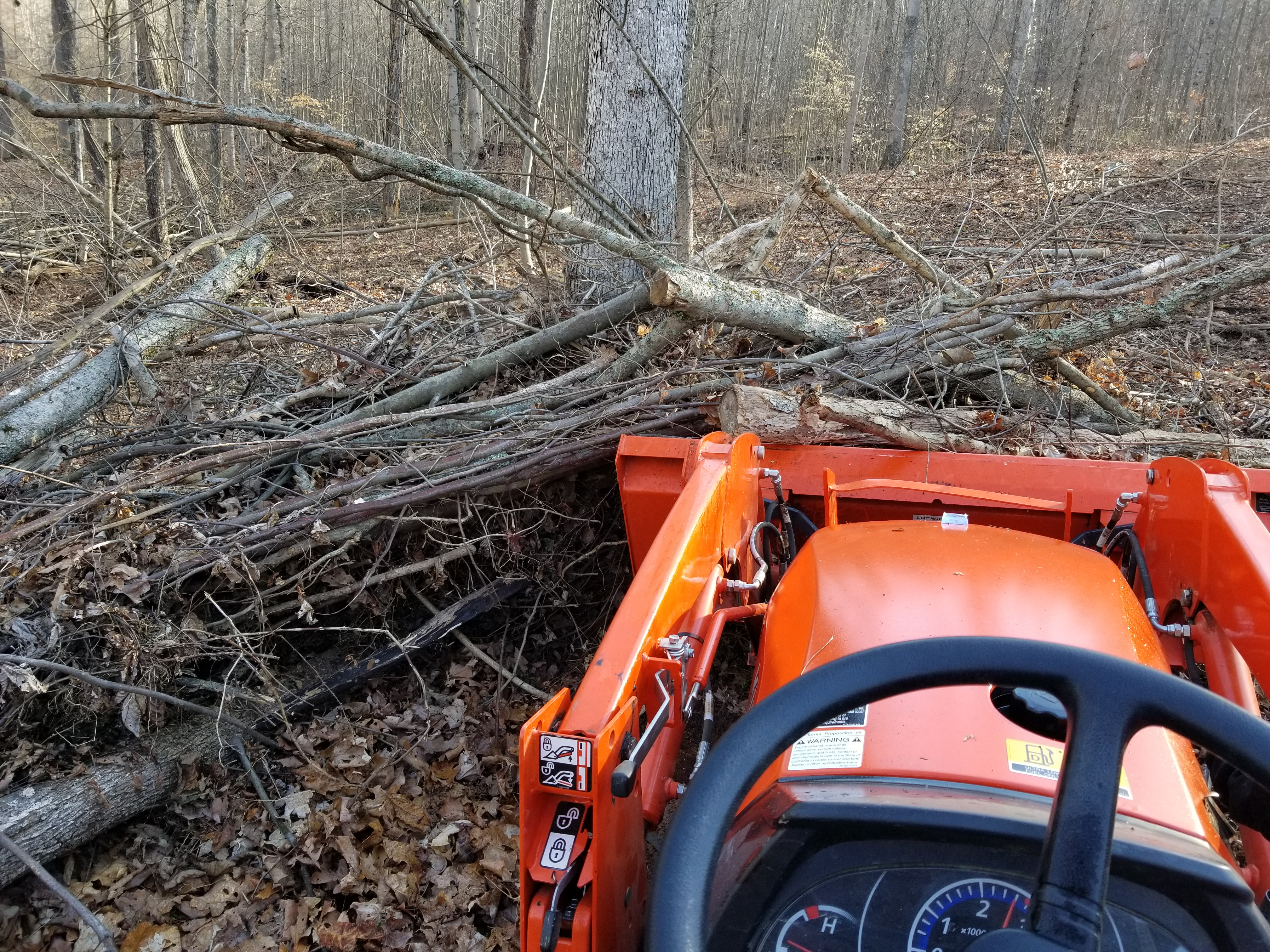

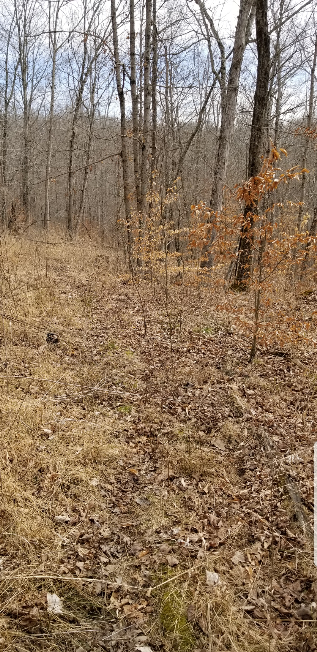

I currently have a b2601, r4 tires and I'm really disappointed with it. Been an ongoing issue. I have a tiller, brushhog, boxblade with it.
Kubota now does 84 months on the L series and I'm considering getting the L3901 with R1 tires and grapple.
I'll include some pictures of my projects because I need help on which grapple and considerations on a disc harrow. Projects are clearing areas for food plots in woods, some unworkable hillsides that cannot be tilled will go into native shrubs. Small trees I want to grapple the roots out of the ground. I want to move trees/brush piles around that I take chainsaw too. I also want to grapple old stumps out of ground if possible. I need to grapple larger rocks put of ground.
My current tractor gets hung up pulling a box blade on my old logging trail I wanting to till up. It gets stuck while moving brush piles around slides around causing me to get stuck against tree or stumps. I want something when I hit the gas it goes straight and doesn't slide.
Disc considerations. I feel I have to have a disc because I have a 10 acre open fallow field I want switchgrass in and it needs to be either burned or disc every few years to keep it in switchgrass. I also want to disc it in the winter to enhance native forbs. My current tractor is perfectly fine for this field but it's all it could maintain. I want a disc I don't have to add weight too. If I did get the disc could I also trade in my tiller for extra cash help? 90% of this field hasn't been worked in 10+ years I think. Would I be extremely disappointed getting rid of my tiller?
How does a disc hold up to rocks and roots i miss on the woods I'm clearing? I had about an acre dozer off and there's still some roots/sticks lots of rocks. I understand pick them up but your always gonna miss something. How well will a disc hold up?

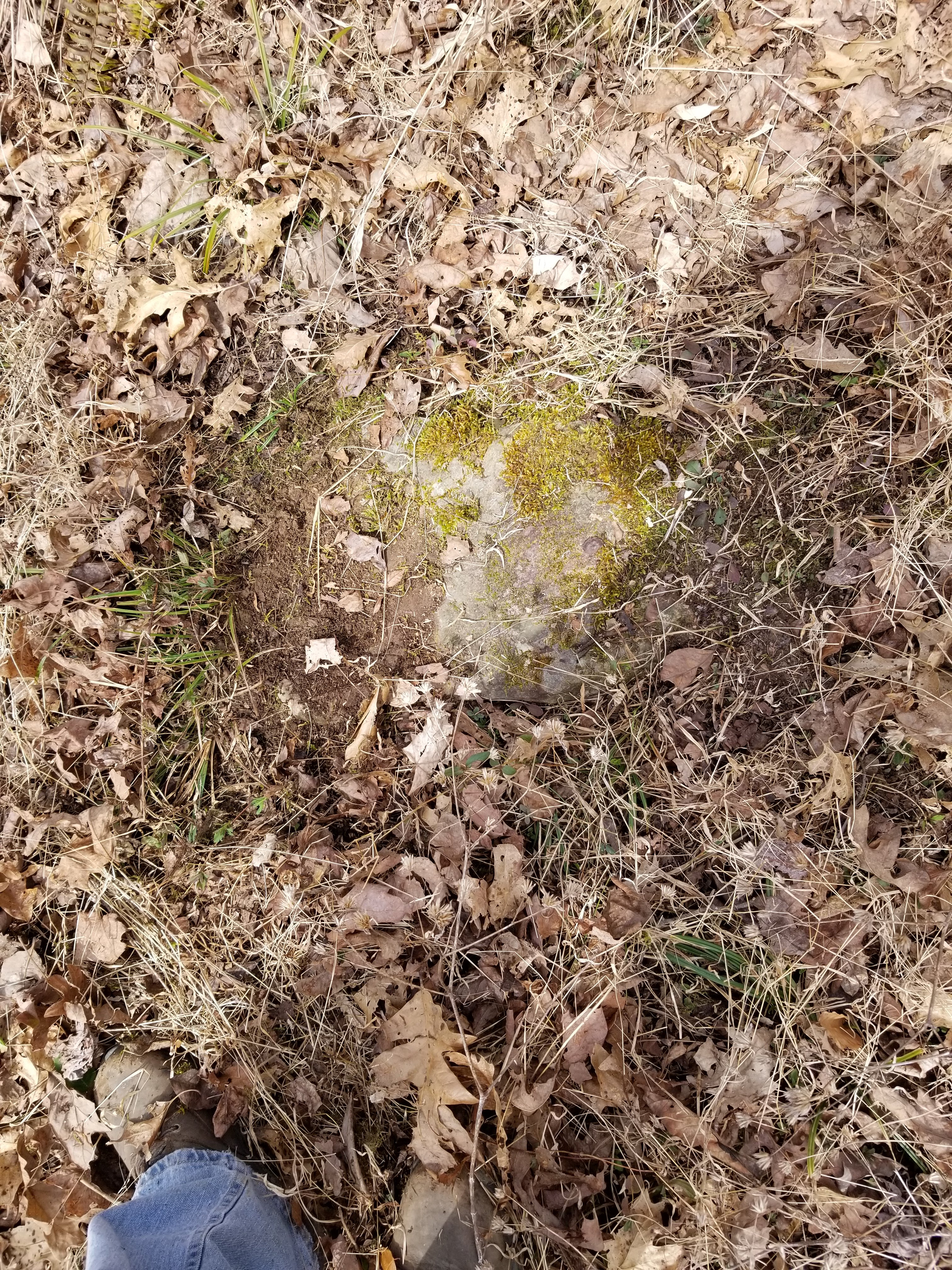

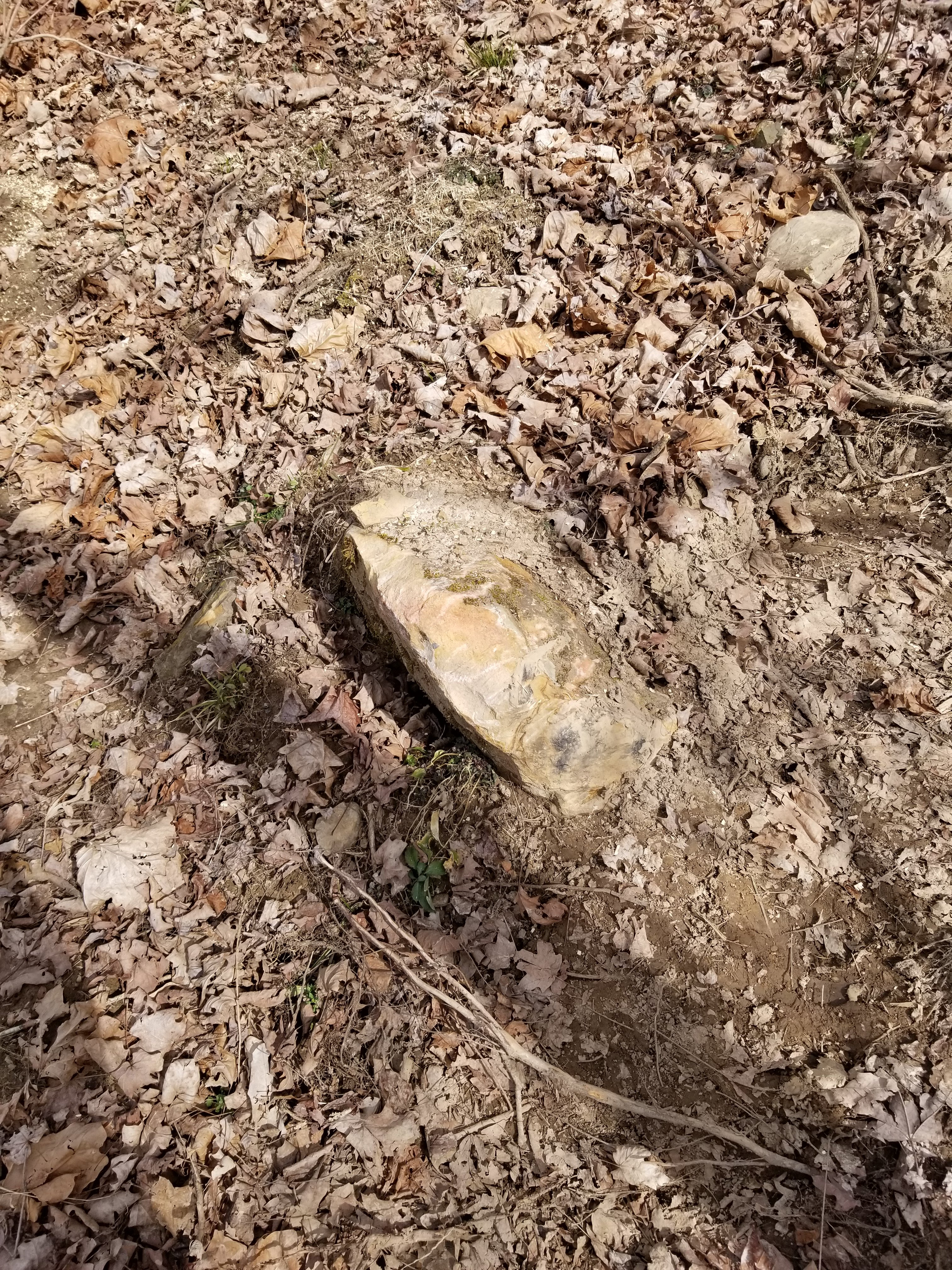

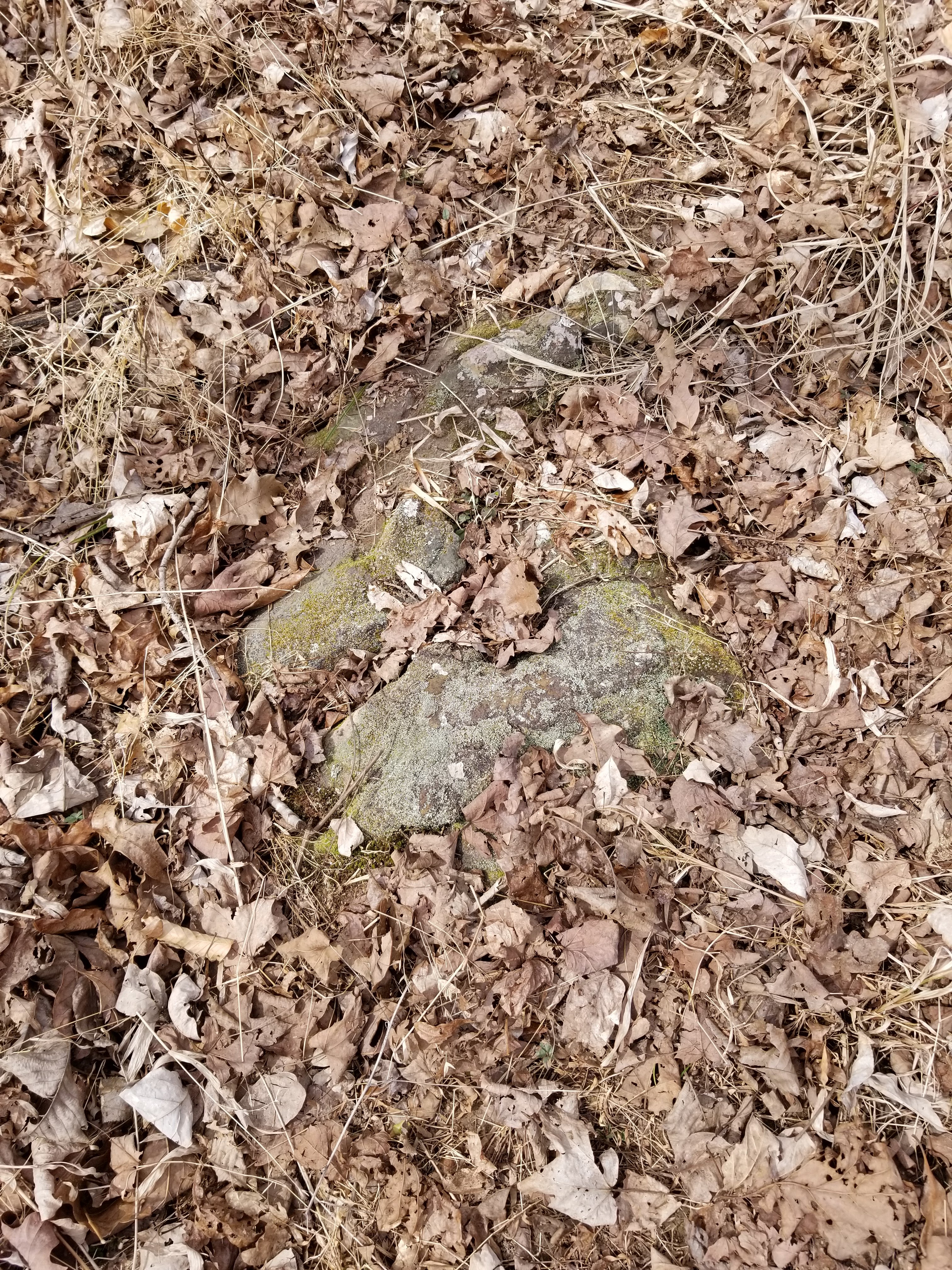

Big rocks I'd like to grapple out of the ground. My current tractor won't get these out even with a tooth bar.

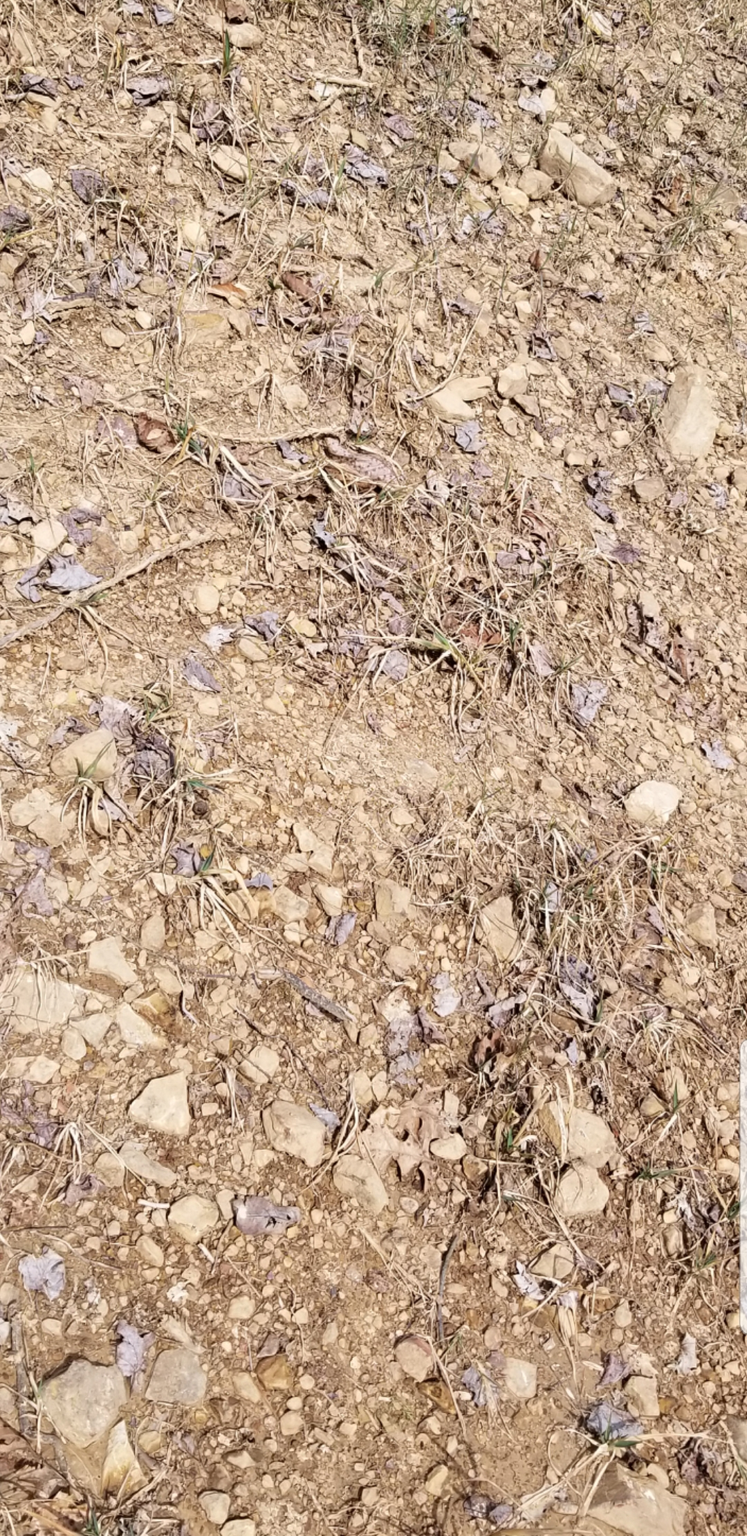

What size rocks can a disc hold up to? Some of my pictures are not loading but this is an acre I had dozed off and I ran my tiller across it at the shallow most setting and 5 bolts broke out of it. Would a disc be more forgiving?

Some of these smaller trees I'd expect to be able to grapple them out by the roots. I don't think I got pictures of the old stumps.

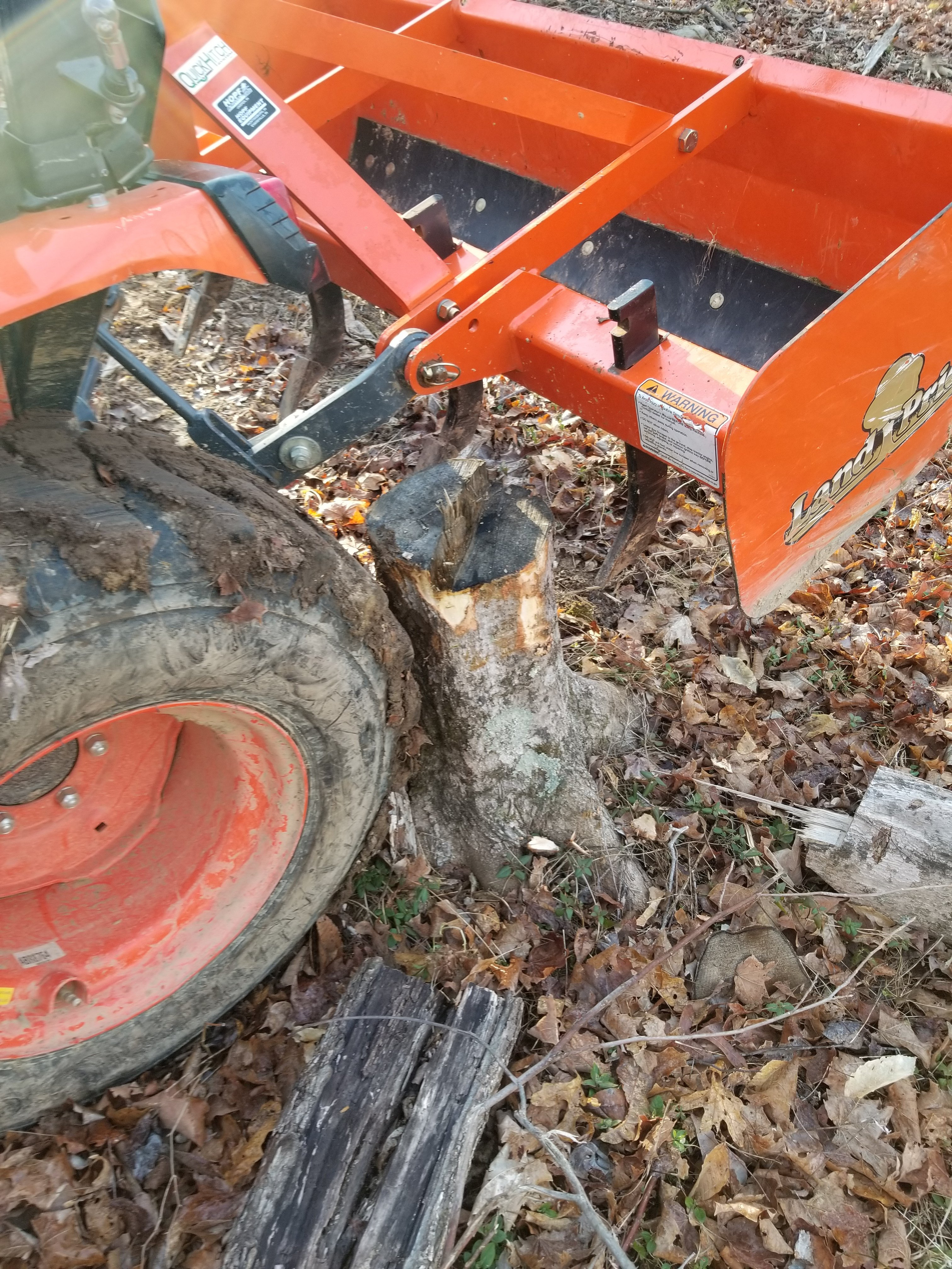

This is an idea of what I was trying to pick up and move with my b2601 which was unable to pick it up and was sliding, back end coming off the ground, got stuck on the stump whiling sliding. Getting old.

You could get a 100hp tractor but it’ll be pointless without leverage and weight is a big factor.
/ New kubota tractor advice
What size do recommend? The L series is 1,000 pounds heavy than what I'm used to.
/ New kubota tractor advice #8
A box blade is capable of anchoring practically any sized tractor if it catches large roots of boulders. A larger machine will have greater fel capacity, but I have yet to see a loader that couldn't be over loaded.
R4's do not excel in mud. Sounds like R1's would keep you from sliding around.
I guess my point is that a larger L series tractor has limitations also, and you should either take smaller bites at your tasks or buy larger and work within the machine's capability.

I’d say maybe your expectations are to high. You won’t be able to grapple a rock out of the ground, you will have to dig them out with the end loader. Dig around them and then get under them with the bucket.
Not to insult you but are you a newer tractor operator? If so it takes some practice and you have to learn your limitations and the machines. I’ve been running smaller tractors for 12 years and about a 1000 hours and am probably just adequate as an operator. I remember getting frustrated when I first started out. There is no doubt a bigger tractor will do more for you but I can’t help but wonder if you will just have a bigger disappointment.

As far as the rocks go they’re hard on everything. Especially tillers. Spring tooth rakes are cheap and do a pretty good job at popping out rocks if they’re not too big. and rock buckets can be helpful to remove them also.

Excavator for the rocks is a great idea. You have a small machine meant for light tasks. Others that have done hard work with 25 HP tractors are probably on a bigger frame. When you are moving weight, you need weight to counter it. You need ballast, and you need enough weight for good solid ground engagement. In a B series you just dont have it. Sure they are awesome for getting in tight places, moving lighter loads... but when you need to break ground weight matters. You cant move a 3000 lb rock with a 2000lb machine easily. You need to find other ways to accomplish this.

A Kubota MX series tractor is what you need. Not too much more money than an L3901. An MX tractor is both more robust and more stable than an L3901.
The fundamental importance of TRACTOR WEIGHT eludes many tractor shoppers.
Within subcompact and compact tractor categories, a significant tractor capability increase requires a bare tractor weight increase of 50%. It takes a 100% increase in bare tractor weight to elicit MY-OH-MY!
Tractors are inherently unstable operating on sloped ground. Tractor rear wheel/tire spread, adjustable on the Kubota MX series, is a critical factor increasing compact tractor stability working sloped or uneven ground. A 6" to 10" increase in rear axle width substantially decreases tractor rollover potential. Tractor width is an approximation of rear axle width.
Small tractor wheels drop into holes, disrupting traction. Larger wheels and tires supplied on heavier tractors bridge holes and ruts, increasing traction. Larger wheels and tires permit higher operating speed over uneven ground by reducing implement bounce and operator perturbation. MX series has exceptionally large wheels/tires for a compact tractor.
When considering a tractor purchase bare tractor weight first, tractor horsepower second, rear axle width third, rear wheel/tire ballast fourth.
BUY ENOUGH TRACTOR THE SECOND TIME.​
