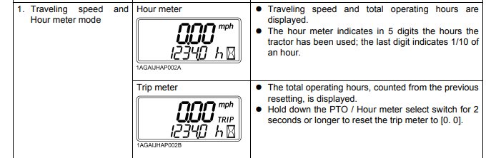

After several months of researching and searching I found a new (to me) Kubota M7060HDC12 to replace my ailing, hard-used, 50 year old John Deere 2020. I spent a lot of time reading the posts and opinions on TractorbyNet, then finally joined up so first of all I want to thank all you good folks for all the great information I was able to glean here.
This is a 2015 model; according to the former owner he bought it in 2016. It came with a box scraper and pallet forks in addition to the bucket on the loader, and had only 179.5 hours on it when I drove it off the trailer here at home on my ranch outside of Winnemucca, Nevada. It has been snowing here for 8 days and snow is predicted just about every day for the next week so I've been reading my owner's manual to learn all the features and operations of this thing. What a difference from my old John Deere! But I found something that puzzles me in the manual, and it has to do with resetting the tripmeter. See photo of the pertinent instruction from the manual below. Does this thing actually have a tripmeter, like in my pickups that resets mileage? Or does it reset the hour meter? I would hate to reset the total hours on the tractor - that doesn't make sense. Does it actually have two hour meters - and I can reset one after an oil change, for example??

It's actually a handy feature if needed. It's a "job timer". So,,,, for example,,,,, you want to know how long it takes you to clear the pending snow from your driveway. Reset the timer to zero, do the job, read the timer. Great for owners that "hire out" their machines by the hour.

DE71 - same operation as on mine. You have an hour meter than CAN NOT be reset and you have a trip meter THAT CAN be reset. Has nothing to do with distance traveled - both are logging hours of operation.

Thank you! That's what I wanted confirmed.

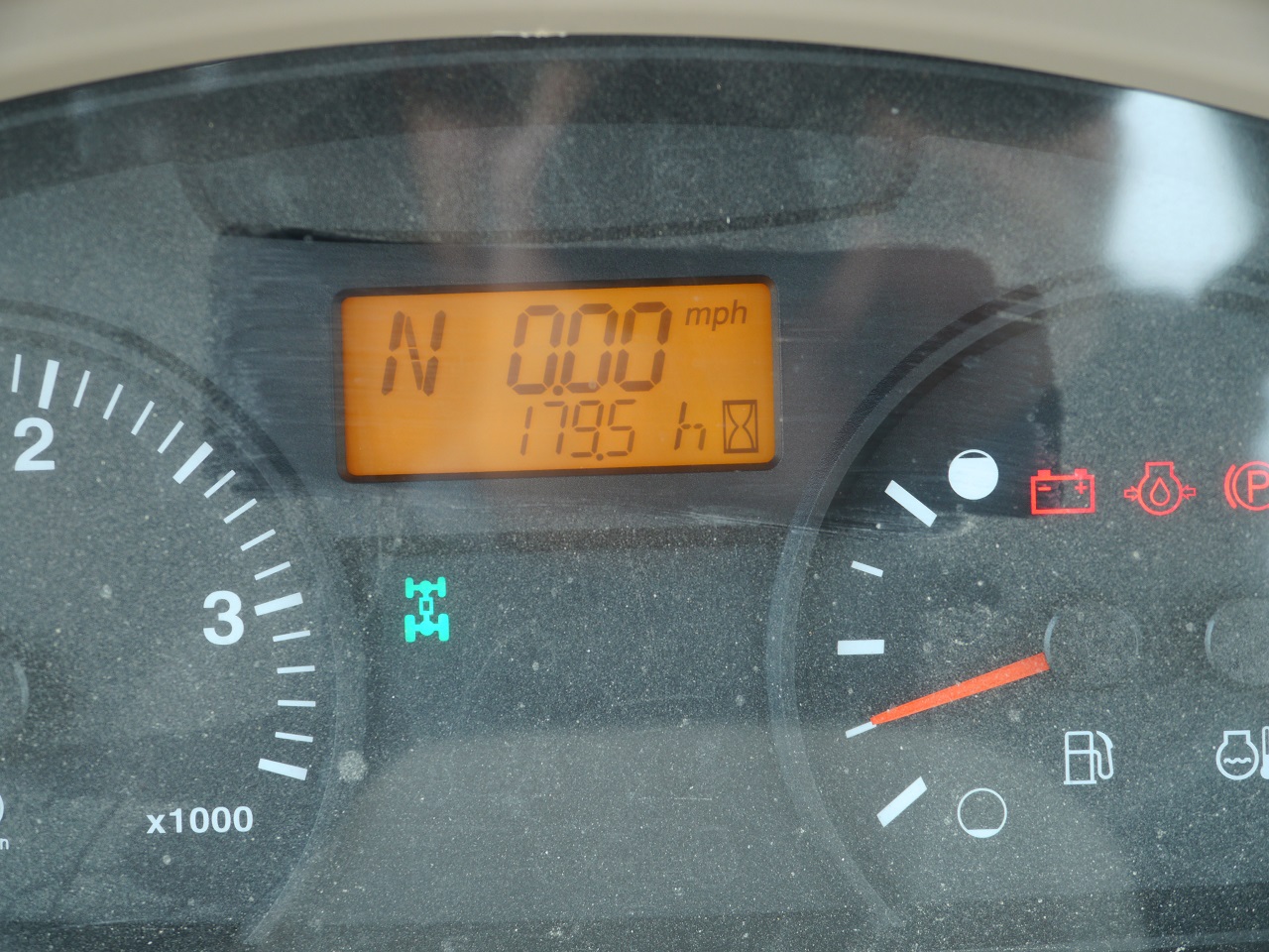

You have an hour meter than CAN NOT be reset...
So I wonder if he is looking at the tripmeter (179 hours) vs. the real hour meter!?!

Well Teg - all I can say is - - your tractor OP manual will tell you: 1) how to switch from trip function to total hours of operation function and 2) how to zero out the trip function.
Mine has a small rod sticking out of the dash that you push to change function and/or zero out the trip function.

I saw this post late last night and thought boy, I wonder if TEG is correct. So at dawn this morning (10 warm and wonderful degrees showing on my thermometer) I walked out to the barn and checked. Both hourmeter and trip meter read exactly the same - 181.4 hours now. Looks like the previous owner never reset it and neither did the dealership - guy told me that's who did the first service. Got to play with the tractor just a little bit yesterday afternoon! What a change from the old John Deere! But now I have another question. When I was tractor shopping I noticed that some of the other tractors with cabs had a provision to operate the 3-point hitch while standing at the rear of the tractor. There is a major winter storm predicted for the next few days so yesterday afternoon I dismounted the box scraper that came with the tractor and mounted up my rear blade in case I need to move some snow. I could see no way to raise/lower the 3-point hitch other than to walk around the tractor and reach into the cab. Does this model Kubota not offer some way to operate the 3-point hitch from the back of the tractor?
