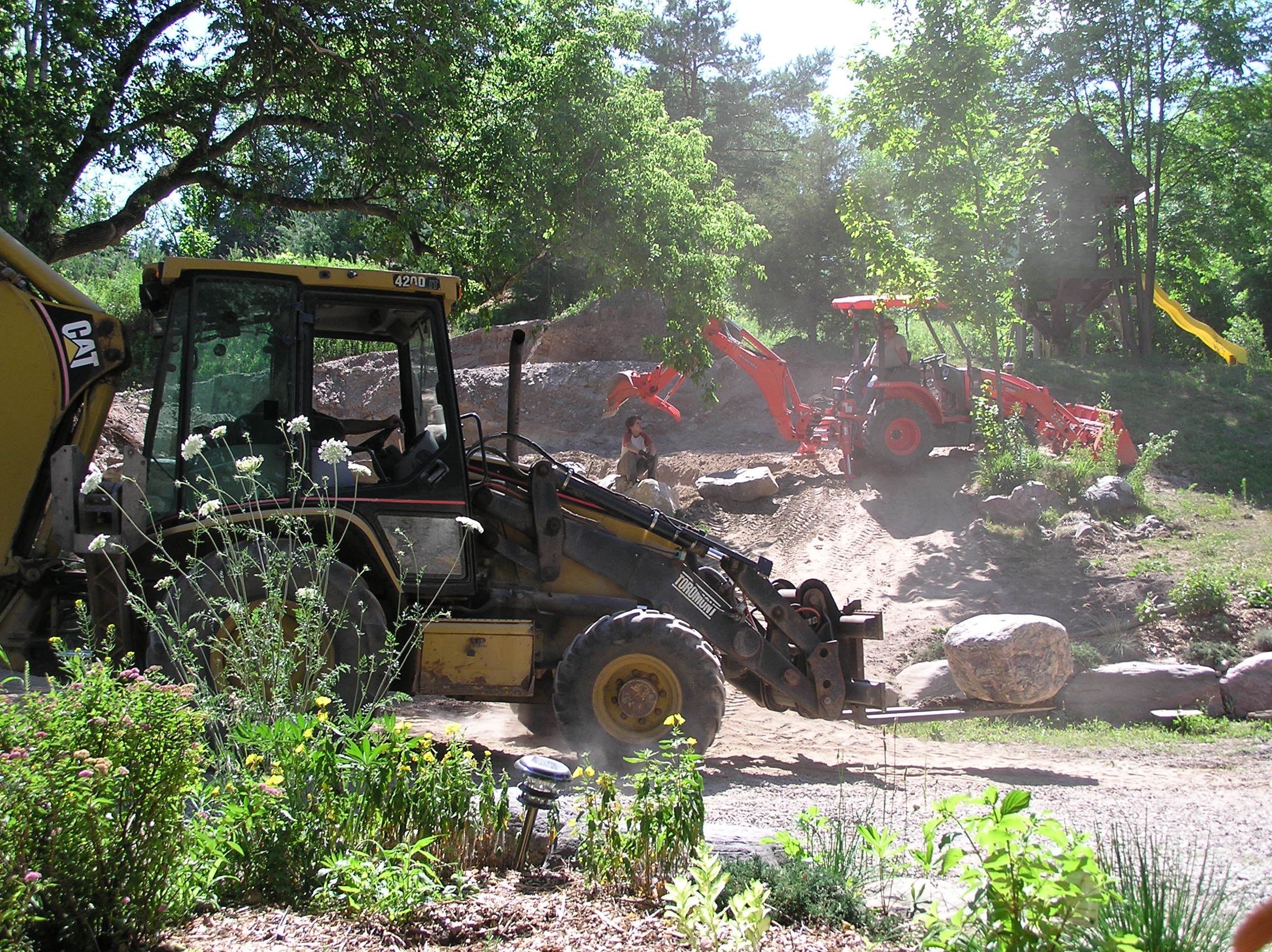

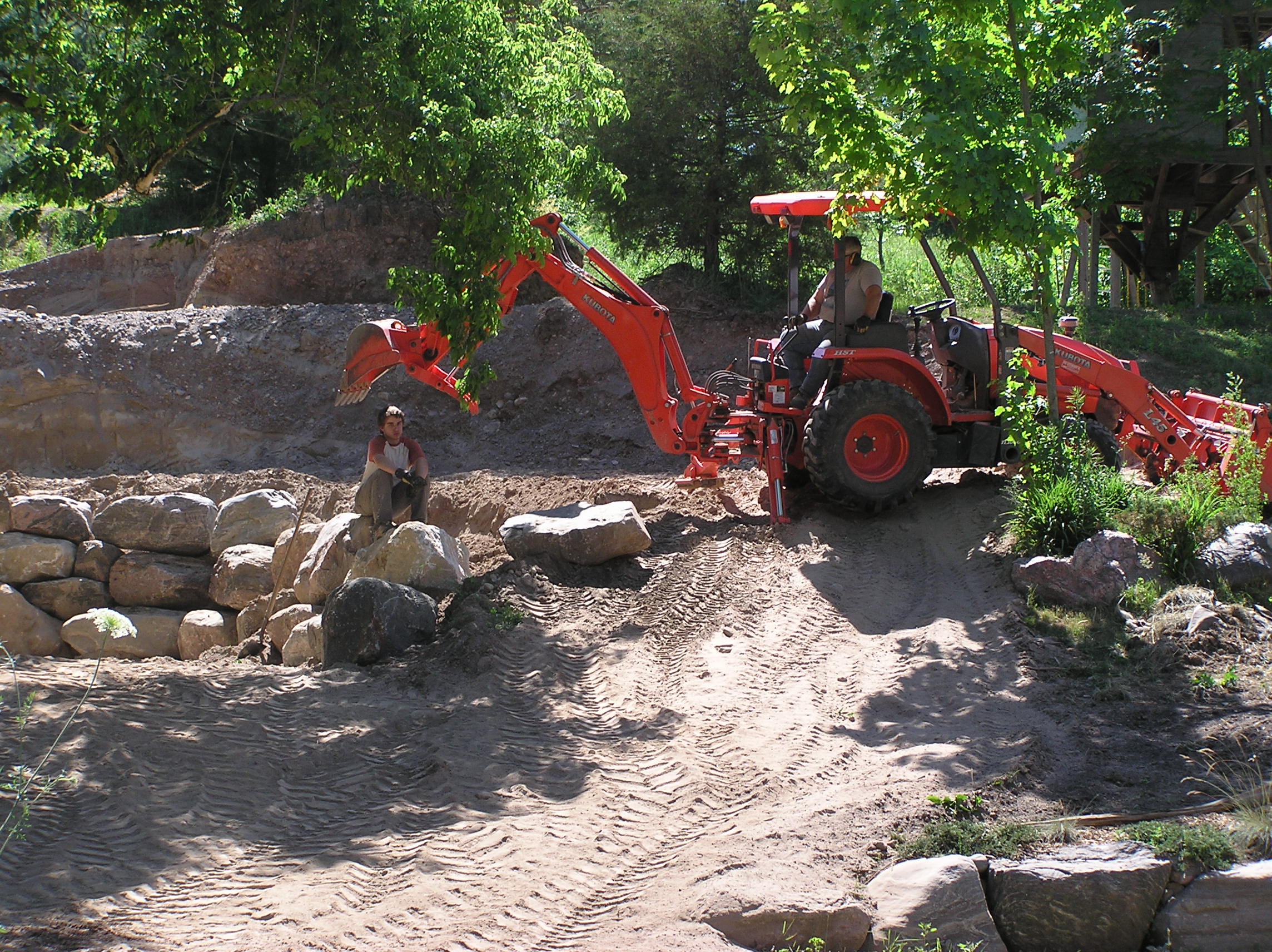

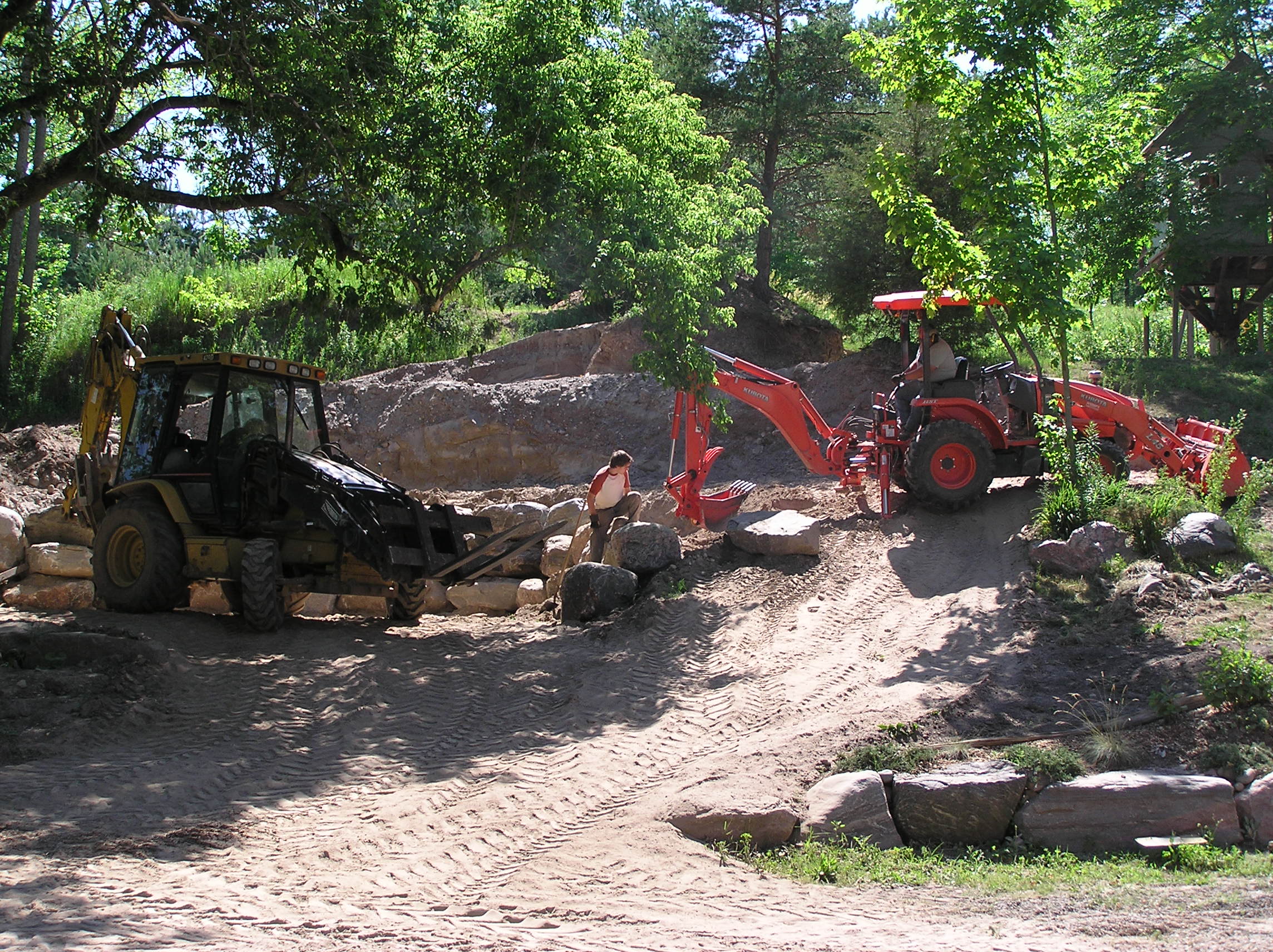

The rock wall in the photo is six feet high so there is no way that either the 4-in-1 or the very handy thumb on the L45 could have muscled most of the boulders into place. Fortunately for me a buddy with a full size Cat 420E rubber tire machine was doing some work in my village and he leaves the machine at my place when in town. I was able to hire one of his guys last weekend and with the two machines we built the wall in two and a half days. The 420E would lift them into place and than the L45 would either spin them or hold them in place from above and behind the wall while the 420E withdrew. It worked very well but we lost almost a half day when we ran into the sixth rock from the left in the bottom row. We had placed all of the rocks to the left of it when we bumped into this one which was in the middle (front to back) of where the wall was supposed to go. I spent about 15 minutes trying to dig it out with the L45 and realized that was a fruitless exercise and hopped on the hoe of the 420E. I spent at least 25 minutes on the 420E digging about three feet all the way around that rock and down about three feet in front of it but even at that point the 420E could not even make that rock wiggle so I new there was no hope of getting it out. We than removed the boulders to the left and realigned our wall to incorporate that big grey boulder into the wall. You know how it is with rocky property - you never know when you are going to run into a ledge or boulder that is just not going to move!

Here are a few action shots of us building the boulder wall that my wife took. My son got a little warm at one point to the L45 created a little shade for him.
Cat 420D and L45 placing rock 120701.jpgPeter in L45 shade 120701.jpgCat 420D. Peter and L45 120701.jpgCat 420D, L45 and Peter 120701.jpg

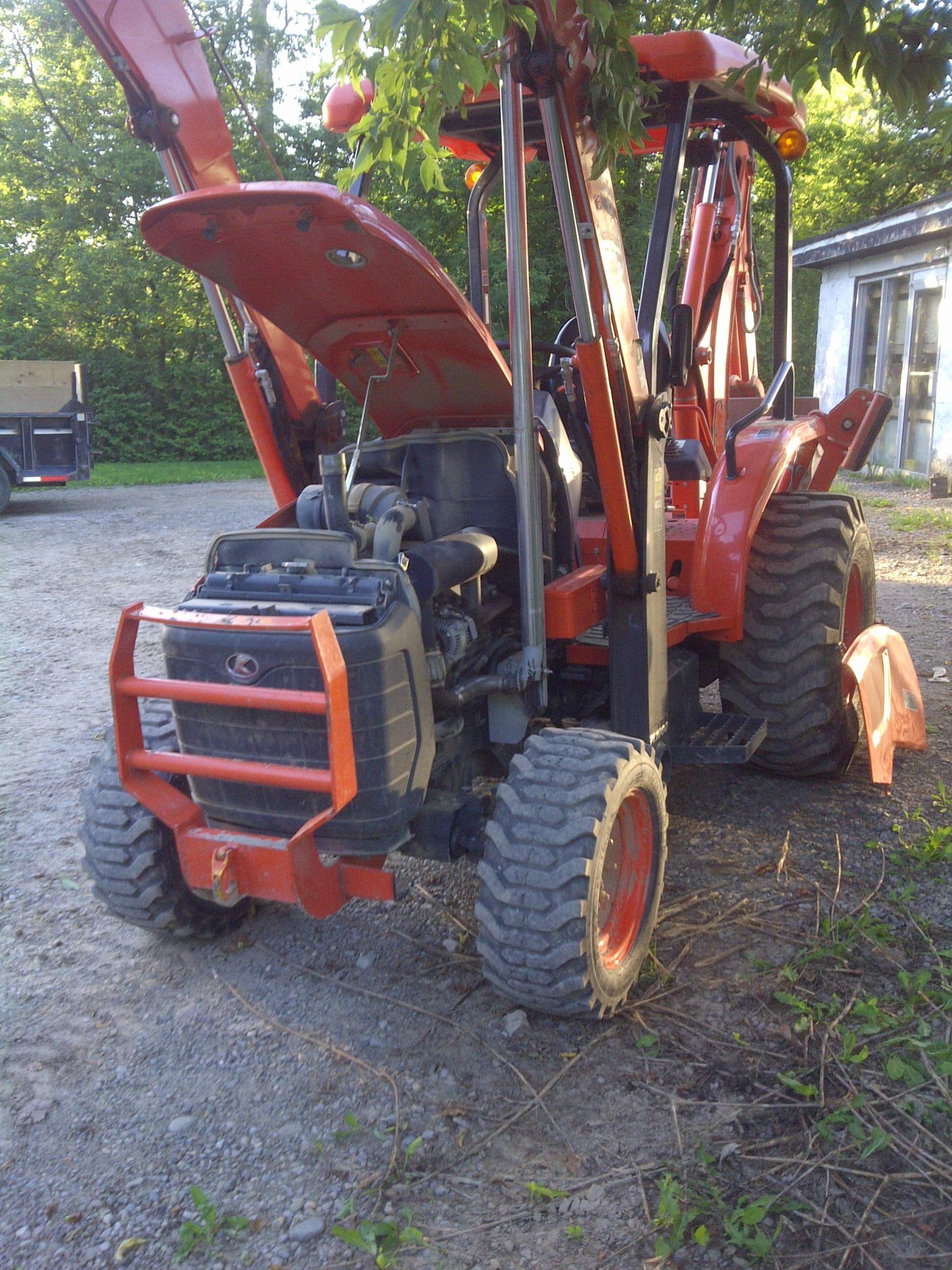

For those of you that have been following this thread, I have a couple of updates. First I started a separate thread on adding an exhaust stack to my L45 since a number of folks (including me) can't understand why Kubota does not include one at least as an option. Here I am duplicating the photos for the exhaust stack in this thread just to have all the stuff related to my L45 in one place.
The trickiest part of the exhaust stack install was to install the bracket to the tractor frame without damaging the front left tire. I thought I had covered that off at one point and then forgot about the front axle pivoting and as a result now have a line cut down the middle of that tire. Fortunately I only cut 3/16" into the treads but bwe warned if you attempt a similar installation. The other option would be to do an install similar to what member 4Shorts did which moves the stack closer to the operator but I did my knowing I had to install the Laurin cab and wanted to ensure that the stack would not interfere with the cab installation. I'm not sure but I think the line carved in the left tire has improved my high speed directional stability!:eek:
Here are a few photos:
L45 Exhaust bracket angle 120728.jpgL45 Exhaust bracket oblique 120804.jpgL45 Exhaust bracket painted 120730.jpgL45 Exhaust bracket side 120804.jpgL45 Exhaust stack detail 120818.jpgL45 Exhaust stack front view 120818.jpg

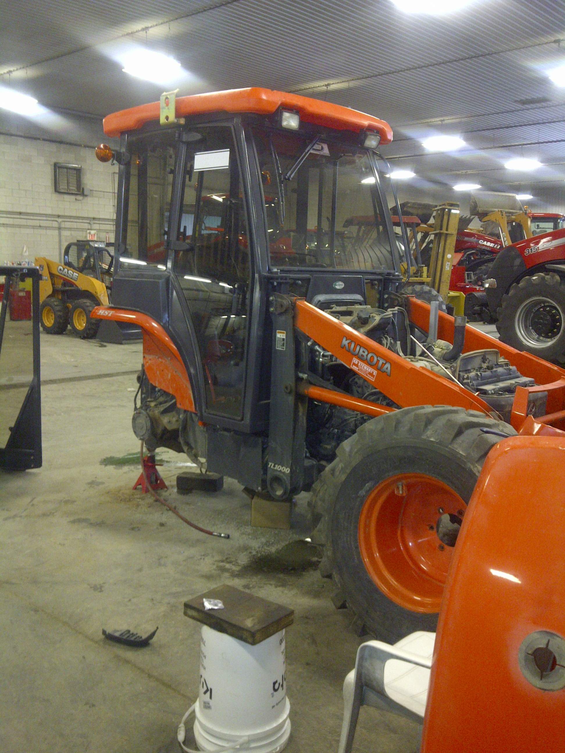

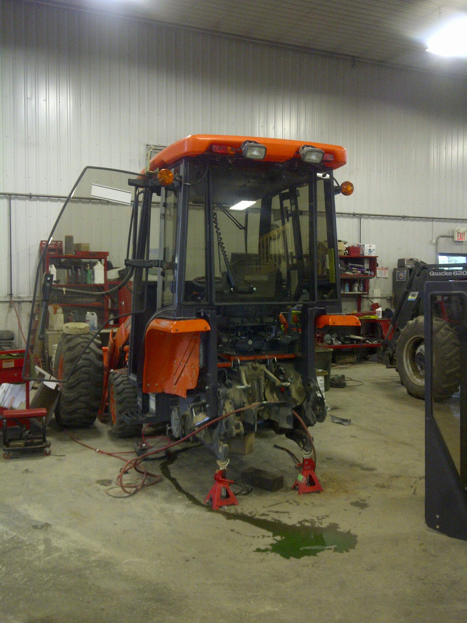

For my second post today, I have some photos of the start of the Laurin cab installation. It is a much bigger job than I thought so I am glad now that the dealer is doing it. They will finish the installation this week so I am hoping it will be cool this coming weekend so I can enjoy my enclosed and heated cab!
L45 Laurin install left 120914.jpgL45 Laurin install rear 120914.jpgL45 Laurin install right 120914.jpg
