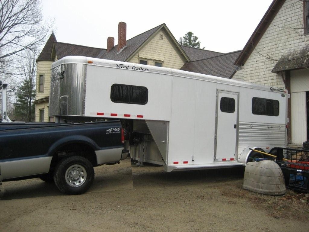

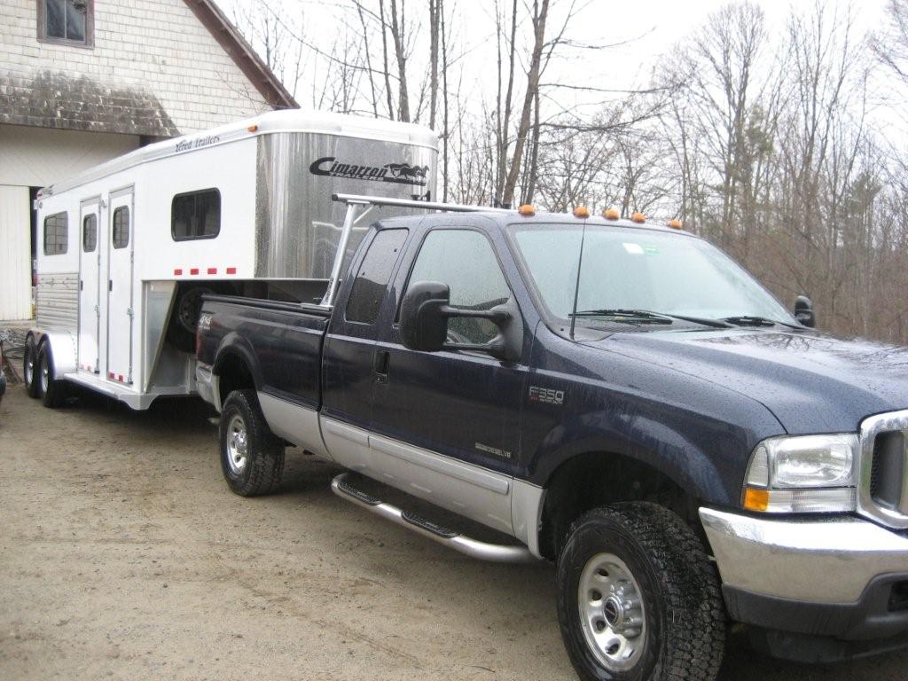

We picked up my wife's new horse trailer yesterday.
I am not as exciting about it as I would have been a new 7-ton deckover deal, but at least I have the gooseneck installed now. Plus the price of the future deckover will seem "cheap" to her after what she just shelled out for the horse trailer :)
Unfortunately, I decided to yank the TracRac (still shows in the photo). The rails of the TracRac took up valuable clearance given the height of the truck. I think I'll put in a headache rack to protect the cab. I have been very lucky over the years to NOT take out the back window heaving in firewood. Hopefully I can find an easily removeable ladder rack for the back - any recommendations?
I am a gooseneck noobie - but drove this rig 200 miles home yesterday - man WHAT a difference compared to bumper pulls!!! I am already a huge gooseneck fan. Gotta spend some time backing/manuevering..... I guess it is easier once you get the feel for it.

Nice setup but I kind of think you may want to raise that gooseneck an inch or so. I don't see much margine for error between the tailgate and the trailer.

Totally agree, except I think more than an inch or so. It can be a struggle/compromise with a lifted (4x4) truck between the trailer being level and the trailer having enough clearance above the bed sides. You can jack the back of the truck up (from the center - diff or hitch) and see how much pitch you have before the trailer binds against your bed sides. See attached - not much of an angle...

Well after I took those photos I yanked the TracRac (for sale now) and gained a few inches of margin. I think we'll be OK at this point. But if I have time this weekend I'll find a road or driveway with a big hump to climb over and see if it will make it.
I'm not sure how much I'd want to load up the rear axle so hopefully the clearance w/o the trac will be OK.
~paul
PS - that's a stock F350 4x4 - with no extra lift. If I really had to I guess I could block up the trailer axles, but it should be OK now.

I agree that the clearance looks a bit tight.

Yeah, I know. I didn't mean to imply you lifted it, just that it is lifted. You'd be surprised at how many people crunch their bed sides. They're about as safe from damage as fiberglass dually fenders! Just wanted to point it out and save you from puking...

Wow that is really close to the bed. The F350 has two inch spacers on the rear springs. That is one of the differences between it and an F250. You can remove those spacers and the truck will still be tail high. just like an F250.
I am positive that trailer has dexter torsion bar axles and you can not raise the trailer nor would you want to do that to a horse trailer.
Here is a pic of my F250 with my goose neck. Notice it has considerable more room than yours does and I get very close to bending the bed sometimes.
