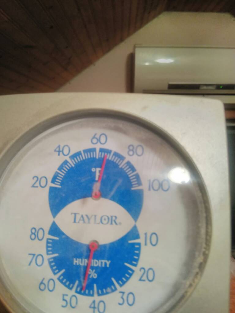

I installed two 10kBTU mitsubishi cold-climate minisplits 4 years ago. So far they've worked down to -30oC, are quiet, cut my heating bill by 60%, and I now have AC in summer. I went with two small single head units because they had the highest efficiency. I installed one unit in the middle of the house on each floor.
I would not hesitate to use them again on a new build.
You will get a lot of claims over efficiency of ducted vs minisplit systems. If your you have a lazy duct installer who takes shortcuts your ducts will be a big waste of energy.
If you have a well designed, well insulated and air tight house I'd recommend an HRV/ERV which requires some sort of ducting. A small minisplit can work well for you.
