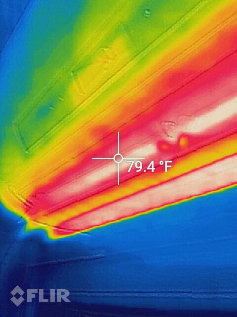

The Mitsubishi I have install will output 70 degree heat down to -13. Right now ín Iowa been really putting it to a test and so far been great.
/ New Home HVAC System #23
I'd like to see the indoor remote reading with the outdoor temp side by side with that claim. I'm very familiar with Mitsubishi technical literature, and no where does it state what you just claimed. I just looked, a new FS18 k model (single zone) will give you 17,100 BTU/h of heat at -13.
The question becomes, when it's below 40F outside, what is the remote set to per desired temp and what is the actual temp in the room?
If you want higher heating output with Mitsubishi, you have to use their "hyperheat" system. By the same token, other manufacturers can do the same thing. On the other hand, higher heating performance systems cost much more.

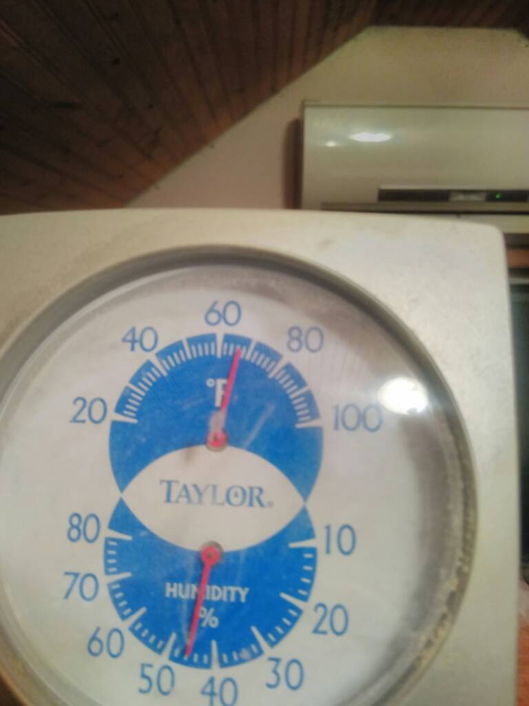

Checkout the MsZ-FE12na. When it's been minus outside temperature the bedroom remote is set for 68 , fan at low and the unit keeps it at 68. We keep it at 68 becaúse of wife. Besides using a thermometer that's in the room AIso I've my Flir camera to check the output temperature of the unit. If you check Iowa temperature you'll see that were in the minus most of February.
/ New Home HVAC System #25
Right now outside temperature is 2 degrees and you can see the pictures. I'll post another when it down in the minus range
Check out KCRG weather.View attachment 686159View attachment 686160
Got to ask, what kind of FLIR unit are you using? I bought one that I can use off my phone and like it a lot for the price point.

Checkout the MsZ-FE12na. When it's been minus outside temperature the bedroom remote is set for 68 , fan at low and the unit keeps it at 68. We keep it at 68 beca?e of wife. Besides using a thermometer that's in the room AIso I've my Flir camera to check the output temperature of the unit. If you check Iowa temperature you'll see that were in the minus most of February.
Missed this one, apologies.
Very familiar with the FE series. It's the older hyperheat single zone system from Mitsubishi that's been replaced by two different models at this point in time. It's a GREAT unit, their top of the line at the time.
Thing to remember is with a "whole house" multi zone system, the capacity can change dramatically sepnding on size/capacity (it's kind of unfair to compare a single zone ductless vrs a multi zone ductless for various reasons).
What I would sincerely be curious about is if you changed the t-stat to 71F indoor, would it keep it at 71F indoor when the outdoor temp was in the negative range? I honetsly don't know.

The FLIR is build into my CAT S60 phone, I'm really hard on phones and I need a phone that could take it and could help me find issues with the house, this phone fit the bill. The house is a story and half refurnished 3 bedroom farm house that we brought and they didn't or couldn't run duct work to the main bedroom above the two car garage they added, they installed two baseboard heaters and no air. The rest of house is covered by regular ducts and heat and air by a Trane system using propane.
I did make an error in the temperature setting of the room last night, wife had turned the remote down to 65 during the day. I wish I could see what the outside model number is, but to much snow and right now -8 and heading for -20+ over weekend and not covering the wind chill.
Most of the time we keep the rest of the house at 68 degrees and at times it'll get bumped to 70 like now. To warm and wife asthma can be a problem.
