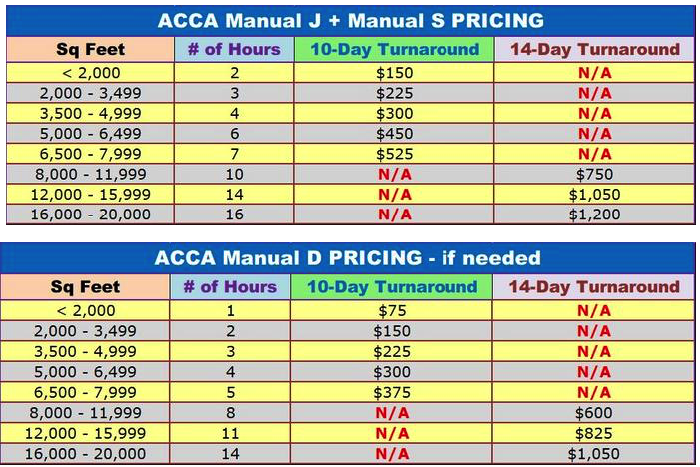

When I had our house built, I required the contractor to provide a manual J calculation. What a mess that turned out to be. It was done after the sub had installed the system. The sub did not have the software to do it and borrowed another company's computer to do it. Didn't get the values right - not even the right geographical area.
I can do heat and cooling loads thru walls and roofs based on a closed box (no wind, shade, solar heating, etc). What i don't know is the heat loss thru the concrete slab (no insulation under it). The manual J as I understand it takes into account the orientation of the house to the movement of the sun, shading, soffit overhangs, etc.
So, my question is: how does one go about getting a manual J calculation done?

Find someone experienced with Wrightsoft. Guys who know what they are doing will guarantee their load calculation. Thing is, training and software isn't cheap, so don't expect someone to do it for free.
Generally, for residential retrofit quotes, a block load is done vs a room to room load (if a load is done at all). When it's new contstruction, a room to room is generally done for the manual J and a manual D for ductwork sizing / layout.

Thanks, I'd no idea as to the name of the software. I expect to pay for it but don't know what is reasonable, is $200 about right for the manual J?

Keep in mind, Wrightsoft is only one software program out there of many out there (Wrightsoft probably is one of the most expensive ones out there, and I'm thinking that becomes a racket as well).
A room to room load will proably cost more than a block load, and I'd guess the sqaure footage would determine. I looked online, and it seems my guess was right.
