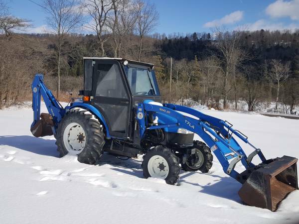

going to pick big blue up tomorrow :) here is a pic
/ New Holland TC45D #9
Nice tractor. If they don't have one buy an owner's manual from a NH dealer. It has very detailed wiring specs that come in handy.
I just got through mowing for the fourth time this year and cleaning stalls. That white stuff on the ground does not look like the same stuff that my horses put down. :laughing:
