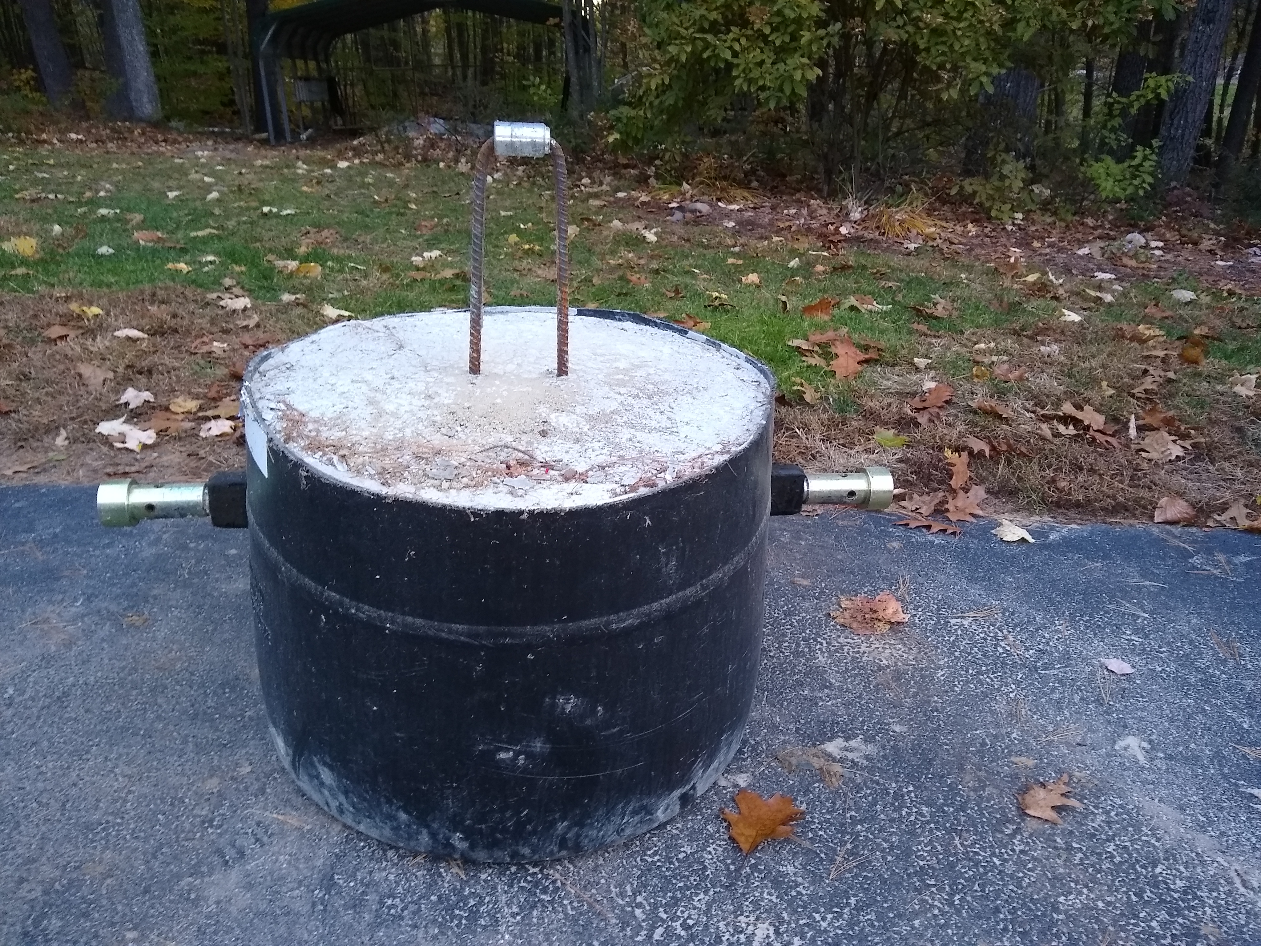

I've got the same setup, mine is my dedicated mower- and it stripes the lawn. You might find the Massey mows better than the legacy XL. The loader is definitely a beast. In winter the snowblower is adequate ballast. Moving dirt you'll want something. Here's a 600lb ballast I rigged up using 1/2 a 55 gallon plastic barrel, a Cat 1 ranchex drawbar (walmart.com), some rebar and (6) 80lb bags of quickrete. Whole thing cost about $50-60. I can pick it up and set it down with a quick hitch. Only thing I wish I did was sinknsome PVC into the cement so I could carry shovels/rake.

Going to start my 2x2x1 ft. (4 cubic ft. possibly 600#) ballast box build today... Glad you reminded me about tool holders....
