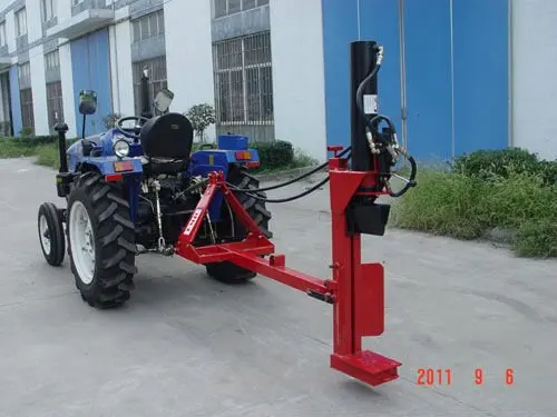

Wood splitter???.... 3PH????.... How did you do hydraulics.... A brochure for the 1700 series state there is a "power beyond" accessory but neither corporate or local dealer can seem to find/supply any information... When I do GOOGLE search with part number I get a John Deere setup that does not relate to the MF...
I suppose you are running it off back hoe hydraulics?
Dale
You can just use the lines that are there for the hoe, or use a longer line and tie into loader spool. My splitter came with its own spool, just needed to buy quick disconnects.
You can use any spool (think I bought mine for $180) and hook it into power beyond, either with your back hoe lines or if you don’t have those tapping into front loader. I use a two spool unit to support top and tilt for grader box and my “snow plow” which is an old back blade I’ve reworked to push snow backwards and use horse mat on the edge to keep concrete happy.search my posts I have it all written up.
   / New Guy New GC1715 #26
The 1705 and 1715 do not have hoe's or hydraulics plumbed out for power beyond (hoe)... Only 1710 and 1720 have hoe and power beyond hydraulics for hoe....

Can you not tap into the loader spool? I am assuming they don’t use a different front spool for hoe vs non-hoe GC? I was actually going to do this to be able to run my splitter up front. Haven’t gotten to it.

I was sort of thinking of using splitter at rear (3PH) with spool on splitter (or any device) .... Was in mental state (thinking) as my friends DJ, which has a pair of connections out to rear with "U" shaped hose that loops back hydraulic fluid when no rear device in use, but removed when hooked to something like splinter with its own spool valve....
Note rear "power beyond" connection!...

A GC doesn't have the flow to run a splitter. Will it move the wedge in and out, yes, but very slowly. GC size SCUT'S are just not made for it. I used one on my TC45DA and it was barely enough to get anything done, I have since bought a Honda powered splitter, now I split a cord an hour..
