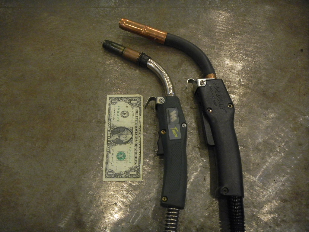

In the 1970s I worked in a Fab shop, all they would buy us was Tweco model 4 guns. I have a model 2 and a knock off model 4 for the high amp welding.

I agree that the tweco # 5 is a great gun but the OP wants to use it on a 150 amp welder. #5 ia a Monster sized 500 amp gun. I would suggest one of the new 180 or 220 amp Tweco Fusion guns. low cost and new technology. Good Luck.

Look at Profax's selection before you buy. Prices are cheaper and they have good quality. Different styles as well.

Yomax, not sure you are qualified to make that statement... Quality or otherwise about our products. I think you just lost a little (if not a lot) of respect with that comment, not only in my eyes, but others here as well. But I am not sure why that came up since this was about torches not other welder companies. For a professional, that wasn't. Profax puts out good quality at a good price and whether it's on our units or other brands, everyone I know who has used them has been more than satisfied, including me (not on Everlast btw).
Victor/Thermal Arc controls/owns TWECO, and as you are a rep for them, seeing a good manufacturer that offers DIFFERENT equivalent brands and models could get under your skin I guess...but why should it threaten you so? Did you look at SA's post with the picture of the Profax beside the TWECO? Profax makes more than TWECO interchangeable products btw...and they do a decent job of it.
