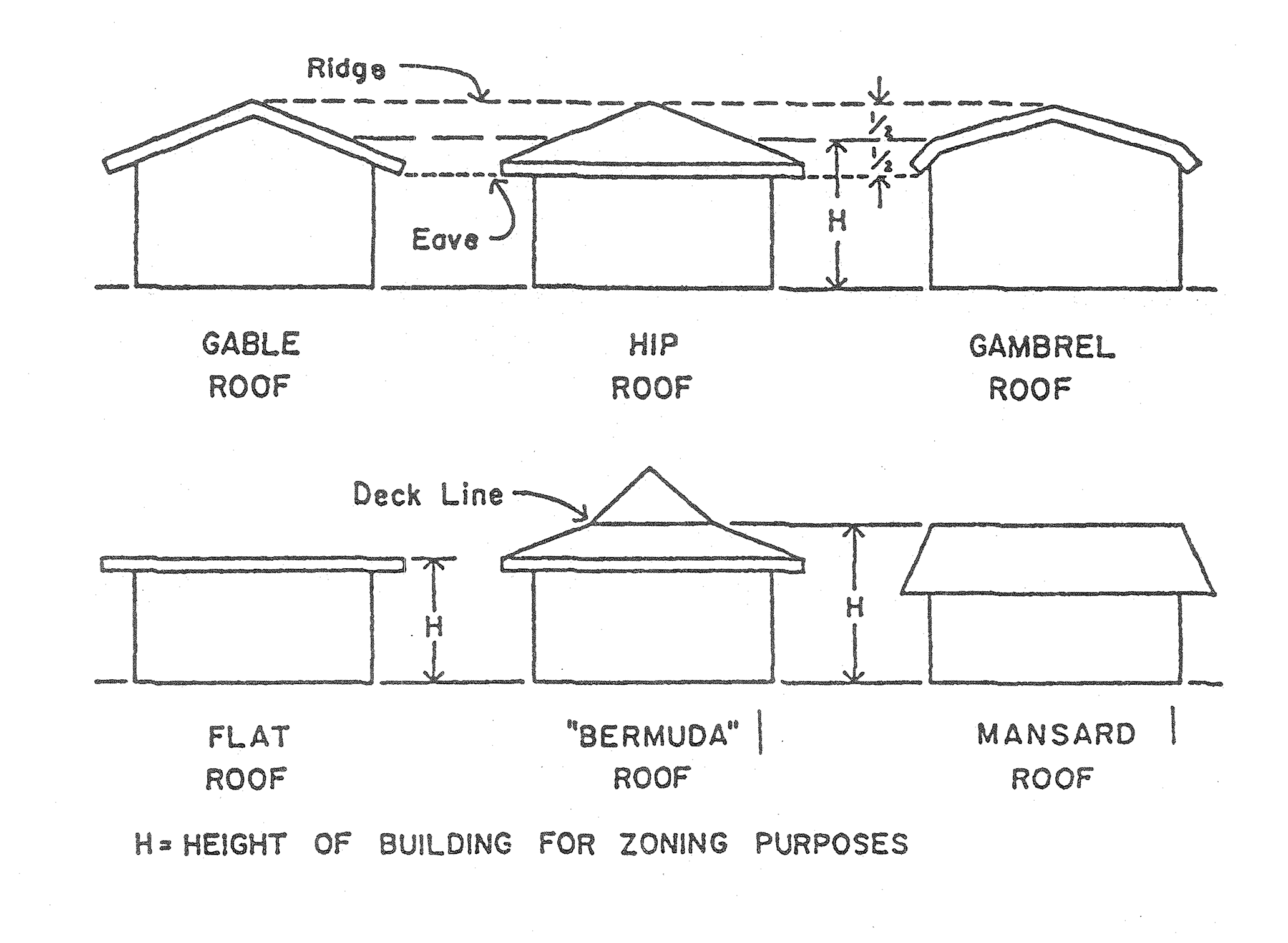

Jay, did you look at the link I posted? Your local code is exactly like what I was talking about. Your height measurement is to the MEAN, meaning Average or middle of the roof slope. So yes you can build a tall box with a low slope roof, OR use attic or gambrel trusses to gain a 3rd story and stay under your limit.
The other thing to make darn sure of, is to complete all your backfilling around the building as high as you feel comfortable with against your foundation. Your local inspector may well measure all around the building, so get that grade established as high as you can to make sure you don't fail.
