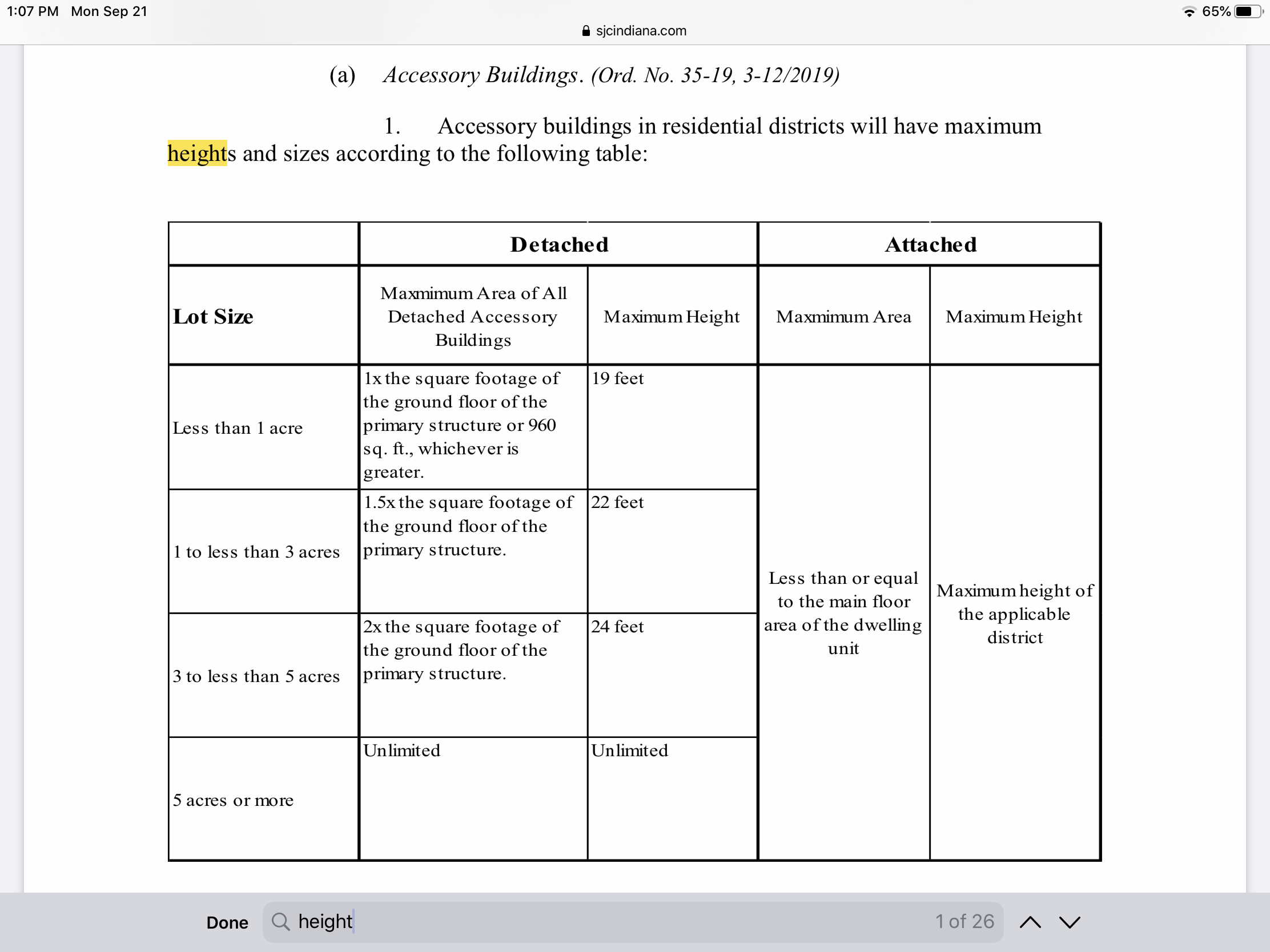

Are you limited in what type of roof you can install on your shop? Can you build a Gambrel Roof if they turn you down for the third floor and just call it attic space?
/ New garage time! #725
I'm just going to do a 1x12' roof with standing seem steel roofing and take the 8' walls up another 4' for a total of 12', which will let me do loft storage or a faux attic.
I think most places limit the total height of a structure.
Here's ours for outbuildings, for example. It's based on total height. And that can vary depending on lot size. And square footage depends on the house and total of all outbuildings. I could have more outbuildings square footage than my neighbor because my lot is listed as 1.01 acres and his is less than 1 acre. Weird stuff, but it's the law.

Did you say you are going with a 1:12 pitch roof? WHY?
My height is restricted to 26', not 2 floors. My original plan was 35' and 3 floors, they restricted me to 26', which i was fighting against. first floor is 12' plus 1' floor which leaves me with 13' remaining. If i make the 2nd floor 12' it leaves me with 1' for a roof. With standing seam steel roof you can go down to a 1:12 pitch. My trusses will need to be 16" on center though to get the snow load rating according to my truss company.
Ours is 35' for zone 2, but because I needed that setback variance they threw on the additional restriction of 26', the 1' floor and 8' walls.

Jay, how does your township/city regulate and measure the actual building "height" though?
In my township of Michigan, we have maximum building heights. But they are measured to the mid-line of the roof! So halfway in height between your roof peak and your gutters is where they calculate the actual building height. This means that you can build a tall building with a flat roof, or a lower building with a peaky roof design. OR, a barn-like structure with a gambrel roof design, because the entire side of the top story is then "roof". I could easily build a 3 story in "26 feet" using a gambrel roof - since the peak could actually be ~30 feet. Cant find an exact diagram right now but this is similar:

Yeah, I was surprised to learn about it when building my house and pole barn; not that I pushed any height limits myself. But this kind of residential building height regulation is quite common across the country, as my google searching revealed. I suppose the reasons for it are myriad, but in particular, it helps establish a fair but somewhat flexible limit that accounts for the variety of roof structures. Seems like building and zoning officials don't exactly go out of their way to explain the complications of this rule, maybe because they don't want people pushing the limits.
So in essence, Jay, don't let them just tell you a number for max height! Find out exactly how they measure and regulate it.

The vertical distance measured from the average elevation of the existing grade at the location of the building to the highest point of the roof for flat roofs, to the deckline of mansard roofs and to the mean height between eaves and ridge for gable, hip and gambrel roofs, provided that chimneys, spires, towers, mechanical penthouses, tanks and similar building architectural projections of the building not intended for human occupancy shall not be included in calculating the height. If there are two or more separate roofs on a single building, the height of such shall be calculated from the highest roof.
This makes me a bit more confused. Anyone with building experience want to weigh in?

"The vertical distance measured from the average elevation of the existing grade at the location of the building to the highest point of the roof for flat roofs, to the deckline of mansard roofs and to the mean height between eaves and ridge for gable, hip and gambrel roofs, provided that chimneys, spires, towers, mechanical penthouses, tanks and similar building architectural projections of the building not intended for human occupancy shall not be included in calculating the height. If there are two or more separate roofs on a single building, the height of such shall be calculated from the highest roof."
That right there sounds like you could gain some height by having a steep roof pitch. It seems to say you measure half-way up the gable wall to determine the height. I'd take that and head to the building department for clarification. Written clarification!!
