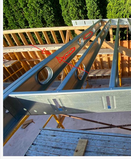

2 more installed. this time only me. If it wasn't for going back and forth so much between scaffolding and hte 95F heat, I could finish it all myself.
/ New garage time! #573
Are there some bolts that are going to tie these 2 together, so that the 2nd one will help the first one bear the weight of the opening edges?
I can't really see them if they are there.
/ New garage time!
#574
They’re not all in yet but there is 3 every 4 feet of the self tapping screws.
I just did 2 more for a total of 4. Doable by one person but much easier with 2.
