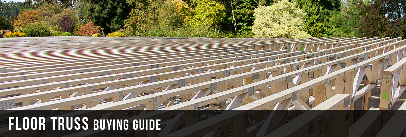

/ New garage time! #550
These are wood floor trusses...
/ New garage time! #551
I had those type of wood trusses on my first house.
/ New garage time! #552
Curious as to the height of the wood joists vs. metal each spanning 24ft?
I bought direct from the factory. I was going to use a taller one, but they showed me a shorter one with a thicker web, that cost less and had same performance.
/ New garage time! #553
Might be cheaper but I doubt the same performance all things considered. I-shaped cross section is the most efficient way to design simple engineered beam where bending strength is driving factor vs. shear strength (web strength). The web does relatively little to help with bending strength. Trusses are another level of strength, where instead of relying on the web for stability and shear loads, the truss members are instead compression/tension members but they generally take more vertical space to be efficient... a la roof trusses.
Sometimes space is a restriction requiring stronger materials or more efficient space for bending strengths... especially for long spans. Nowadays it is cheaper to manufacture a wood engineered I beam than a the raw material cost of say a 2x12 fir and can handle longer spans and are more stable.
Sorry for what might appear as a lecture here but I am guessing many don't understand why all the choices in joists.
/ New garage time!
#554
Locally those are known as tri-force joists. We looked at 3, LVL's, i-joists, and tri-force joists. LVL's were $250 each, 12" on center and can't drill. i-joists had issues with the span and were about $130 each and couldn't get wet, tri-force the guy at the supply yard recommended against them saying alot of people complain of sagging after a period of time.
The tradeready joists were $4024.83 for 33x 24' which was $121.96 each, $376.90 for the 5 at 14'10" which is $75.38, 9 pieces of rim track 12' 12ga for $515.31 or $57.26 each.
With the steel joists it feels like I'm getting the strongest product for the lowest cost. The rim track is extra though.
