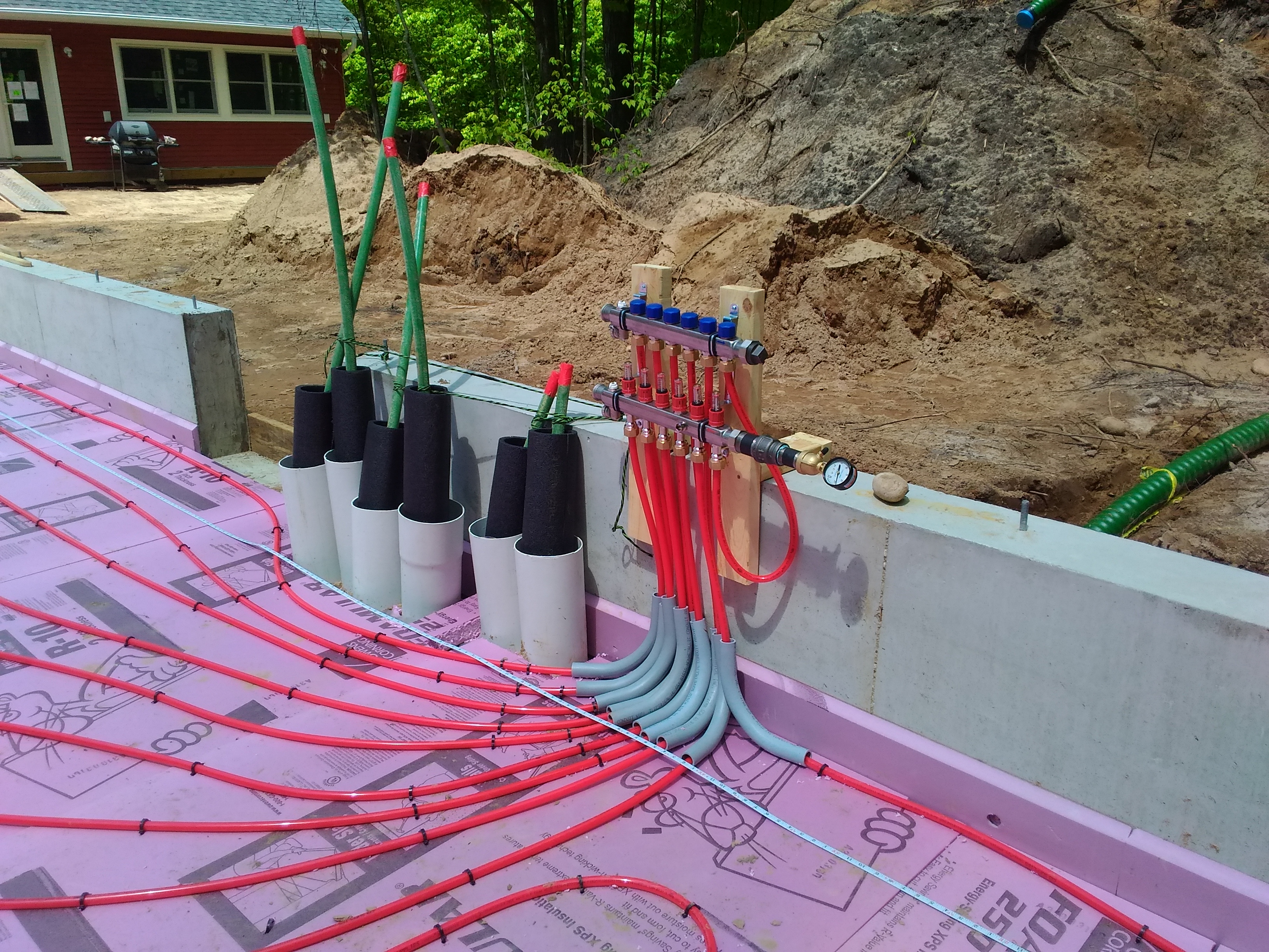

Got the pex all laid in and clipped. I need to pick up long turn 90* 1.5" pvc, each run will go 2 in 1 to come out of the concrete and meet up with the manifold. I'm going to leave them long and put the manifold hanging over the back wall while the pour is done, then when the pad is set I'll go back in and trim off the excess. I'll have the tubes pressurized during the pour as well to prevent potential crushing. There's 700 pex clips and ~1600ft of pex tubing totaling only 16.3 gallons of fluid.
The right side was done first. And it's a bit of a mess compared to the left. I may redo it honestly.
/ New garage time! #252
Where your pex turns up things are going to get crowded real quick. It's hard enough when the pex is at the bottom of the pour. With yours within 2" of the top the long turn elbows are going to breach the surface of the slab at an angle with most of the sweep being above the slab. Pex can stand some pretty sharp bends, more than you'd think. Normally pex fitting elbows are used on each individual run. In your case those will still breach the surface. But they might work better than long sweep PVC. Even the horizontal end of the PVC is going to nearly breach the surface.

How about this picture of where my pex comes thru some pvc elbows. My pex is plastic stapled to the insulation and ends up on the bottom of the concrete pour.
Jon
Yes, very good pic Jon.
This clearly shows how much space sweep elbows require.
Is that a 5" pour? Hard to tell in a pic.
Good example of a very tidy setup!!!
