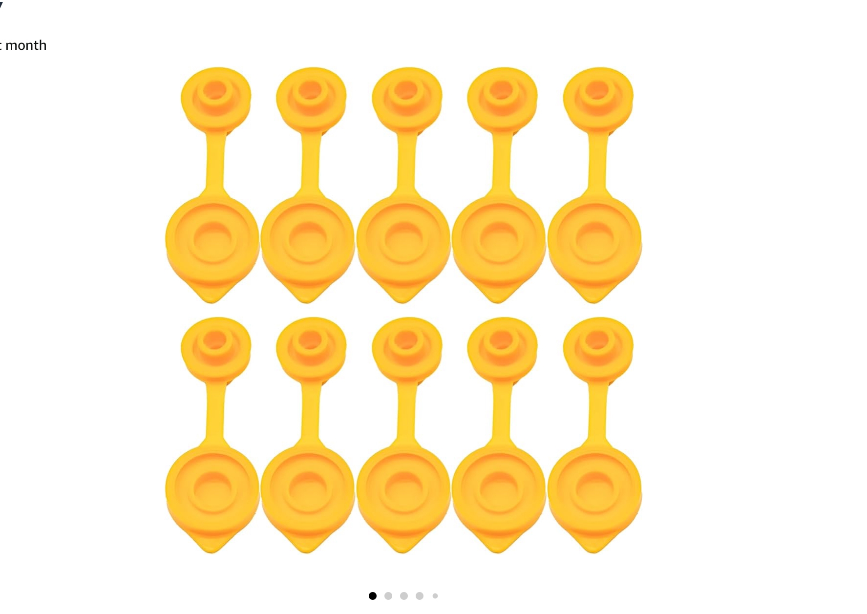

I learned that drilling a small hole in a high spot at the back of a plastic gas can, and then using wire to pull through a rubber tire valve stem, which you just leave the core out of and cap works perfectly to vent the can. I have spilled more gas trying to use the new safety cans than I ever did with old fashioned gas cans.

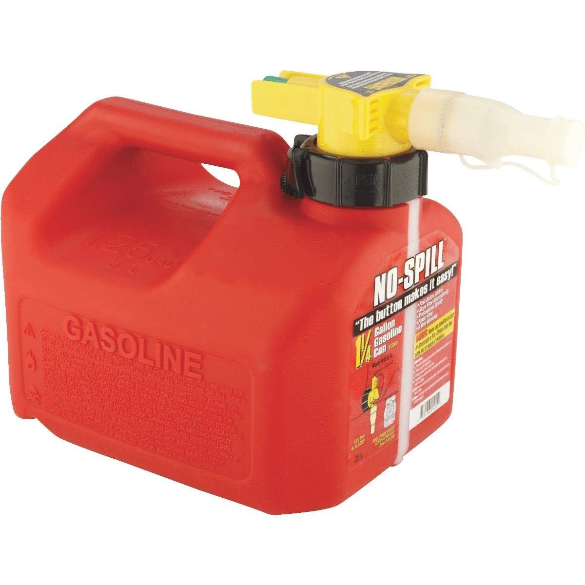

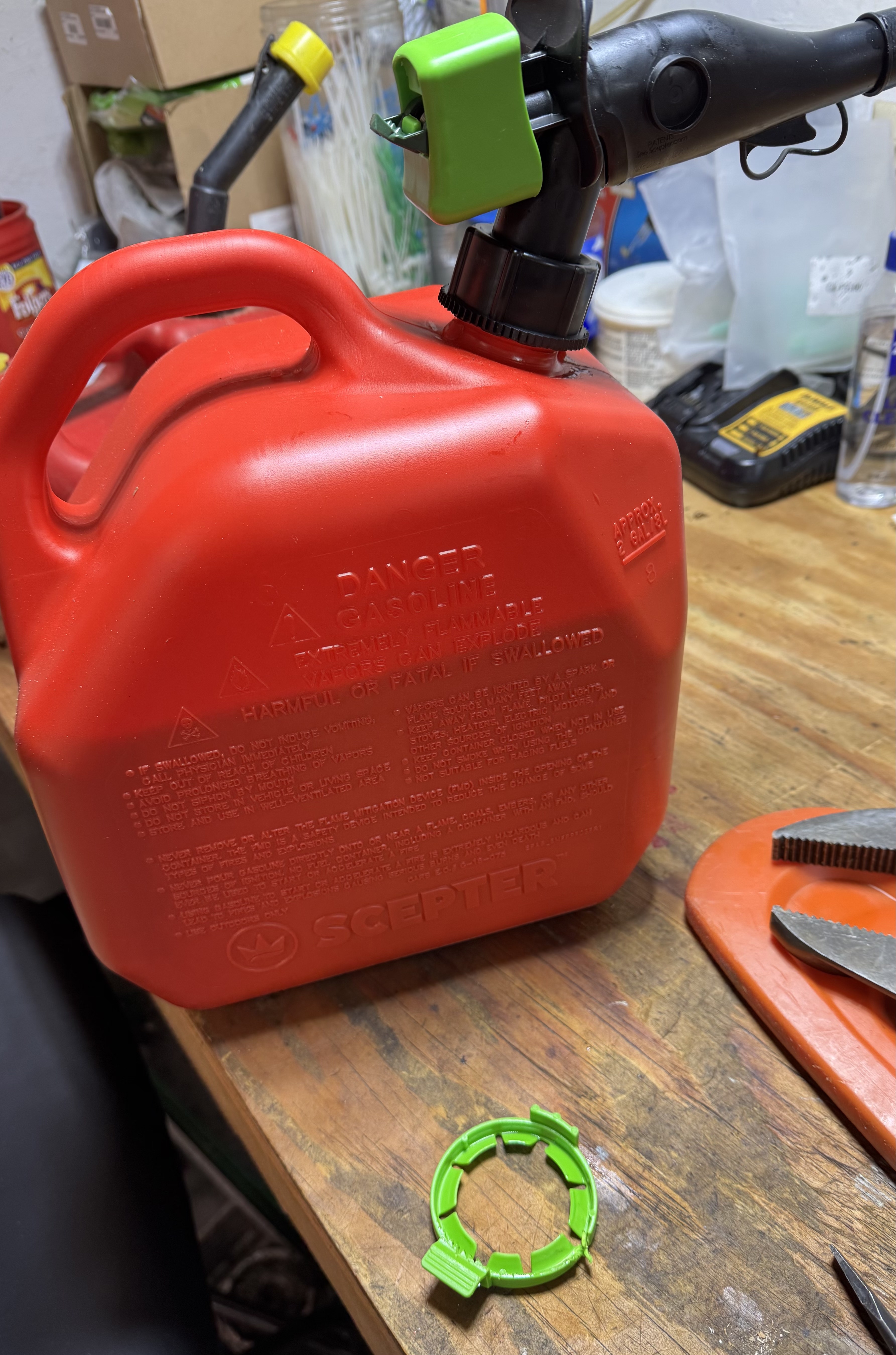

You can fix most of the new cans (except the ones with the green button. Don't buy one ever).
for the others (midwest type cans) First pull out the strainer and throw it away. For the spout, fix them this way; there is a rubber gasket on top of the nozzle that holds it together. Take it off, pull the sliding part out, remove the spring, slide it back together, put the gasket back on. When you need to use it, just push in the release button, pull the sliding part up and get the fuel out.

Green Button Can?
/ New fuel can comments. #60
No Spill brand. Oddly, my favorite of all the current options, without modification. But if you're going to modify, they'd be the most difficult.
I like this can also… no complaints… that said sometimes only a long flex spout will do.
