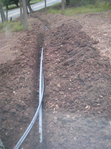

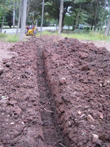

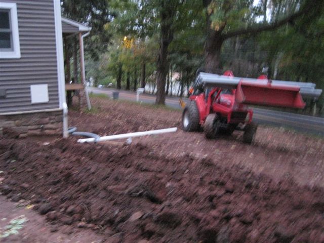

The latest chapter of my house renovation/addition was putting in my new underground electric service. The old service was fed overhead from across the street. My utility co. put a pole in at the corner of my property, I had to trench from pole to house and lay conduit and pull in 2/0 copper wire to the meter pan.

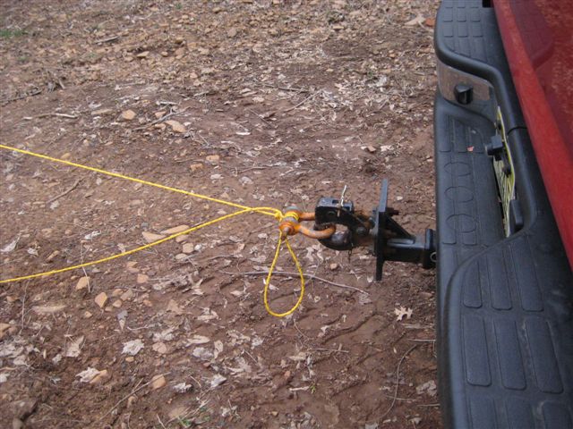

pulling in the wire with my pulling crew

/ New Electric Service - Underground #4
Around here everyone is overly concerned about separation between the primary and communication cables (Annoying 60-cycle hum). Personally, I have never had an issue, but I have also been pretty careful about maintaining a good separation.....

trech is 2foot give or take in most spots but after finish grade it will definately be well over 2'.
around here any new houseing development is joint trench, you've got 13kv primary & 120/240v service wire, gas main, phone and cable all in the same trench and usually criscross or touch each other at some point.

The electric conduit is 3", the other 2 are 1-1/4" for phone and cable.

I ran 3" pipe for the power and 2" pipe each for cable and phone. Specs here call for the trench to be 4' deep with a sand base, no large rocks and 12" of sand on top of the conduit. Also the sweeps had to be galv metal pipe. My run was 185'.

I don't think running primary in the same ditch with other lines is code anywhere, and should be buried at least 3 ft deep. I install most primary 4 ft deep in a separate trench and depending on where it is lay in about 6" of red concrete on top for protection.

We have our phone,cable tv and internet from our cable tv company, so for now i'm only pulling in coax. The other conduit is there with a pull rope inside, so if we ever switch to verizon fios they can pull in fiber.
