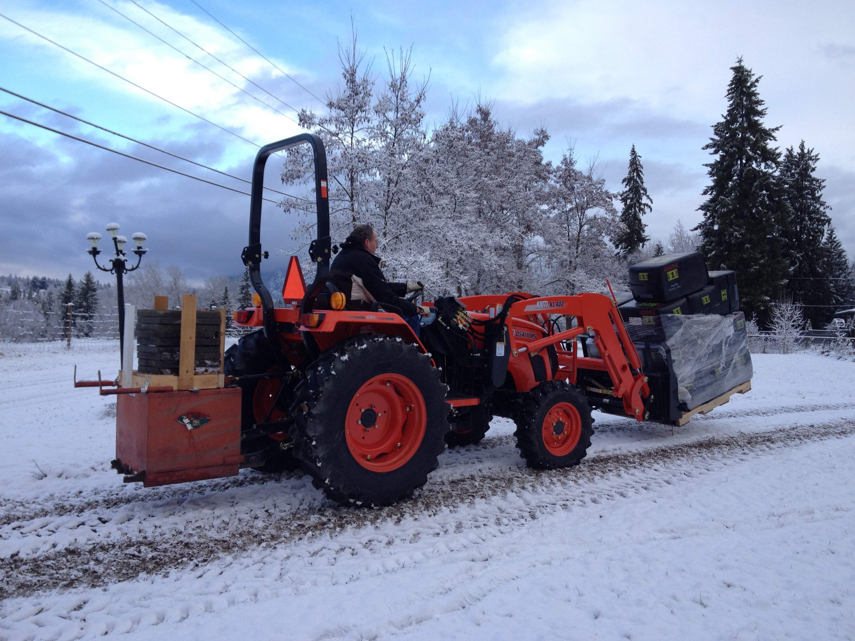

Well I know inquiring minds want to know....
I needed to this at the last minute, as I just returned from a 800 mile road trip yesterday afternoon. So my solution was, to take an old 3 point sprayer, removed the hoses and meters, filled the empty sprayer with a sand soil mix some where about 500lbs, quickly built a box to hold some 16x16 patio pavers flat, on the top of the sprayer box. Finished weight around the 750 to 770 lb mark.
The truck showed this morning and we took the first pallet off, 25, 60 to 70 lb bales of soil. Around 1750lbs, Loader just lifted an inch off the back of the trailer, and I could feel the rear end get pretty light.:eek: Set the load gently down on the ground.
Pallet number two, we took 5 bales off first, down to 1400lb and the new Kioti pulled her all off. Moved slow, and carry the load low and no issues. More counter weight will be needed even with the tires loaded with rim guard.
Split the first pallet to 2 loads and the new toy didn't blink. Overall pretty happy.
Plan now, is turn the sprayer upside down, empty out the sand/ soil, preb and paint it it, then I will fill with real sand or if I can find a ton of lead tire weights, for a consistent weight.
I know it didn't happen unless photos appear, so for your enjoyment.. and yes the front tires a tad under inflated, will fix that in the next couple of hours

Way to improvise. Weird homemade ballast boxes are better than $$$$ ballast boxes.
