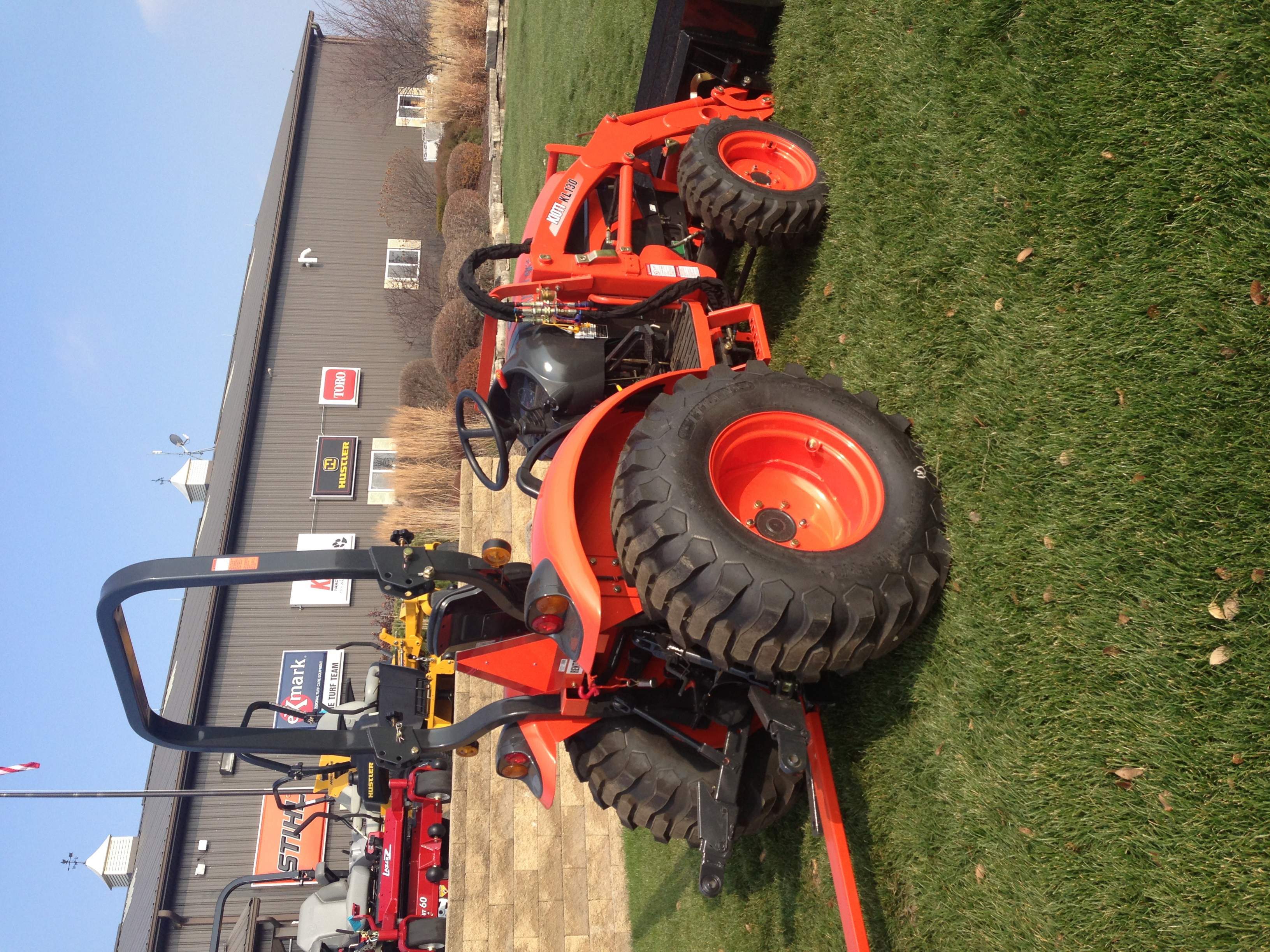

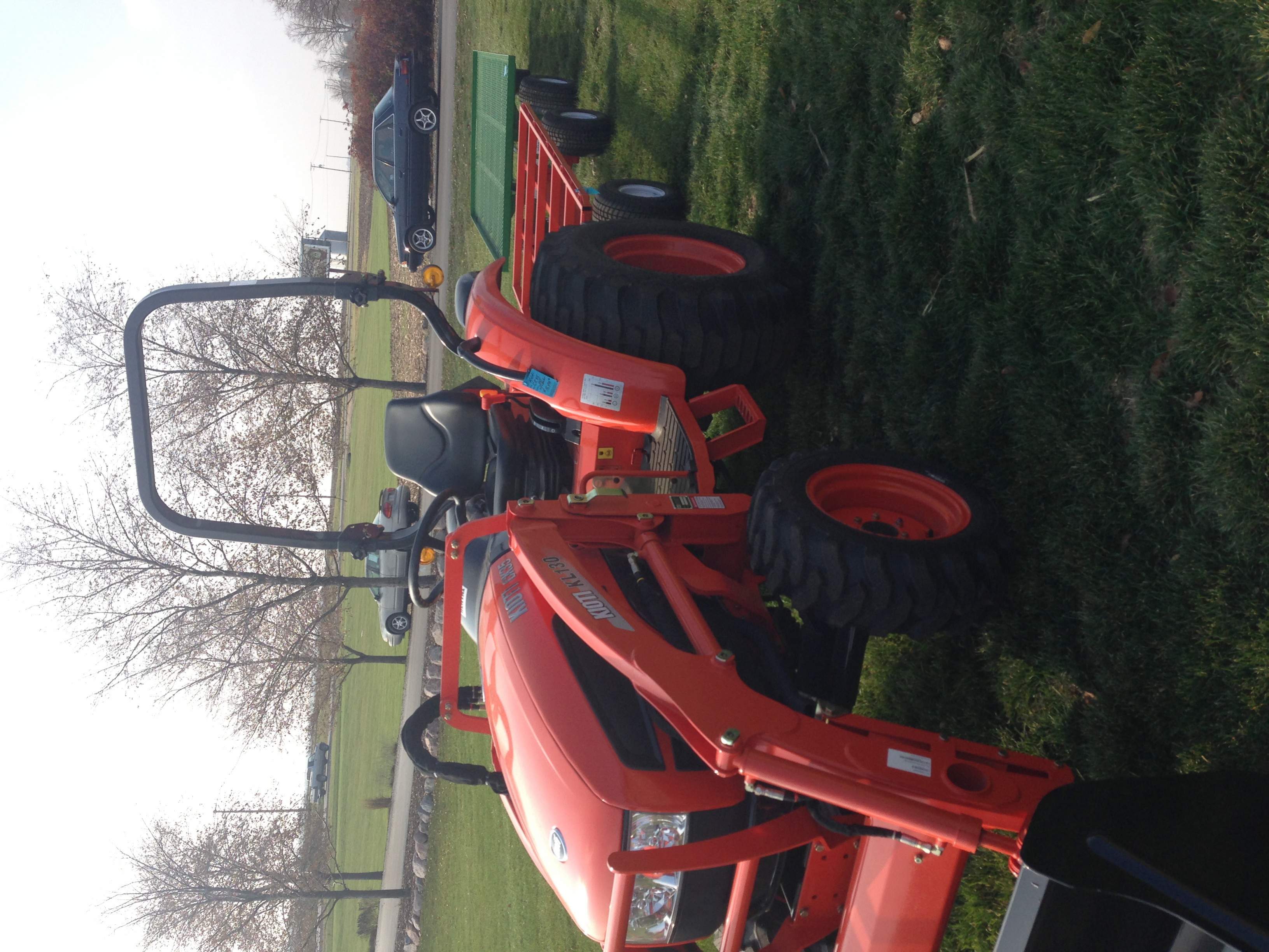

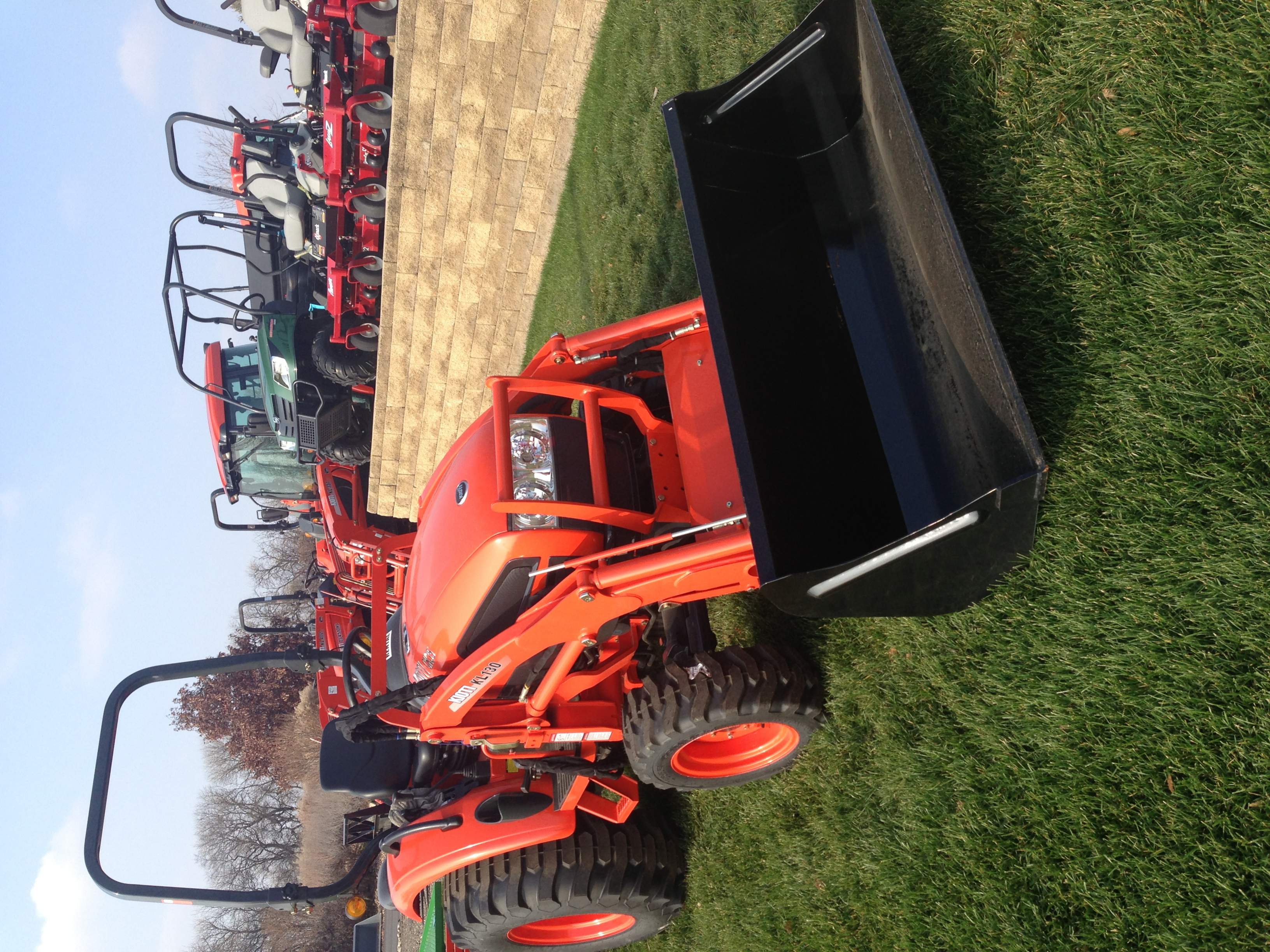

I just left the dealer and left a $1000 deposit on a new 2011 ck35 hst. Loader, quick attatch bucket, suspension seat, r4's, grill guard and bucket hooks. They don't fill tires so I'll have look elsewhere for that. I may have them install remotes, $340 for one set, another $430 to turn it into 2 sets. I have know idea if ill ever need them but may add them anyway. image.jpgimage.jpgimage.jpg
