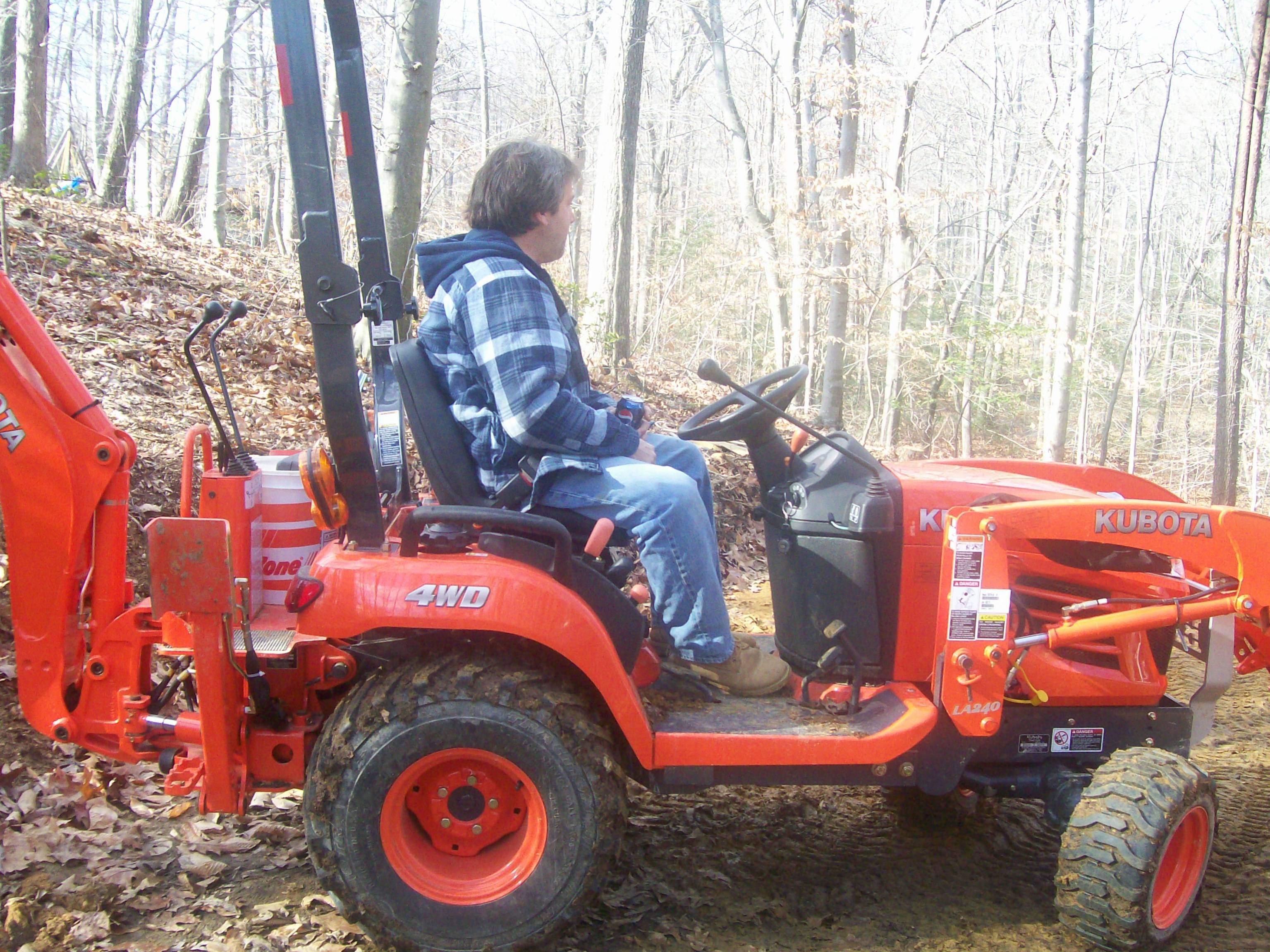

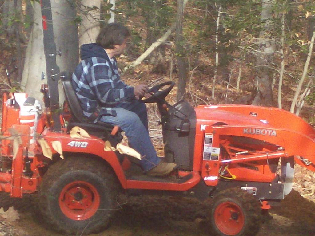

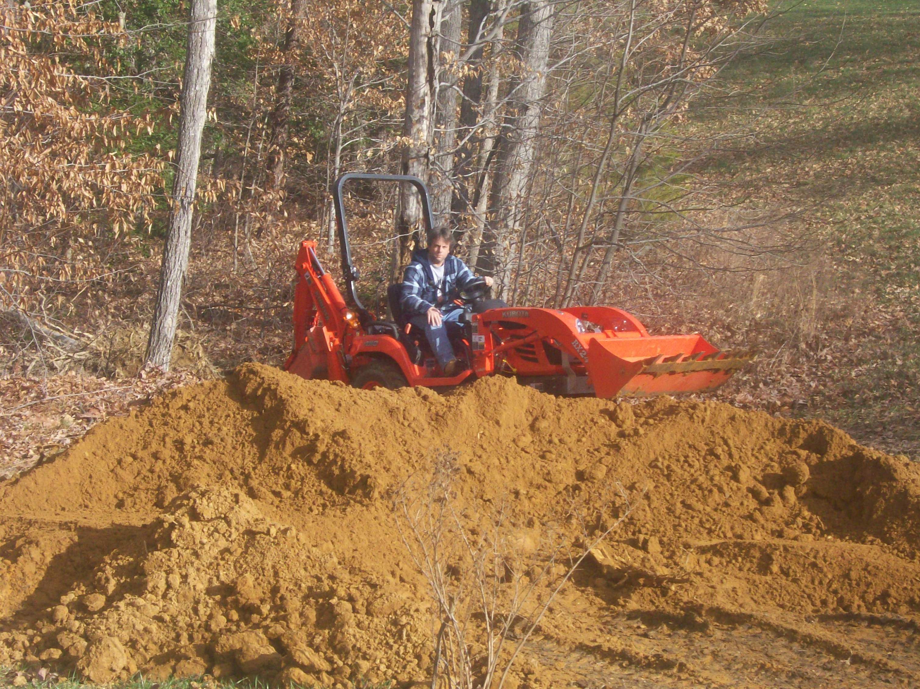

1*You may still be fine with a SCUT.
2*I Have cleared over half an acre of brush
3*moved 60 ton of fill.
4**It Is slow..
1* I think he will be.
2*I cleared .6 acres of dense heavy growth consisting of many many 4 to 6 and several 8 to 10 in diameter trees with my bx23.
3*I've moved way over that much dirt and slag .
4*No it's not it just may seem like it.

1* I got tired of always getting stuck in 4 inches of snow. I did have extra weight & chains which helped a lot but the tractor just did not have the ground clearance.
2* I got tired of always getting stuck in 4 inches of snow. I did have extra weight & chains which helped a lot but the tractor just did not have the ground clearance. Look at the size of the wheels. What do you think is going to happen when you try to clear a foot of snow.
3*You can try to clear it in front of you but as soon as you have to back-up & those tiny wheels start going into the deeper snow because you did not back-up perfectly over the cleared path you just made.....your toast.
Believe me.
4*I did it for 5 years & it was frustrating.
Congratulations on getting the new property. Must be on cloud 9. :)
1*I don't know what you had for a tractor But my old 1966 Bolens 850 garden tractor with weight and chains handled it well for years.
2*Plowed several 14 inch snows and many a 4 6 8 and a couple of 10 and 12 inch snows with the ole Bolens// no problem.
3*Never ran into this with the Bolens.
4*I plowed a lot of snow with the Bolens in the 42 years I have owned it without problem.
Looks to me like if plowing snow with a garden tractor is as problematic as you paint it to be I would have come across it somewhere along that 42 year journey don't you think!

1*A BX isn't a step up form a 14 HP riding lawn mower. It's in a totally different class.
It's a real work horse of a tractor in a compact size.
2* I've done an amazing amount of work with mine on my 30+ acres.
3*There are times I could have used a bigger tractor but they were few and far between.
4*I do logging in my woods to feed my wood stove and to be honest the extra 4 inch clearance of a 2620 wouldn't make a bit of difference.
5*The small size and 48 inch width of the BX allows me to get between trees that I couldn't with a bigger tractor.
6* As far as snow goes, even with turf tires (which work fine for me under all situations) in 4 wheel drive I cruise thorugh 1 foot of snow without a hicup.
