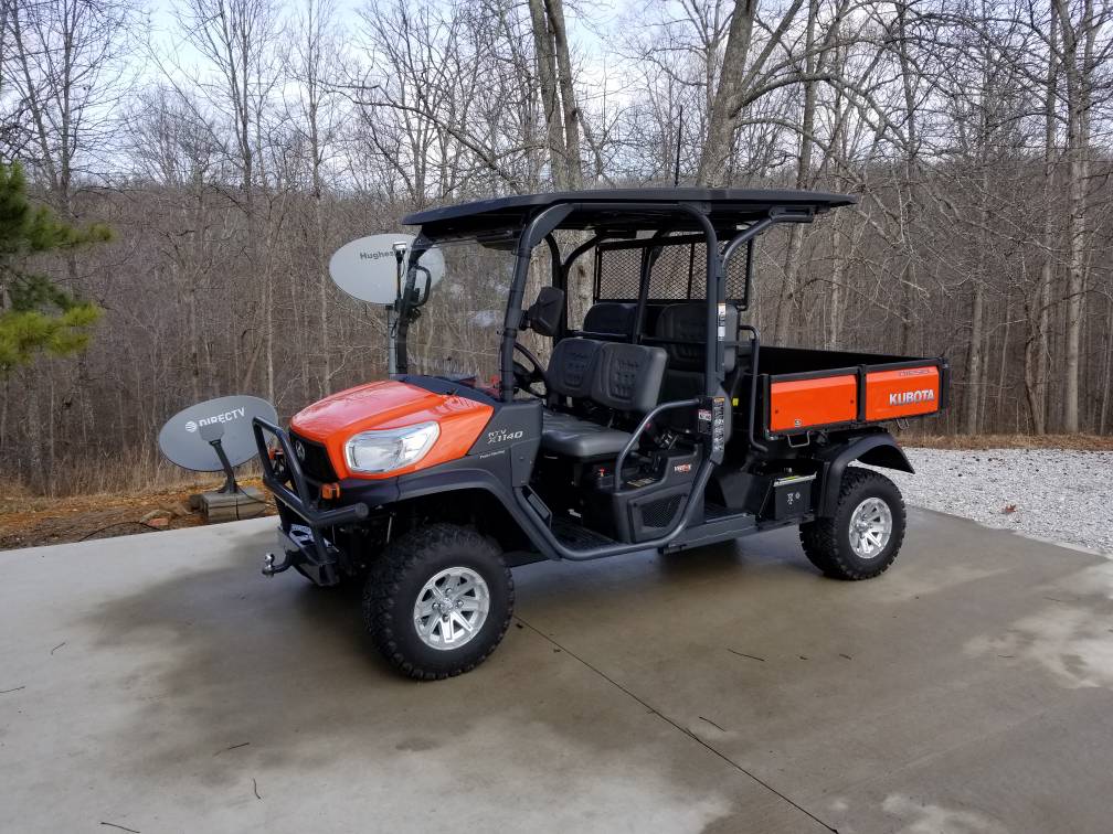

Beautiful machine!!!!

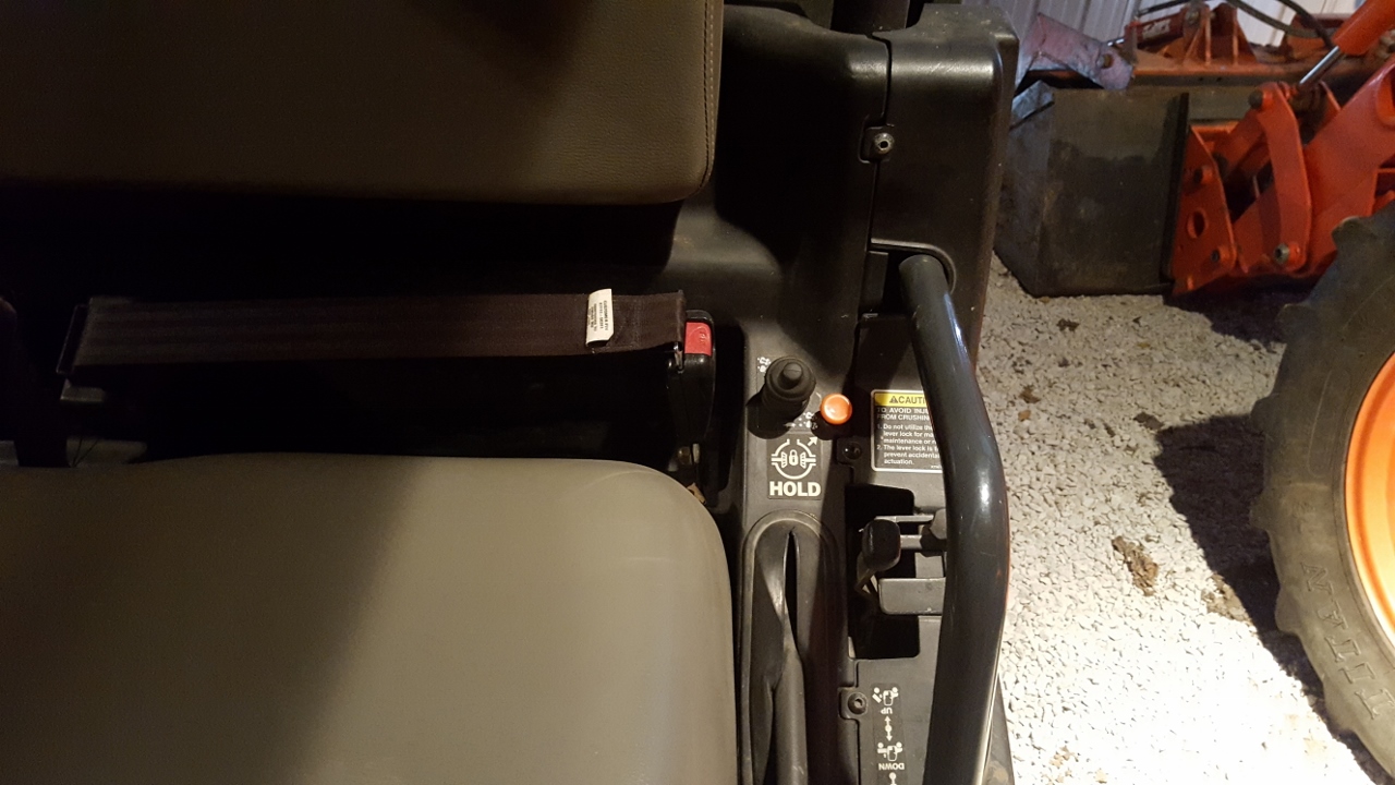

I think I paid close to $100 by the time it shipped. Yes, very similar in design. Push the button on top of the knob and pull, releasing button when you are close to what you want. Then turn the knob clockwise to increase, counterclockwise to decrease engine speed.
I don't use mine a lot. But I've been in situations in the steep timber that required it to get out of.
Black knob up and to the left of the small orange knob. Your location might be different. Very easy kit to install.

Cool. Thank you for the pic. I have a blank in the same spot yours is installed. I'll order one today.
BAM!!!
I haven't even been on here 24 hours and I've learned something important.
Thank you very very much..
