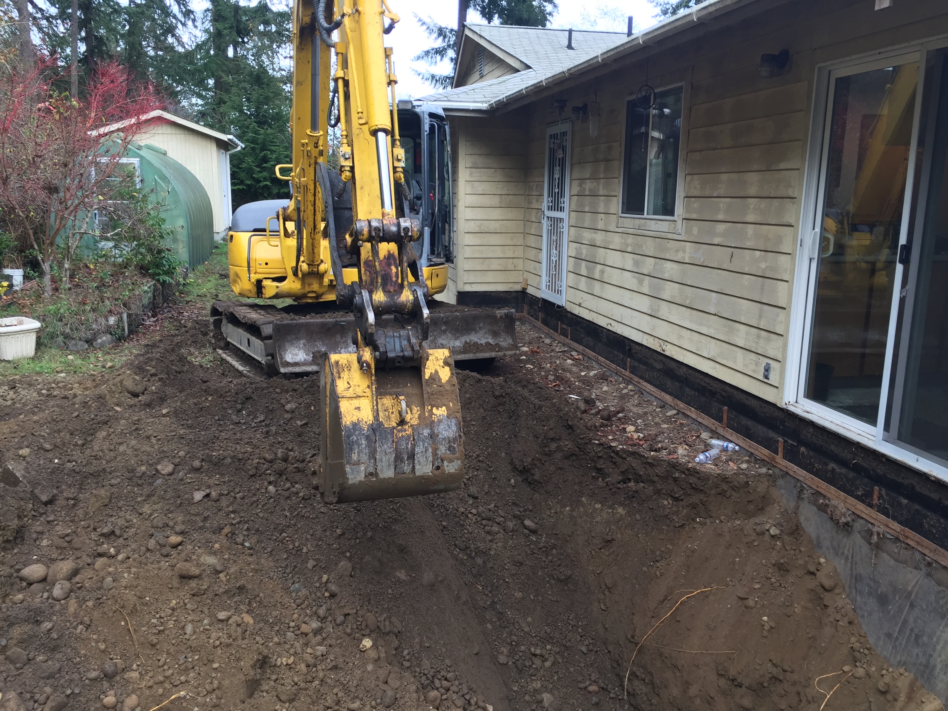

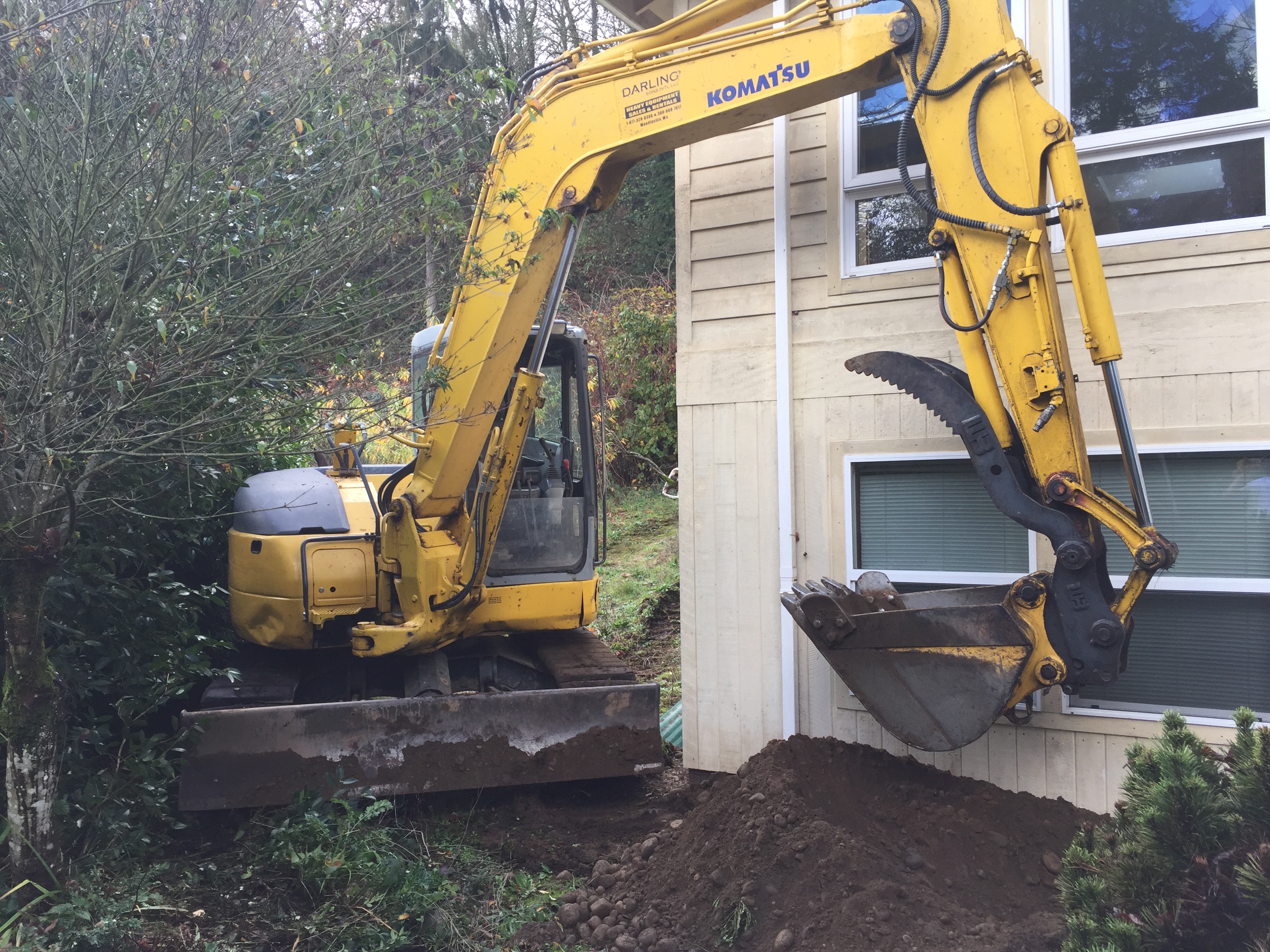

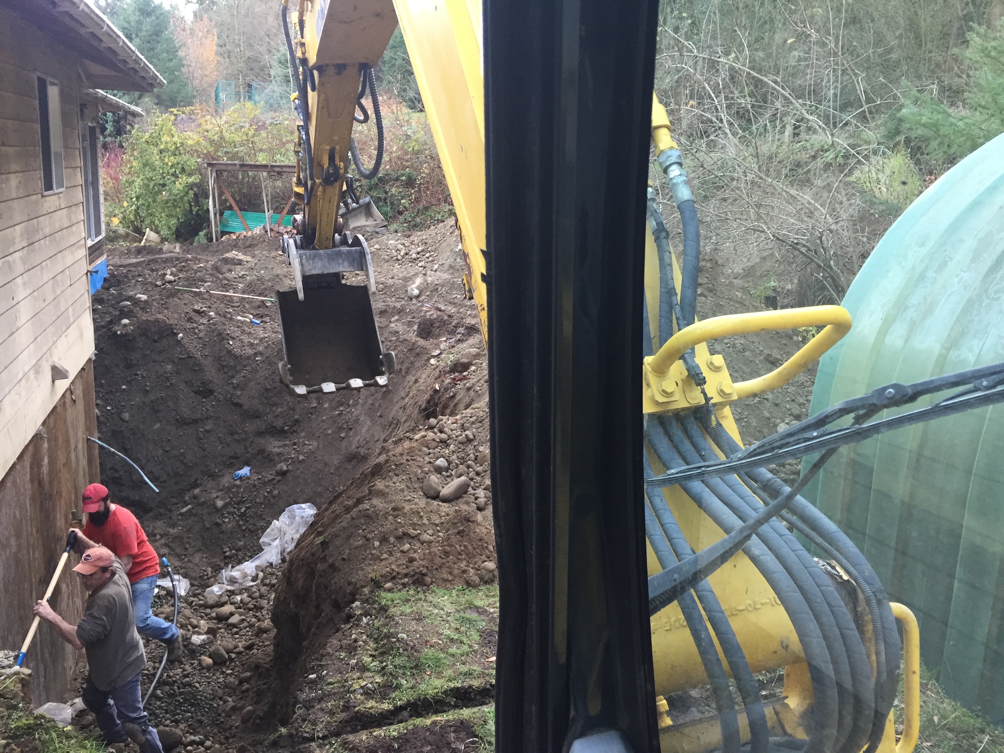

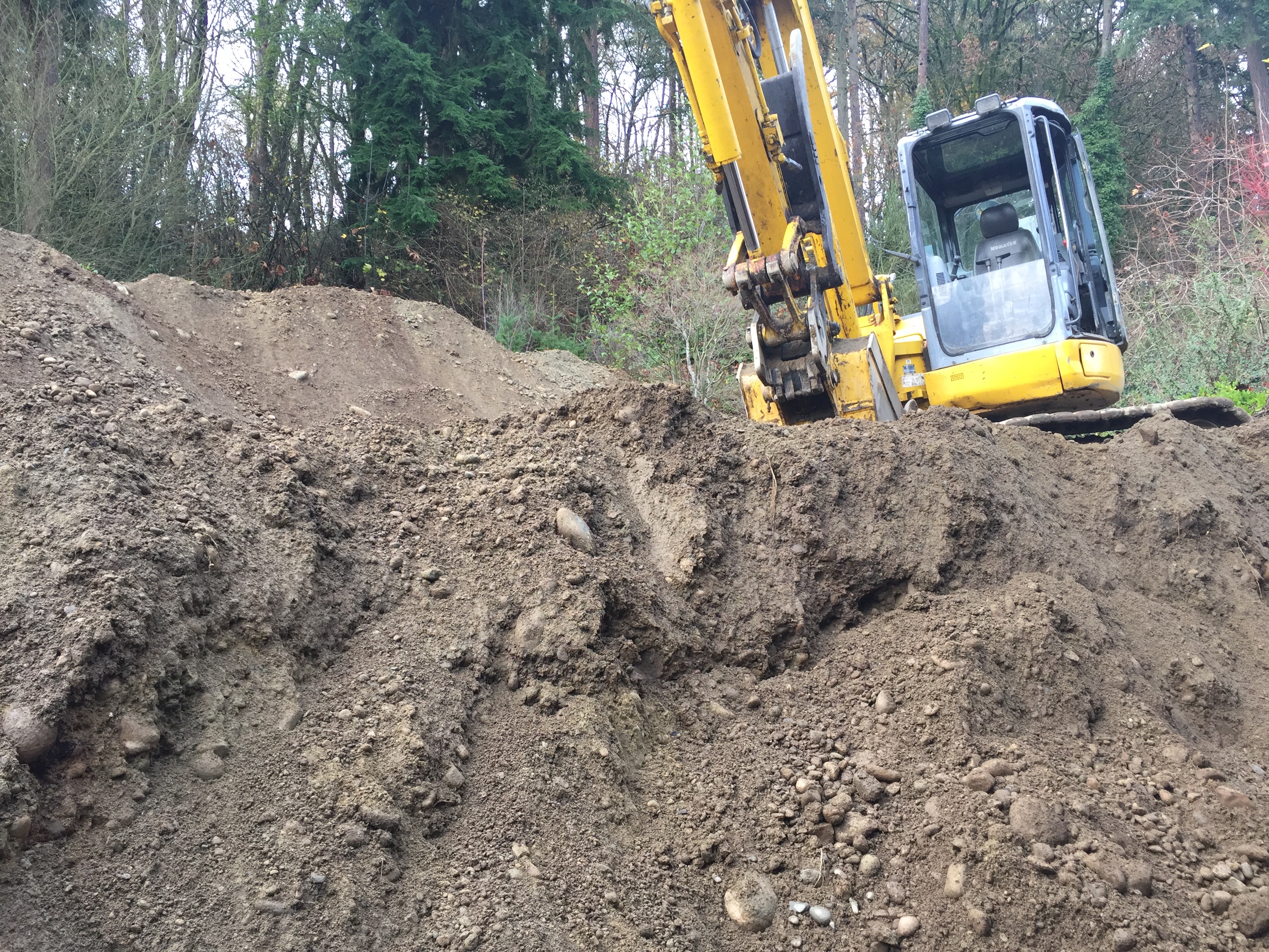

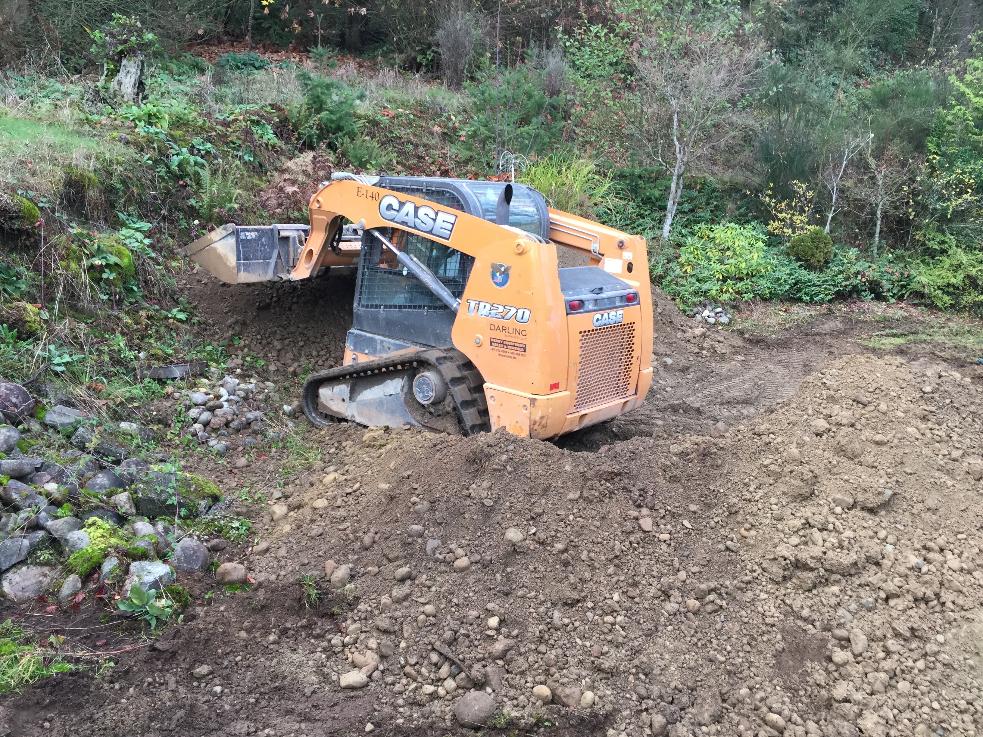

I'll see if I can get some pics from my first project to post. It shows a pretty good sample of my rock soil and my project acre.
/ New B26 tlb. #12
Nice pics. A few rocks, but mostly dirt. Around here we would call that pretty good dirt.
