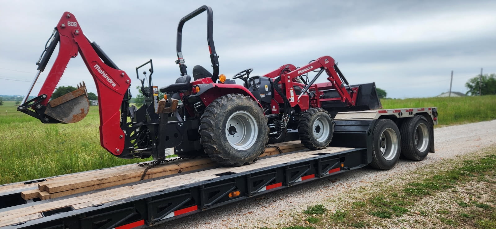

Hi folks. I recently acquired a used low hour 2638 HST TLB. Some of our property developments are a bit more intensive that I wanted to do with hand tools and what I had, thus the TLB.
I already have a interest in acquiring a couple of attachments to help with my project bucket list. Forks, Grapple, maybe a landscape rake, hyd. thumb and a box blade come to mind for the time being.

My 2638 TLB is in transport, I should have it in the next day or 2.

I've put just over 40 hours on it so far. Mostly doing property maintense items. Some backhoe use, anda good bit of landscaping dirt moving.
I acquired forks and have modified them by adding a 2" receiver. I've got a 8k winch that is mounted on a 2" tube and plate, and of course moving trailers around is easy with the setup.
I'm noticing that my tractor has a tick(kinda lifter sounding), that is very noticable immediatly after starting, however it does quiet slightly during the initial warnup, but is still loud IMO.
I did a oil change using T5 15w-40 but didn't notice any perceviable improvement.
I'm in need of a service manual that includes the engine (preferably the entire tractor) to start doing some investigation as to what the actual problem is. I'm not on FB, and am not likely to ever be there.
